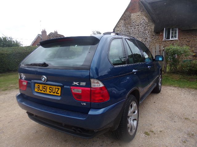

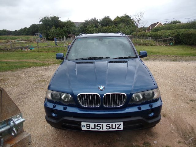

Don't listen to the haters!
I have a 51 plate 4.4 v8.
Unstable, no, not even remotely. Is by far the best cruising car i've ever had. I would advise though, if it is to be used for lots of local driving, don't get one with M sport suspension, mine has. it makes local driving a little harsh on pot holes and speed bumps etc, but it comes into its own on A roads, motor ways etc.
Depending on the how much it gets used, expect to replace ball joints etc more than a "normal" car, lots of weight bearing down on them all the time. Common bushes to go are the rear sub frame mounts, mine need doing, you'll notice a "thump" from the back end when going over speed bumps for example. Many horror stories on costs, but reality is, bushes can bought for around £80, my local indy will fit mine for £193.00.
You'll get through brake pads to0, heavy car to stop, front wheel will always be black! Again inexpensive job.
The most important thing in buying one, is history history history. Check the online MOT history, this gives a good idea of how its been look after etc. Try to find one with as little owners as possible, mine had 1 for first year, then a lady for the next 14 years. I would put history much higher up the list than spec, mine has a pretty low spec but very good history. Look for things such as the correct tyres, should be Michelin Dyamaris (SP?), if it has budgets, wall away. Check all tyres have even tread, they suffer from transmission wind up, for example, if you blow a tyre, you need to replace both on the axle. Without going into it, wind up over long period screws with the gearbox somehow leading to problem, and they can be expensive ones.
Make sure the engine is dry, not power cleaned, just naturally clean and dry, mine is, and doens't drop oil from anywhere. A power cleaned engine would be very concerning.
Wouldn't bother with the diesel, not much difference in power to be honest, you can't beat the V8 grumble! I would think the 3 litre petrol to be bit underpowered, it is a heavy car, but that is just a thought as i've not driven one. Also, the 4.4 only comes with auto, and to be honest, my wife had reservations about auto, but now having driven it, the auto is the one to have she loves it.
Be prepared for warning lights to come on, I have one for the brakes coming on although there is nothing wrong with them. I have one on at the minute for the driver side rear brake.stop lights, they like to mess around and not work, i've not looked at mine yet, but it is common and something to do with connections.
In summary, an excellent car with a bad reputation, but you never read about the good ones on the net!
