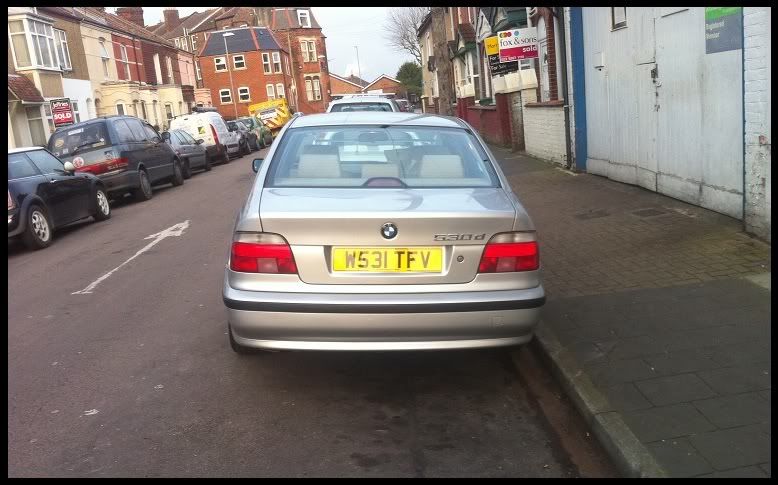

530d. With 95k Full BMW Service History. One owner for the last 8 years. Silver
So this morning I took it for a test drive and I fell in love. Now it does feel a bit like a old mans car with the cream leather all over but I love it. Everything works just needs 2 front tyres but I will be changing the wheels anyways.

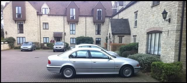

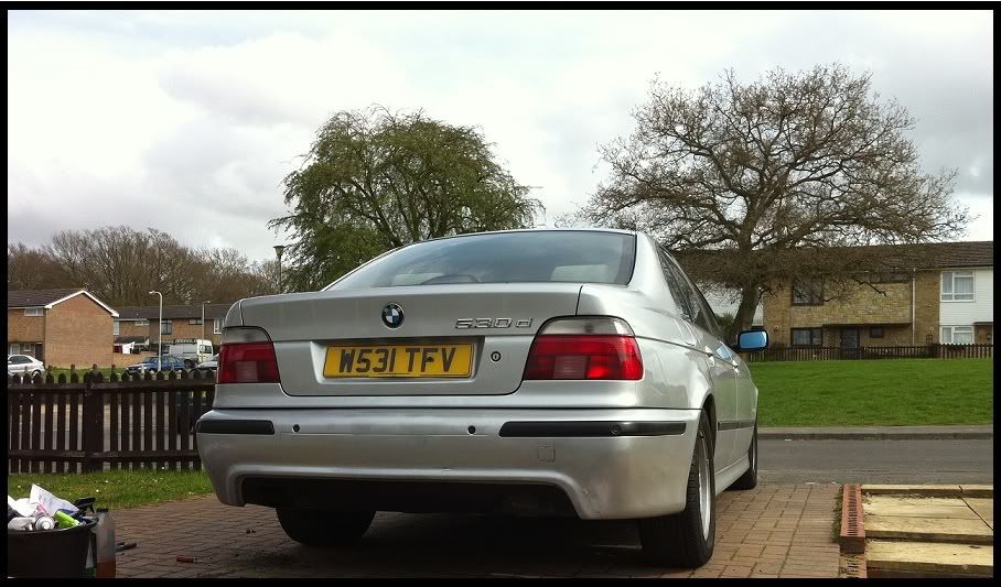

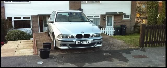

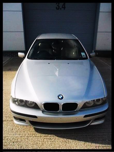

So here is a quick pic nothing special. Will be getting a full detail this weekend.
Nothing exciting yet.

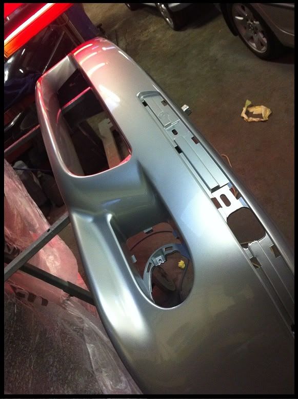

M spec front bumper ready to be sprayed up.

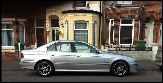

Here Is a pick of the car sitting in standard form

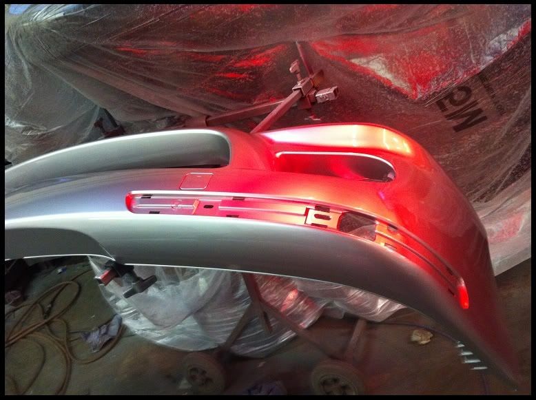

I have now dropped both front and rear bumpers at the painters. He is doing them on the cheap for me as a favour so make take a week or so to get done as he is doing them in his spare time for beer money and a quater of the price I would pay at any decent bodyshop.

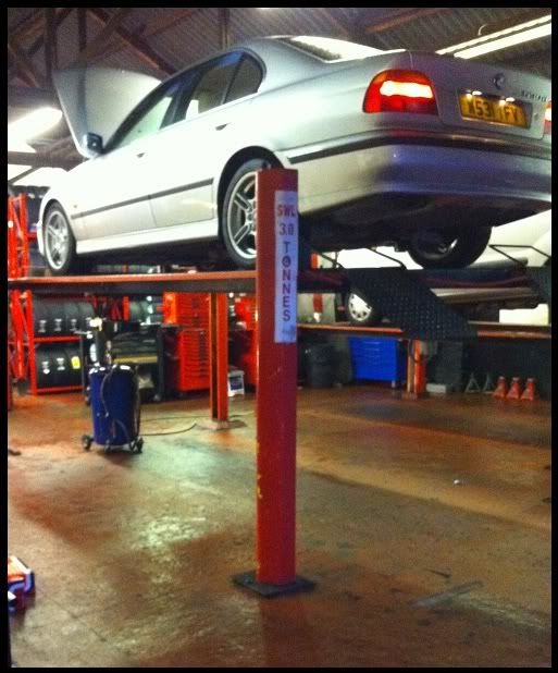

As I put in my previous post I bought some Fuchs Titan Race, I called opie oils and asked for their reccomended oil for the car. they said either Castrol Edge 5-30 or Fuchs Titan Race, I obviously went with the race only to find out my car takes 7-7.5 ltrs of oil not the 6 ltrs opie oils sold me. So I called Opie asked for another ltr but I would not be paying postage because of this. this didnt go well and I will not be ordering from them again to be honest.

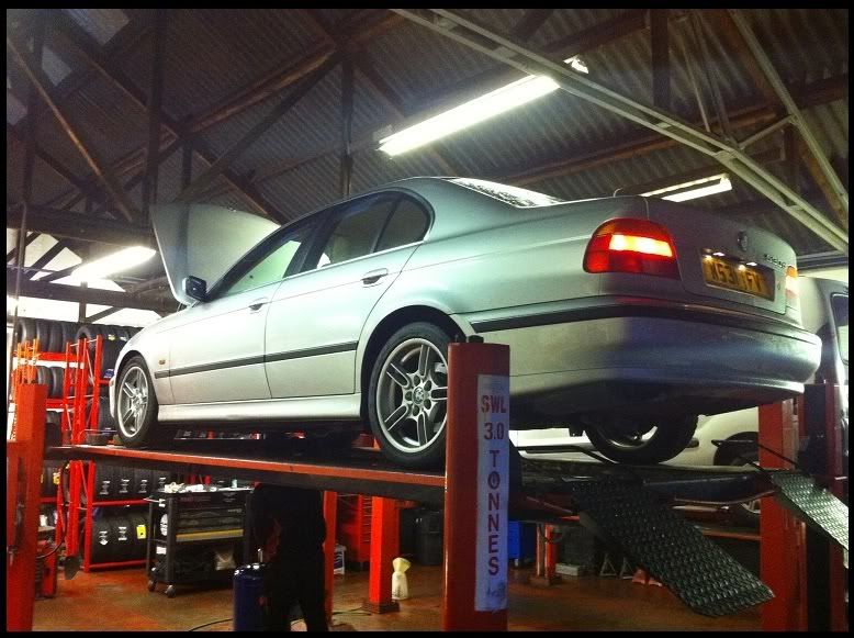

Fast forward to today. I made some calls to my friend in the trade for some Castrol Edge 5-30W and he tolde me to give National Tyres a call as they over a Oil service for something stupid like £40 much less than the price of the oil. So after a quick call to them I droped in and waited while they changed the oil.
to be honest for the amount I paid I was very impressed. The guys were very proffesional and let me have a good old look under the car while it was up on the ramps and commented on how clean the car was. I asked why it was so cheap and they told me its a gimmick to get customers in so they check tyres and everything else and they buy the oil in by the boat load.
So for a Oil Service with Castrol Edge Fully Synthetic 5-30W I provided my own filter. which they said they wouldnt let me do but after a quick chat he was fine with putting mine in. not that I dont trust the filters I provide. but no one can beat OEM. £38.70inc Vat. He even filled out my Service book and signed it.
The keen eye of you will notice the nose dive the car has atm, the car is feeling alot better for the oil service.

My sprayer called me on satuday to tell me the front bumper was finished. So I will be going down on Wed eve so I can fit the bumper and and make sure I'm happy. Cant wait M5/Sport front bumper totally transforms the way the car looks in my opinion. Can't Wait to get the Rear done.

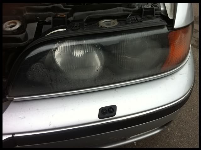

Today as money is now low from spending out on coilovers and bumpers I decided to do something that costs nothing. When I first picked up the car I noticed that the Passenger headlight was full of condensation and as I had an hour spare while the girlfriend was out I could use the oven without her knowing. :lol:

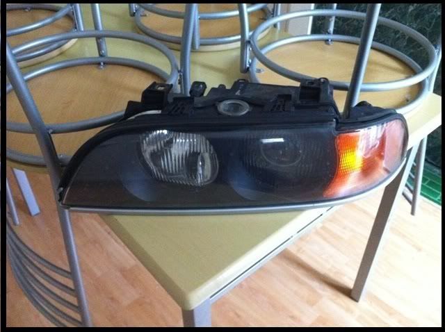

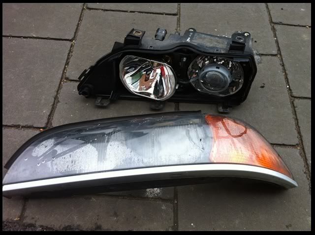

Headlight came out easy enough some of the bolts holding it in were pretty rusty, I've put it down on my list of things to buy.
Headlight out I gave the area a bit of a clean but there wasnt to much poop around it which was good.
It comes apart with about 5 clips which make it really easy. I'm gonna be on the look out for some new headlights later on but as they are £200+ for a set of good genuine angels they will have to wait for a bit.
Headlights apart. I took the glass out and gave the insides a good scrub then stuck the unit inside my oven about 180c for 10 mins.
They came out perfect. I didnt have any sealant so they will need doing again. but I made sure everything was back together properly so hopefully it will take a while before I have to do this again.
All back in.

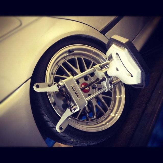

Rear Coilovers
Laser Alignment

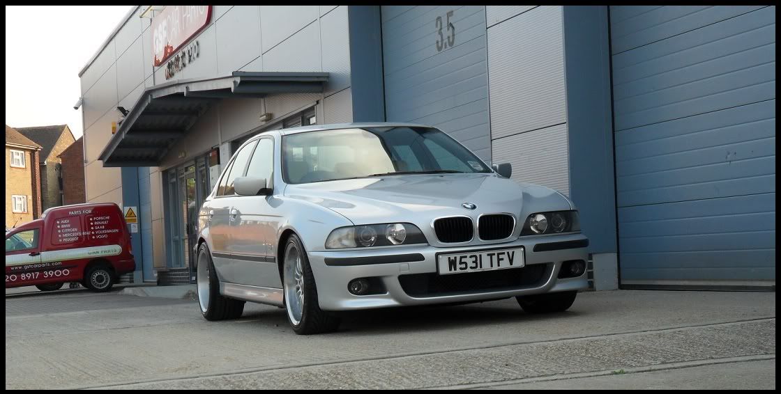

The front bumper went into the sprayer a week or so ago as the rear bumper needs a bit of work and Im a bit short on funds but the front was sprayed on monday but I wasnt happy with the finish so I asked him to do it again which he did. Here are some pics now finished.

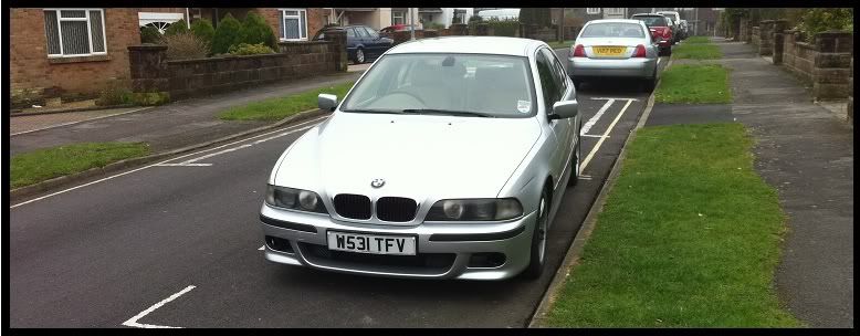

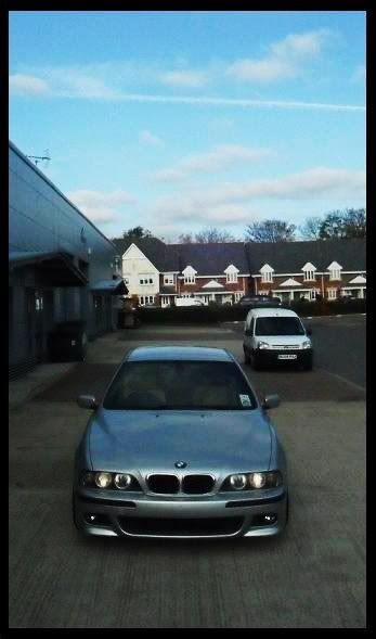

So After alot of of swearing and a bit of triming here and their I finally managed to get the bumper to fit.

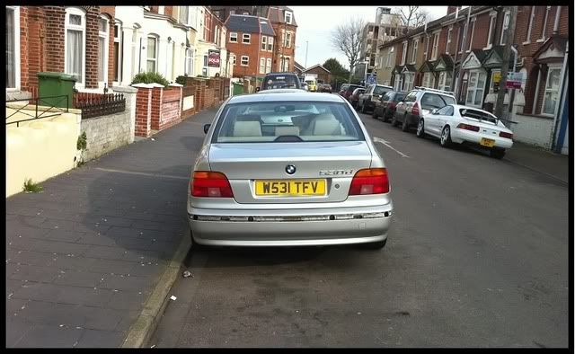

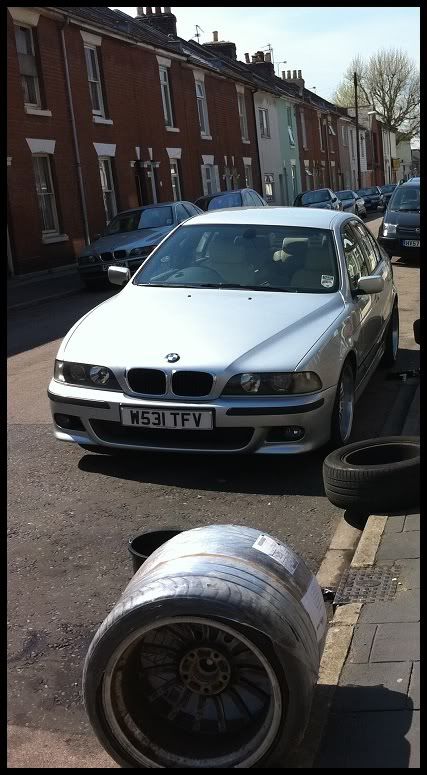

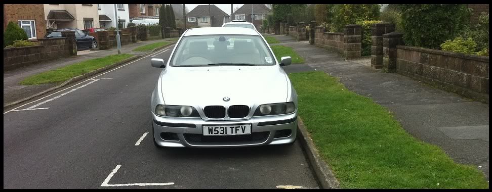

So here is the car 3 weeks ago

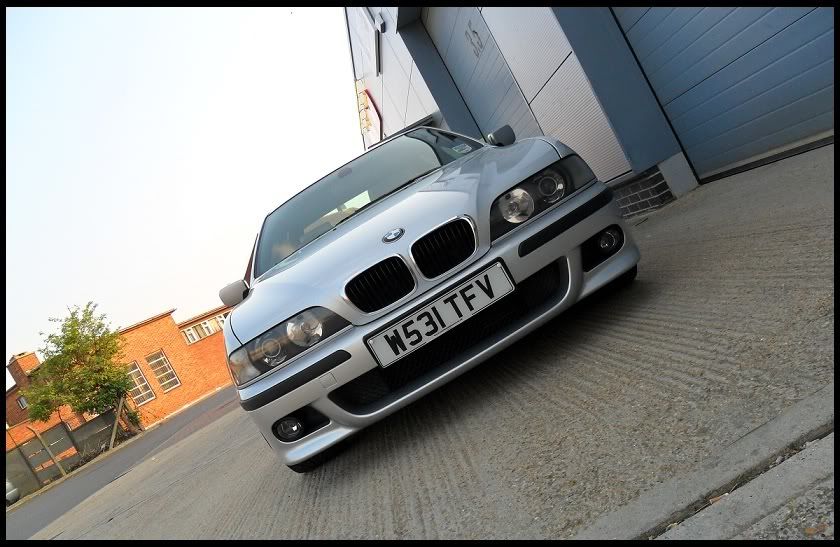

And now this is how it sits today. Really needs the new angel eyes and facelift grills. also you will observe that It has no fog lights. well they have not turned up yet but should be here soon.
All in all im very happy with the finish and fit of the bumper. and extremely impressed with the 5 series, My plan is to keep the car a long time so many more mods will be done over the comming months. let me know what you guys think

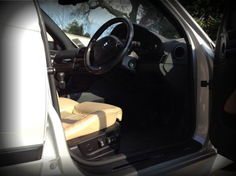

Time for a little update. I've been busy on the car today. Had a bunch of bits laying around that I had ordered while the car was being fixed so I wanted to get them fitted.
First I got a Mtec Steering wheel from ebay for a good price which arrived a few days ago. Now if anyone has ever tried to removed the air bag from one of these you will know what a bitch it is. for some reason the right hand side clip would not move at all. took me the best part of an hour to get the air bag of the mtec wheel. The old wheel took like 5 mins to take off so here is a before and after.
Ugly massive steering wheel
Less ugly steering wheel

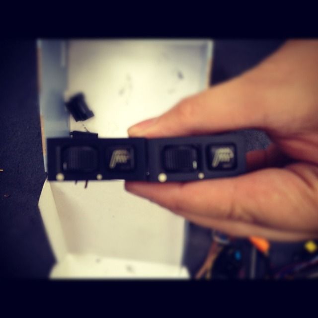

The bumper I had never came with sport fogs and some of these fetching up to £80 for two I waited for a good deal to come up and got these for £40 for the pair I also took the time to delense the car. Pictures dont show it that well looks much better in real life.
Left hand Delsensed
Both done.

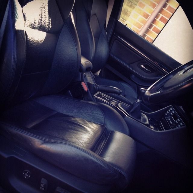

I also managed to pick up a set of black leather sports seats
These wont be this colour for long. and my interior wont be beige and brown for long either. I have black dash on the way with new doorcards hopefully and black pillars and rooflining. Thats about it for now will update again in a few weeks.

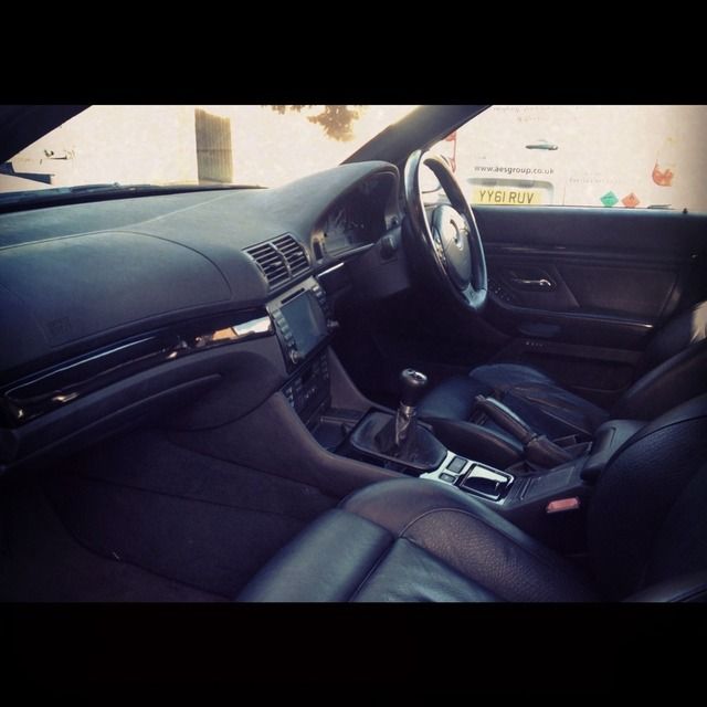

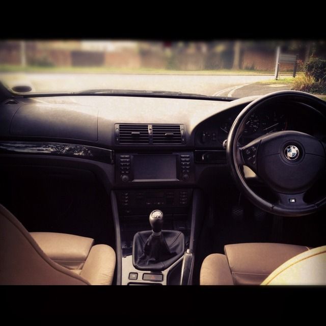

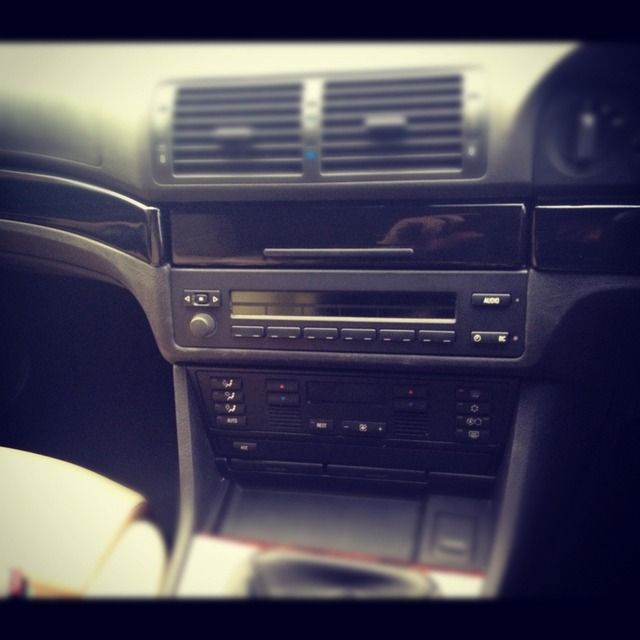

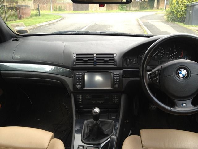

I managed to pick up a decent headliner the other week to decided to fit it. really didnt take any pics as to do it quickly its a 2 man job and it was only me, but I got stuck in and I really enjoyed taking bits apart and seeing how it all came apart.
I fitted all the pillars bottom pillars rooflining. I now need a black carpet, center console, under dash and dash bits to finish the interior. I also decided to spray the ugly cream/beige parcel shelf. So out it came. you wouldnt believe the amount of effort just to take the bloody parcel shelf out. all the rear seats, headrests, then rivets its C pillars. trust me in this heat its an effot!

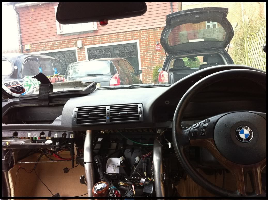

Right well what can I say but massive props to Paperjams who took the day off today and helped me get or this sorted. I would of never got this done on my own at all so really owe you one mate.
So the morning started at about 6:30 :shock: which is super early for me. Kissed my pregnant lady goodbye and said "I should be back by about 2pm". How wrong I was! well after what seemed like an eternity on back roads I was finally in reading and I met Paperjams had a good look over both cars. Cosmos black is just such an amazing colour really makes the BM.

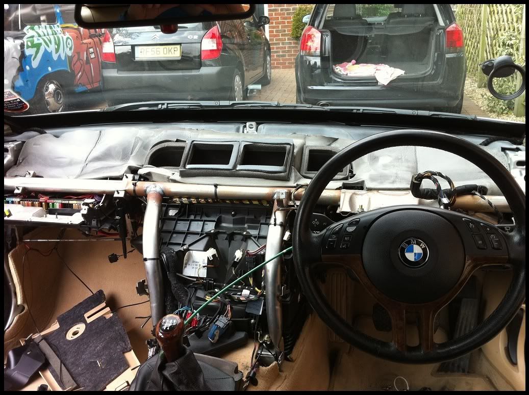

8:45 we set off to the scrap yard to have a good old gander at all the lonely E39's. the place we went to was a little bit of a gold mine to be honest. Is anyone is interested there is from what I could see a genuine facelift alpina splitter in good condion. bumper is mashed but the bit you need it fine. Did take a photo on my phone but its dissapeared for some reason?
9:15 we found a nice Titan silver in E39 flavour and went to town on the dash and carpet. the dash seemed to come out pretty easy to be honest but I guess it is when you dont give a monkeys how bits come off :lol: . Unfortunately we forgot to get a blade to cut the carpet so had to pack up our tools and nip back to paperjams house for some Krispy creames and a stanley knife 8) .
10:45 back on it we get all the seats out and the dash and had a good old mosey about looking for a lower dash, center console, doorcards and seatbelts. we managed to get everything bar the seatbelts unfortunately I totally forgot to be honest and some people kept trying to borrow tools and I didnt want him to loose them.
12:00 we loaded the car up with dashboard, lower dash, carpets, doorcards and some genuine black mats and side trims.
12:30 went for quick maccy d's and a recharge, then on to the pressure washer to have a good go at the mats as they were proper manky.
13:00-18:00 back on the car to fit it all. we had some hairy moments with a angle grinder and my new dash :shock: not being able to get the bloody accel pedal off! (honestly this thing was made by the strongest german in the world) and a problem with an airbag fixing. apart from putting bits back on and forgetting that there were a couple of wires behind I think it all went very well.
I am extremely impressed with how it now looks and there are no rattles and you would not tell it was not all black from factory. so once again thankyou for your help mate. Im really sorry I didnt take many pics, I just wanted the bad boy in. Door cards still need to be done but its getting there.

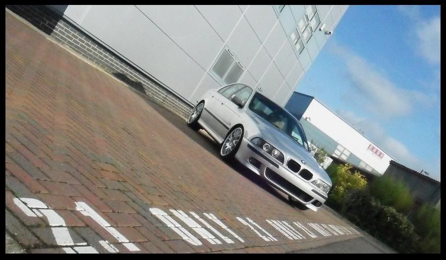

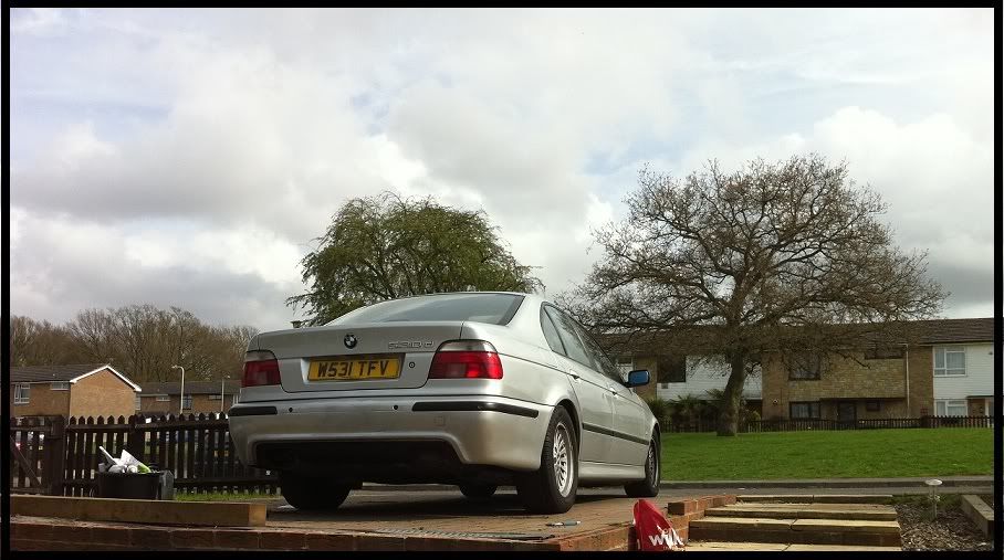

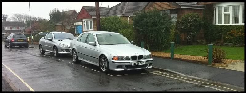

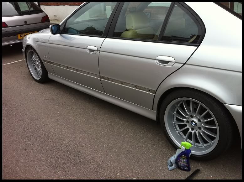

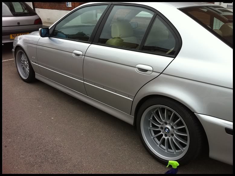

Went and took some photos of the car today. I had to raise the car as I need the rear arches rolling as the 10j wheels were catching on my new! right hand tyre so im trying to source an arch roller if not im gonna have to get someone like "arch enemy" to come over and roll and flare the rear arches as I really want to get it alot lower than it is at the moment.
The car is slowly getting their now. The rear bumper needs paint and the wheels deffo need refurbing, I think im gonna go gloss black on the wheels but we will see how that goes, Im also on the look out for a set of electric sport seats in beige so if anyone has a set for sale or knows of a set let me know.

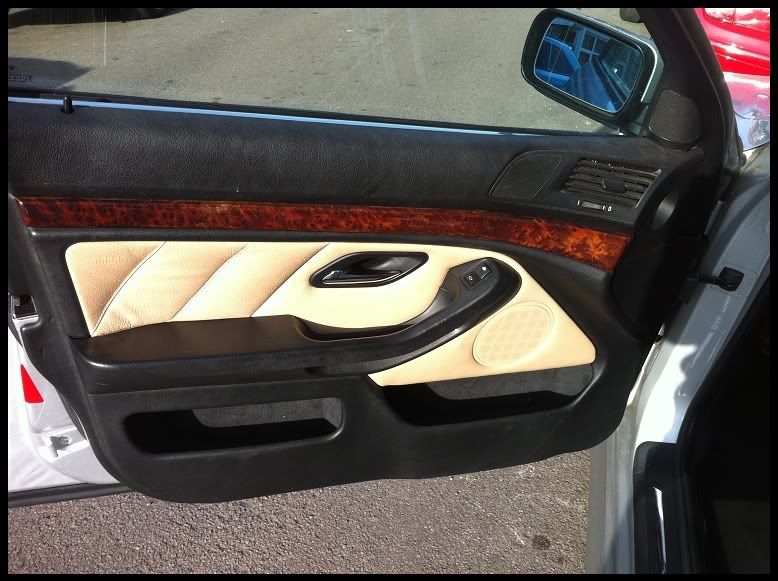

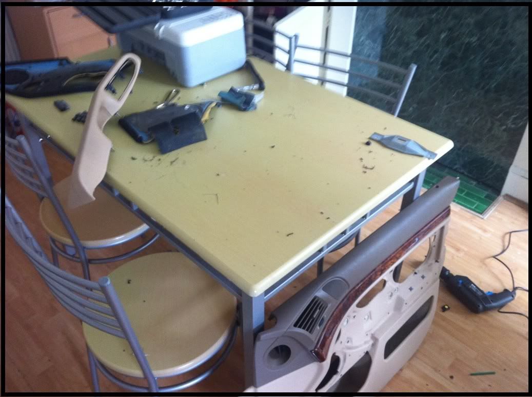

Started my two tone doorcards thisafternoon while the other half was out.
The Mess
The Doorcard
Just needs glue/self tappers now.

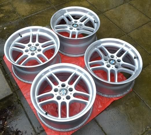

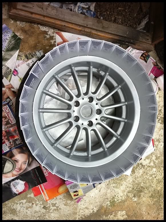

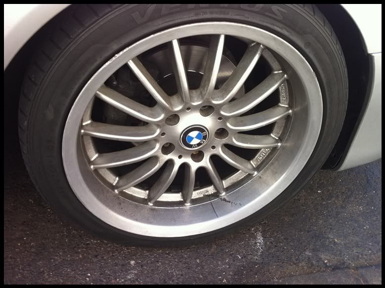

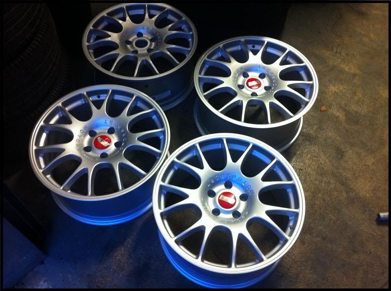

So the wheels are up for sale but have not sold yet so I thought I would do a mini refurb on them. When I got them from jeek they were not in the best condition but the price I paid reflected that. I used nitromors to remove the laquer from the wheels as it had gone milky and there was kurb marks and bits of dirt that had got in it. after that they looked alot better but were not great and really bought the overlook of the car down so I thought while they were still in my posession I would do a bit of a refurb.
So out came the sandpaper and wire wool. I sanded them from 200 to 800 grit then I had a bit of a search on what to use for these alloys. In the end I decided I would use Wurth Silver as apparently its very close to OE paint.
I didnt want to spend loads of refurbing these and had a full can of hammermite silver in the shed so I got that out and gave them a good priming ready for paint. Sorry I didnt take many pics as I only had a day to do this.
So From this
Do you like my ghetto use of playing cards?
to this
They are now all ready to be primmed and finally my Wurth silver paint and laquer has turned up so if it wasnt raining here today I would be cracking on but apparently there is a heat wave this weekend so game on!.

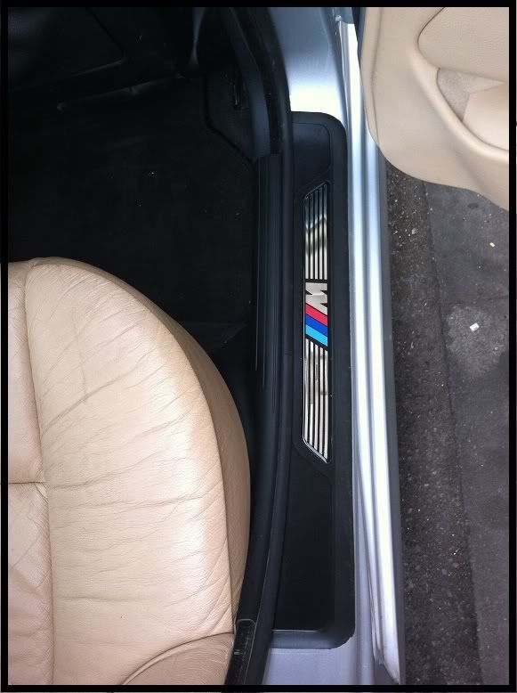

So next on the list was fit my new mtec mouldings and doorkicks. These are very simple to fit. just pull off gently and your done.
Then onto the door kicks. Excuse the rear doorcards there still not done.
All in all I'm very happy with them for the price I paid there not perfect but its a 11 year old car so what is :D

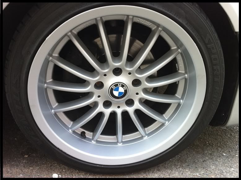

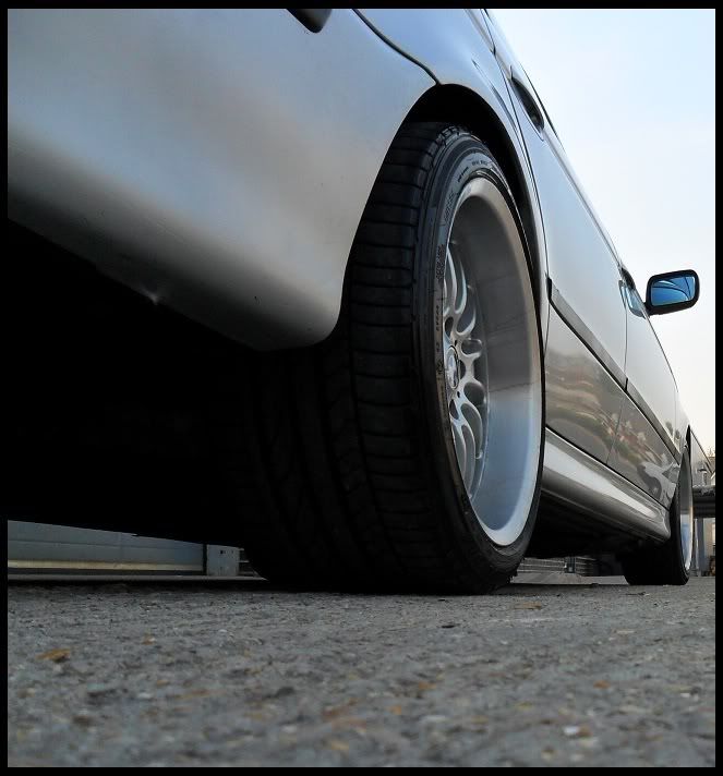

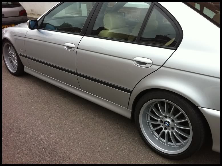

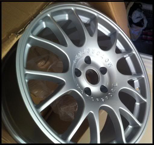

Well as some of you may know I was on the search for some wheels, but with the new baby money is king. I had been looking at some CSL rims and a set of alpinas just like Anils but these wheels just came up at exactly the right price to take them. I baisically stole these wheels. A guy on ebay was selling them at the a very low price compared to how much I have seen them for and he was just up the road so how much was it fate!
So I went to pick them up earlier. Get there and they were perfect never been fitted unfortunately he has sold the car now so never got the chance to put them on. So brand new still inboxes.

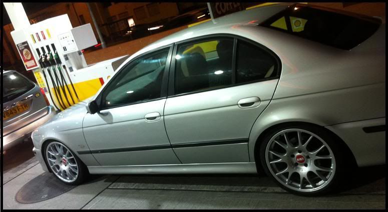

So next was off to my local tyre guys and I ended up with a set of P Zeros fronts & Vredestein Rears.
So here they are in the petrol station.
Now the ride height has not been set this is just what i was running on the 18's so alot of work and messing about is gonna be needed. especially since these are not staggered but im gonna stick a 20mm spacer on the back roll the arches and get it sitting just right with a bit of camber and tuck.
oh and my new resprayed bumper with sport diffuser just for good measure.
Im definately sold on the look but they will need the right height seting and the spacing for me to be happy.

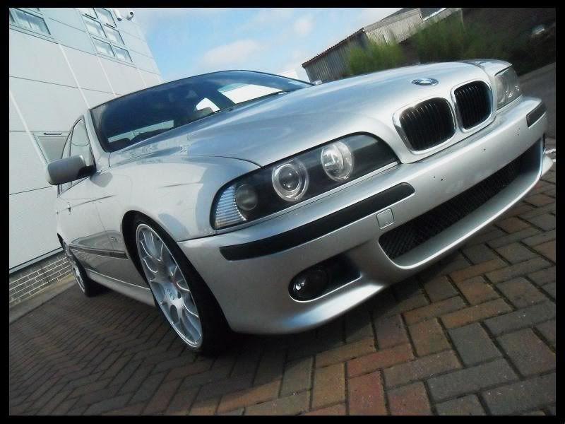

Well I last updated this properly in May so its been quite a while. I had not done anything until recently as my daughter was on her way and I really didnt know where funds would be once she was here so just normal servicing and putting petrol in the car. I have now nearly finished the interior and I managed to pick up a set of genuine Hella angel eyes that were not a fortune. I also have a set of facelift rear lights but im waiting for a part I need to get them fitted. I got the rear bumper sprayed as it was an absolute state and I was pretty ashamed of it.
Well I decided I would take some updated photos of the car today. Unfortnately it was really sunny out so made it quite difficult and these were mostly done with my iphone because my camera had no battery once I was out! but you get the idea :lol:
Next on the list will be sort the ride height out and some spacing for the rear, M5 mirros & some sort of front splitter.

Post Sun Dec 25, 2011 10:27 am
They are fake CH's aren't they? Sure the low offset stuff should be concave.

Post Wed Dec 23, 2015 2:55 pm
Gave the Beast a clean and polish today.
Thought I would try the new iphone panoramic app.

Ok so more mods on the way.

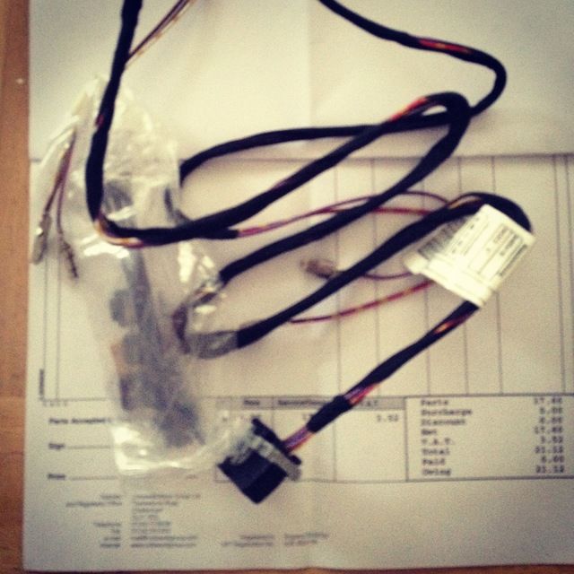

I've always been a bit partial to retrofitting bits onto my cars that were not there from factory so I've decided to give the MID retrofit a go. After a bit of research it looks like its a pretty strait forward job. The big reason to do this mod is one it is looks alot better than the standard BMW RDS and two it works alot better with the ipod connection software, Three if I ever manage to find a high obc diesel cluster that can be codded! it will show all my functions :P
I had been looking for one for quite a while but it had to be round pin to match my car. After a night of researching the "High OBC" modd I thought i would give another search and I managed to pick this up from ebay for a very good price. Really not fussed that its tape above as I only use the ipod and cd changer in the boot anyway. its really a stop gap before I find a cheap full sat nav sat up but that is a mod for another time.
Once I won it I Dropped cotsworldand they sent over the loom P/N 65129405409 if anyone is interested.
Gonna try and get it done this sunday if time permits, So I will do a how to for the E39 guys wanting to do this.
On other news now the new wheels are fitted I'm gonna need to tracking done and I'm gonna use this as an excuse to change the Bushes in the Control arms as I think they may have seen better days and change my anti roll bar links. If anyone knows if I should go OEM or Polyflex give me a shout. I have looked into both and im just weighing up if its worth me getting the stuff to fit them or paying someone to do it as I doubt i will use a ball joint or bush tool that often. or just completely replacing the arms. we will see what the wallet can provide.
I managed to test drive an M5 not long ago and was really impressed with how well it pulled the car up compared to my tiny pre faclift stoppers. I know alot of people go on about how bad they are on the track ect but my car is just over half the bhp of an M5 so they should do well with a good set of pads and some ATE super blue. So as being the bargain hunter than I am I managed to find a guy selling a full set of disks calipers anc carriers front and rear. They arrive a bit rusty but after inspection the disks are sound and the calipers just need a good clean so i've bought some de ruster and im gonna gonna soak them for a few days to get rid of the barnicles and then get some high temp paint and clean the hubs calipers and carriers up. Not sure what colour atm think it will either be black or silver.
I've got a week off comming in about 3 weeks to hope to tackle this so if It takes longer than expected I wont be without a main car.
ChiSharpe
Posts: 30
Joined: Tue Sep 18, 2007 11:00 pm
Location: Hampshire, Portsmouth
Post Wed Dec 23, 2015 2:56 pm

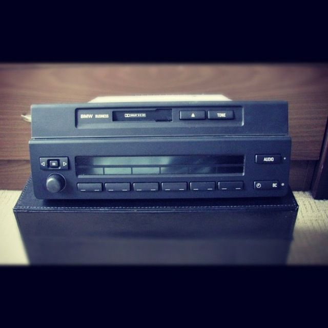

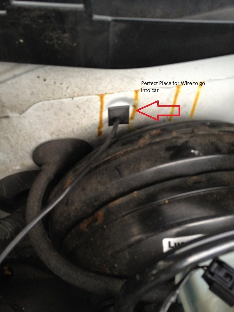

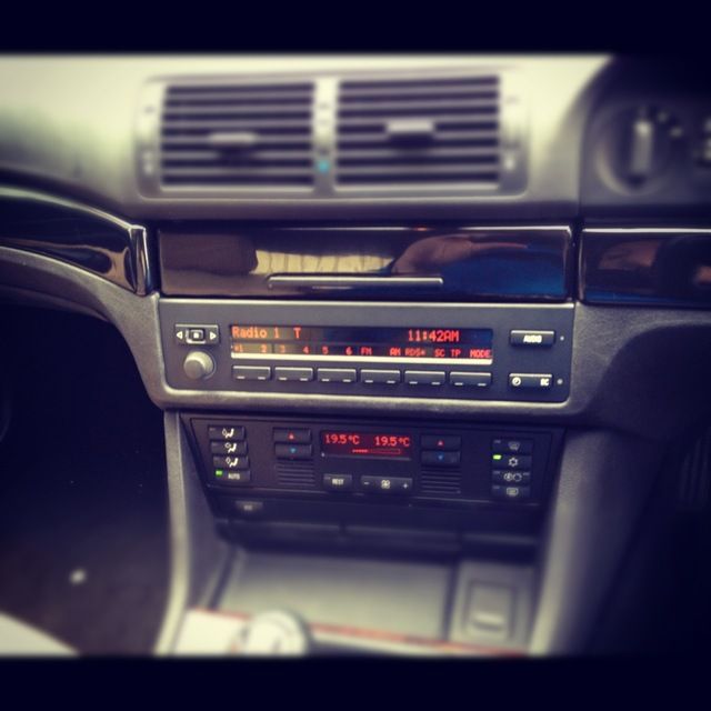

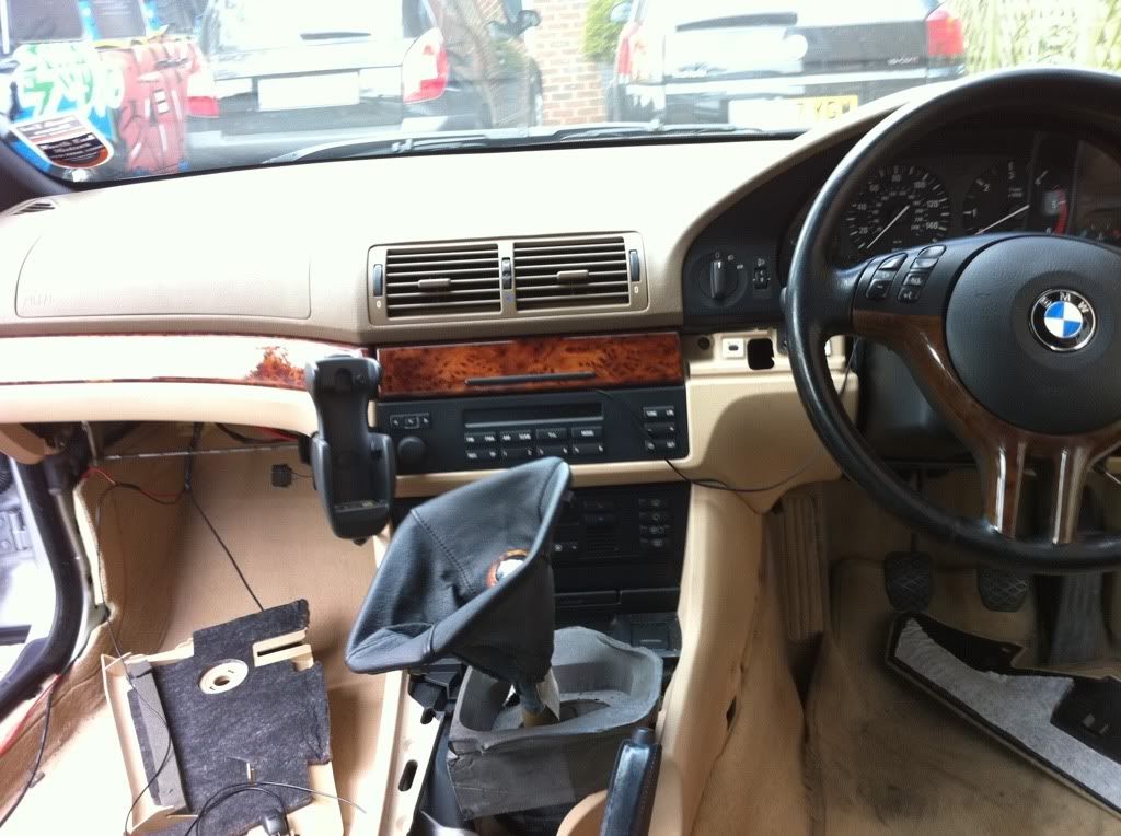

So managed to get some time to get this installed tody.
I only managed to get a few pictures as my phone battery died just after I took the stero out!
For anyone that is interested though.
I disconnected the battery before I did anything

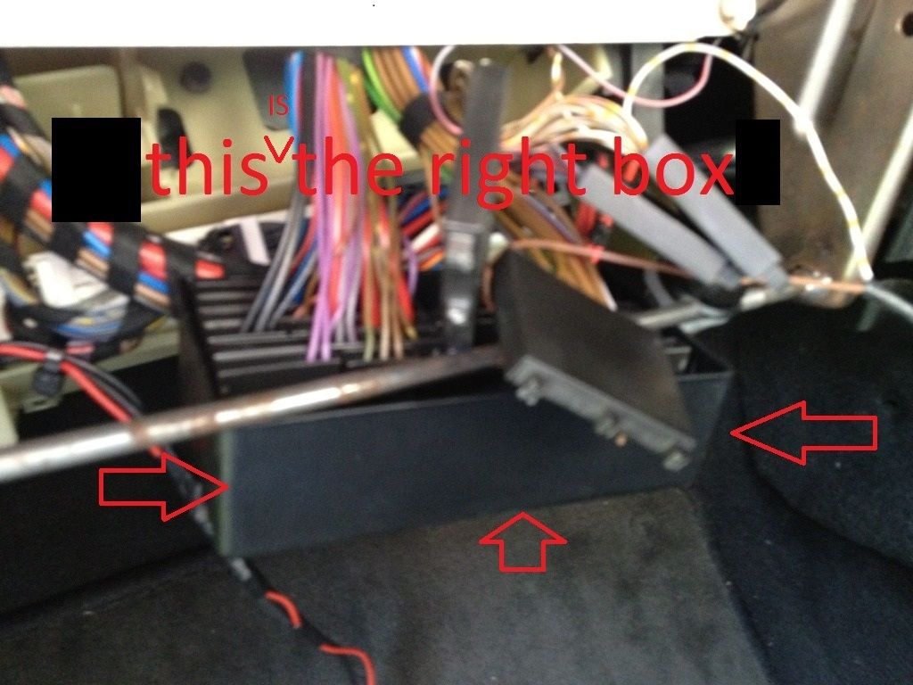

Step:
1. Remove old stereo
2. Remove carpet side trim next do passenger side right leg
3. Remove Glove Box 10mm nuts
4. Remove white/cream plastic box with 10mm and unclip from the top 2 clips this just pulls away
5. Remove big black wire box 2 clips either side
6. Look at the bottom of the black wire box and you will see the clips that hold the wires in push all 3 through and it will pull out the brown/black, grey/red and white/grey/yellow blocks.
7. Connect the 3 cables provided in the retrofit kit next in the next avaliable slot and push into place A2/A3/A4 in the retrofit guide
8. Drop the fusebox down with the two white clips. Remove the fuse box clips infront of fuses 10 & 35
9. You now need to fit the two last cables into fuse 5 & 6 (in my car fuse 5 was unused where as fuse 6 was being used) when you look at fuse 6 the bottom metal connector is being used but the top is not. I did try and remove this but it would not budge so I used the wire crimps that come with the kit. To do this I got my wire stripper out and stripped just enough to clip it in. Fuse 5 uses the violet/brown cable just slot it in the then use the 5amp fuse provided. fuse 6 is now connected and now you can plug the 30amp fuse back in, itshould be green
10. Thread the top of the cable up through the bulkhead into the stereo area.
11. Connect the top stereo back in with the old cables for your RDS stereo
12. Connect the bottom mid unit in with the new cable
13. Put eveything back in reverse of how you took it apart.
14. Connect battery back up
15. Turn on stereo and check its got power.
16. Code the unit to the car. To do this connect car to DIS, Ignition on, select Coding ZCS, Choose E39, Retrofit, Radio with MID this will take about a minute, Ignition off 10 seconds, back on and all should be working perfectly!
All done and im very happy. it looks loads better than the standard unit and now I can get my new Ipod connection and get the songs to come up.
Up next M5 brakes will try and do a proper picture write up for that one.

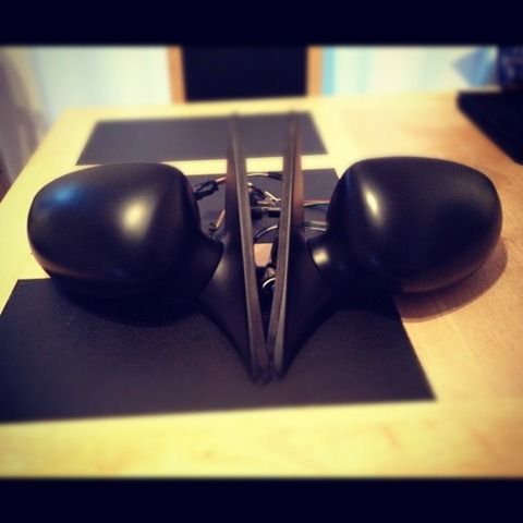

More cheap Chinese plastic. Sold my Genuine M5 mirrors a while ago then I got a pair of second hand non genuine but they had some damage so I sold them on and have bought a new set of non-genuine. The main reason I went non genuine as to me they look exactly the same apart from the part numbers. These are also auto folding so will be on the lookout for an electric door loom if anyone knows of one please let me know.

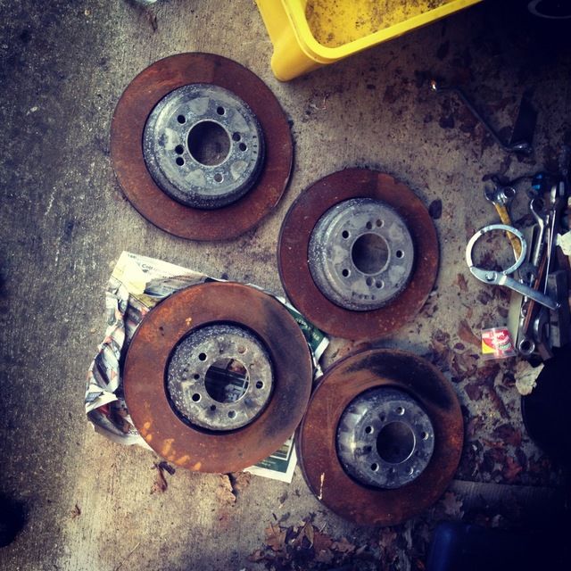

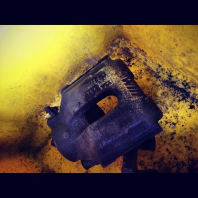

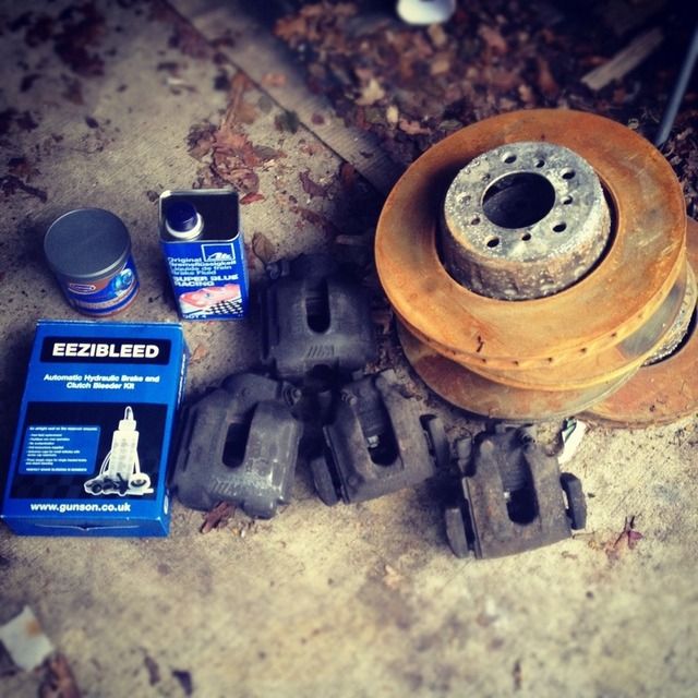

I've also managed to source all the parts to fit my M5 brake set up to the car. I managed to get a set of genuine BMW pads front and back for 60 quid from a lucky ebay find! I was gonna go Yellow stuf and pagid rears but I couldnt turn down such a bargain and these pull up a 400bhp M5 so im sure they will do the same for my 230bhp derv. so there stting in a box in the boot waiting to be fitted tomorrow hopefully!
I did managed to drop these in rust remover which did a great job but soon as you take them out they rust strait away again so im just gonna hammermite the center bells and the calipers. I went for the eezibleed & superblue as I dont want to mess about with the brake bleeding and from what I've read online it makes it a doddle especially the brake fluid being a different colour when changing.
Got a bit of a question to anyone reading this for when im removing and fitting the calipers. Should I put the eeasibleed on first or just remove the cap and change them all over then fit the eeasybleed and bleed the brakes.

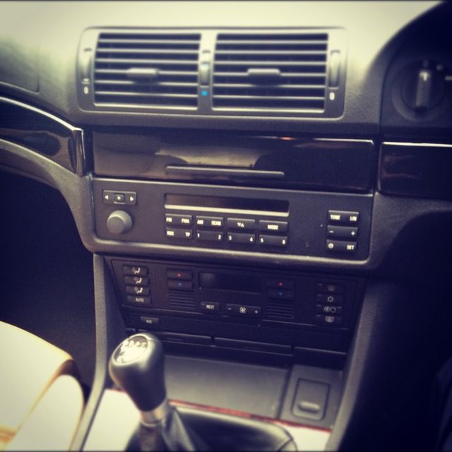

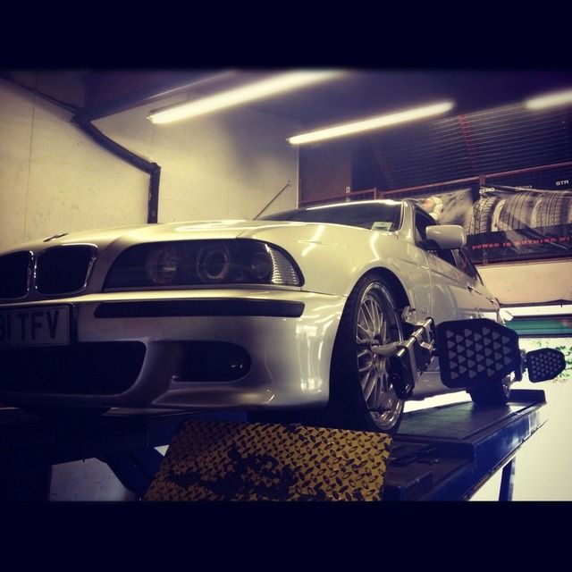

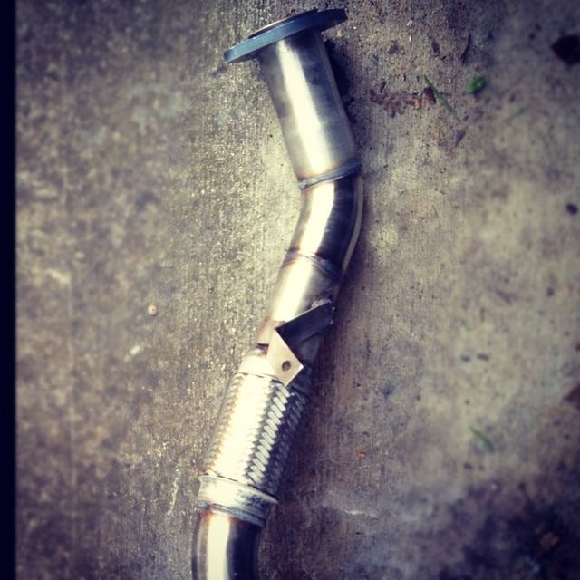

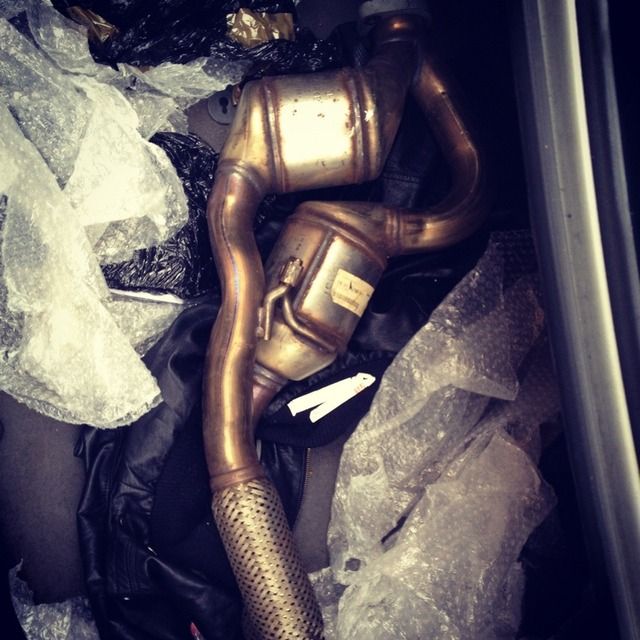

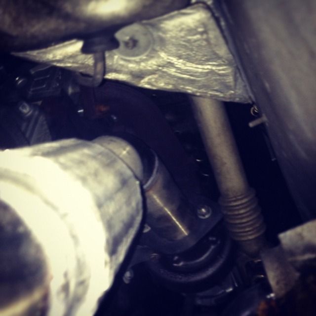

Well I thought I would give it a try and fit both the Decat and the powerflex bushes myself. Well what a failure! I couldnt get any leverage on the bolts near the turbo I needed it to be up on ramps and a breaker bar no matter what I did it would not budge and I didnt feel too safe under the car really going for it. So I called it a day and thought I would leave it to my mech. Next up the bushes I got one of them ball joint splitter things from halfords and went to town no matter what I did I could not get either arm out! in the end I got so frustrated I just left the car there no wheels on axle stands tools everywhere and went inside for a few hours to calm down. after some time I decided I would give my mechanic a call and see what he thought. He said its a pig of a job to do with the right tools if your trying to use the same arms again so I decided the car had beat me and booked it in with him.
First up fit the decat.
You can just see the new turbo at the top of the picture
Here is the old cat
The car looked in very good condition tbh. Even still had the bmw sticker on so I would think it has been replaced at some point in its life. It also gave me an opportunity to tighten up the bolts for the heat sheild on the turbo as I could hear it vibrating on low revs from pull off and was driving me crazy! im pleased to say that has completely gone now!
While under the car I had a good look over and all seems to look very good I also wanted to get a look at the prop doughnut which almost seemed new It probabily needs taking off to get a good look but I've seen some really fucked up ones on other bmws and im not getting any virbrations or clonks so im sure its fine for now.
So took it out for a test drive AND...
.... I noticed fuck all apart from a slight difference in pitch from the turbo lol :) to be fair my car feels rapid and pulls all the way to the redline very well in all gears so we will see how the mpg fairs over the next few months but im happy with it as the cats are restrictive so a improvement in breathing should help.

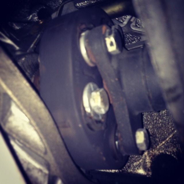

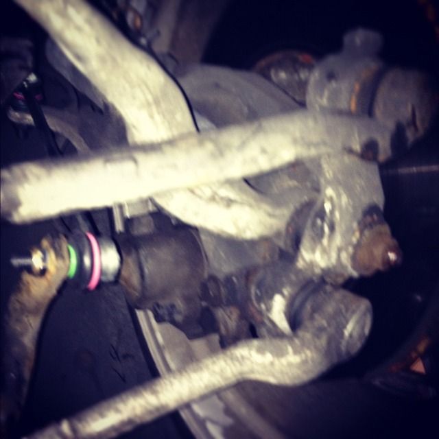

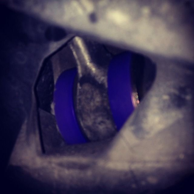

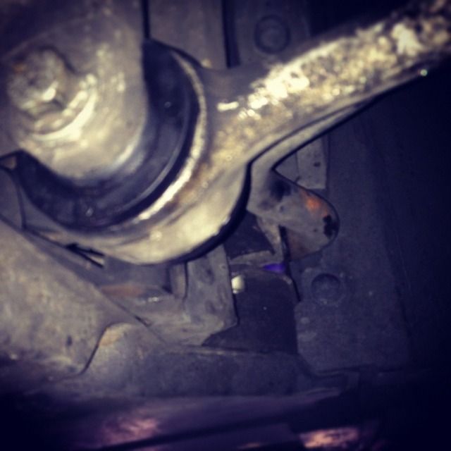

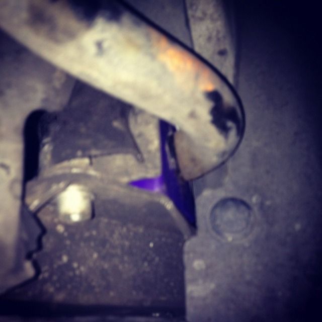

Next up was fitting the powerflex bushes.
Now I had a problem when calling powerflex BMW snows had told me my car uses 23mm anti roll bar bushes. So when I called powerflex they said they dont stock them for e39s but they do for the e46 so I ordered some on the word that I could send them back if they didnt fit.
I spoke to my mechanic about how these were to fit and he said I quote "if you get a new car dont fucking bother asking me to do these again just buy the whole arm and be done with it!" apparently someone had had these out before and done something that made it alot harder to remove the arms and not ruing the ball joint at the end. anyways once off everything went smoothly and he said the bushes were a doddle to fit once the arms were off and said he was very impressed with the way they were set up not having to pre load them.
Thrust arm
Control arm
Anti Roll bar
Tsr Drop Links

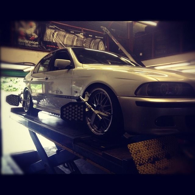

So after this the car needed to be set up again. I went to my local who have a hunter machine. They were very nice but clearly not interested in setting the car up handling wise and just doing it to the BMW standards which I totally understand. As I said to them "Im having some overstear on the car and a bit of rear sliding can you improve this? and I was met with blank faces. I've done a bit of research and it looks thorney motorsport have the pedigree to do this and the equipment so once I have a set of decent coilovers I will go down and really sort the cars handling out.

Just to keep this up to date.

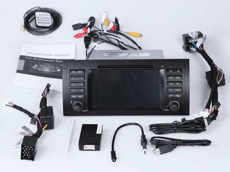

Ok so I have not been happy with my headunit for a while as it doesnt have touch screen, does not play dvds and doesnt do nav!
I have been looking at getting a head unit that did all the things I need over the past 16 months since I got the car. I knew I wanted something that looked oem and the double din units just dont look right in a system to me. I know they are about 100x better than these chinese units but for me its more about looks than sound and these units can be linked into subs, processors and amps ect to improve the sound volume and quality if thats what you desire.
I really liked the features and support of the dynavin but the price and the old 6" screen looked frankly shit so that was out the window. The hauligan or whatever it was called was fine but didnt really look that oem for me. so there was nothing really on the market. Fast forward early 2012 and the Dynavin brings out a new unit.
now with a 7" screen looking alot better and this unit now even comes with android so you can browse the internet on the go or play angrybirds! unfortunately 699 pound price tag was a little bit too much for me to swallow. especially as the warranty is only 1 year ok there is continued support but it doesnt seem like alot and they have not had alot of updates at all. so back to the drawing board.
As some of you may have guesed from my name I have some chinese heritage (from my grandfathers side) and have some cousins and family over there. A while back speaking to my cousin about my new car he told me he had just got hold of a dynavin clone for decent money for his E46 from one of the local companies. I asked him about e39 but he said they all had the 6" screen so I didnt bother. he then facebooked me a while back and said they were now doing 7" screens with android! quick how these chinese catch on!
He put me in touch with the supplier and from what it seems the Dynavin and Chinese units come from the same area just the dynavin has just got slightly more support and has been marketed well. So I asked my cousin to buy one and send me one of these new android units for a much more decent price.
This is a picture of the unit. obviously very OEM in looks and similar to the dynavin. I have ordered it with DVB-T, Wifi & 3g Dongle and Reverse camera.
The company itself offers a one year warranty with the unit which isnt bad and I feel alot safer about this as my cousin has actually been a customer and has had his unit for well over a year now and it works flawlessly.
Full Digital LCD, 800x480 resolution, GPS Function, FM/AM Tunner(RDS), Bluetooth Funciton, IPOD Funciton, Built in DVB-T TV receiver Function,SD Card/USB.
Same as the Dynavin.

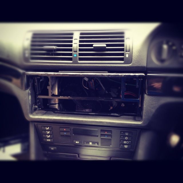

had a chance to play around and get more installed today.
First impressions of the unit as its quite feels well built if they can? the way they are made look the same as the Dynavin the buttons look and feel very good and dont feel cheap. it was packaged extremely well as my cousin just added the outside box. instructions well there are none for fitting you just have to learn by doing. Its pretty simple if you have ever fitted a stereo yourself over the years I have fitted quite but its pretty much plug and play.
Loads more to do with this regarding fitment but I am very happy with it.

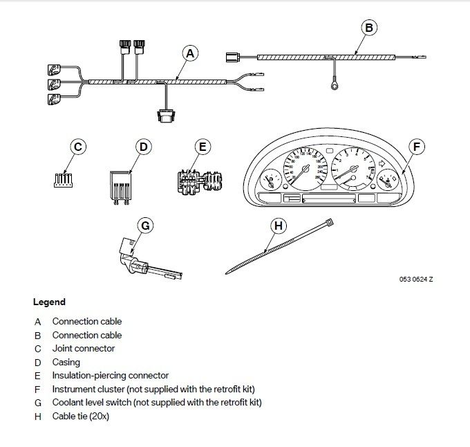

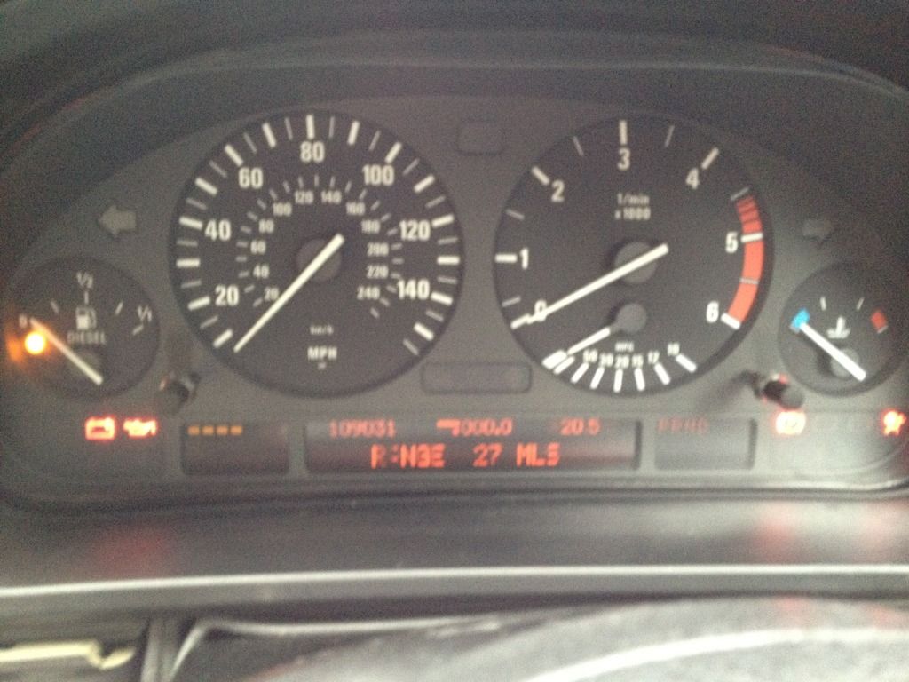

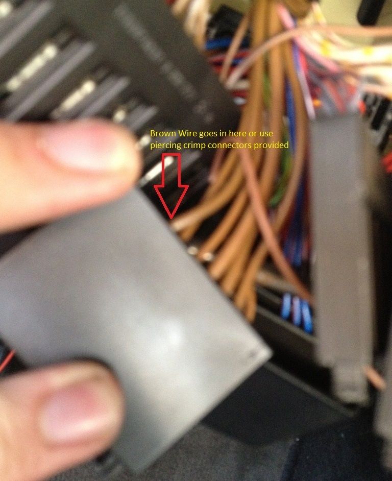

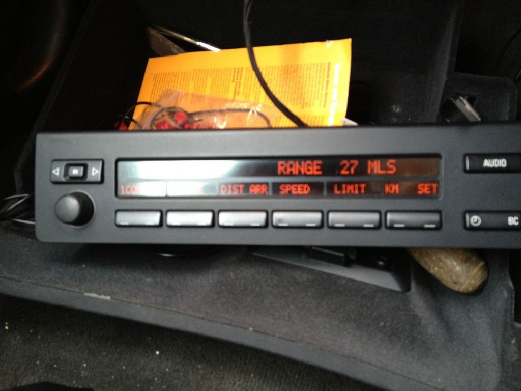

igh OBC Retrofit.
Been wanting to do this for ages. As I who wants low obc lol
Thought I would write this up as anyone attempting this and is a complete novice like myself this will definately help you! First you will need to find a cluster that can be codded or buy a new one from BMW the cheapest I could get one after ringing a bunch of BMW garages was 400 pound obviously if you want to spend that kind of money on a car that is 12 years old be my guest but I cannot justify this kind of outlay just for high obc. if you go with a used cluster this is apparently a bit of pot luck it took Rob 3 clusters to find one that the mileage could be codded on. As for me I actually bought jimmys and it had 109500 on it and mine has 110100 on it so no need really here for me to mess about with mileage. What I will need to do is code the car so it knows im using high obc and remove the tamper dot.
Ok so to install first things first you will need the 4 things.
1. New or Used Cluster
2. Retrofit Kit 65 90 0 308 455 (about 50 quid)
3. Coolant Level Sensor (about 10 quid)
4. The High Obc Guide printed off from here http://forum.bmw5.co...ul-information/
Ok so once you have go this its time to get to work. Remove the - from the battery and make sure you dont lock your keys in the boot!
1. Remove the Trim around the dash.
2. Remove the your Exisiting Radio & disconnect
3. Remove the trim around your Cluster its uses a very small Torx screw
4. Remove screws holding your cluster in
5. Remove your cluster by putting the steering wheel the lowest it can go. There are two 26 pin connectors at the back remove these and it will just come out. Keep this aside for now.
6. Remove the glove box
7. Behind the glove box is a big white plastic mount with lots of wires and fuses going to it you will see a black box connected to this. This is the "joint connector box" named in the retrofit Instructions. unclip this for later.
8. Remove the trim below the steering wheel where the "gong" is located.
9. Open the bonnet and then remove the bonnet opener and boot opener trim behind this is the LCM or light control module.
10. Take off the Drivers side microfilter. Under it is the brake fluid the should be a couple of rubber bungs. I used the top one and removed it.
Ok now you are ready to install the loom.
Connect the 3 connectors to the back of the new high obc unit. they are colour codded blue white and black A1 A2 A3 simple! Put the two old cluster connetors into the the connections provided branches A4 & A5
2. Thread the two wires from the loom through the dash past your radio unit and down into the glove compartment and thread the gong cable down the steering column and put it into the other side of the gong.
3. Ok so we are now down in the glove compartment. Remove the I & K bus connector block from the big black connector box these are clipped in from underneth. look under the big black box and you will see how this works. The K bus has White Red Yellow. I Bus is White Grey Yellow. Now what is says in the obc instructions about the "E39 cars only" is COMPLETE BULLSHIT its actually the same as the E53 model. disconnect the Ibus cables from the connector block I had 2 cables that were ibus the rest were k bus. and now connect these cables to part C in the picture above and also connect your ibus cable from the retrofit loom this and put the casing part D in the picture above. this is done so that you seperate the I & the K bus so that the low obc doesnt talk to the high obc anymore and there is less chance of errors. im pretty sure the K bus is low obc and the I bus high obc
4. now remove the only all brown wire box inside the big box of connections and if there is space install the new wire. If not use E from the picture above pierce the two wires together. I would assmume this is a ground but im not sure tbh.
Now go stop give youself a pay on the back you have just fully installed the loom.

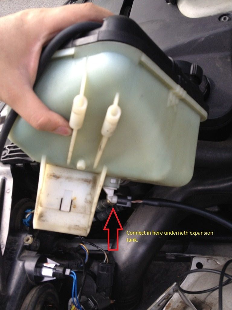

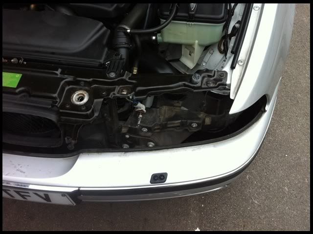

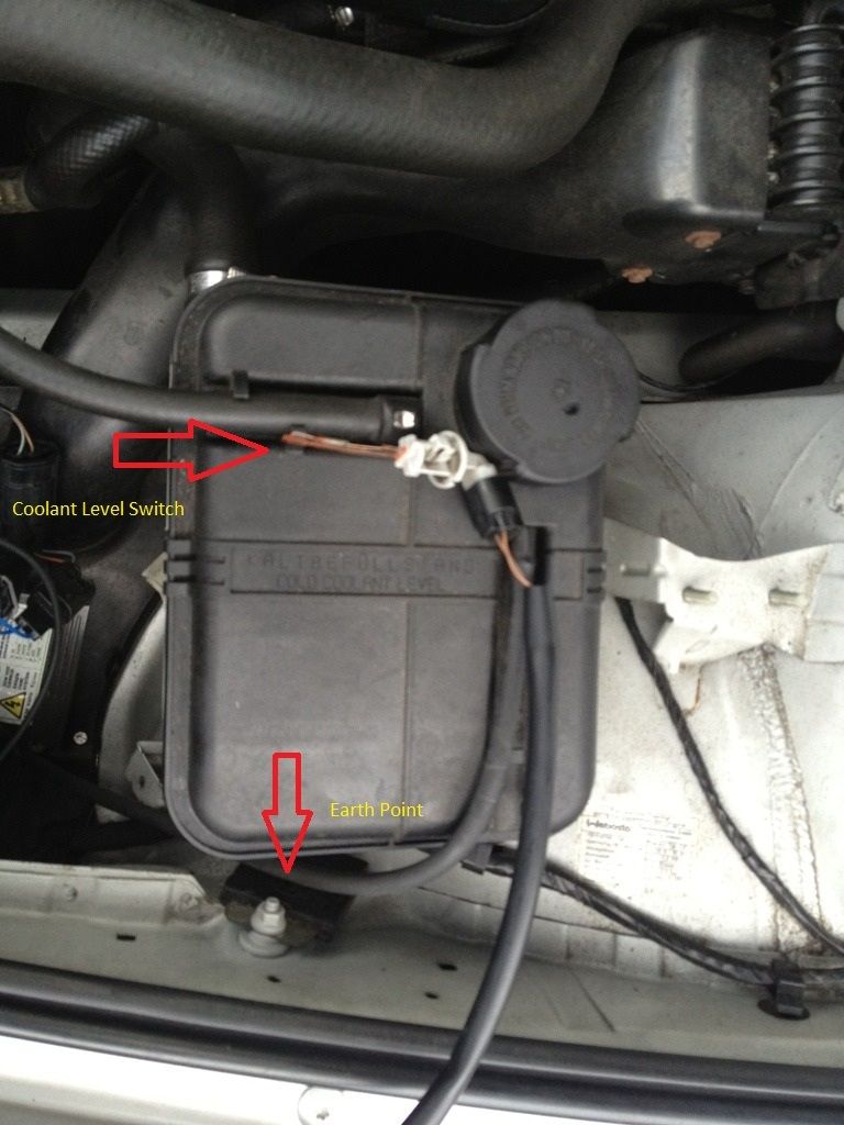

5 go into the engine compartment. im going to talk about the 530d side of things this is slightly different but you will get the idea.
6. Remove the expansion tank and look underneth you will see the coolant level switch fits perfectly one way and just twists in. now connect the cable to this.
7. right next to the expansion bottle is in earth point in the 530d connect the circle earth cable to this with the bolt thats already there.
8. run the cable along the slam panel from the passenger side of the car down the drivers side wing and to where the brake fluid is kept. there will be a bung here. remove this cut a hole in it and thread the wire through.
9.now go inside the car and find that wire its pretty simple if its daylight as you will see the new wire easily.
10. remove the middle connector to the LCM module this is a 54pin connector. work out how it comes apart. its very easy. the white bottom bit slides off and you can just remove the blue block inside. the blue block splits apart. and you will see there are 18 numbers on each blue block. find number 24 and put the wire into it.connect it all back up and plug this into the LCM module again.
Some pictures to help you where I think its needed.
Ok so now your are completely done. if your using a used cluster. I would put the battery in and test to see if everything is working as it should. like so.
Hopefully your cluster pixels will be better than mine for a tenner and the right mileage I really cant moan Just need to get the pixels done which will be my next diy.
As you may notice my MID panel is on the glovebox. this is where it will stay now as I have aftermarket nav and it doesnt connect to the obc. but I still want to be able to use the functions. and if I ever find a cheap genuine 16:9 nav I would probabily do that retrofit aswell.
The next bit is coding and Im gonna need some help on this from rob so as soon as I have I will update with all the information needed to help you guys tackle this.
Thanks
Chi.

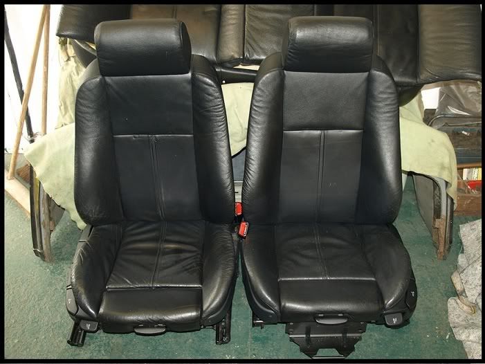

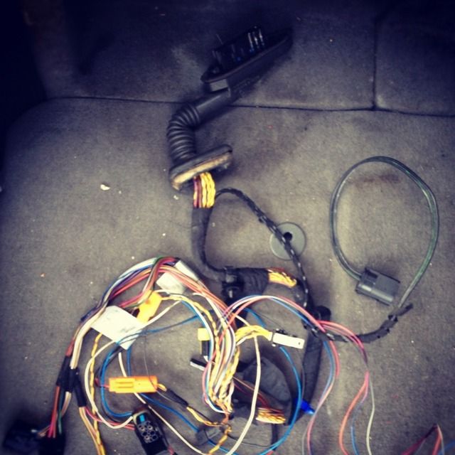

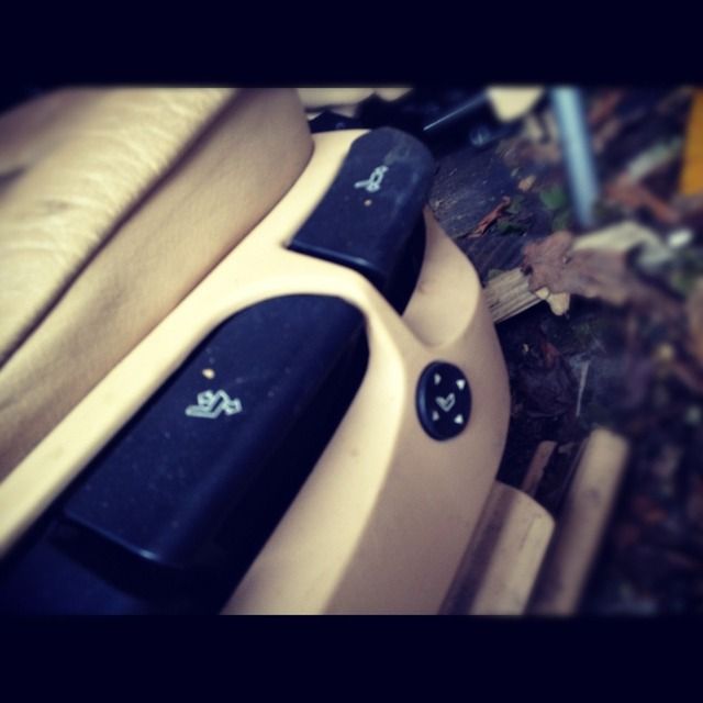

Next on my list I have been gathering parts for a massive retrofit to my seats/electrics. When I bought my current electric sports seats I just hard wired them in with and didnt bother doing anything else thinking that would be fine. but after seeing what they can actually do I've decided to retrofit them in fully so I can have the Memory function and also have heated front and rear seats, Lumbar support with auto fold mirrors.

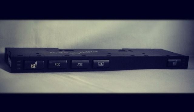

I managed to source the drivers door loom
Switch pack. I got one with blind and front PDC as I already have an electric blind ready and waiting to be installed and I would like to retrofit front pdc. Its not too hard at all as long as you find the right module and get the retrofit wire for the sensors which is about 80quid.
Obviously getting them working involved some wiring im currently researching into making my own wiring loom up as bmw charge 60quid just for the heated seat loom. as for the memory that you have to do youself but raymond has put up a very good guide on 5.co.uk which looks pretty simple just time consuming. Iv also got a swich pack and all the bits so I can fit up the autofold side of the mirrors.

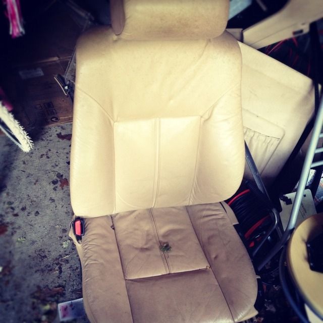

After seeing trisman had a set of lumbar adjustable heated seats for sale for a very cheap price I nipped down and picked them up on a cheeky sunday. The seats were out of a 535 drift car so you can imagine they have not been leather fed so they will be treated and sold on but the heated mats and lumbar support will be retrofitted to my rear bench and front seats.
looking to have my set up just like this
http://forums.bimmerforums.com/forum/sh ... ?t=1324132
Obviously as I will be ripping up the carpet and laying lots of wires and taking all the seats out ect I want to gather all the parts first then have a full couple of days getting everything fitted and working.

Really cannot help myself. Bought these on a late night on ebay. they were very reasonably priced came in the right colour, added the extra lumbar support I was looking for an also had all the memory bits to make sure I can get it wired up. Just need a leather center console now and I will be happy.
Has really changed the feel of the interior. I have always loved the two tone but on silver it just doesn't quite work compared to the darker colour cars.
Next on the list is to get the memory parts finished and sort out my new switching panel.

The ones above are m5 seats heated with lumbar. I never got round to doing the rear heated pads but they were out of a front set that I gutted.

Ok so some of you may have seen I have a set of M5 seats which are already heated. now BMW want 60quid for some wire and connector which cost me a total of 6.99 and 25 mins in my scrap yard.
This write up is for anyone who does not want to pay a fortune for something they can make themselves with a soldering iron and some time and also has the heated pads inside their seats. if you dont you will need to look at Liams thread.
all the bits can be had out of a breaking BMW but there are 2 connectors that I just could not get hold of as I kept finding cars that were pre facelift. if you want to do this cheap you will need to find a breaking BMW. if your gonna buy the parts from BMW just get the loom yourself.
Ok step one go to a scrap yard and equire these bits.
Part 1-4 can be had at most places in the car but the part we need will be connected to the fuse box under the drivers seat while your there in the fuse box get all of these two parts aswell.
Part 8-9 in the picture.
Ok from the picture above we need 4 different 61130007257
part 1 61130005197 is all over the car pretty much connected to every block from the cluster to the lcm ect just cut a big lump off. we need this for the yellow seat plug connector and the switch panel you will need about 12 of these just in-case
part 7 61130007257 this is used for both the seat connector and switch panel you will need 4 of these i couldn't find these anywhere so got them from BMW for pennies
part 8 I could not find the part no for this for love nor money and finally got it from BMW head office and they sent me one for free but its pennies as well 61138369644 this part provides power to the switch panel
in the picture above we need part 2. we only need a couple of these but just grab the whole fuse panel from the glove box as im sure it will come in handy for another retrofit.
now while your at the car there are two long looms that run the length of the car. rip these out and take with you this should be well enough for any wire you need.
I paid exactly 5 pounds for all of these bits from my local scrappy. Told them i took it out of a rover lol. and the rest of the money was bmw for the little bits I couldnt get.
Ok so this is how you wire the bad boy up.
Ingore the fact that all of the wires cross over each other. each wire is separate to itself if you get where im comming from. if you dont just ask.
I will add more pictures ect this weekend once I have started to fit the loom.
Chi.

I was having a look last night and found the US thread where a guy fitted rear heated pads from an E38 rear bench, looks a perfect fit
The one thing I want to get done is a DAB radio add-on that works with the standard head unit/display. Cant be arsed with all the android/internet daftness tbh
