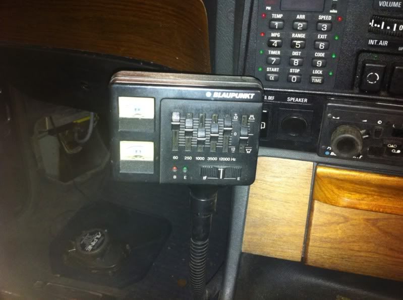

Amazingly original down to the mental Blaupunkt radio/cassette with stalk mounted remote control/graphic equaliser - with manuals.

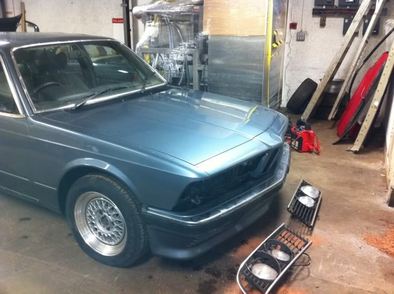

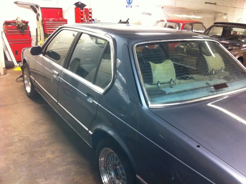

Here's a few photos:-
It's amazing. It's a real time warp car and the standard of the bodywork restoration is astonishing.
I've only had a quick look, but it looks complete and fairly easy to put back together - just like a bigger six series.
And Christ is it big?!

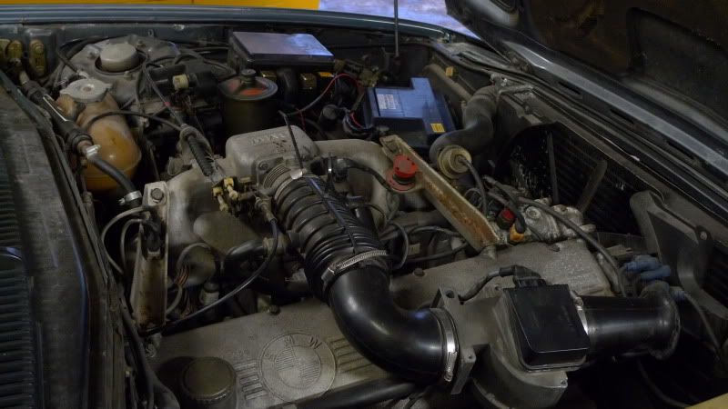

Whats she like under the bonnet? And if the guy knew what he was doing, why was it never finished. Sound like theres a story behind it?

Under the bonnet is clean, but dusty. In terms of why he didn't finish it, his painter did this car and then killed himself - nothing to do with the car I'm assured. He just doesn't have time. He runs this:- http://stewartwalkerltd.co.uk/ by himself. No staff. No employees. He does all the non contracted out work himself. I'm certain, having spent a couple of hours with him that there is no story attached to it, other than what he says.

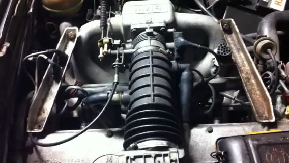

Well it runs. Very smoothly too actually.
But first, some more, decent photos as requested:-
There was no fuel at the fuel rail, in fact the fuel feed had been disconnected at a strange late 80s catalyst type of "bomb" thing used as a snake oil "cure" for unleaded fuel. Bin that and go foraging for a length of fuel pipe to get it connected at the fuel rail. A dead 320i convertible sacrificed the necessary length of rigid fuel pipe and the fuel lines at least look pressure capable.
No fuel when cranking. Bugger. No fuel when shorting out the relay. Hmmm. Nice healthy bright bulb on the test lamp at the fuel pump connections. Gotcha.
Fuel pump replaced with an known good E24 one and fuel at the rail with the relay bridged and with the relay in place and engine cranking.
When I say fuel, I mean varnish. About three gallons of the stuff pumped up and into a jerry can until it ran dry. It was a real murky, dull brown colour. Tank empty. Fuel filter changed. A gallon flung in and pumped straight back out to flush it through and then a full jerry can emptied in. I remember filling that can, not *that* long ago and thinking, "Bloody Hell! £14!! That's damn near £3 a gallon." Today? £26.
Success. Nice clean clear fuel into a glass Irn Bru bottle to check first and then at the fuel rail.
Check oil. Plenty and clean. Put some coolant in. Connect up the power pack and let's see what happens.
Nothing. Well lots of spinning. No firing. Stick a plug on a lead on the rocker cover. Nice big fat spark. So we have fuel and spark, but no startee.
It's spinnning over very slowly and the plugs are rank. Stick a set of plugs in it and that's me for the morning as an M20 needed a belt and pump.
While waiting for Euro to deliver said belt and pump, I decide that I might as well buy a new battery for it. It needs one anyway. Phone Euro and the boy on the phone says that there are none listed either by chassis or registration number and the car must be too old for them to stock a battery.
"OK, I'll get one locally.". Within 3 minutes on Euro's website, I've got the part number and phoned him back with it. 17 in stock apparently! It arrives just before 1.00.
By 2:30 the M20 is off and it's time to get this thing running. Battery in. Spinning over at a good old rate, but not starting. Not even firing. Spark and fuel, but no combustion.
Compression test is next on the cards, but I decided to ply it with a quick score of "Easy Start" to see if it fired. It did. Compression test not required fortunately, so injectors are now the prime suspect. Hide the "Easy Start".
Plugs out. They appear dry. Looks like the injectors aren't firing even though they have power.
ECU not sending the injectors a pulse? Swap out a known good one. No difference.
Hmmmm. With a hammer and long extension, I give each of the injectors a couple of good sharp taps. It fires. It even runs. Momentarily. On three, maybe four. More injector tapping and half a can of carb cleaner rammed down the throttle body get it running at idle speed. It won't rev and only the front three are firing. The back three are dead.
Cleaned every electrical connection with cleaner - sensors, AFM, injectors, HT leads. Everything. No difference.
Swapped out AFM. No difference. Decided to bin upside down AFM and cone thing and fit proper filter and airbox. In doing this, I see the AFM is fitted backwards. Shouldn't really matter, but I put it all right with brackets, airbox and air filter as it should be.
Wrong:-
Bolt it all on and this is the result:-
Right:-
[youtube]http://img.photobucket.com/albums/v296/ ... c8ea06.mp4[/youtube]
I'm not yet convinced that swapping the AFM round did it, I think the AFM connections were possibly ropey, but it's running anyway.
It's also dropping ATF on the garage floor - from the steering box I think.
Bugger.

Ah. Motronicsaurus Rex. I have a wiring diagram for it, written by some 'Shakespeare' geezer. Did he work for Haynes once?
Anyway. The injectors run as two pairs of three. All have a common 12v from the ECU (red/white from terminal 87 on the five pin DME relay), but three of them have a signal from terminal 14 on the ECU (brown/white), and the other three have a signal from terminal 15 (brown yellow).

Over the years, I've found myself on Rick's No Start Shark Homepage a few times and prehistoric though it undoubtedly is, Motronic is fairly simple to diagnose.
My recollection was that the injectors were fired by two separate feeds, but were grouped 1,3 5 and 2,4, 6 and that's what made me doubt it was the ECU.
I was getting cylinders 4,5 and 6 absolutely dead - removing the HT leads and injector plugs made no difference to the car's "idling". I thought I had it when I pulled off the earths at the fuel rail and they *seem* to be grouped 1,2,3 and 4,5,6. They were a little furry and I cleaned them up and replaced them, but no definite improvement. I think the injectors were all bunged up with crap, old fuel and just sitting for years - see below - that they were sticking. A good rattling, carb cleaner, earths cleaned and it appears good to go.
Swapping the AFM round and binning the cone for a proper airbox is what did it, but in reality, it probably wasn't. It was probably a combination of a number of things and they've all been fixed, but I can count on the fingers of one finger the number of times I've had a motronic car with fuel and spark and compression, refusing even to fire.
