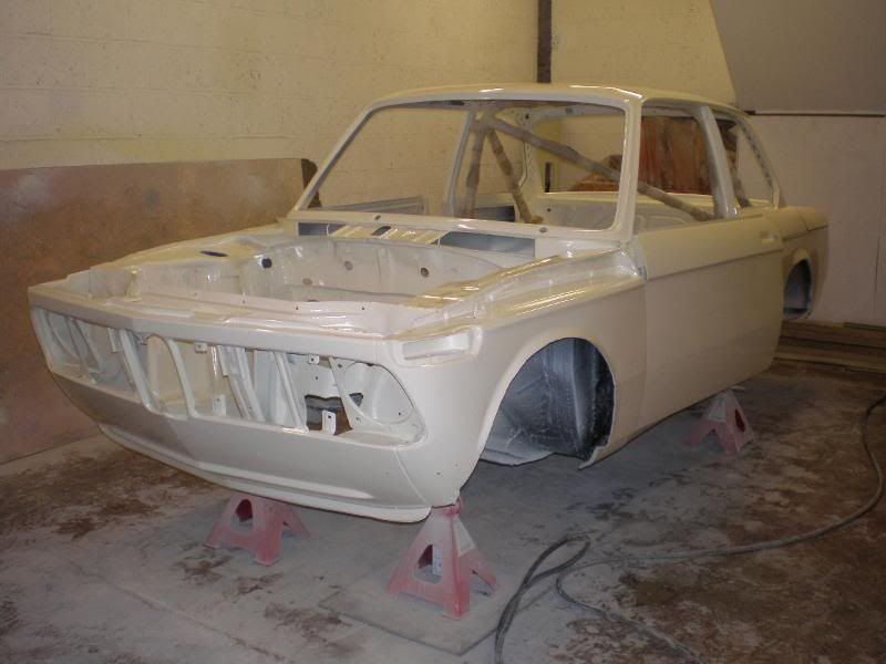

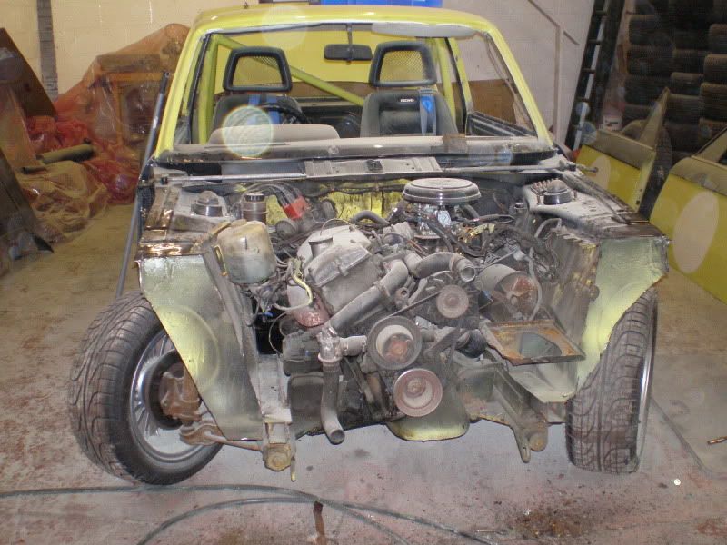

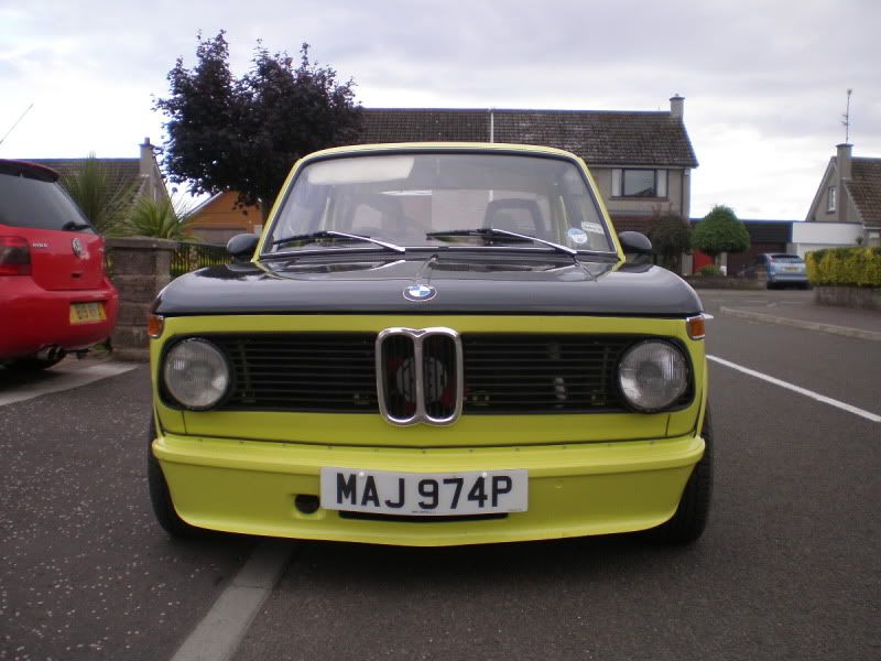

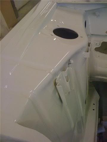

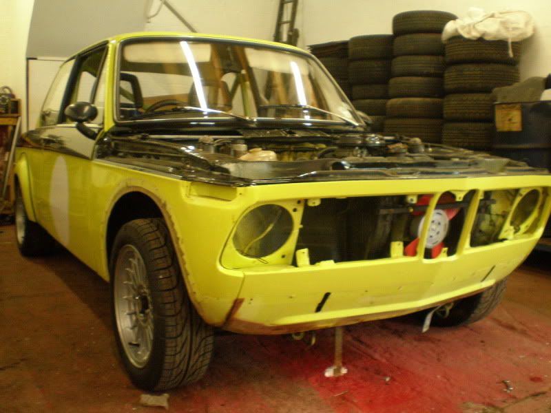

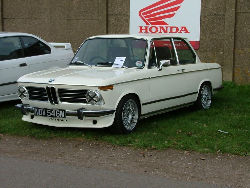

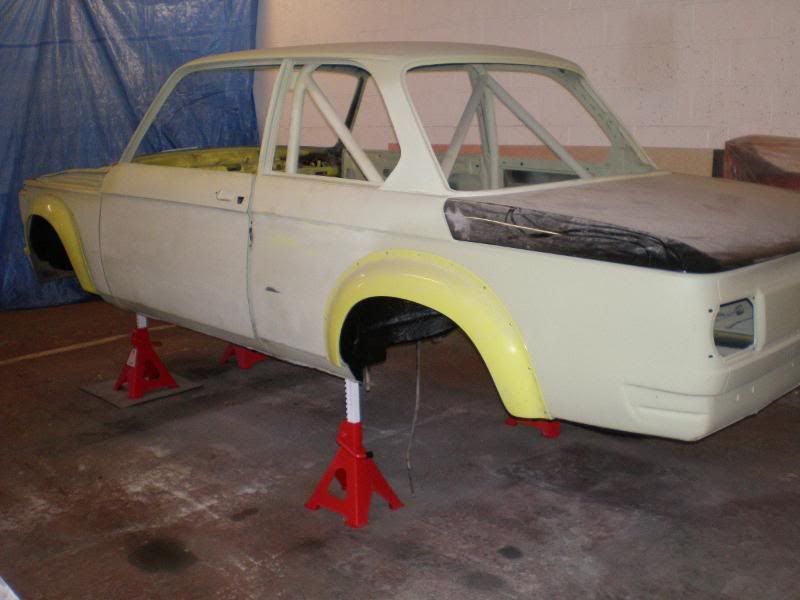

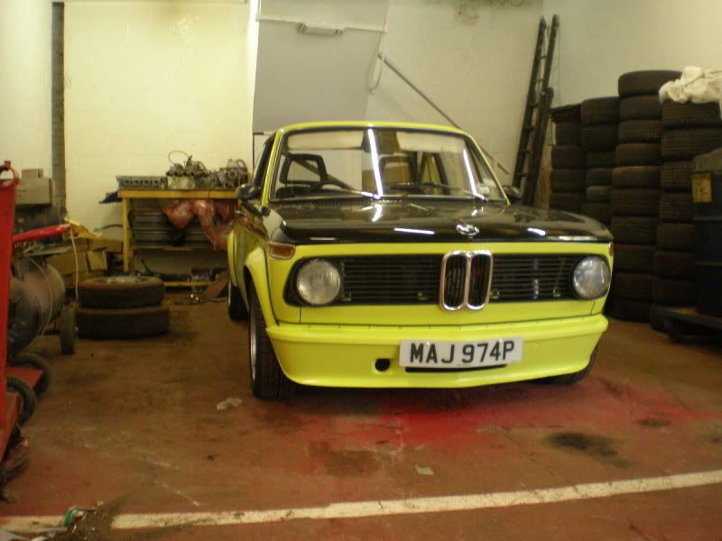

hi guys , just wondered if you lot would be interested in my old 2002 project car? il post up a couple of pics from when i got it last year to how it is now and if your interested il fill in the middle bit later on for you

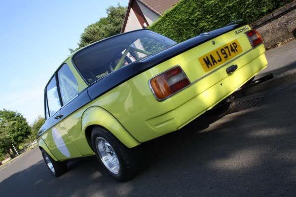

when it was bought summer last year.....
and a year later.....
clearly alot of inbetween stuff going on so as i say if enough interest i will do a full right up

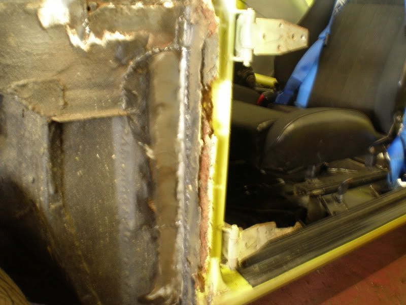

right guys..... im not going to right up a big story as this will take ages with the stage im at now. il post up the pics and they will more or less tell the story....

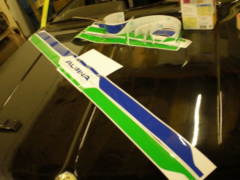

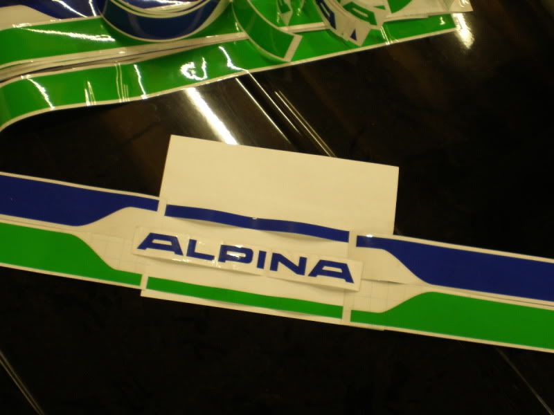

the change of colour......because it is having the green and blue alpina decals on it.... looks best on white imo.

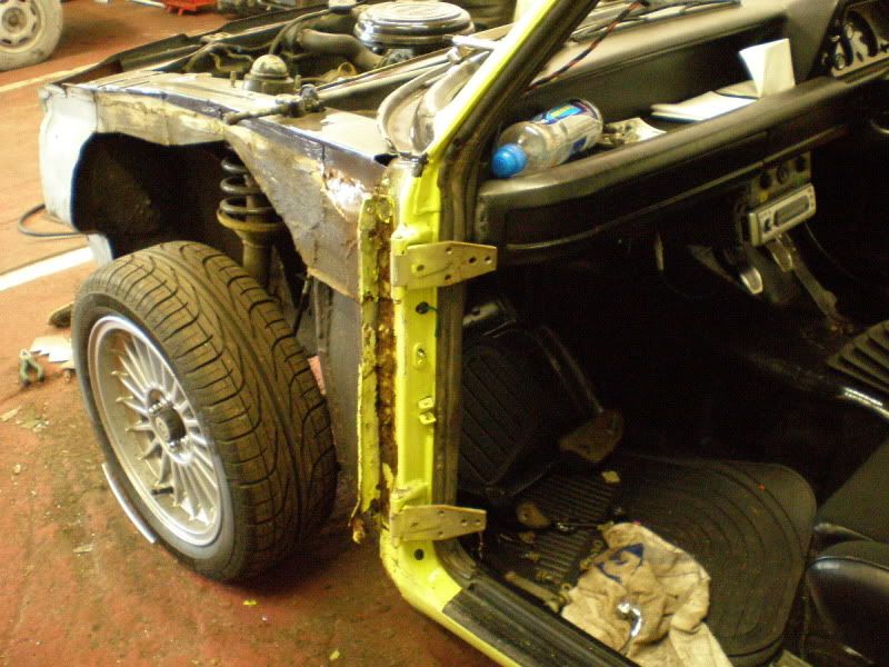

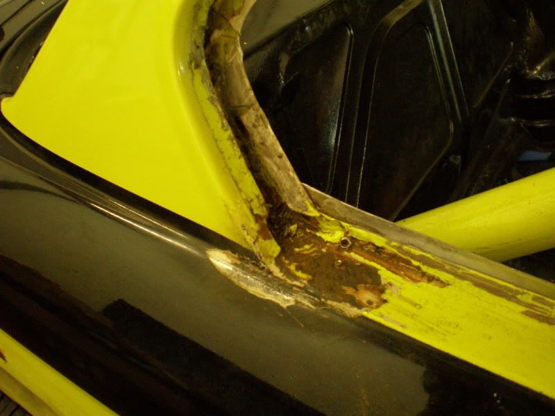

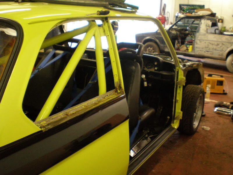

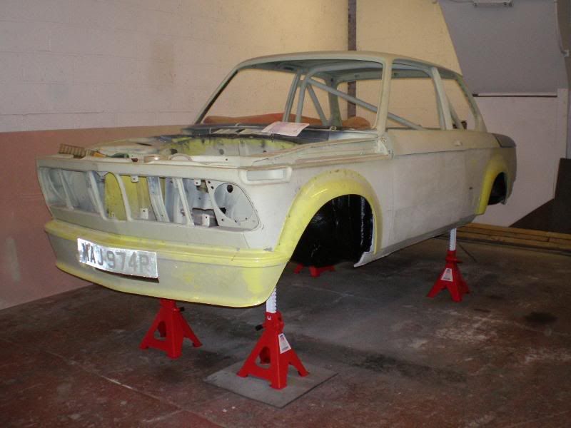

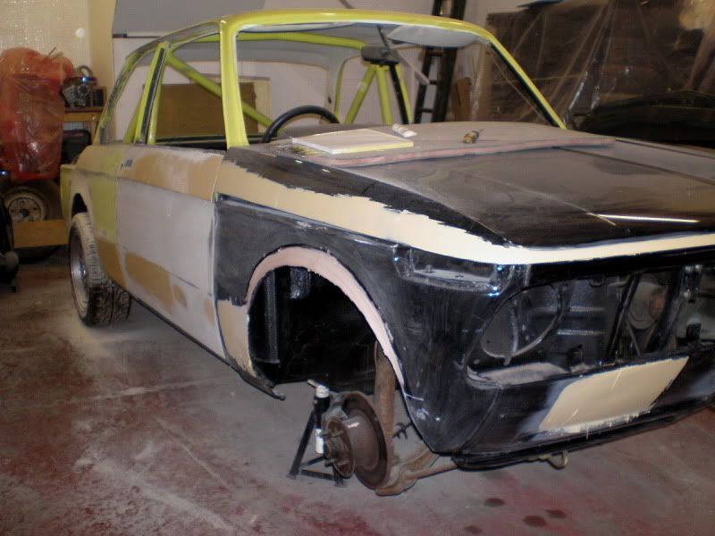

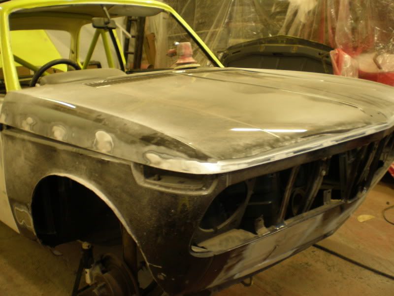

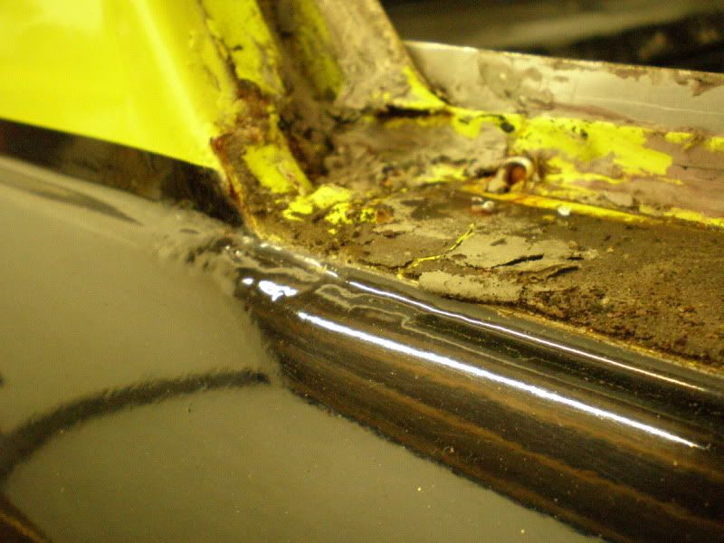

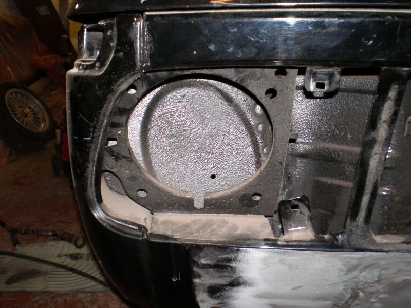

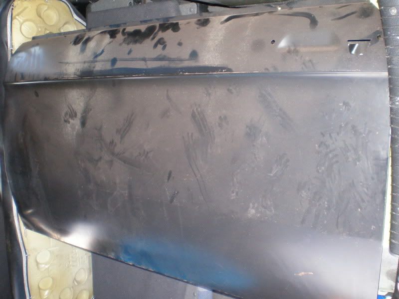

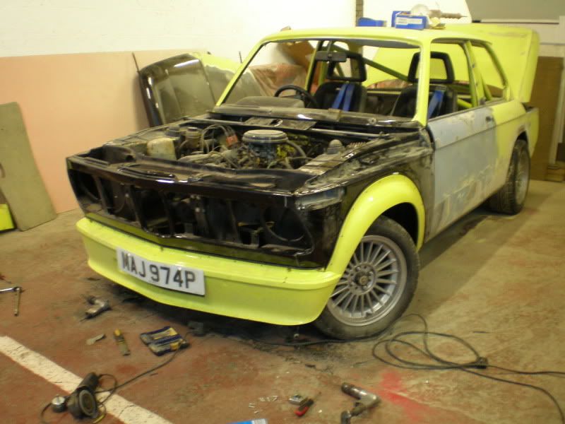

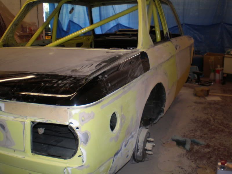

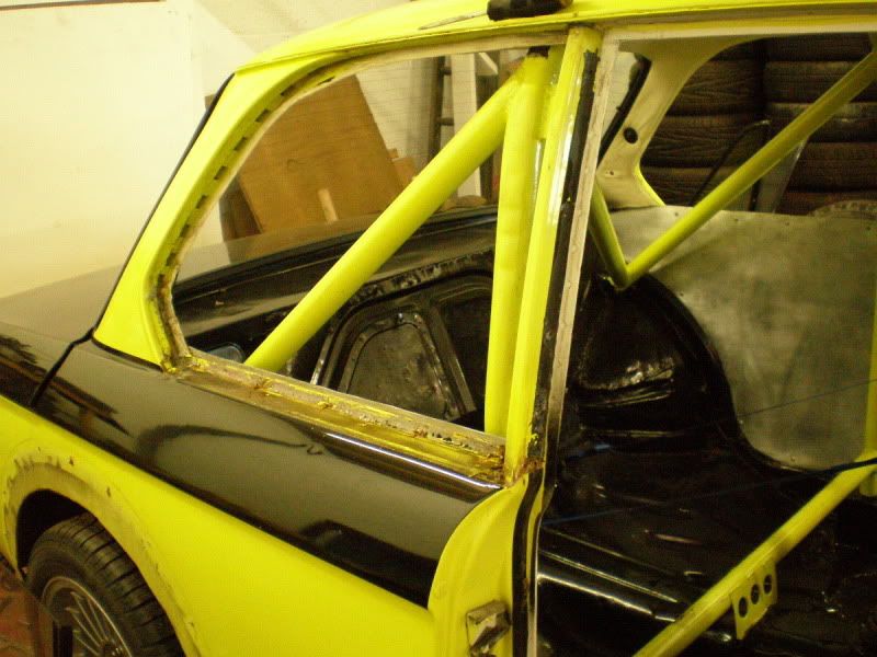

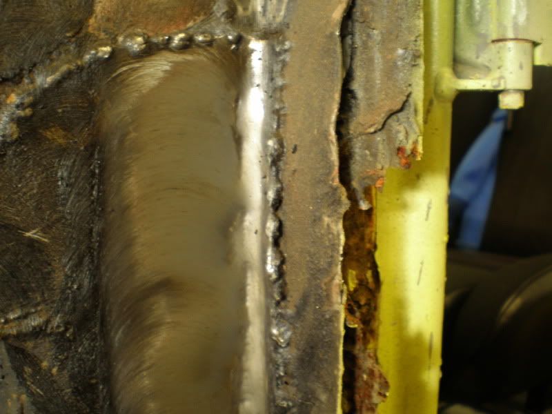

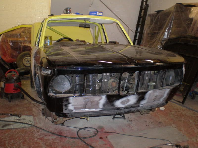

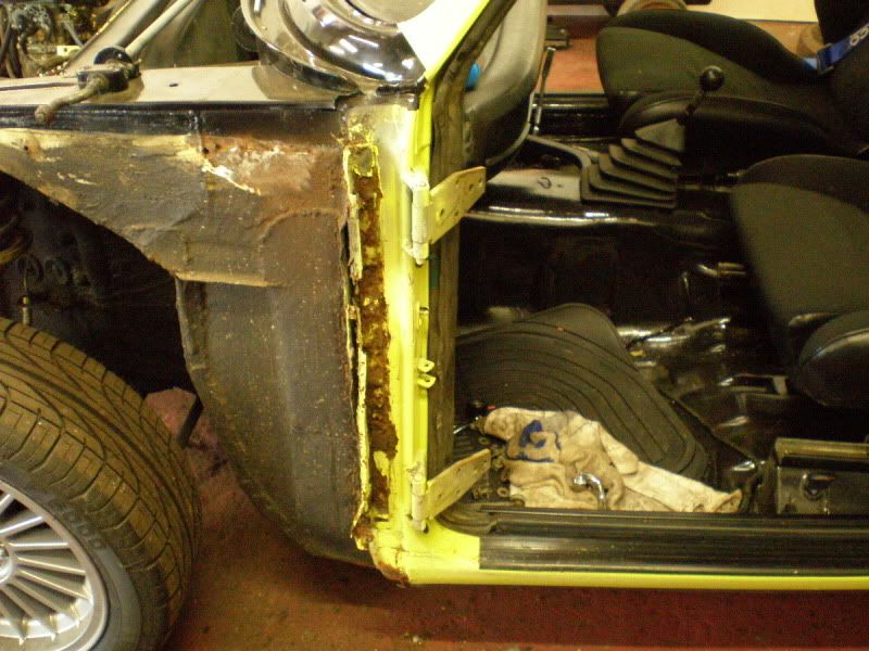

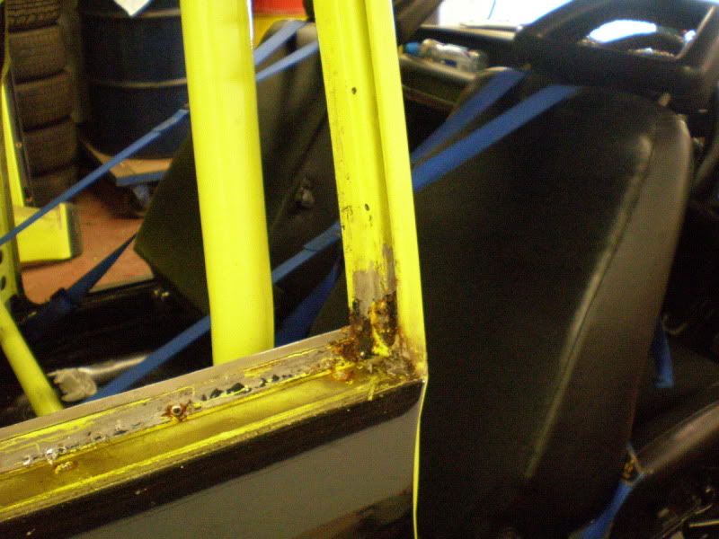

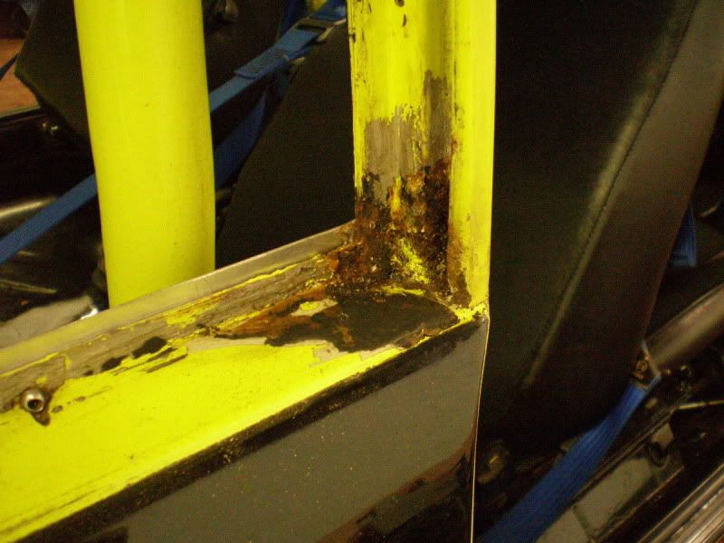

the reason.... i bought this car a year ago after being told edinburgh retro cars had restored it from the owner at the time.... my god was i in for a shock.... also may i add, i informed the said company i had bought the car at that point they said they had done loads of body and mechanical work..... once they seen some of my pics emailed to them i never heard back!! shock!!!!

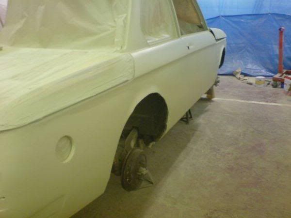

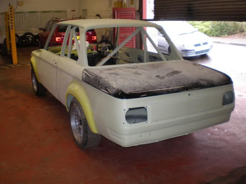

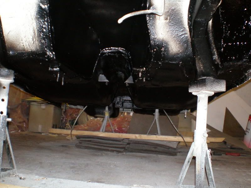

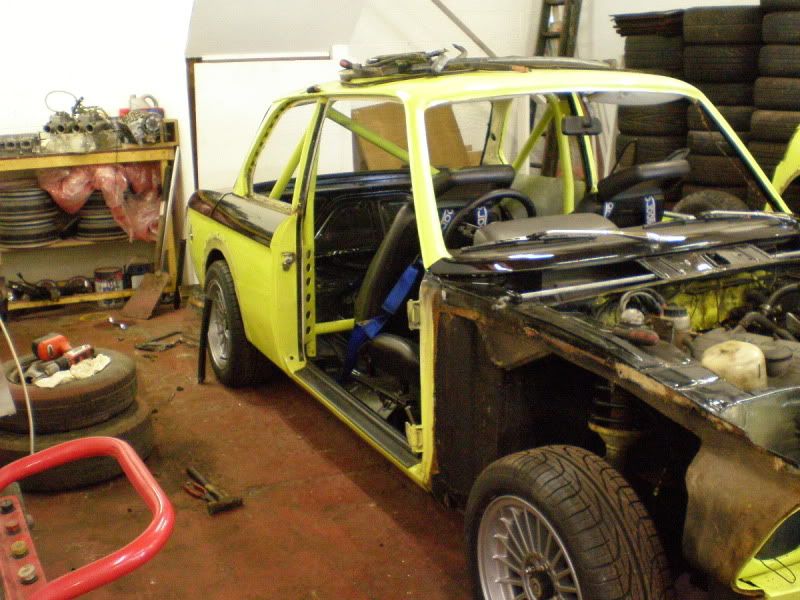

here goes from taking it into my workshop to how it sits now
welding of a resoration company????!!!!!!!!

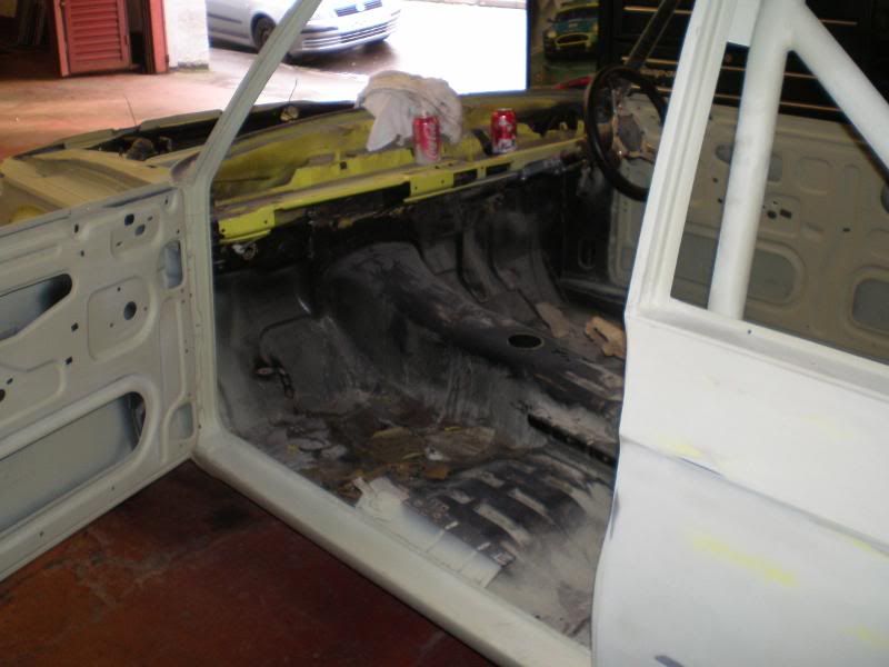

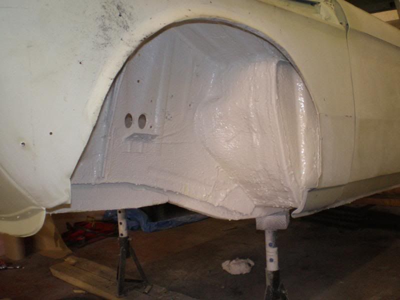

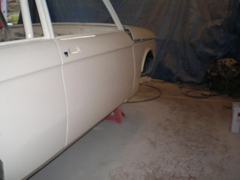

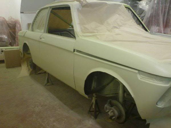

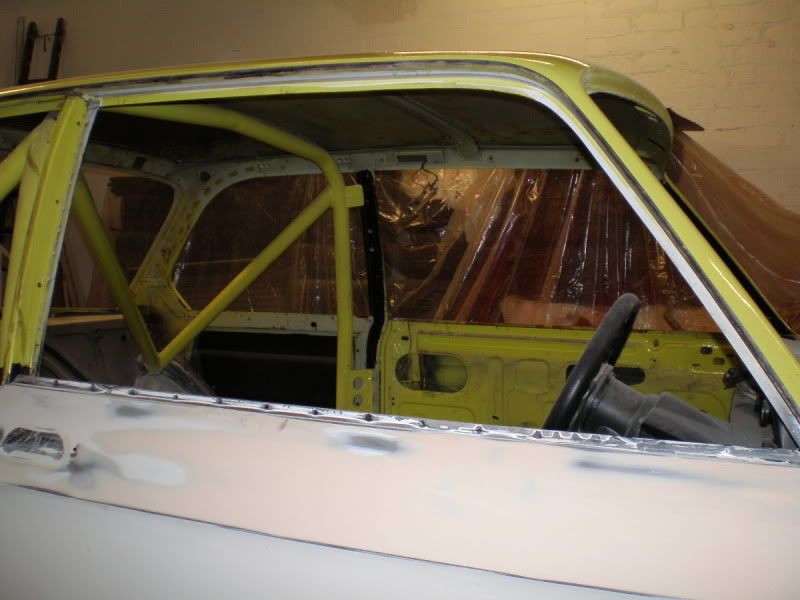

it was at this point i knew there was no going back! its all or nothing..... so this happened

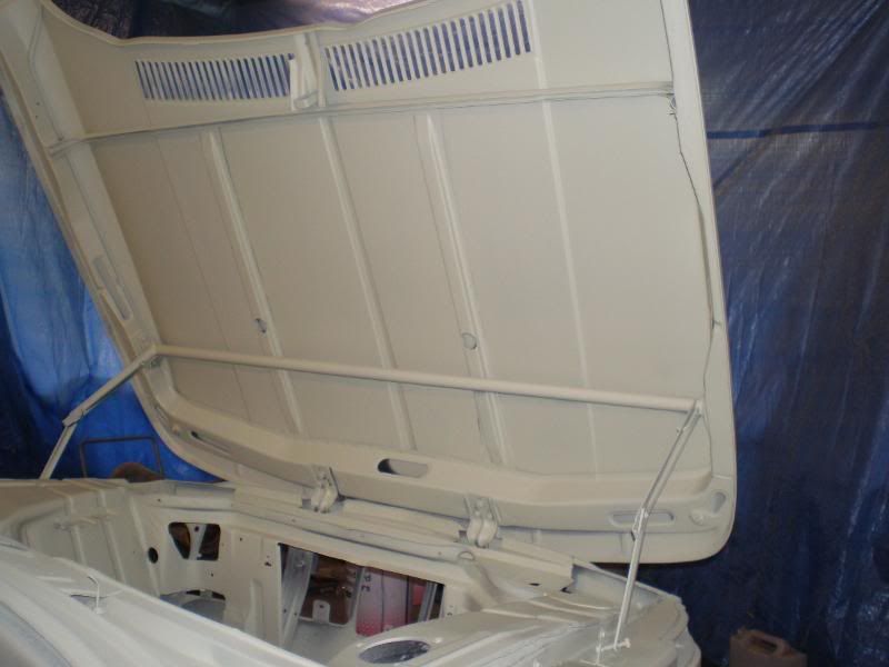

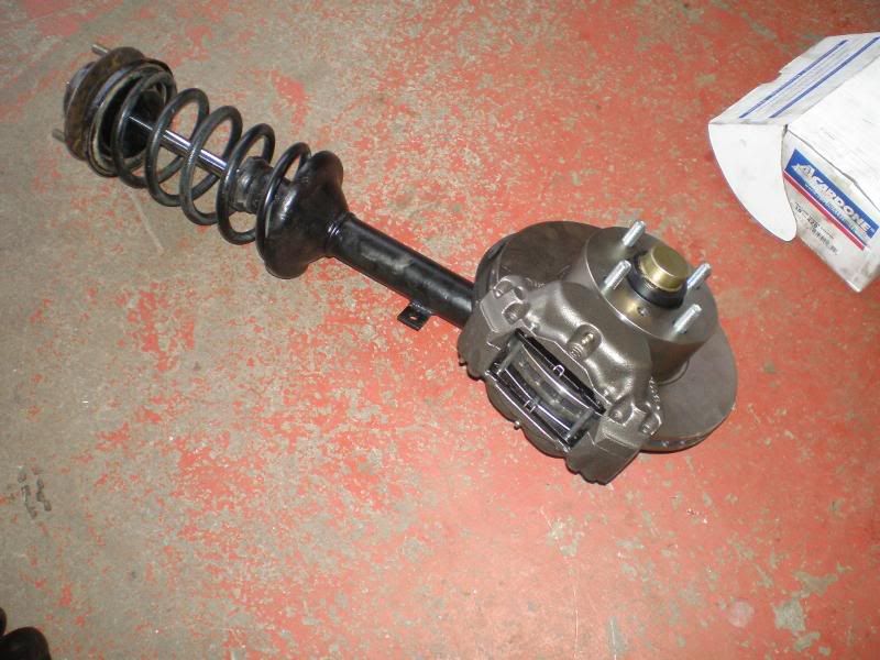

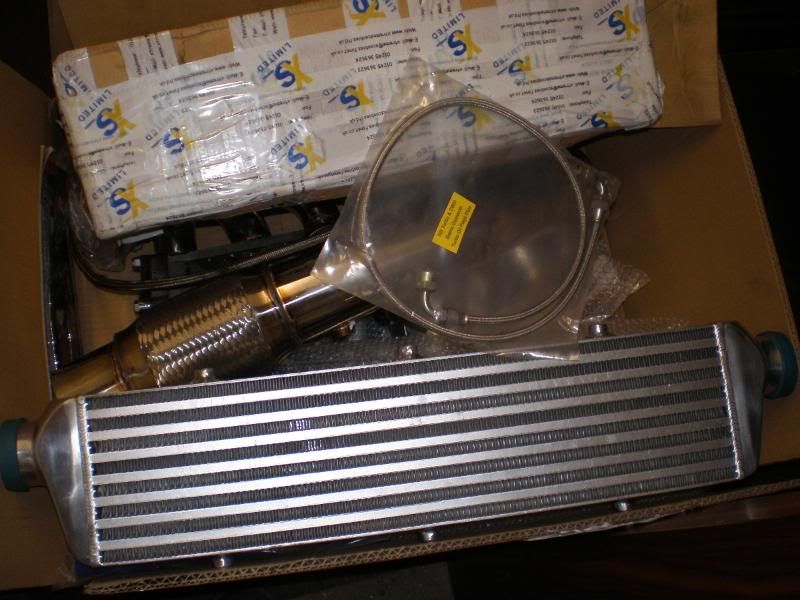

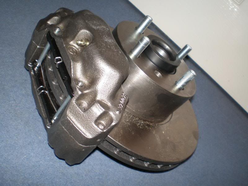

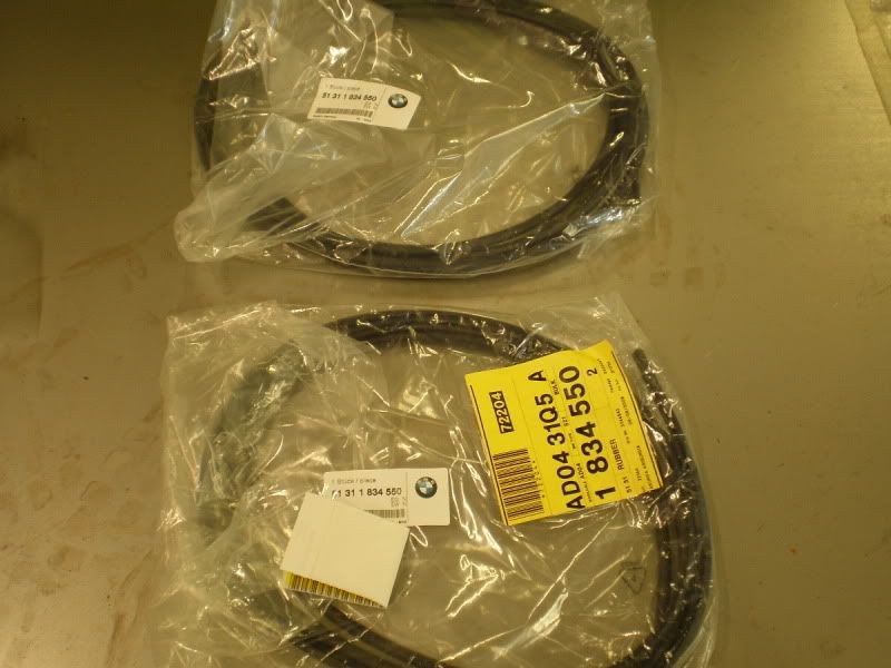

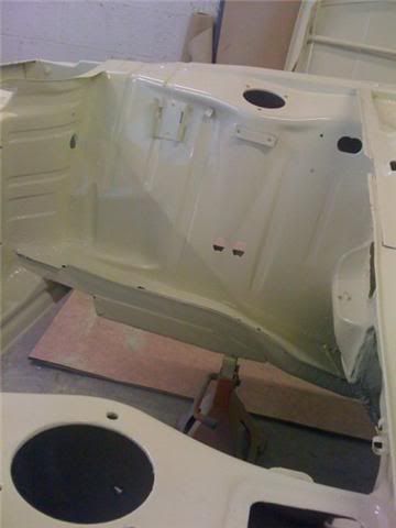

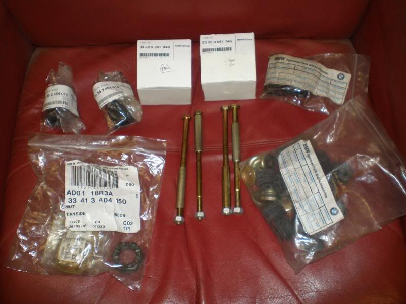

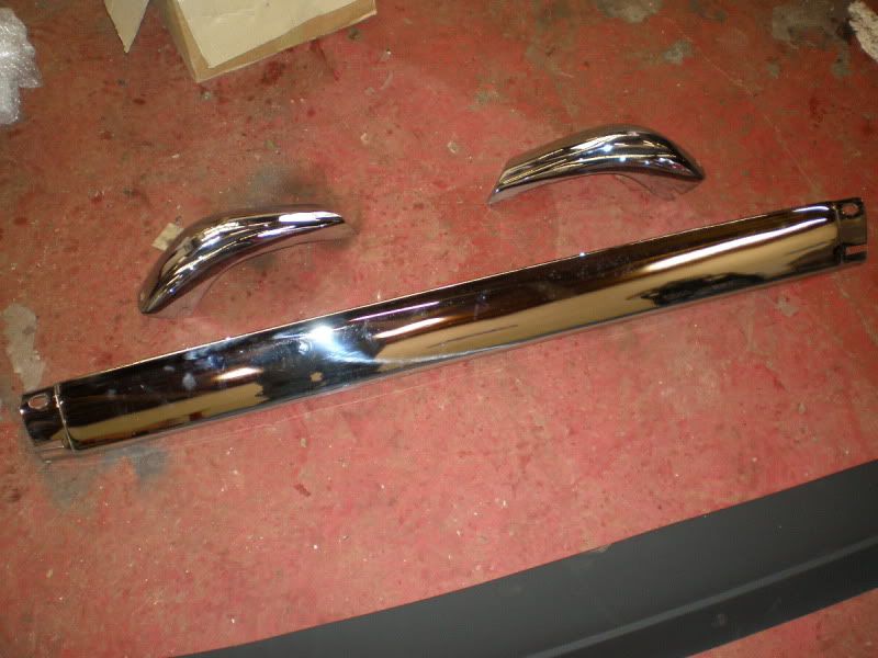

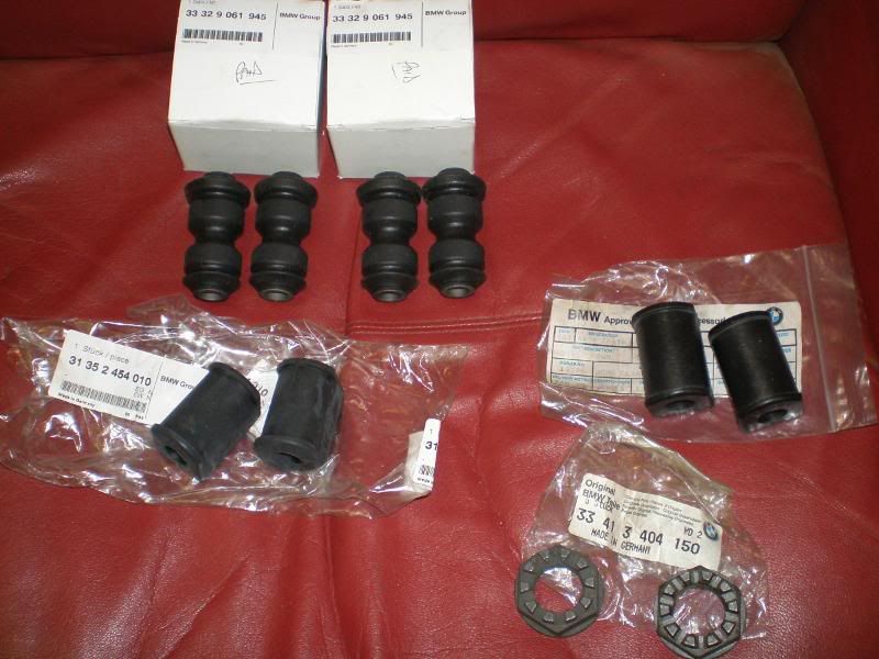

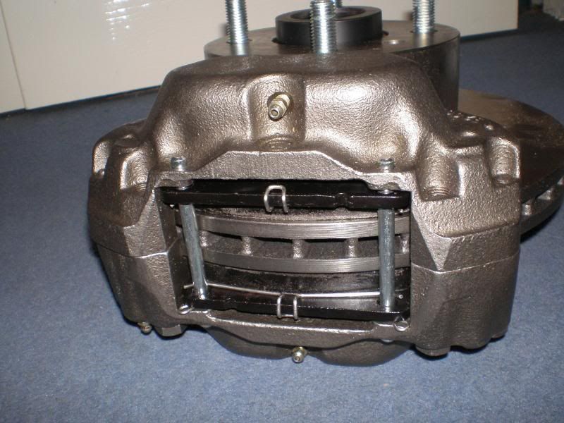

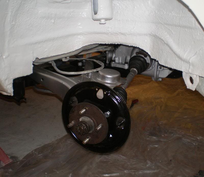

at this point i started to buy some new bits and bobs , i got carried away shall we say......

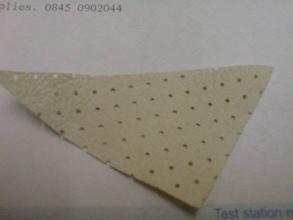

also had a full roof lining made in this retro perforated material

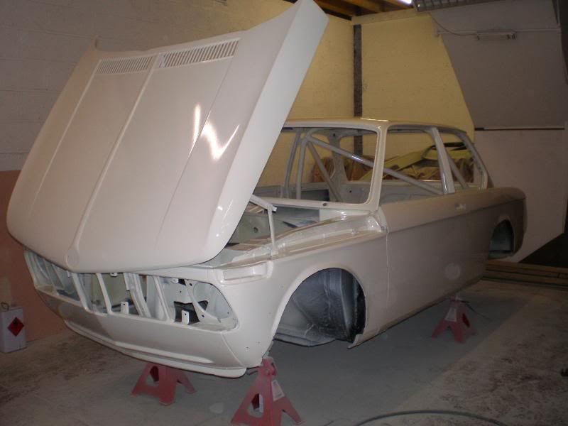

im going to leave it at that point for now. its taking ages to go through all the pics i have,.....
continued very soon!!

I remember this being featured in a magazine and it looked really well restored. The pictures would suggest otherwise... 8O

right ......back to the pics guys

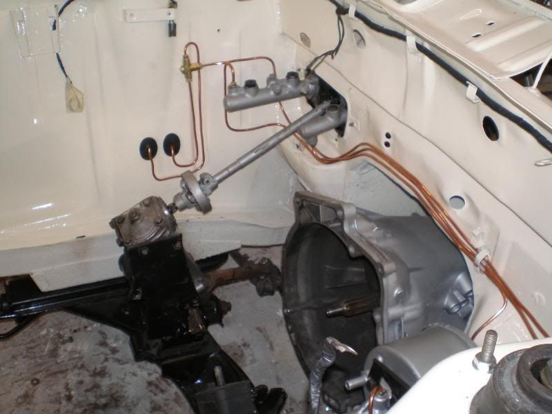

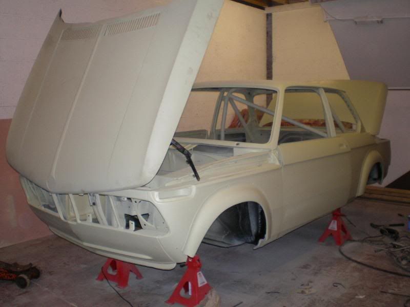

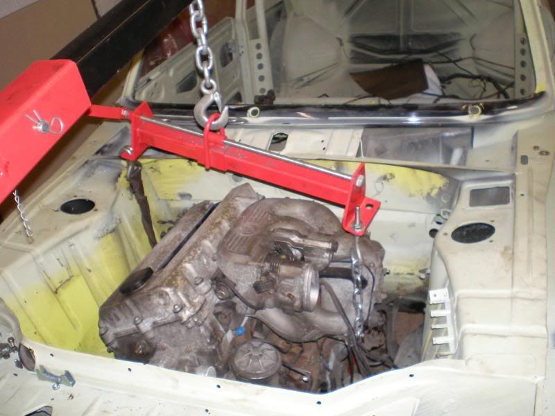

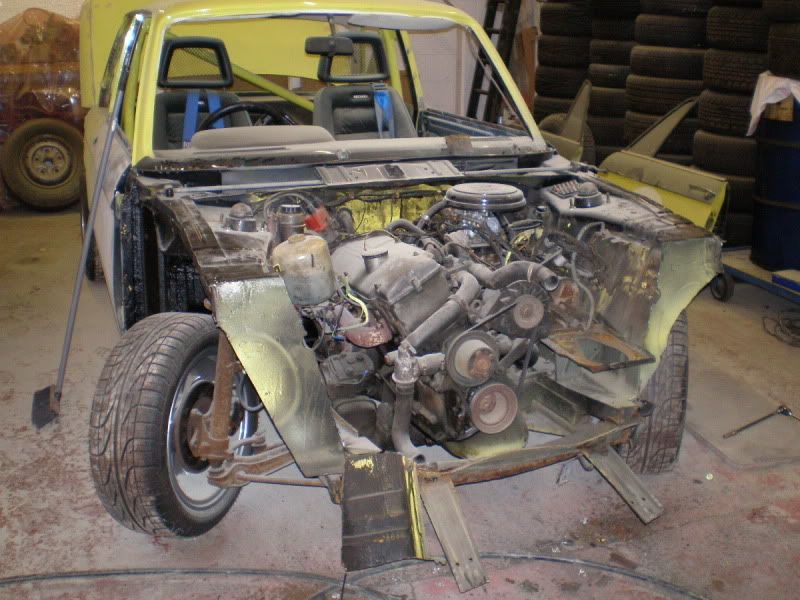

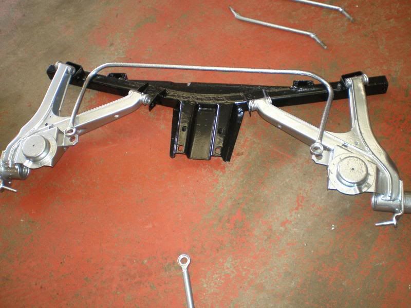

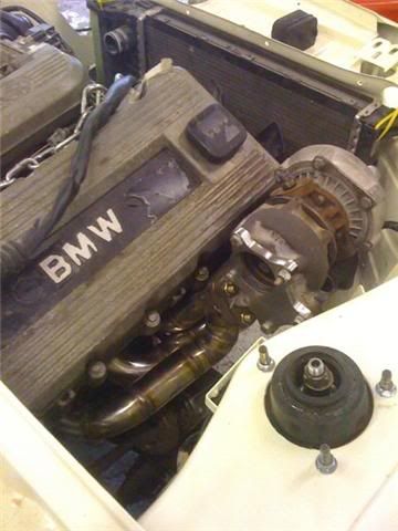

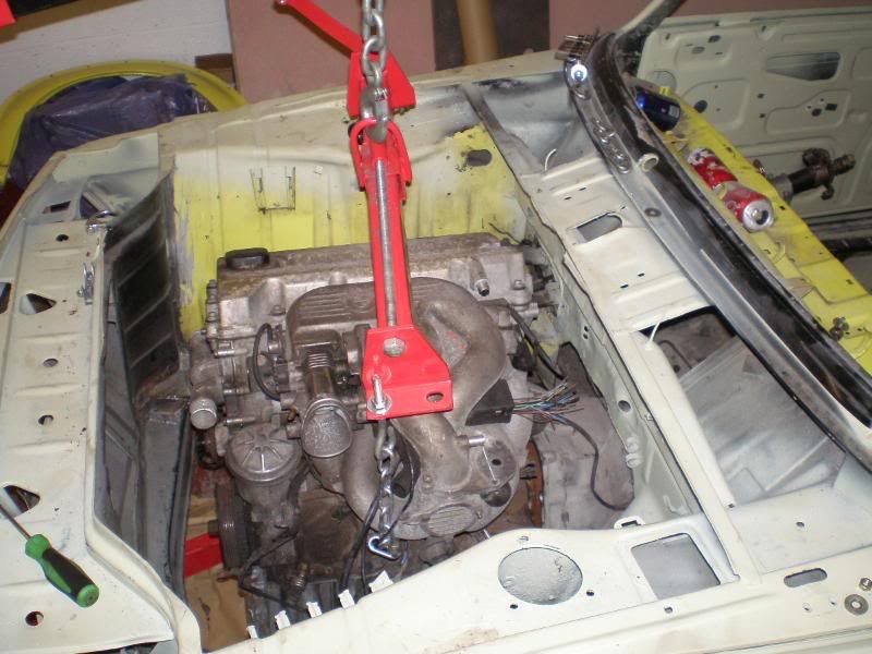

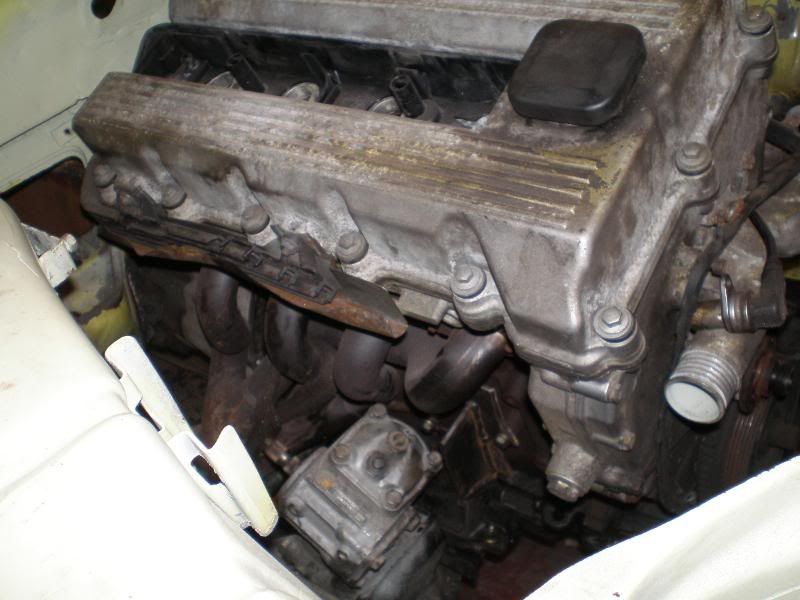

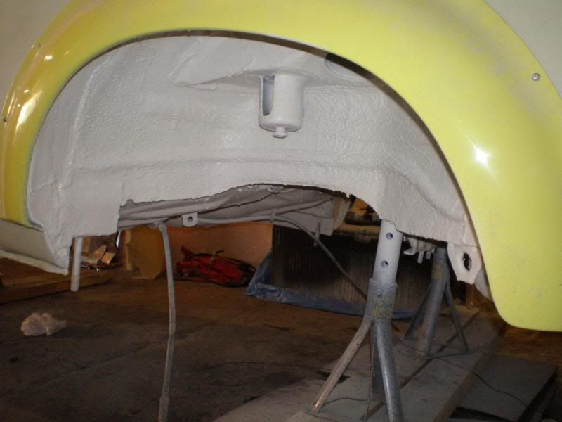

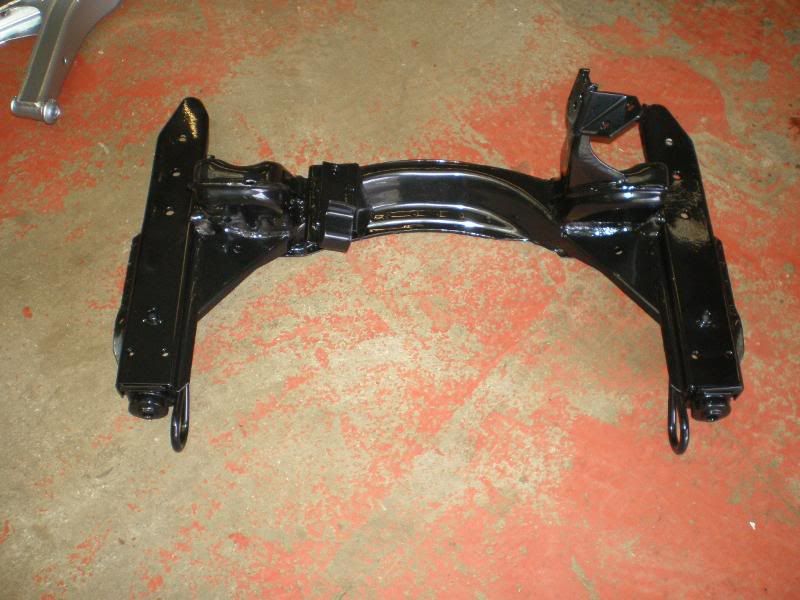

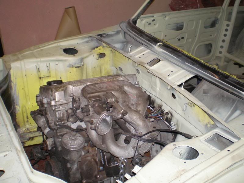

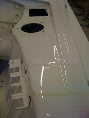

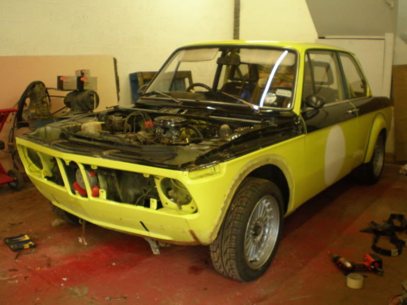

at this point i decided to mock fit the engine and make up some mounts

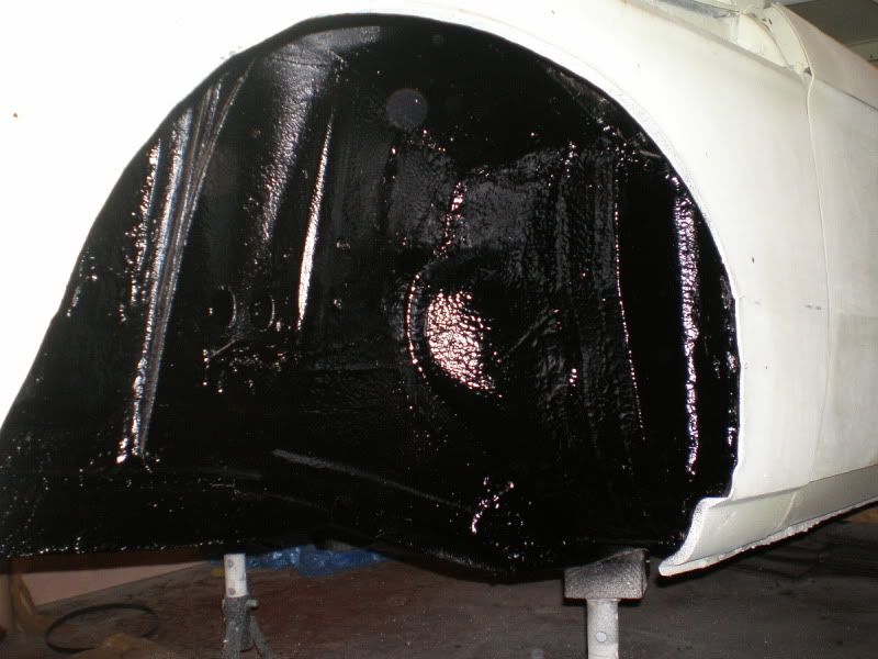

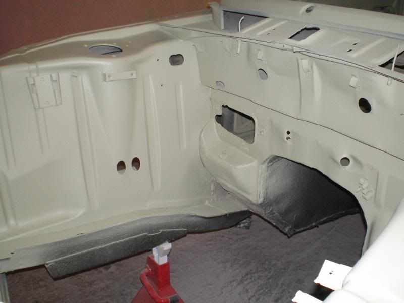

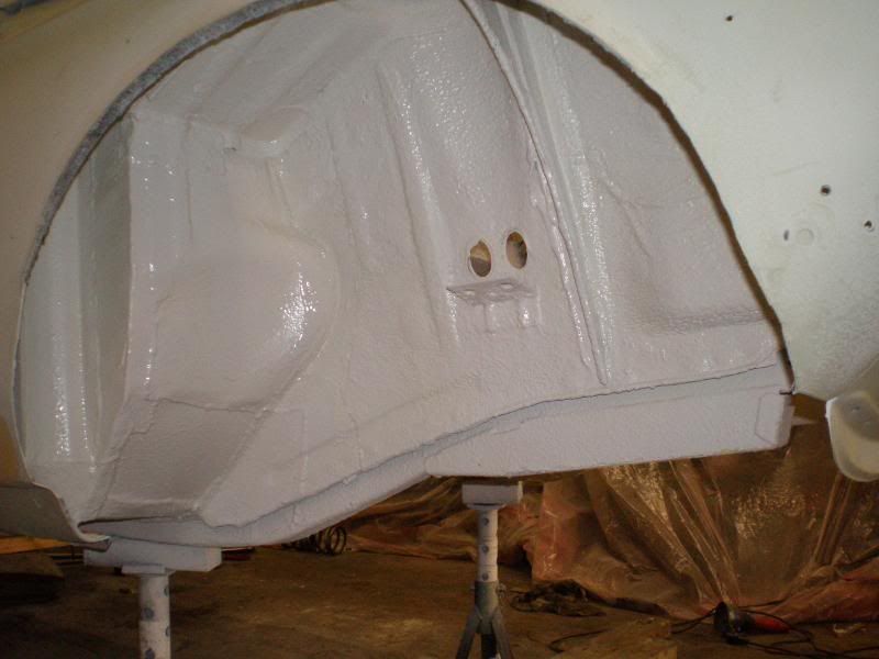

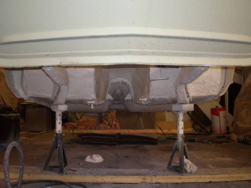

then it came out again for some undersealing and painting and primer.

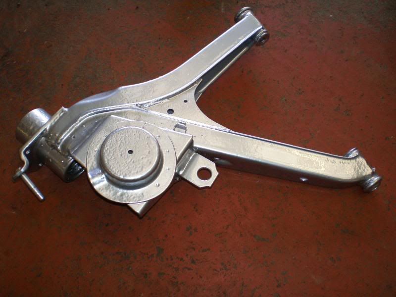

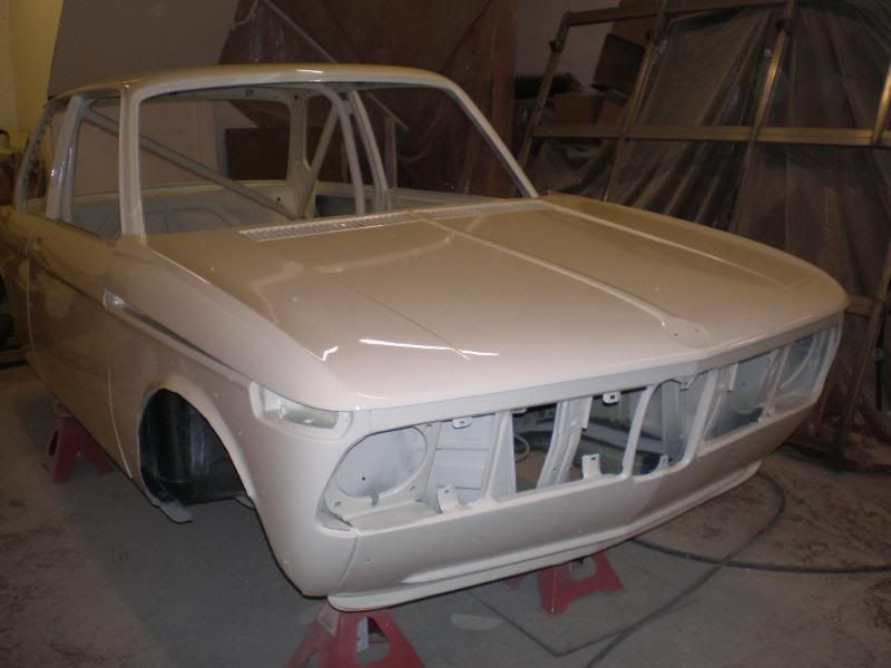

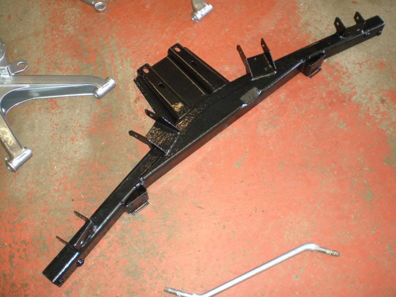

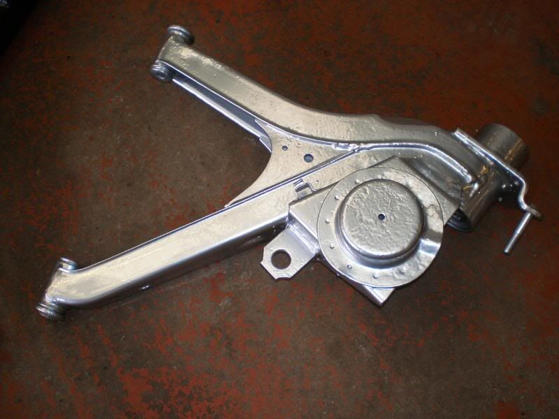

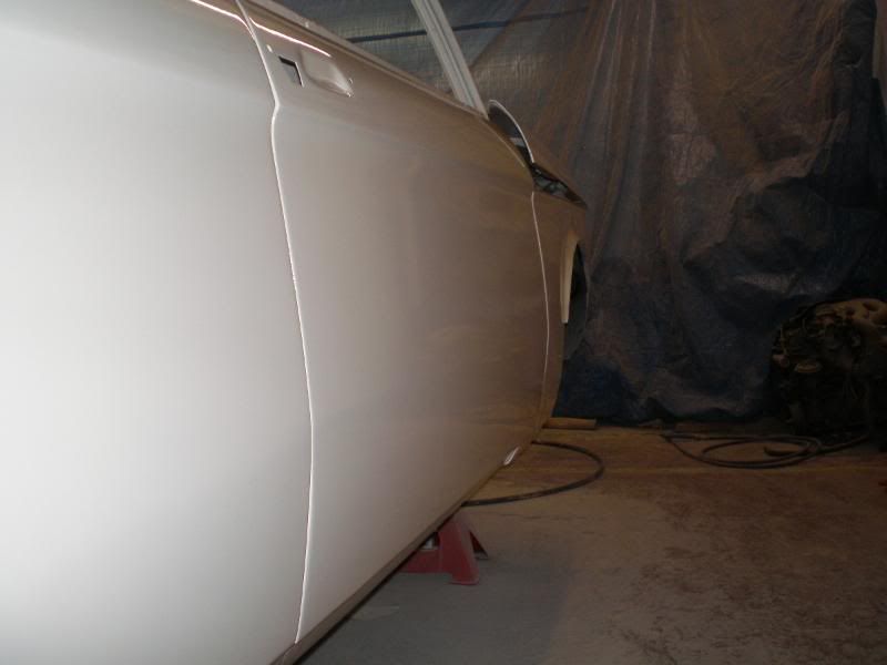

i sent all the subframes atc away for blastong and powder coating.......

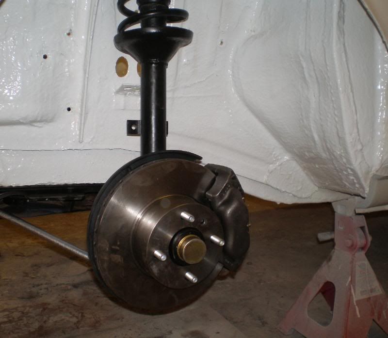

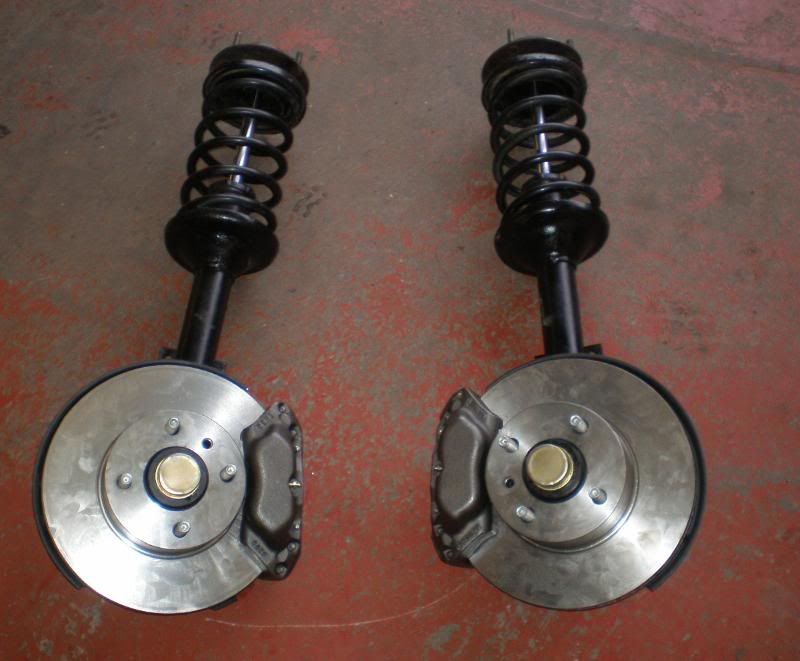

and now i have started to rebuilt it all.....

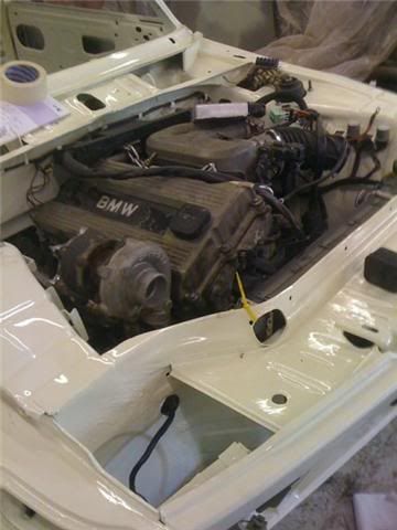

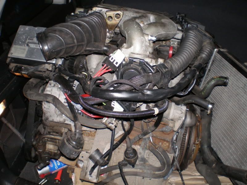

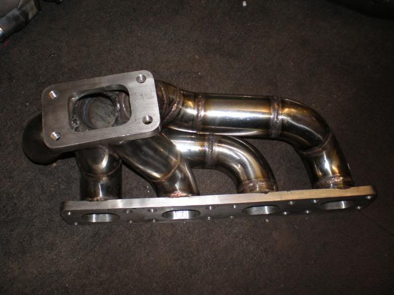

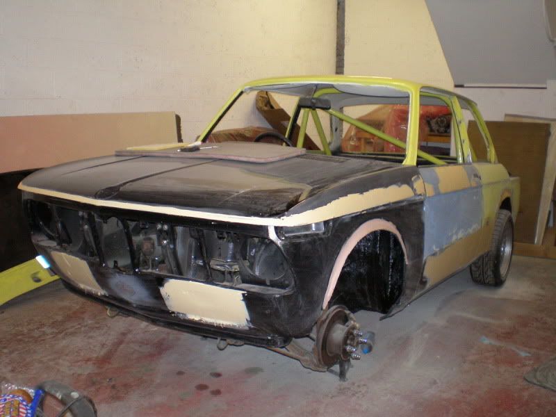

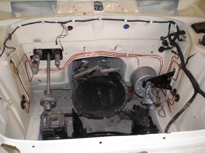

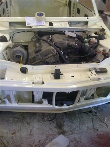

yesterday...16/5/2010 i realised i was going to have a problem with the turbo manifold i bought from obx racing....its going to hit the steering box WITHOUT a turbo on it!! so......i spent the afternoon AGAIN fitting the engine in so i could modify the obx manifold so it now fits upside down.... had clearance issues with this but i have got around it..... this is the latest pics i have to this point
obviously its to come out again for cleaning and painting but im happy to see it even in this state!!!
baz

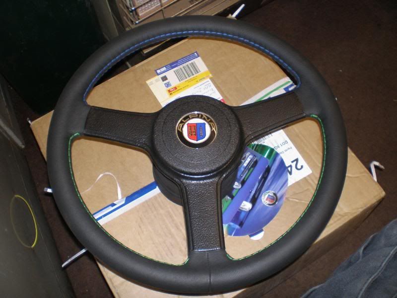

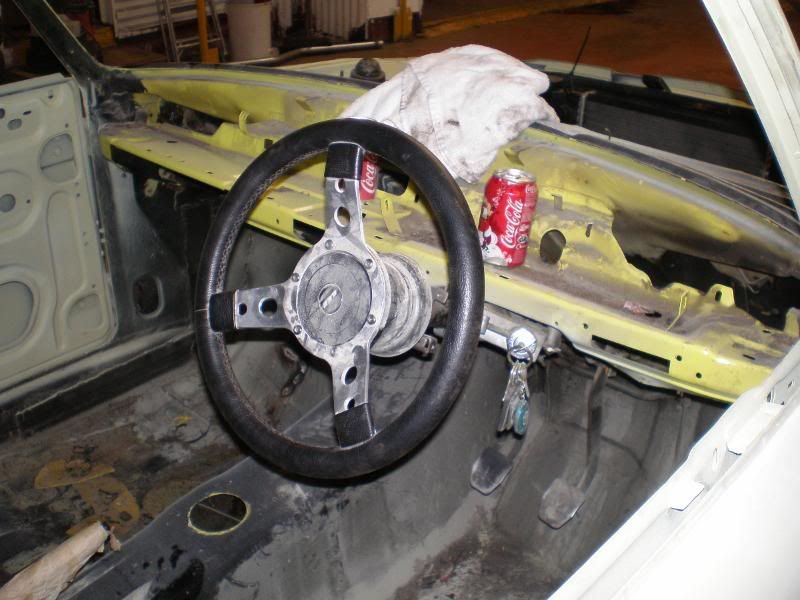

Mon May 17, 2010 10:14 pm

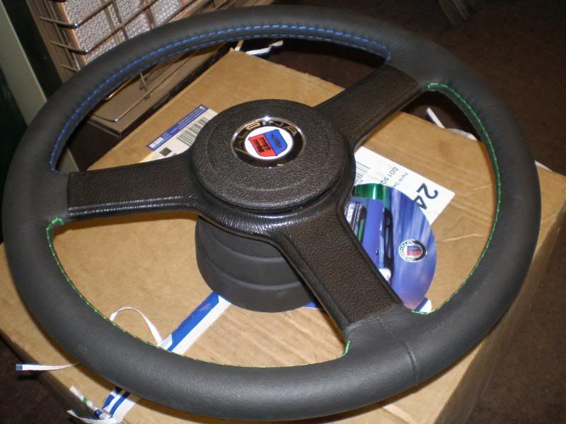

Never knew there were 2002 Alpina steering wheels.
stbaz
Posts: 391
Joined: Sun Dec 20, 2009 11:00 pm
Location: dundee, scotland
Tue May 18, 2010 6:53 pm
its an e21 sport wheel thats been retrimmed......... not original alpina 02 part but then again niether was the 16v turbo winkeye

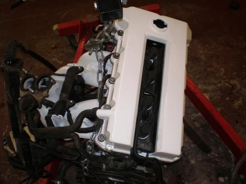

Sun May 30, 2010 9:55 am

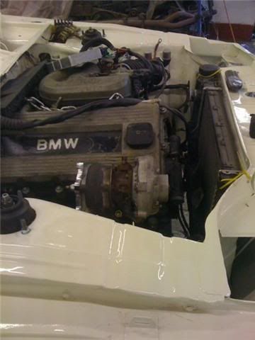

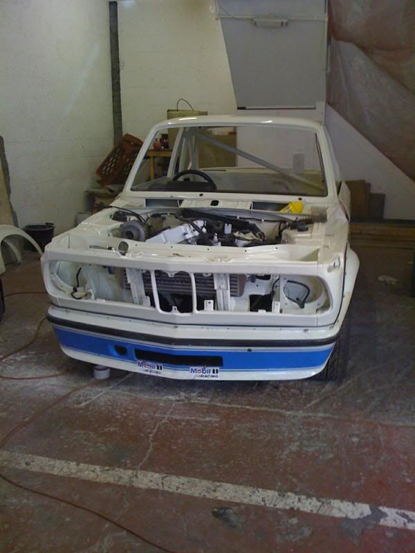

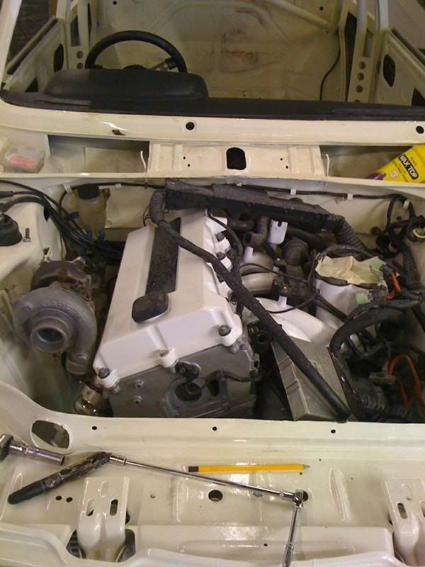

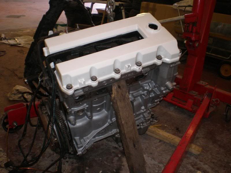

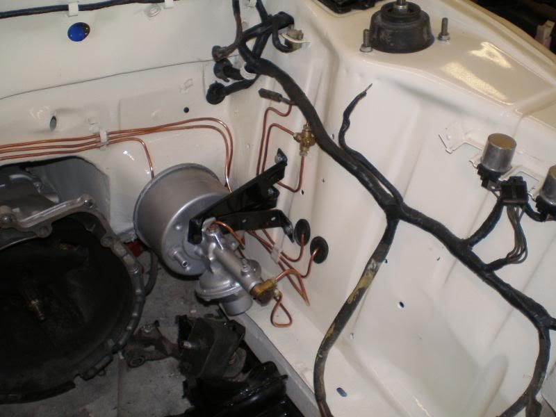

couple of update shots, started getting the bay back together for the final fit of the engine and also started to paint up the engine

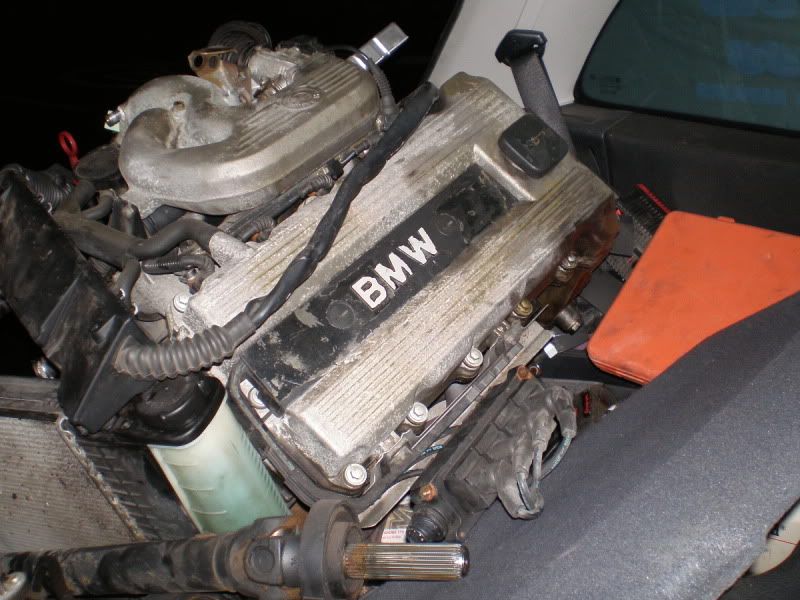

Awesome!! The 02 is this winters project for me, will be watching this closely. What sort of power do you think the motor will be making once full setup? Mines currently got a blown head so the engine conversion is very interesting stuff. Were the engine mounts easy enough to make? Keep up the good work.

Very easy to do if your handy with a welder. im aiming for a realiable 220/240 hp
i have a spare engine i will be building into something better at a later date

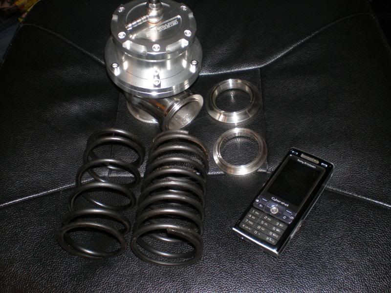

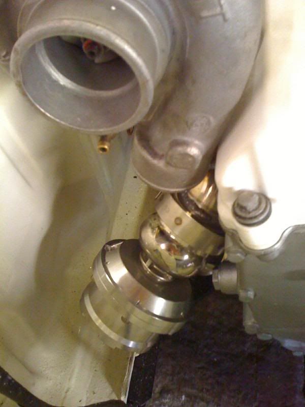

Wed Jun 02, 2010 7:48 pm

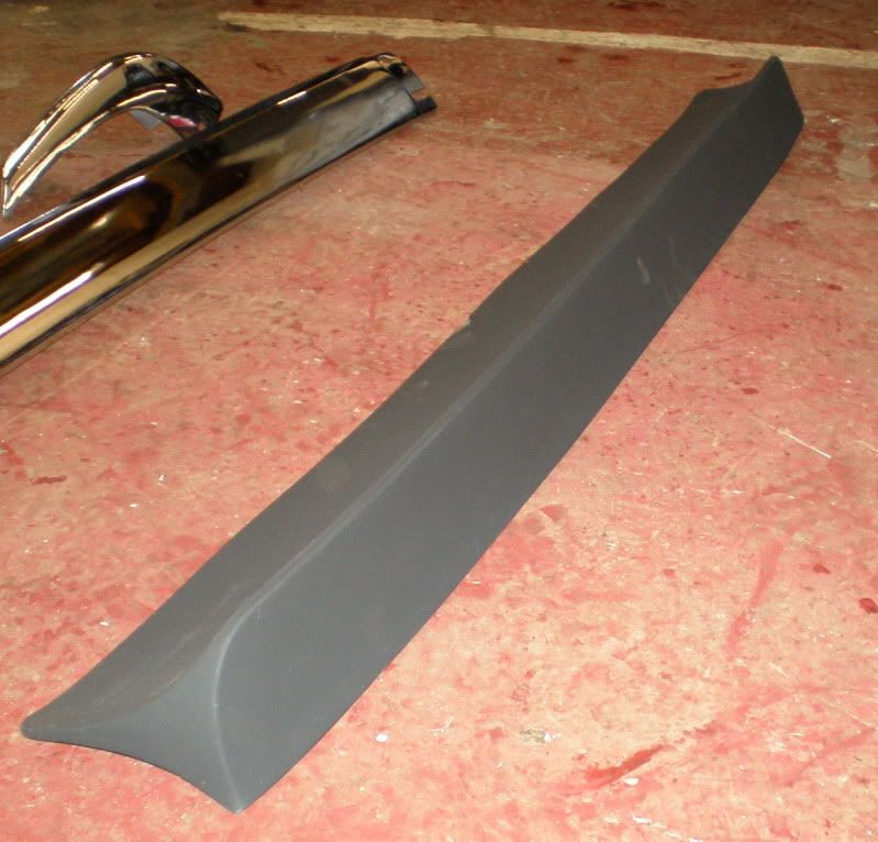

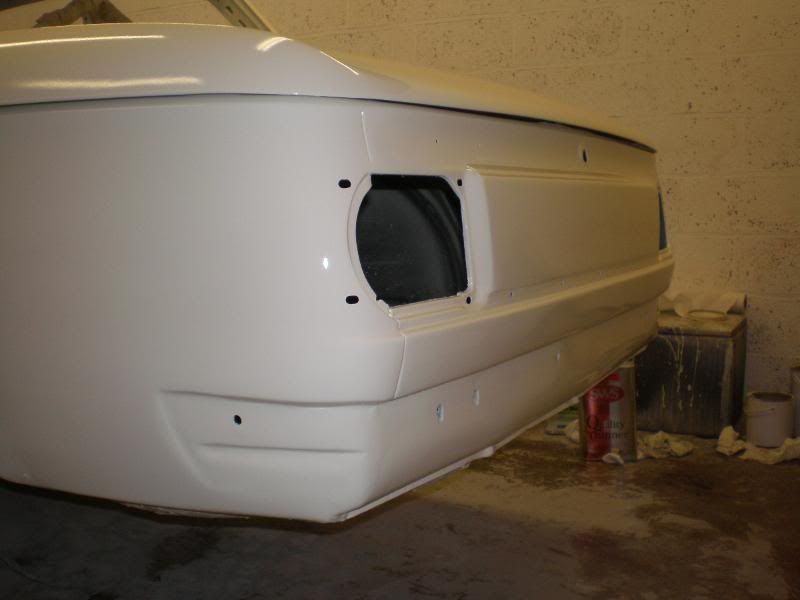

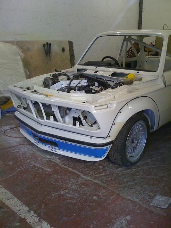

minor update. engine is now in to stay, external wasgate position has been moved and wastegate fitted and had to get hold of a diferent front spoiler as the one off the car just wouldnt fit so some more painting to go......
pics
