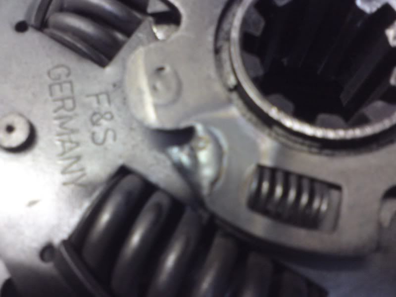

Aircon spec clutches are utter shite, they are sold as 'heavy duty' but are the same as a standard clutch apart from the extra spring plate
It juddered like a b*stard on my 2.8, I cured it with some welding and it now works perfectly on my other car
