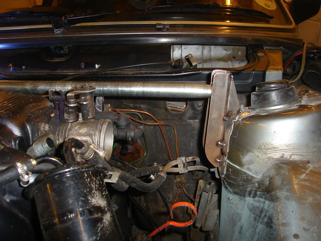

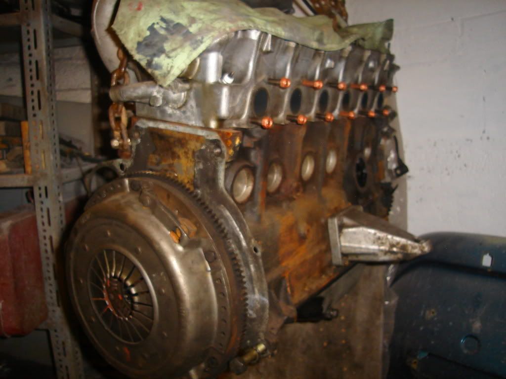

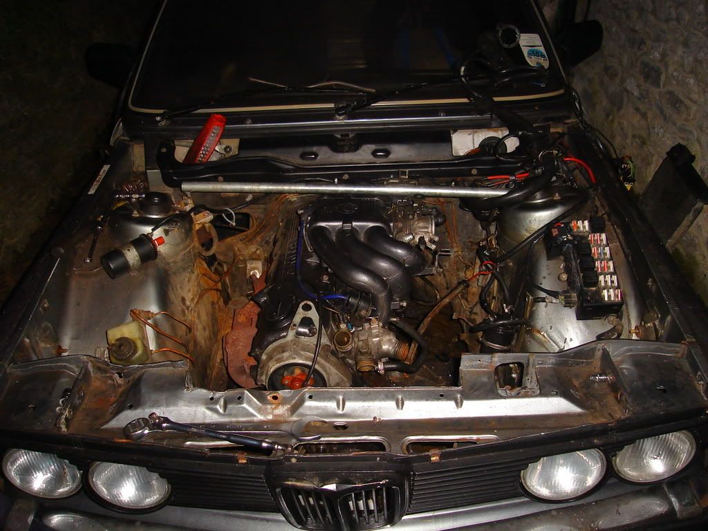

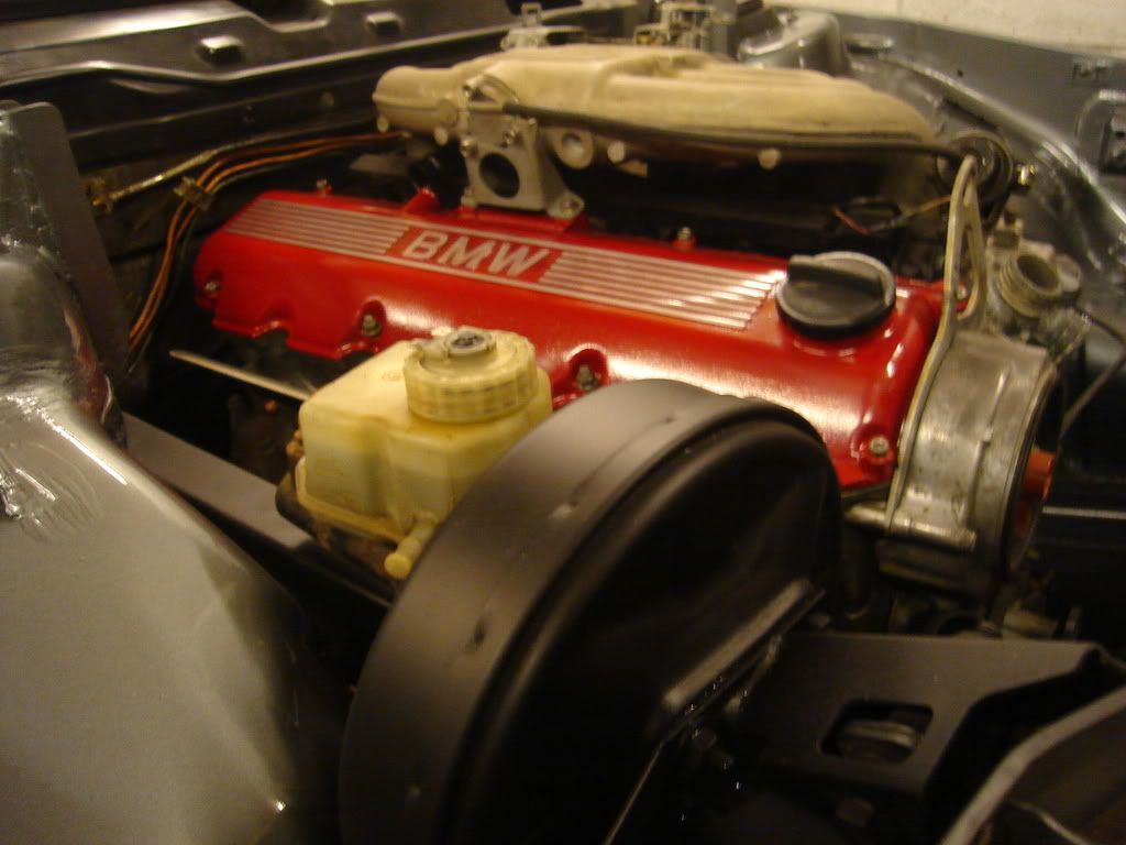

im in the process or fitted sweeps 325i engine in our drift spec 320/6 e21 end of this week/weekend. just thought id post up some pics for your possible viewing pleasure!
before.....
strut brace were making........
out.....
built up e21 tin sump on, 320 flywheel and 2.5 clutch. manifold studs sorted out.......
in......
just pipes and wires left today! :D 8)
e21 killing tyres with e30 325 powerzzz

finished pics!
and vid!

picked up a s/h one from quarry motors. this morning. all fitted!
so were back one the road again! tho i have a feeling replacing broken driveshafts may become a hobby of mine!
also other finished pics..... strut brace made from a weight lifting bar and a big bolt.....
bonnet now comes off for ultimate access!
aerocatches....... sexy!
fitted the whiteline anti roll bar kit i ordered quite a few weeks back when i had money spare! (tho im paying the price for my spending spree on the car now!)
fitted.....
incase you were wondering, i left my axle stands at my mates workshop!!
house bricks.... the poor mans axle stand!!
