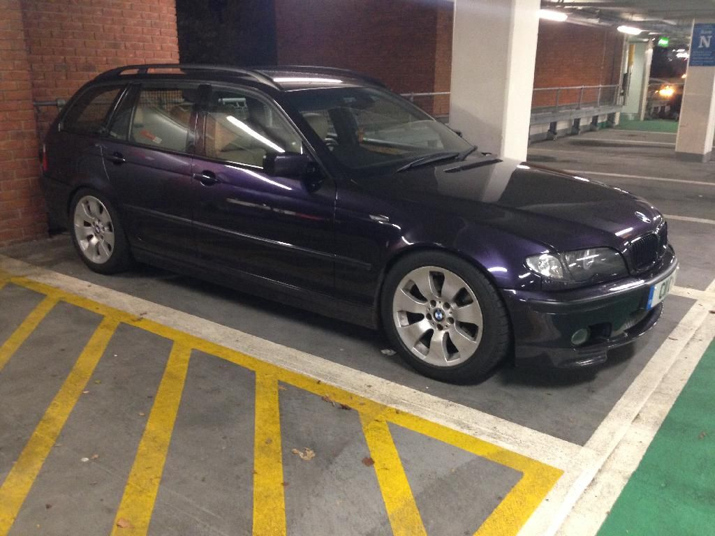

Lovely colour Kos Techno Violet is a great colour

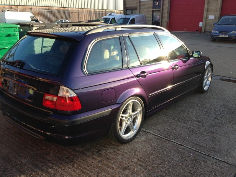

WOW!!!!!Kos wrote:right, car has been detailed !
i had 2 clear days with an empty work shop and to keep me going a shit load of lucozade, snickers bars and my ipod
the car has all original paint, one of the things that made the car a decent purchase, however is was hard, faded, swirls and generally unloved
you could see that the previous owner made a lame attempt to put some shine back into it, but i knew that i could bring it back to life. techno violet is a stunning colour and deserves to be show in its full glory
first up was a thorough clean, de contaminate and remove any traces of polish it had. was was power washed with the trusty karcher, all the nooks and crannies cleaned with autosmart G101 and a small brush. this gets rid of algae build up. the body was also washed down with autosmart as well then dried off
so, i proceeded to clay the car, use some tar remover in the lower sills to help shift what the clay wouldnt
i wipe down with some IPA/panel wipe it was inspected properly with halogen lighting and it was swirl city and a there were quite a few scratches

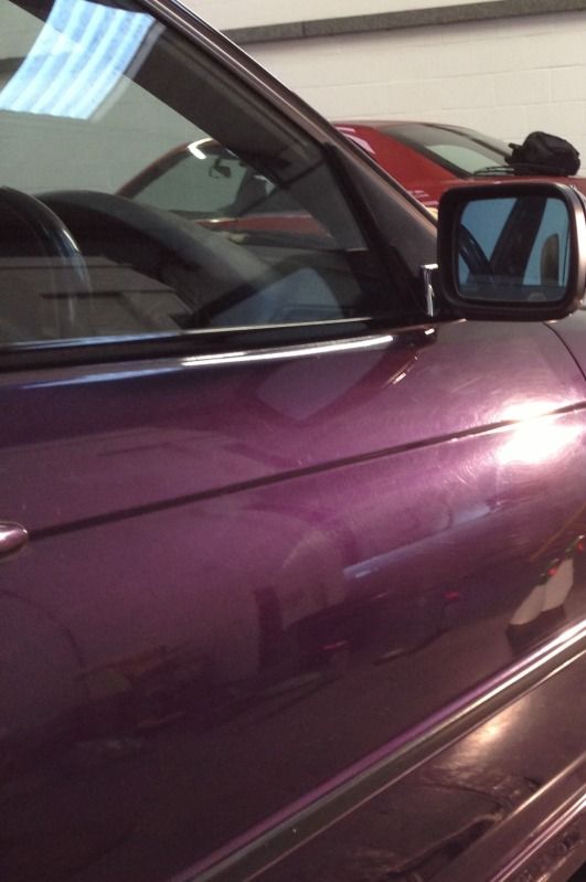

drivers door
this gives you an idea of what i was up against.

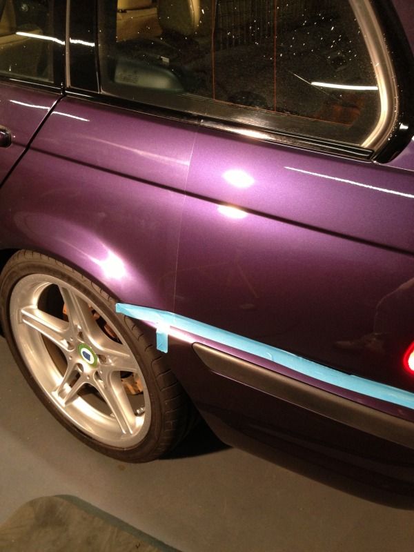

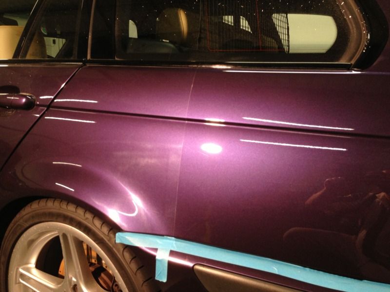

i got the rotary polisher out and got to work using a cutting pad and menzerna FG400. where there were scratches i wet sanded with 2000 wet & dry to feather them out and used a small spot pad to work these areas.
as i was going along i'd wipe the panels down with IPA to inspect how i was getting on, halogens lighting up everything as well.
from there, i refined the panels with softer pads and milder compounds until i was at a level off correction i was happy with

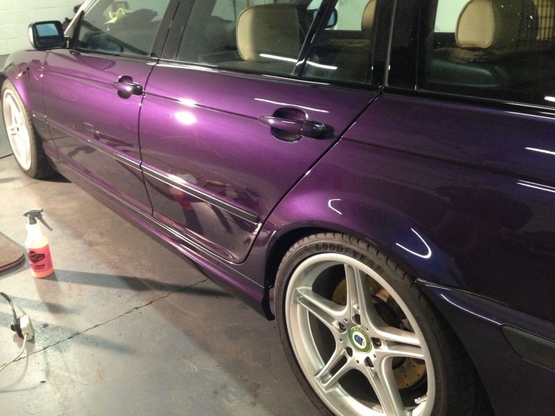

the car was then washed down using a a nice soft wash mit, dried off using a soft drying towel.
compound & polish gets everywhere no matter how well you mask up, i only mask up to protect edges when polishing and trims because i will always clean the shuts and clean the panel gaps with a brush
i was considering using a synthetic sealant but i still prefer waxes and with this in mind i can use a glaze as base for the wax, this adds depth and gloss to paint. the glaze of choice this time round was chemical guys EZ creme glaze. it works well for me. using a finishing pad went over the car with it. you only need small amounts on the pad and work it in. this doesn't create and dust
before the wax, i wiped the car down using meguires last touch QD and applied the last stage protection. wax is collinite 476. its a cheaper wax but is renowned for its nice gloss and durability
thin even layers as best as it can be a pig to remove. if it gets too dry you can use the QD to help buff it off.
i left it over night and the following day (this morning) gave the car a final wipe down with some Zaino Z8.
all the shuts were polished by hand, glass polished and on the inside wiped down with IP. all plastic trims were treated and restored with gtechniq c4 trim restorer (a 15ml bottle is enough and makes the trims look as new and last well over a year)

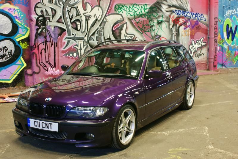

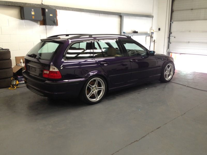

anyway, some pictures

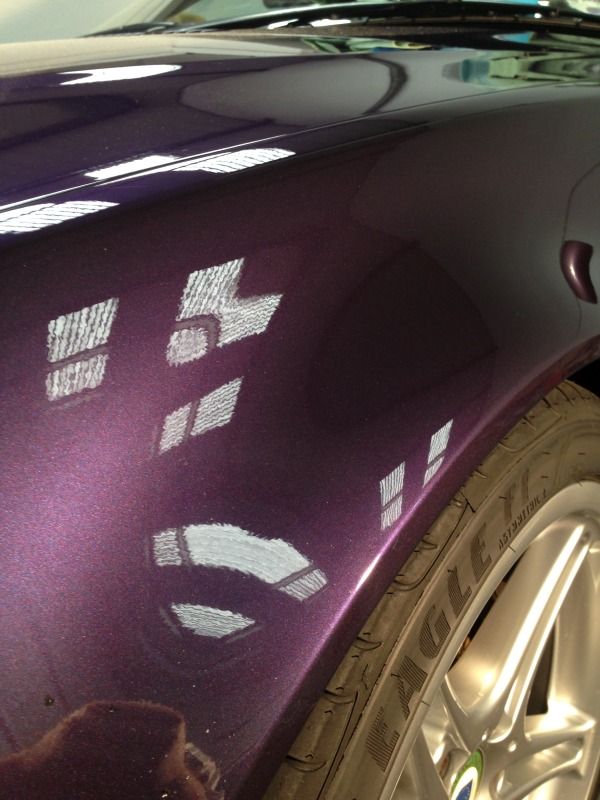

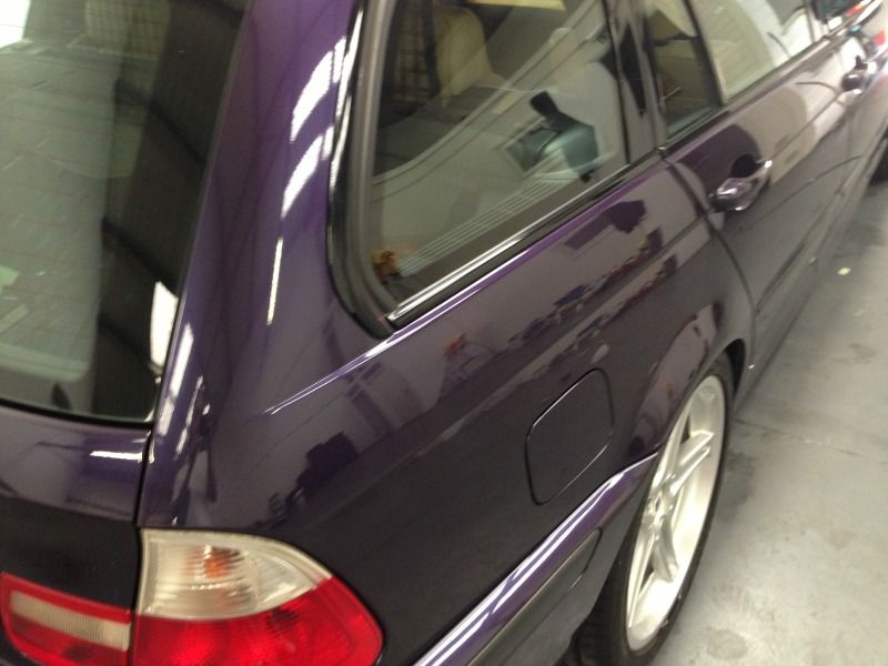

a 50/50 shot of the rear 1/4 panel

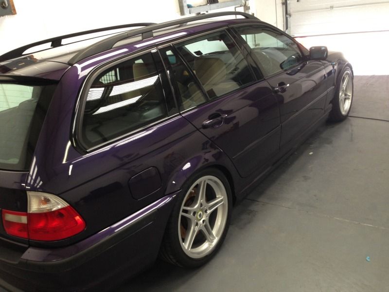

and one side almost complete

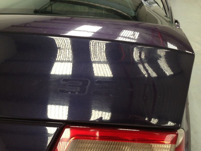

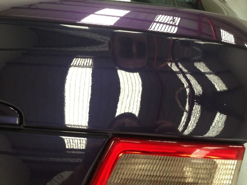

before and after of the tailgate where the 330i bagds was
other side getting finished off
a close up of the wing
out side in the sun light

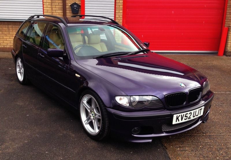

and one from this morning before it started pissing down
in all i spent a solid 30 hours on the car including the engine bay and interior clean up
body took up 24 hours
apologies for the average quality pics, i do have more taken with the SLR but having been at work all day today, i cant be arsed to host them right now, hosting iPhone pictures is easy while i'm at work
one thing is, that after all this work is that i'm not 100% with the front end. front bumper and bonnet are peppered with stone chips and so are the leading edges of the wings. the skirts could do with a repaint as well. so i may just live with it for now and get it painted some time later on this year

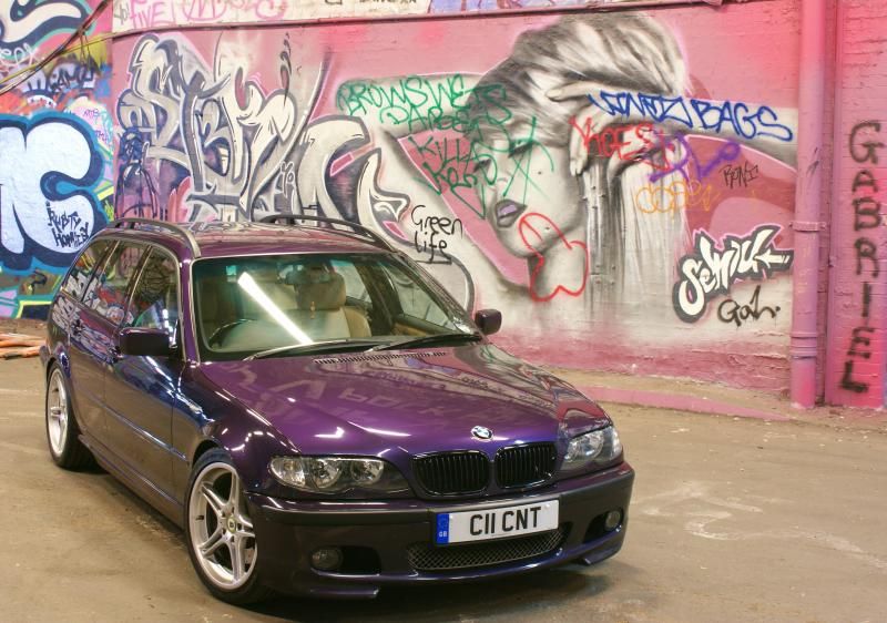

a few weeks ago i went to the most over used photo shoot location to grab a couple of pictures of the purple turd
anyway, updates .......... not a lot.
the car runs fine, drives well and handles really well. i have decided that i will most probably paint the front end. the stone chips are starting to annoy me !
i'm also considering changing the rear box to somthing more fruity. i'm looking at either an eisenmann or even a bmw performance rear box (US spec), neither are cheap but both fit properly and sound good.

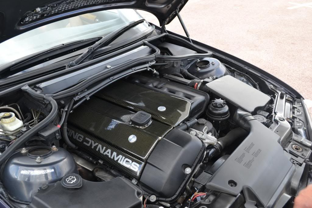

Right, exhaust & manifold are on.
At the same time I changed the AC compressor as it was starting to rumble. It was also due a re gas after being worked hard all summer.
The only 'drama' was having to extend the lambda loom. It's worked fine and there are no fault codes coming up.
Initial thoughts and feeling is good. Nice burble at lower RPM and a higher RPM is just a touch louder than the original system. You do get some noise from the manifold, but nothing unbearable. so on that front i'm happy. Performance wise it seems more torquey in the mid range. Further up the RPM range it feels less strangled now that the pre cat manifolds have gone. It certainly feels more brisk at high RPM and 3 figure speeds
It's going in for its remap some time next week. Reports to follow

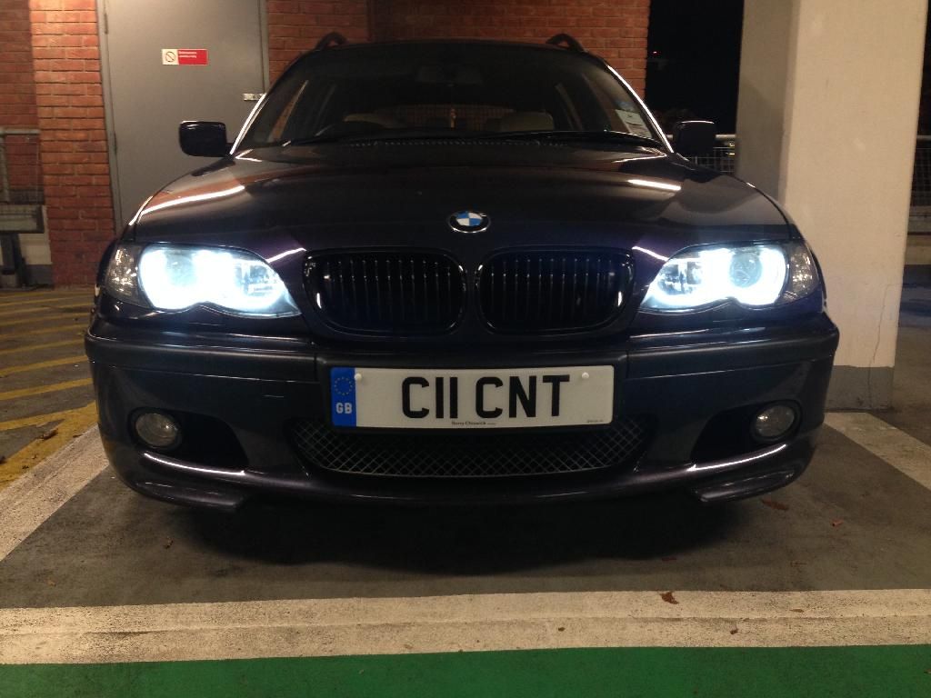

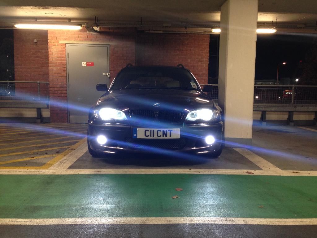

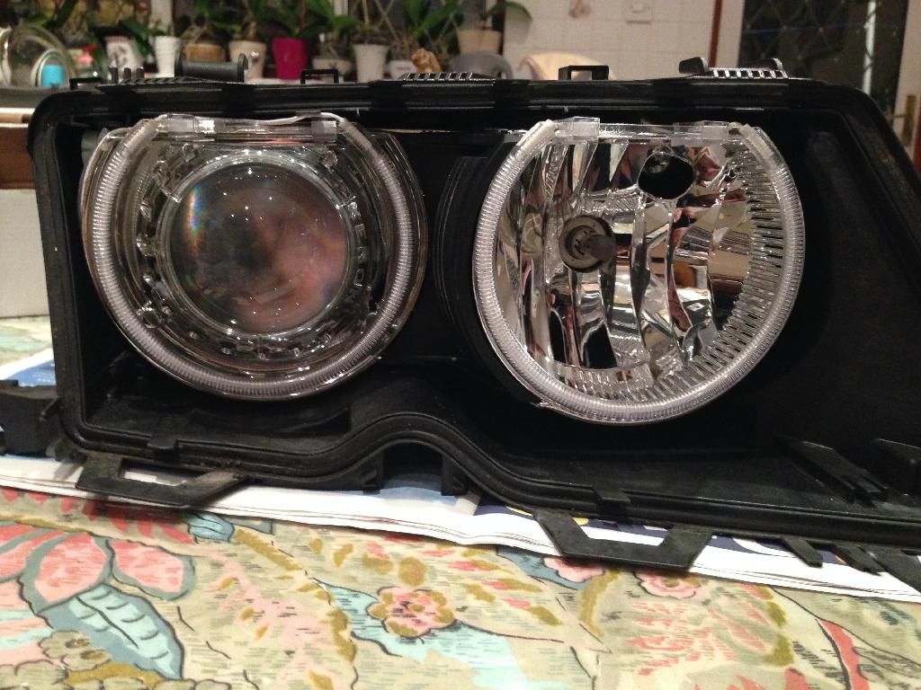

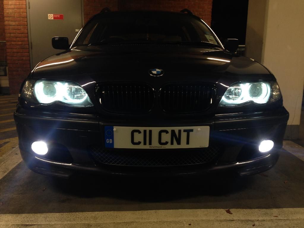

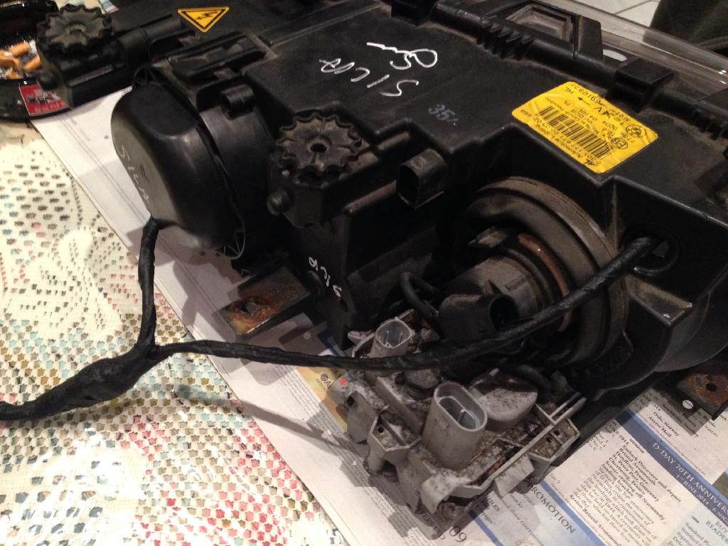

I don't know how I've lasted this long without xenons. I bought pair of genuine xenons (complete with ballasts and bulbs) the same day I bought the car and they have just been sitting there waiting to be fitted. But before fitting them I wanted to install some angel eyes. super bright LED ones were considered for about a minute before I decided to go with the tired and tested CCFL's with a 6000k colour temp. They look OEM and bar the light colour. I got 2 new bulbs (again 6000k) and proceeded to take the lamps apart and fit everything
Pretty straight forward stuff, the loom for the CCFL's was fed through the hole for the original 501 side light bulb on one side and and on the other a small hole was drilled through.
Once that was done I taped up the loom in OEM BMW loom tape. On the main beam side I mounted the ring slightly off centre. Reason being if you mount it central some if the ring gets hidden.
Removal a fitting of the head lamp units is straight forward and the original loom for the halogens plugs in normally. Now, I was expecting some possible flickering issues and I got them big time. This is due to the xenons using less voltage (or something along those lines) and I bulb failure on the check control system
To get past this you have 3 options
1- get a light control module from a xenon equipped car
The draw back from this is that it will flag up a mileage ardor
2- dick about with resistors
Not interested in doing this
3- re program the light control module with something like auto logic
I went for the latter option which was done by Jason at BW Chiptune
When you do this you loose the ability to adjust the head lamps from inside the car, reason being xenon equipped cars have auto adjusting headlamps
As I hardly ever have a heavy load in the back i just manually adjusted the head lamps to be level

CCFLs
LED fogs for when I'm in the urban cruising mood
And the xenons in all their glory
I do like the look the the fogs, they don't emit much of a beam and the Local Heathrow traffic unit didn't seem bothered by them as they look like daytime running lights that every car seems to have these days
On a final note, 17 wheels and winter tyres have been put on as well. I wasn't too fussy about wheel choice and I think they look alright. Tyres are 225/50's pirellis on the front and dunlpos on the back. The correct size would be a 45 profile but these were easier to source as part worns and have loads of tread

Stanced
appletree
- Posts: 3482
- Joined: Fri Jan 20, 2006 11:00 pm
- Location: Retford
Are the pirrellis Psottozeros or something simular? if so I fitted these to the missus Mondeo two winters ago and have been nothing but superb in the countryside snow we have here on un salted roads they were awsome.

Yes they are on the front
The back is running Dunlop winters SP's which I also had on the e39. Also a very good winter tyre

I have those CCFL fitted on my factory xenons, they look good, I also have headlight auto leveling system and headlight washers.....
... I believe the law now states a headlamp leveling or cleaning device is required for MOT if the car is fitted any form of HID lights. You might get away with it unless you get a really arsey MOT tester.... You gonna retrofit them?

Nope, to pass an MOT the auto level and wash devices only have to work IF fitted.mcbonio wrote:I believe the law now states a headlamp leveling or cleaning device is required for MOT if the car is fitted any form of HID lights. You might get away with it unless you get a really arsey MOT tester.... You gonna retrofit them?
Basically you can have HID's without those two things and pass an MOT as long as the beam image and colour are correct.
