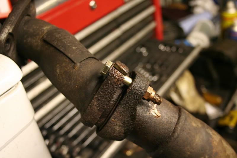

Also had a bit of a blow on the zorst so took it to the tyre place to get it on the ramp. A loose nut bolt
This one to be precise. I've put a concave washer on to see if that helps.

Si that bolt is shocking!
You spend £140 on seat foams but wont shell out on a nice stainless fastener :eek:
I hope there is a washer under that nut too.
I would never use plated or galvanised bolts on the lower sections of an exhaust, they dont last!
