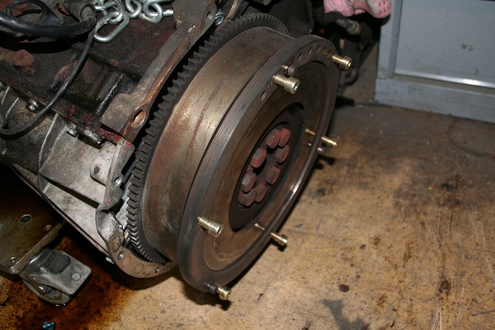

worlds biggest flywheel ever. A singlemass lightweight job could transform this car I expect!

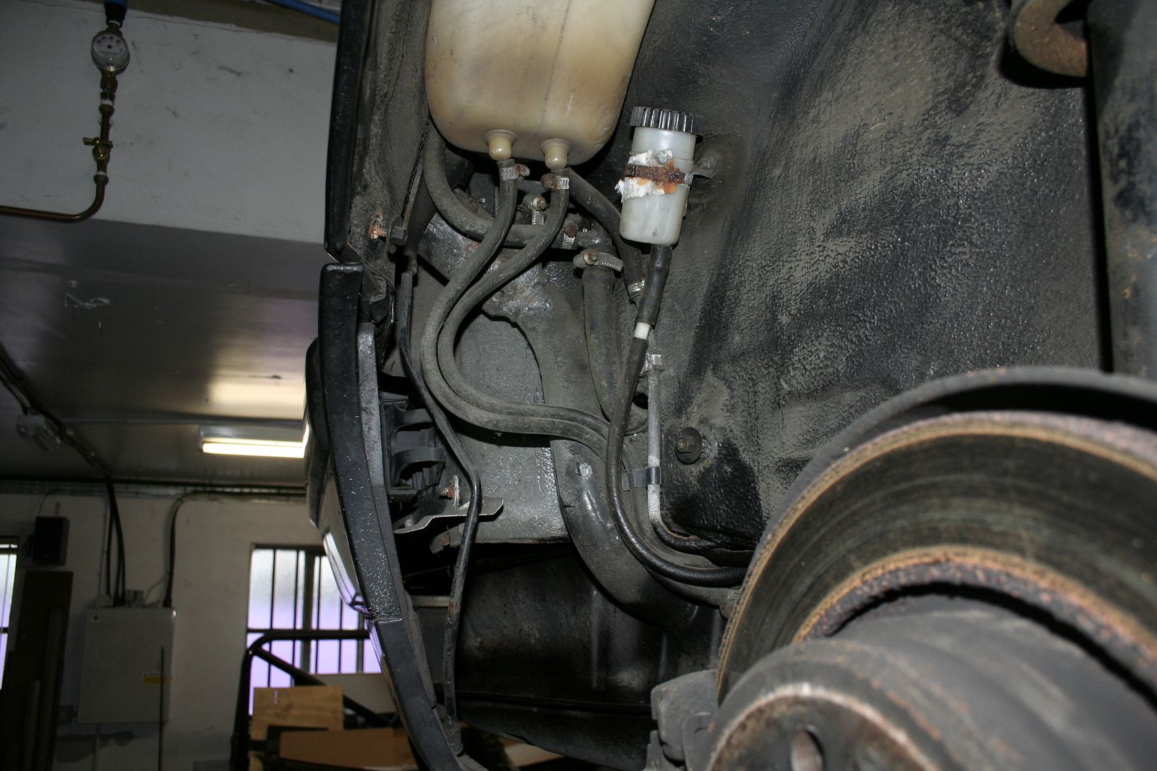

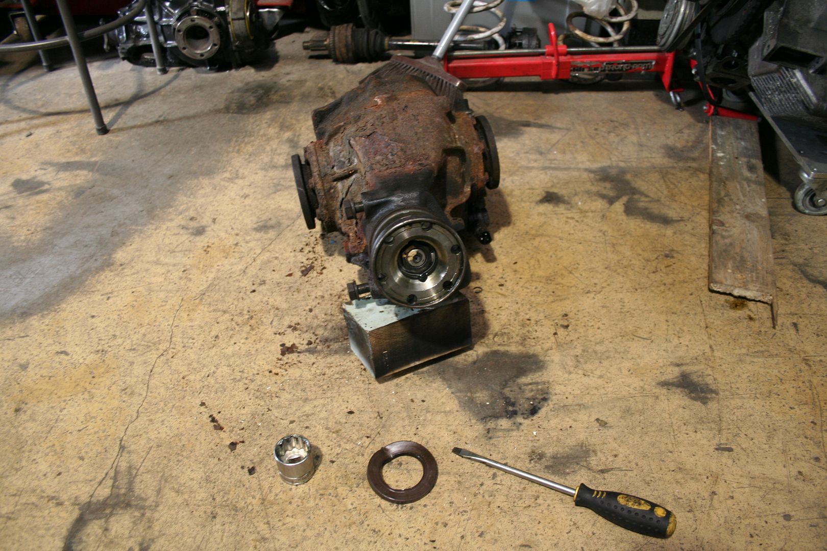

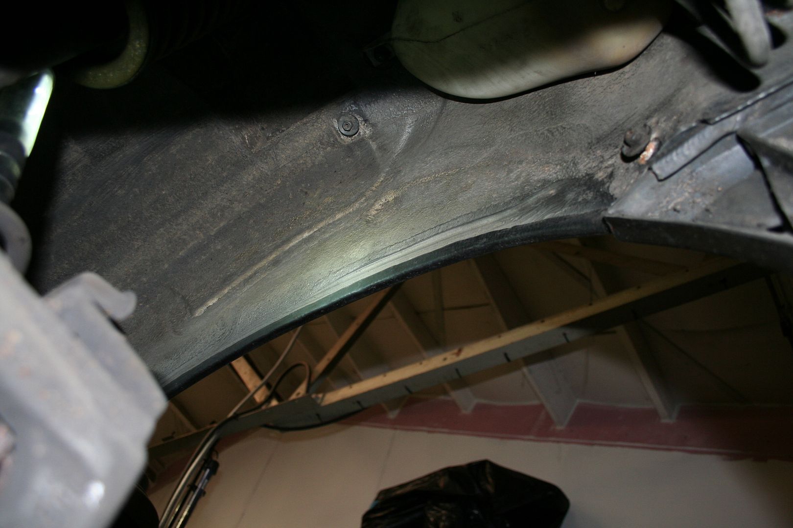

I've been cleaning/wire brushing/ protecting brake/Traction/SLS pipes along the way. Like the diff oil cooler grill thingy. Nearly filled a tray with built up mud..........
if only e30 rear arches looked like this after 20 years!
New prop centre bearing mount. One of the few things I can get aftermarket that's available and not made in Italy
This oil seal was pissing out, strange as Birds garage did it a couple of years ago according to service history
New seal in, lets hope it all stays oil tight longer.

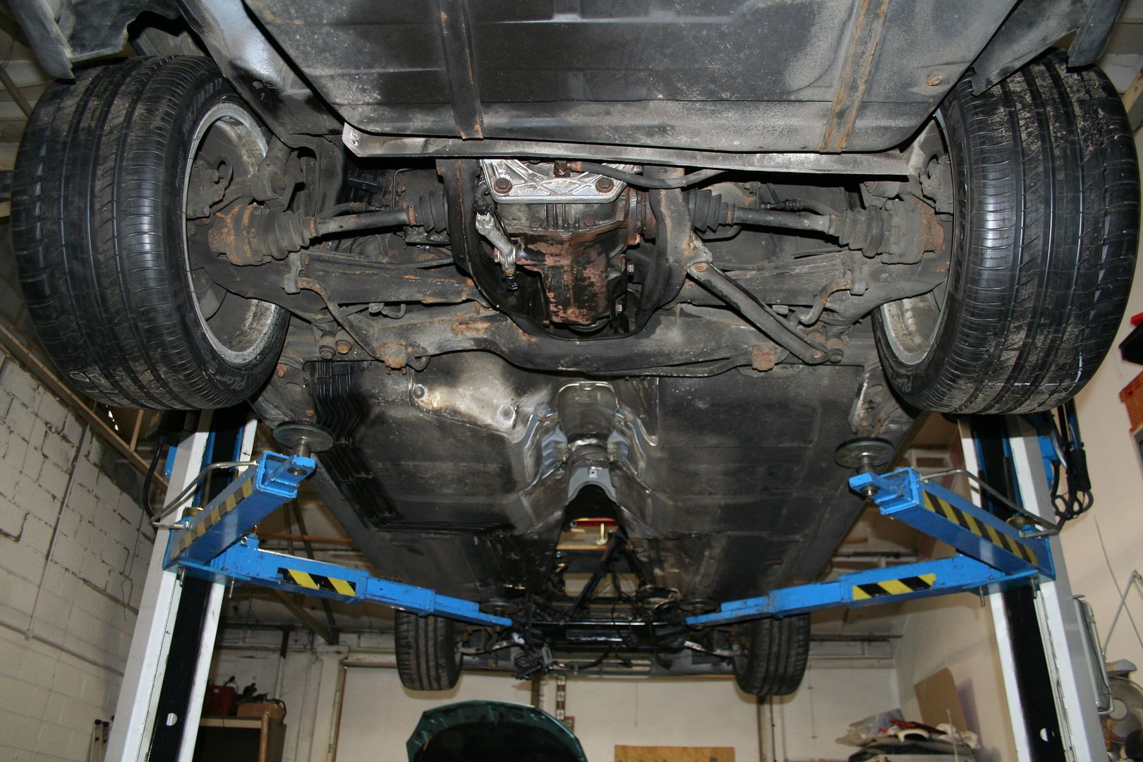

Nice you got a 2 post makes life a lot easier, you bolting the snails on and dropping the car onto the donk ?
got to be better than going in the top and getting rash sticking the blowers on in place?

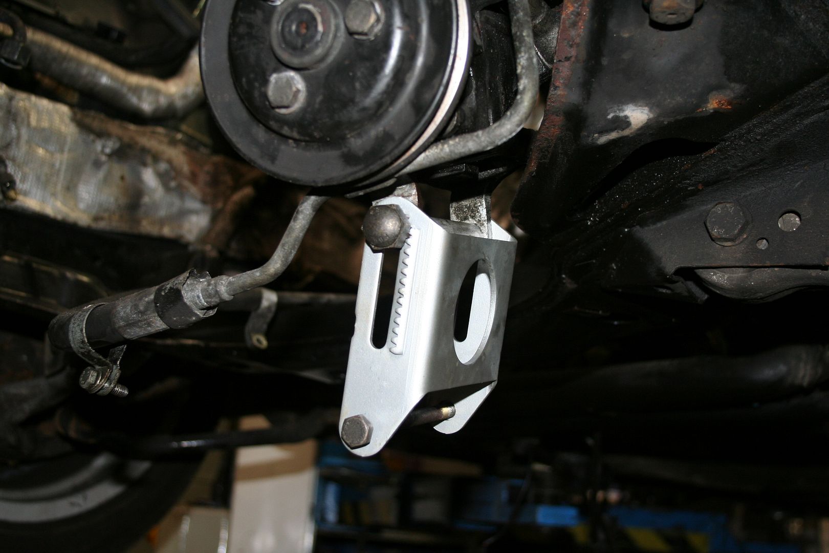

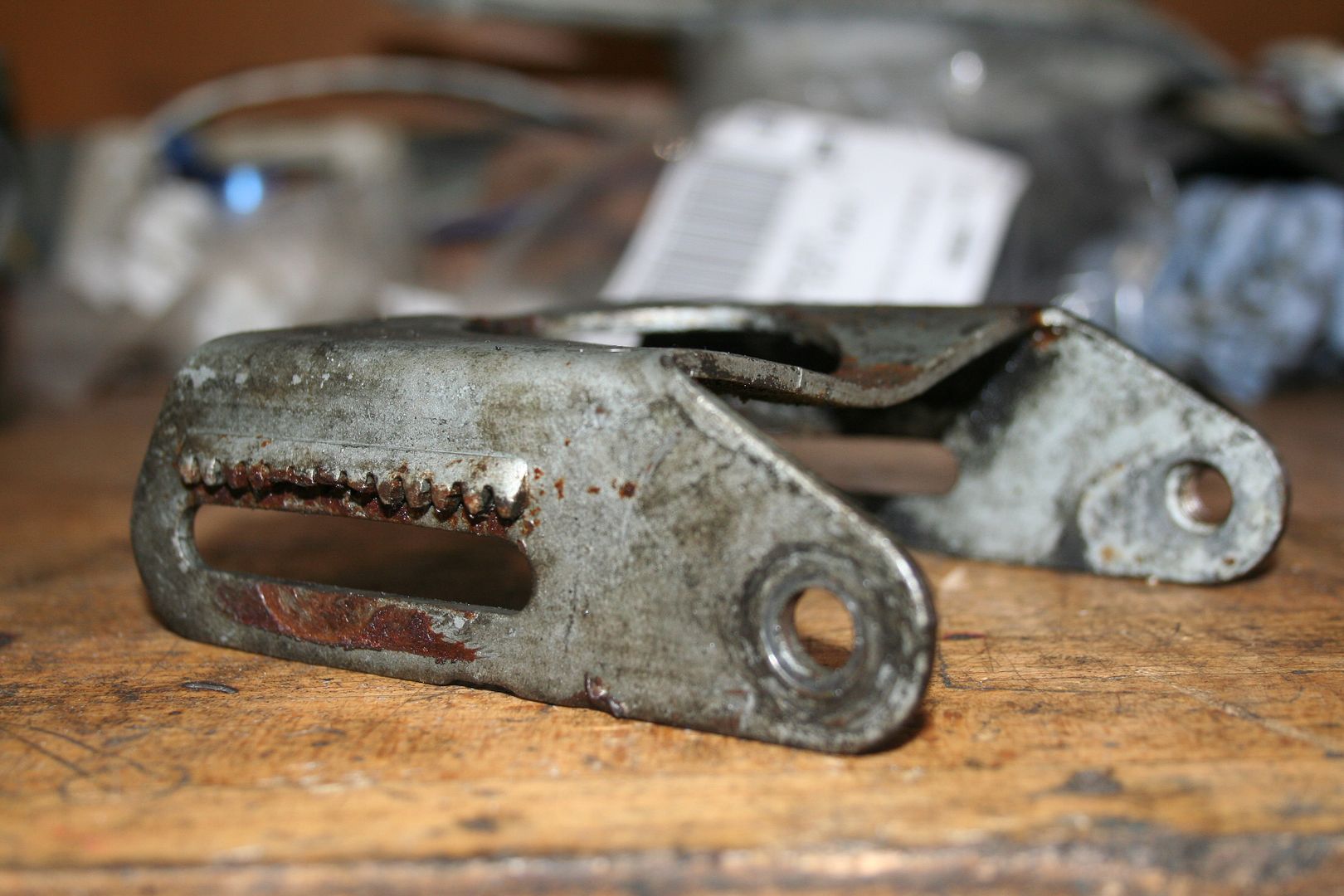

PAS adjuster bracket. Last one from Germany so the dealer said
This motorsport item's days are over. Garages eh? under £5 it cost

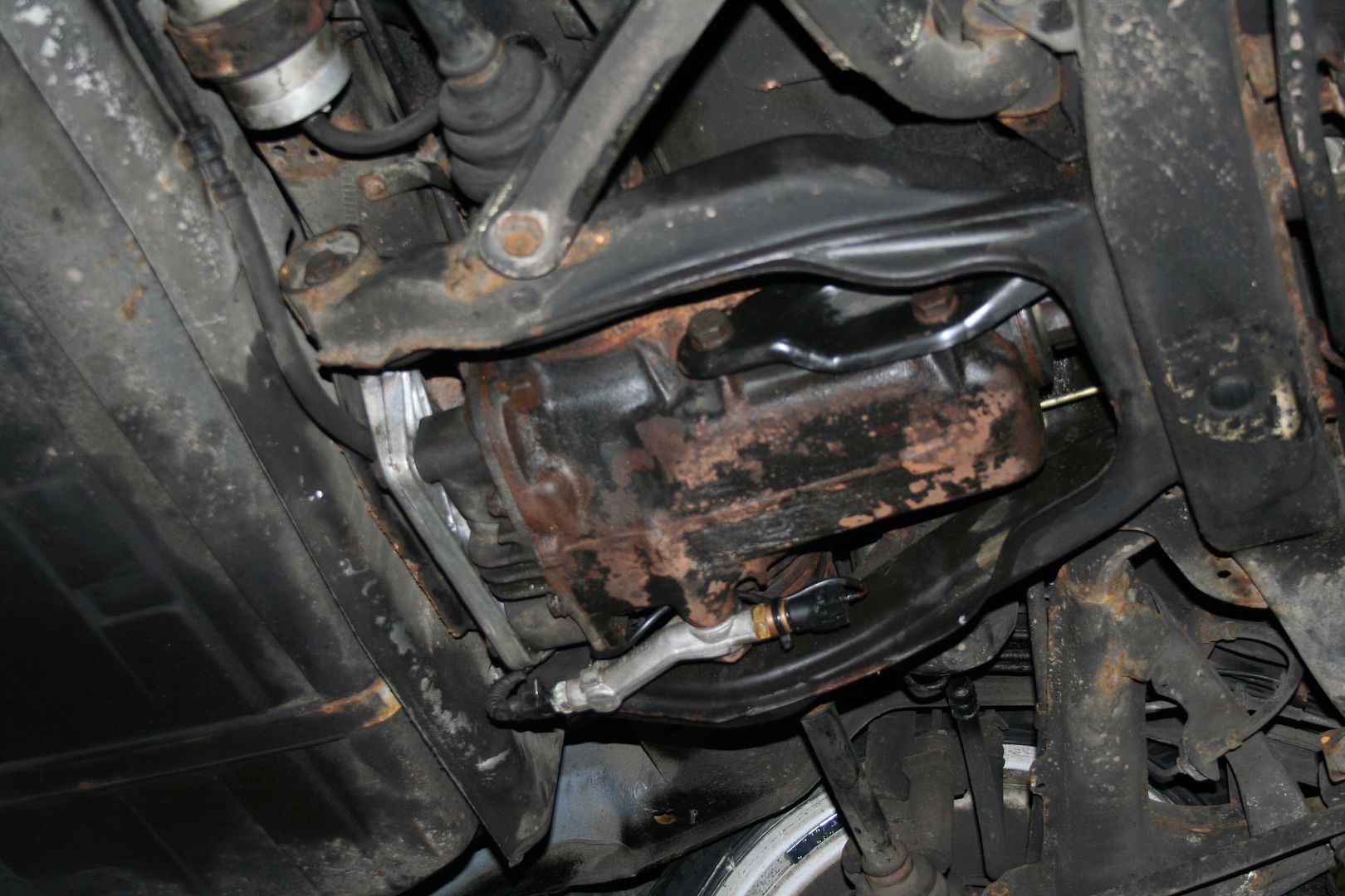

Big diff in situ. Was a bit trying on my own. Connecting up all the oil cooler bits and plugs is fiddley. No more oil leaks lets hope
Love a bit of bespoke alpinaness 8)

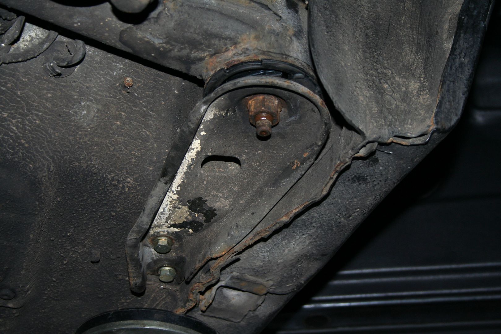

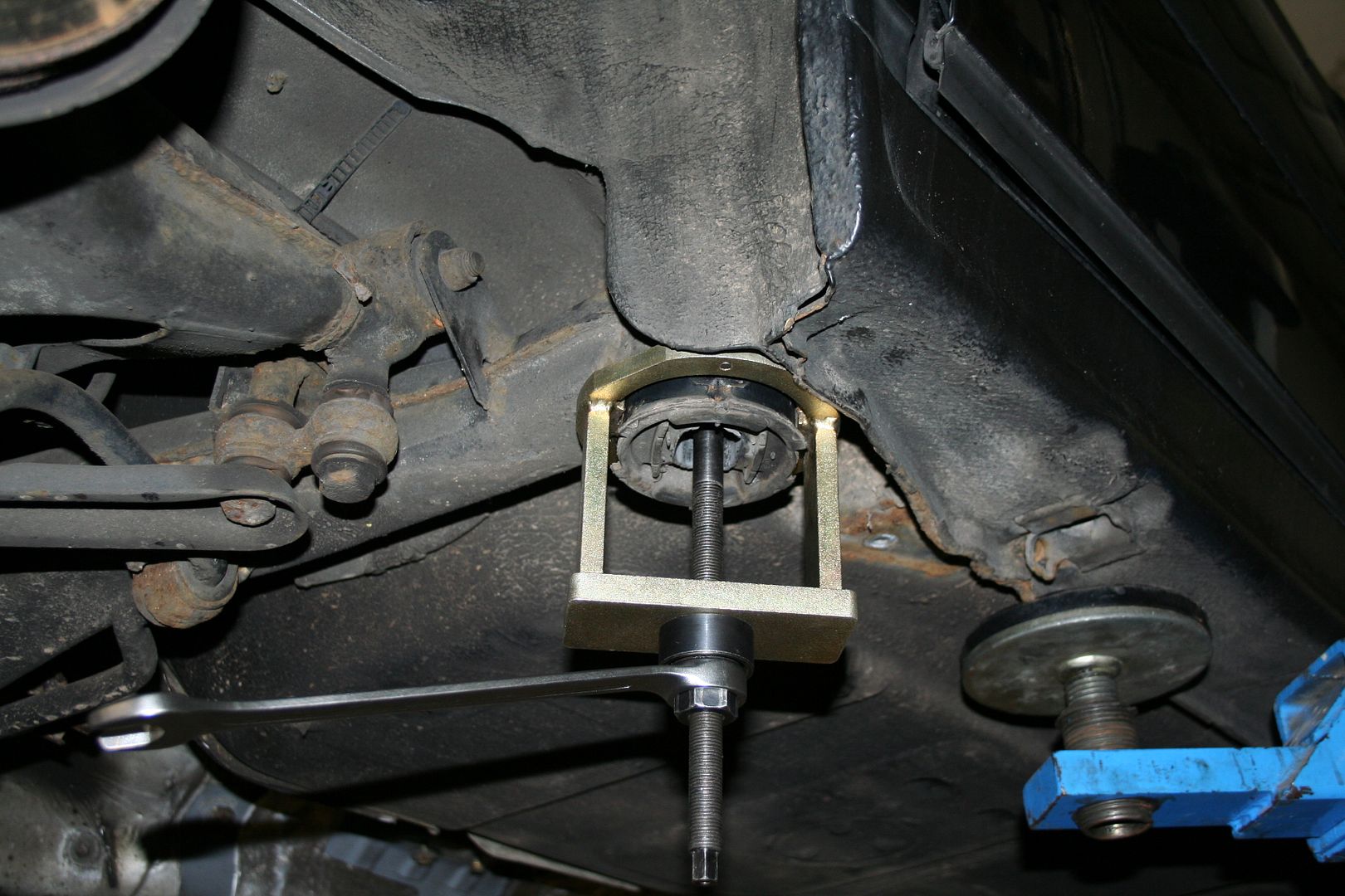

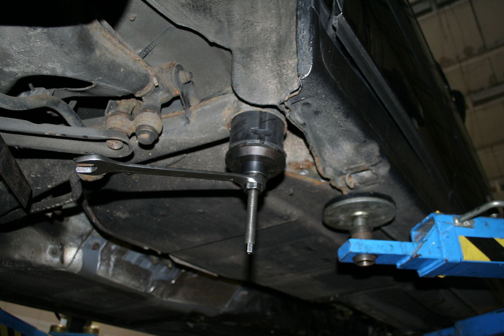

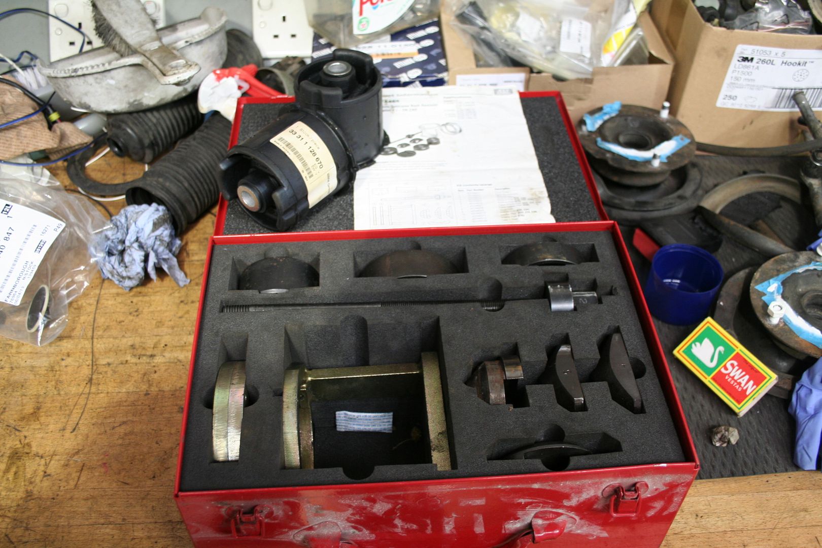

Subframe bush time! With the proper tool lent from Barold the 3rd of course.
Nice bush eh?
half the old bush coming out. The middle fell out with the slightest of wiggles
Winding new one in......
Bolt the plate back on, repeat on the other side.
The old bushes were 2008! considering the previous keeper only averaged around 5000 miles per annum they don't last that long!

Why such a big flywheel on them?

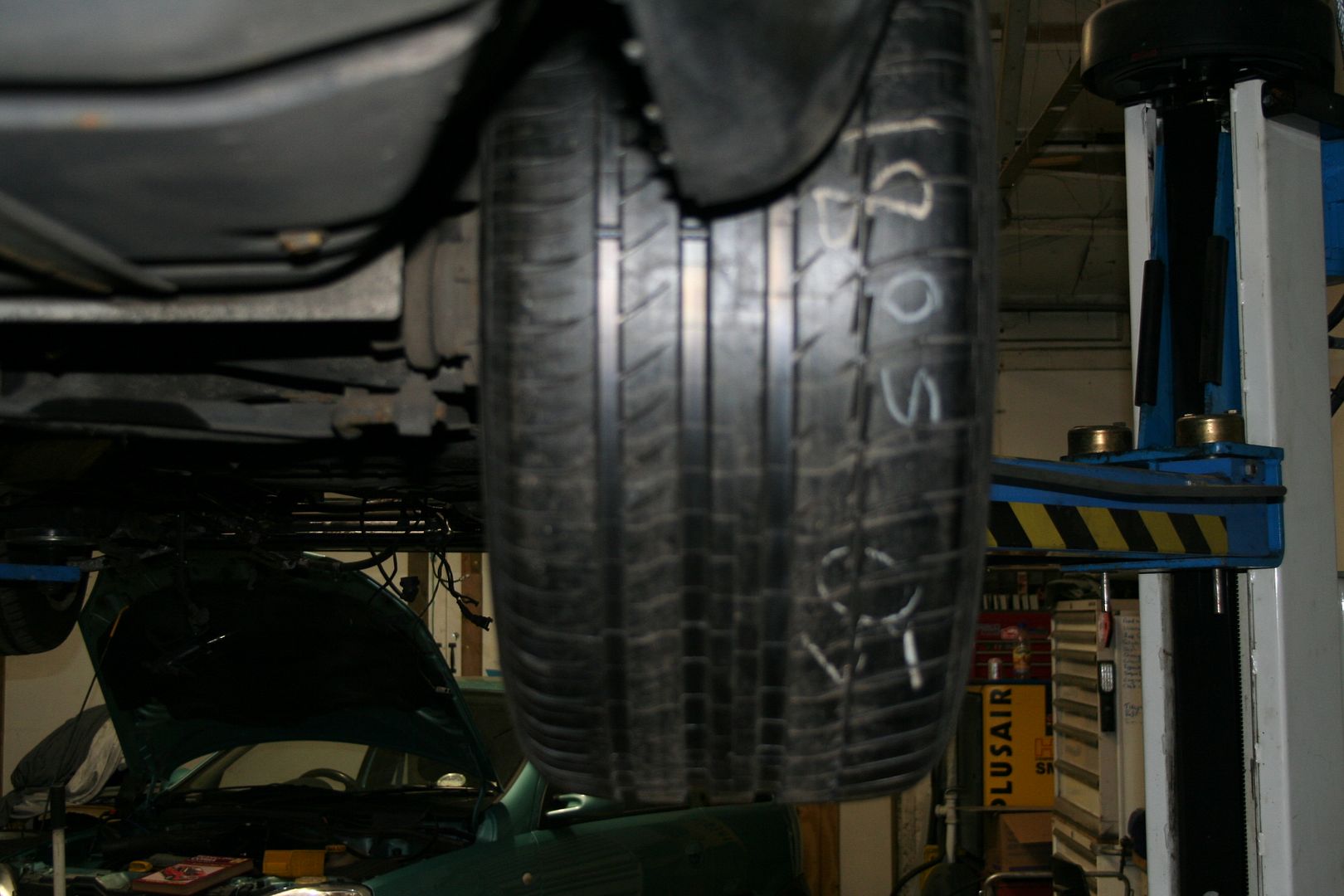

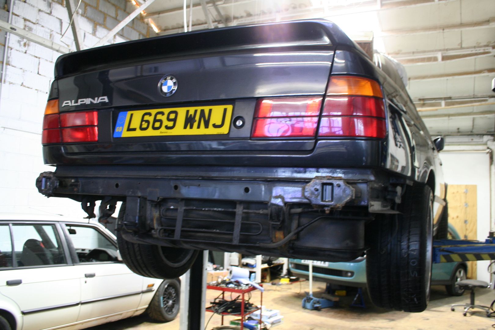

Look at how wide these tyres are!
Keep them slightly under inflated or the middle will wear quicker than the edges (if all the geo is spot on of course).

They are indeed epic. I swear this thing looks better from underneath!
Is that wrong?
