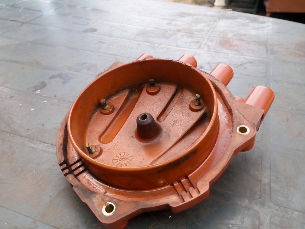

It's had a recurrent misfire for the last few months, came and went.
I put it down to use patterns; 20 motorway miles to work Monday, 20 back Friday, almost nothing more. Later I read that a worn dizzy cap can cause this, along with loss of power, economy etc.
It's the same part as a facelift E30 320/325i cap; in a few places it was cheaper to order it as such...
Anyway, here's what came off (both caps looked like this) :
The brass contacts are grooved over a mm deep, furry and green. The carbon is gone and the spring is visible about 8mm deep in the hole. To fire a spark plug the ignition would have had to bridge both of these gaps, too!
Going by the embossed date, they were the original parts. If the replacements last another 19 years I'll be very happy :mad:

Shocking :duck:
Post Wed Jul 27, 2016 9:06 pm
you might get 13mpg now lol. It should certainly run and accelerate better with new ones looking at them! 8O
