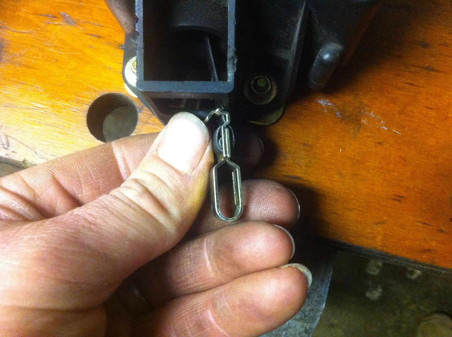

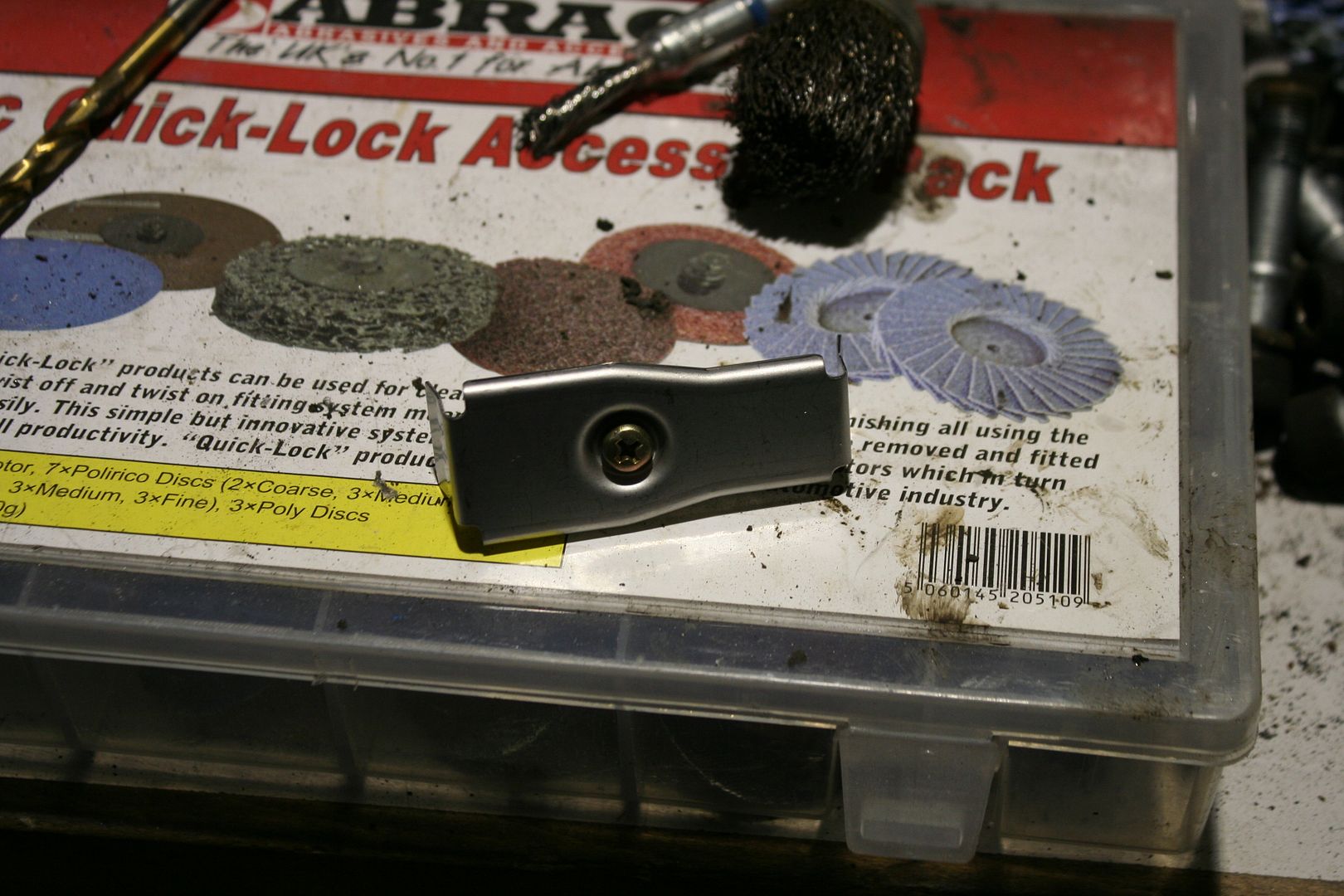

As stated before my cruise control suddenly sprung into life literally. But i'm now thinking this was the fault i had all along. When it wasn't working correctly if at all.
Where my fingernail is pointing this should be flat not bent over like so, this was jamming or causing obstruction or both. Anyhow i guess it is my fitting error that may have caused it. I've a spare actuator in stock and voila i've perfectly functioning cruise control now after an extended test drive it and feels as it should to me now.

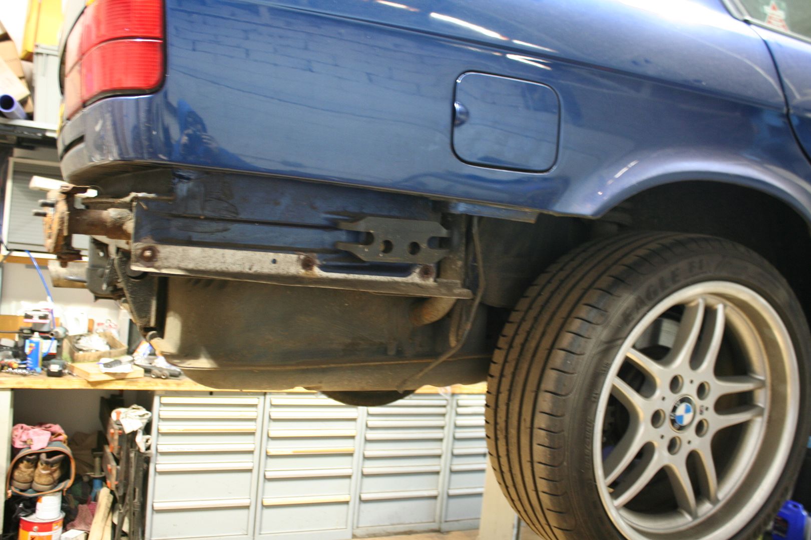

Metal fuel tank though innit. If you haven't already, it's worth taking the rear bumper off and replacing the steel fuel line.
Post Sun Nov 16, 2014 10:30 am
And? the whole cars metal, its an e34. Proper motor. That rusty vent fuel pipe thing is blown out of proportion my bi turbo and iX had pipes with no rust on them!

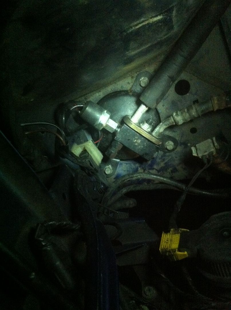

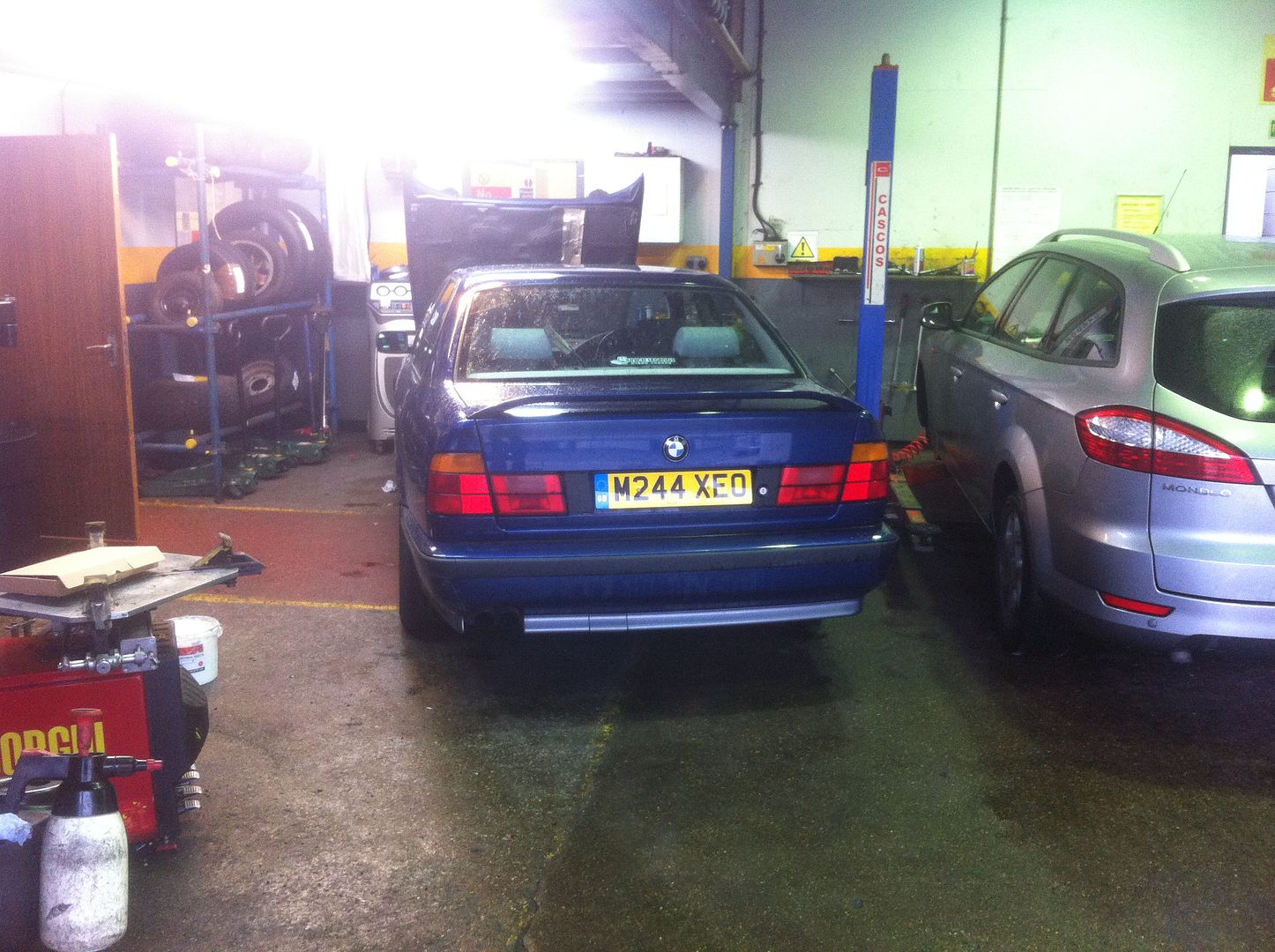

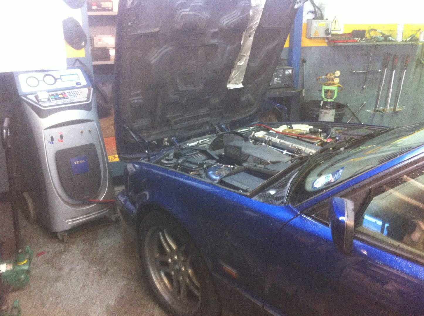

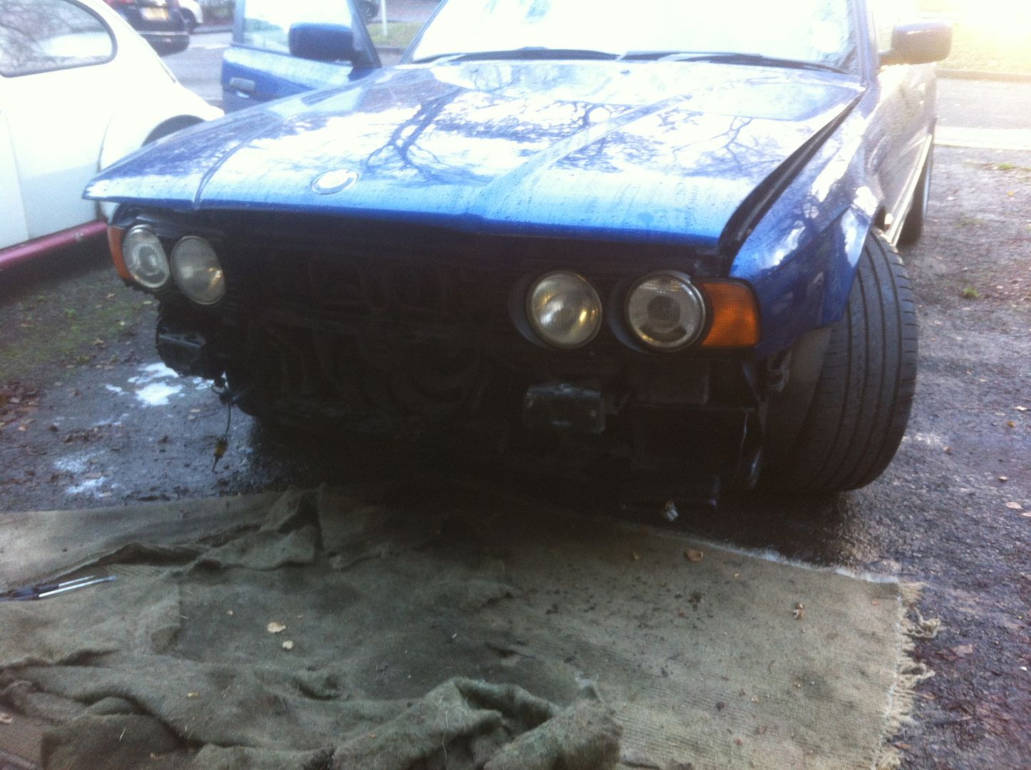

So this week has been air con time as its the right time of year :o
I whipped the bumper off and trim for a good inspection of the fan, condensor and much to my surprise the fan is unseized and the condensor looks to be in very good condition. Result, as its an M5 specific item i learnt this week. I unplugged the fan and gave it 12 volts up its chuff to see if its working on both speeds which it is, someone has in the past replaced the resistor in the past as there is cut wires and heat shrink evident. Nice to see a decent electrical repair for once instead of sctotch locks and electrical tape!
Its also just dirty under here and not all crusty on the edges like i guess cars with alot of winter driving end up like
So i've took a chance and just changed the dryer and pressure switch and a take a chance on the gas up
The compressor also moves nice and freely so in theory it should go again?
Upto my local tyre place yesterday as they'll gas my aircon for me for a nice crisp £20 note. Lovely chaps they are
First off was to see if the system held pressure with some nitrogen gas at 10bar for 5 mins and see it holds. Which it did so then it was onwards and the 40 odd minute wait it takes the machine to do its thing
And we now have some nice cold Air con again! I don't know how many years its not worked for but there appears to be a tiny leak from the smaller charge point valve. Being a 94 car it looks like it may have been R12 from factory? As it has the 134a valves screwed on. I've got spare a brand new valve any how so i'll see how it lasts and i may have to change that valve and it should be 100%
So thats another job kind of done and shes coming back to full health nicely now, all the electric windows work ok along with the sunroof, check control doesn't throw up random faults, cruise control added and now the a/c is working its becoming more like an M5 by the week. Still lots to do though

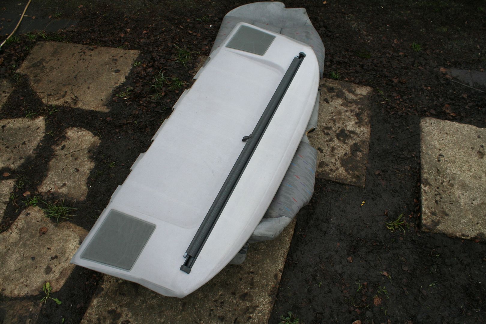

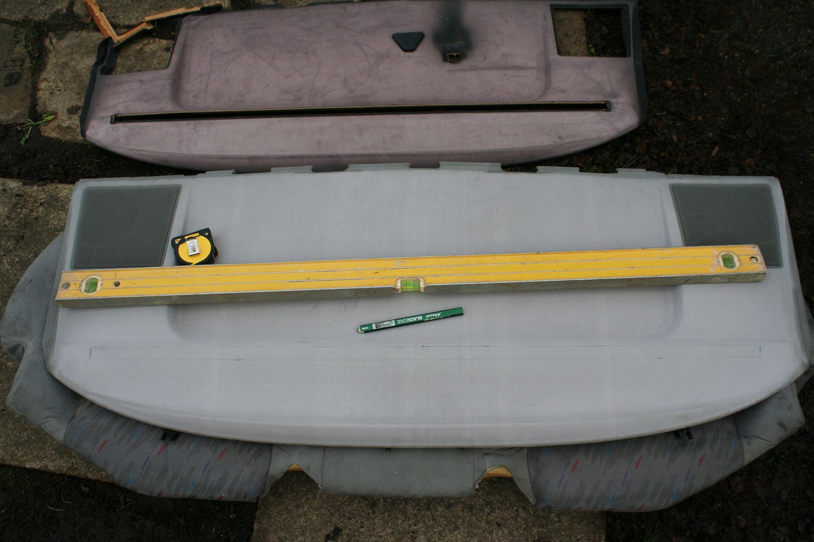

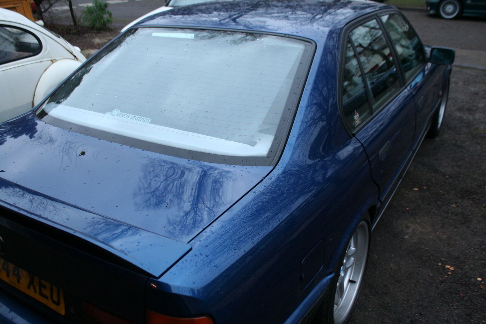

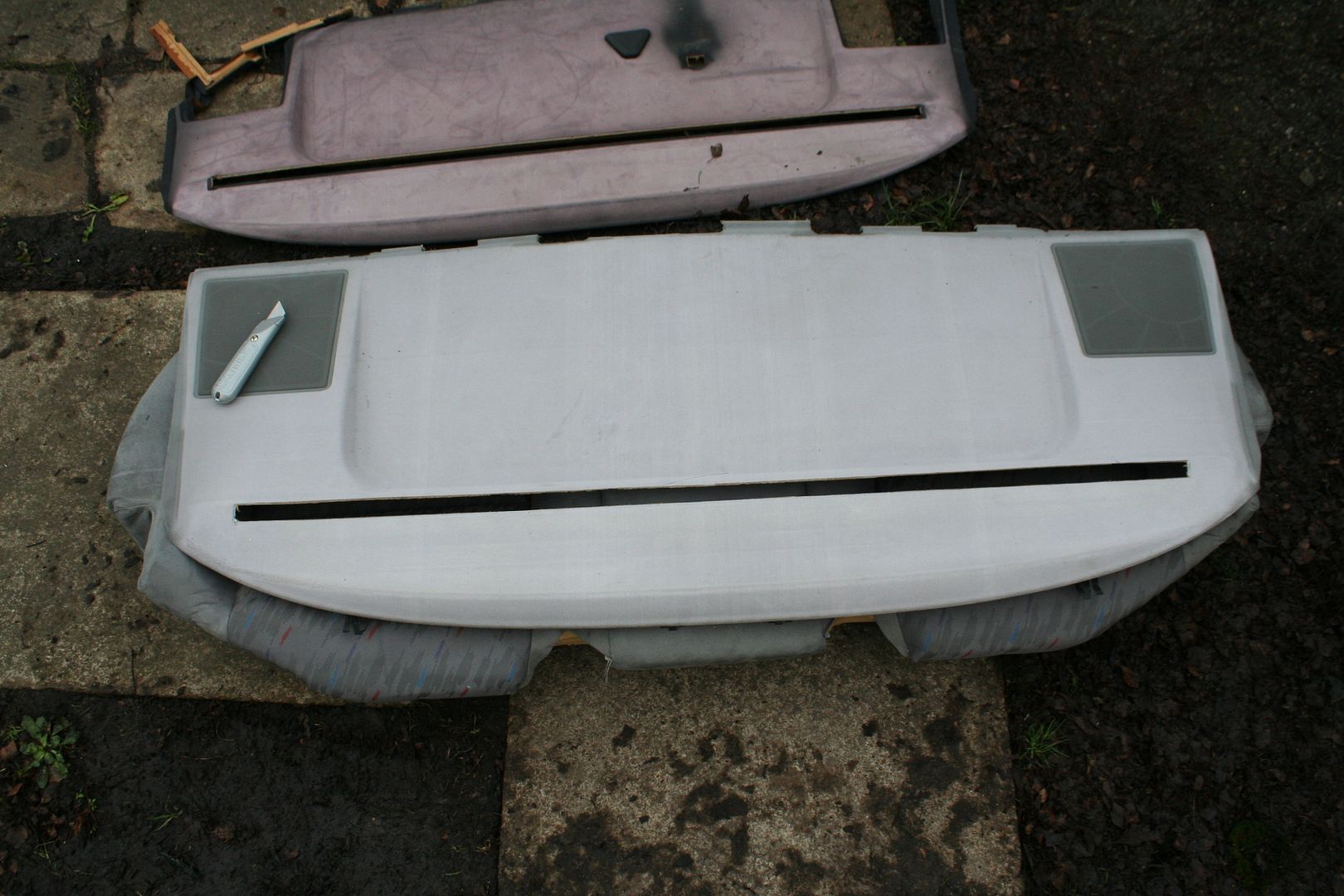

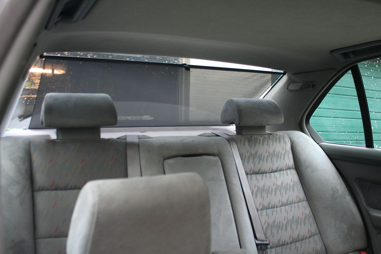

Rear blind time! I've a major fetish for shelf/door blinds and i bought this one off m-sport a few months ago but had a crack yesterday at fitting it. e34 shelfs are the same moulding whether its got a blind or not so it was time to crack on mark it up and cut my shelf
hole cut, i cut the cloth out with a knife and then i cut the shelf with my 4 inch grinder with a 1mm cutting blade, worked a treat
blind fitted in not too bad, but i can't get the end clips in properly so i'll need another go later on to get it perfect
And shes in and up, next up is door blinds which i'm working on as we speak.

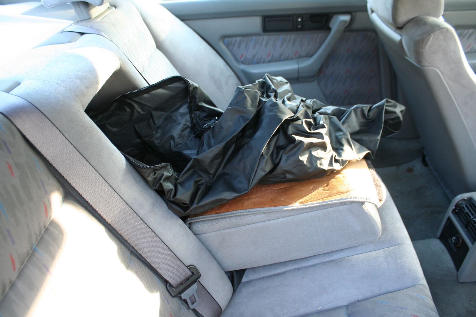

Found this? Ski hatch bag option thing?

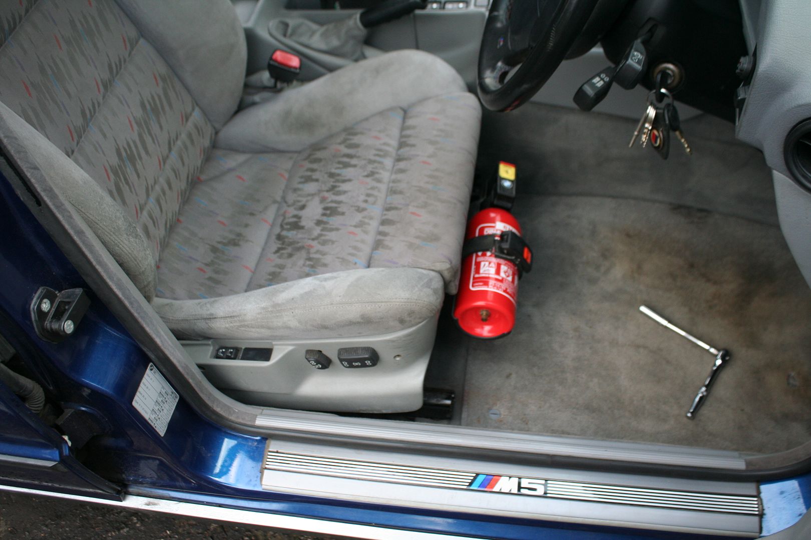

I also remembered i had a fire extinguisher bracket and spare bottle so another trinket.
Dare i say it the grey cloth trim is growing on me :o: I need to wetvac the drivers seat but the rest has come up nice with a hoover. How do you clean the alcantara bolsters anyone?

Did you have to pull roof lining down to get the blind clip in place Si?
Need to do the same mod on my m5 so thanks for sharing :thumb:

M-Sport wrote:Did you have to pull roof lining down to get the blind clip in place Si?
yeah the brackets for the clips are there in the shell, you just "bend" the headlining down a bit and you'll see it.

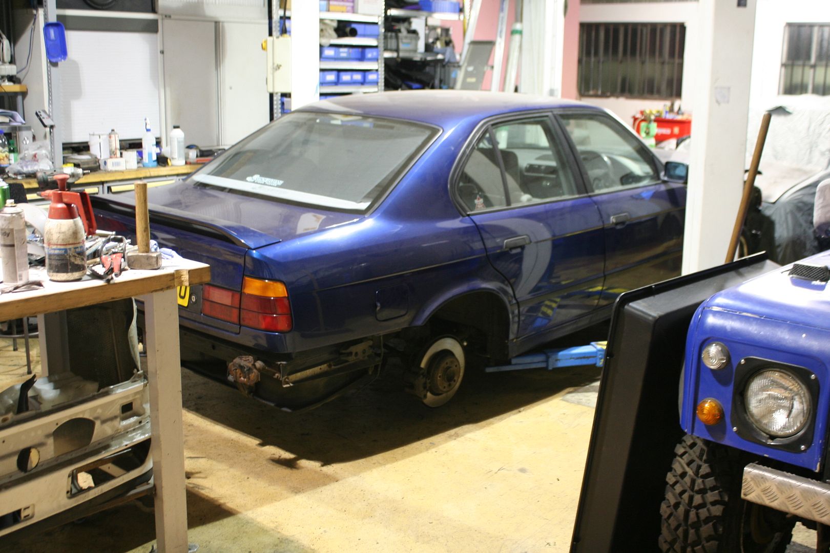

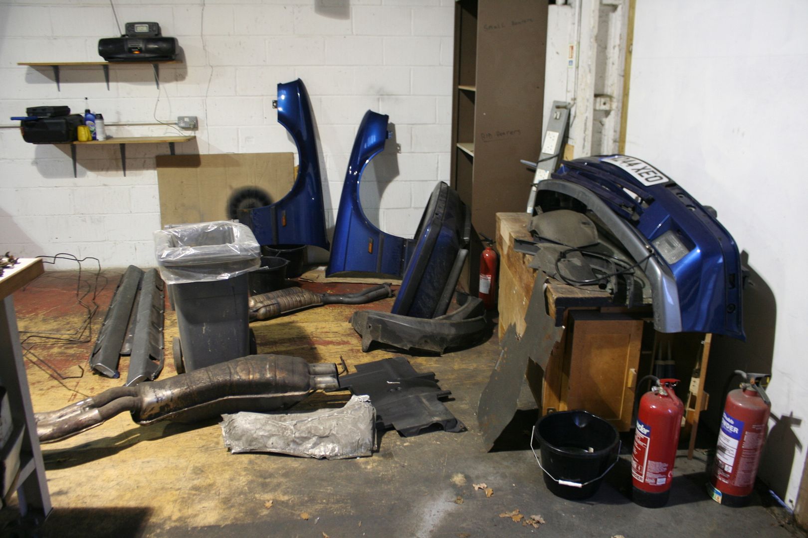

Post Tue Feb 03, 2015 8:07 pm
Men, rejoice the mig welder is coming out! :o Sill covers off the lot. MOT time has come, failed like i knew as i poked a hole and left it 8O
Henry hates me :D
Currently in a million bits and taking the bull by the horns in the usual fashion and eating my wallet along the way. :cry:

I thought the sills had been welded up in bobs time with it?
Post Tue Feb 03, 2015 8:48 pm
They have, it appears they only welded the outside of the sills and skipped any of the inside work. :o
I've got lots of pictures to digest and too many beers mean i'm not functioning correctly at the moment for a picture fest.

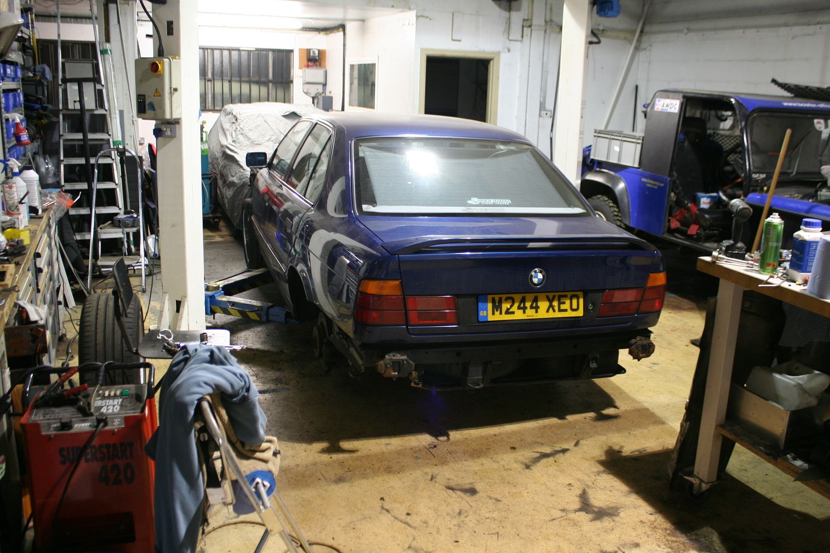

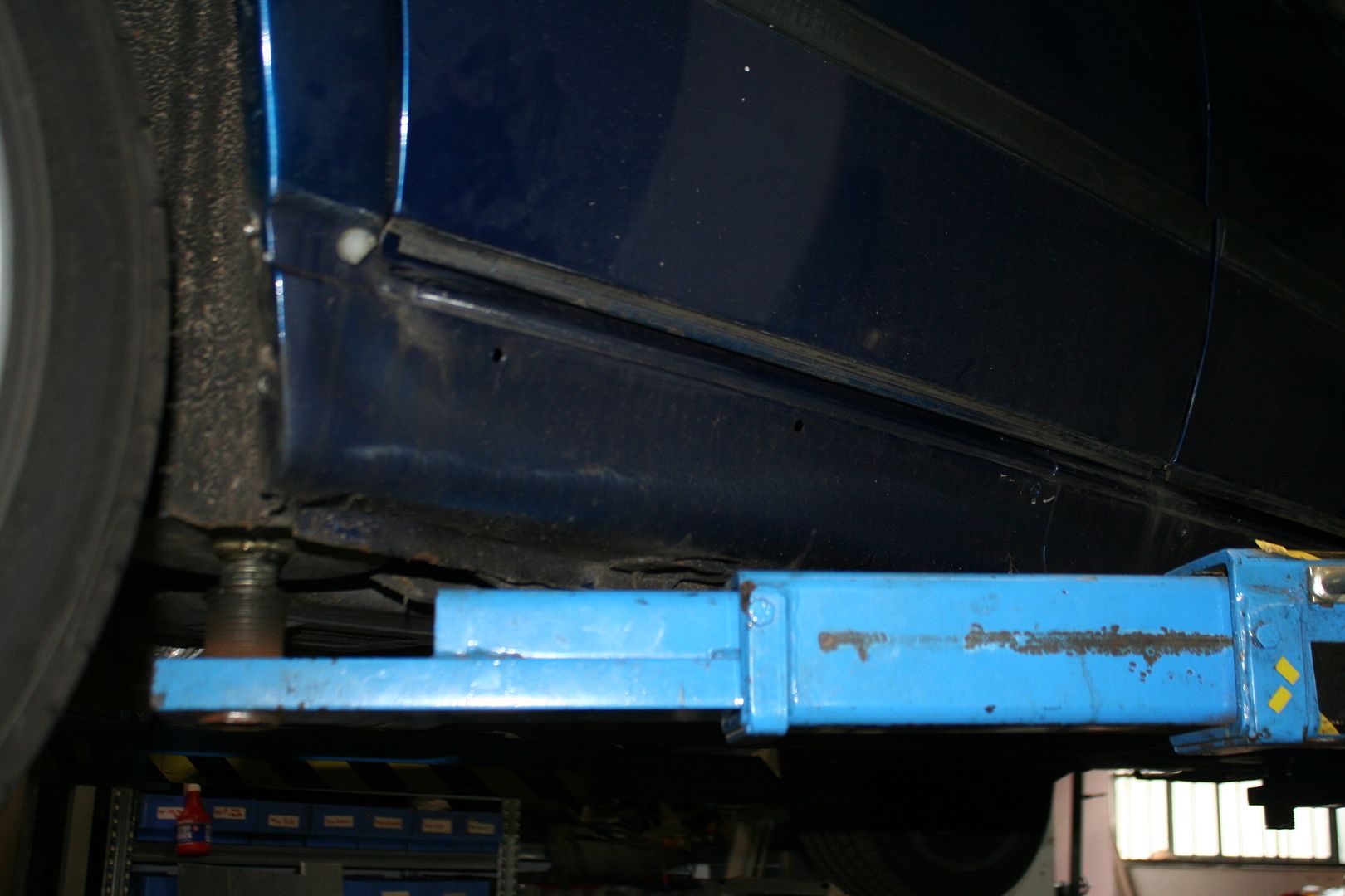

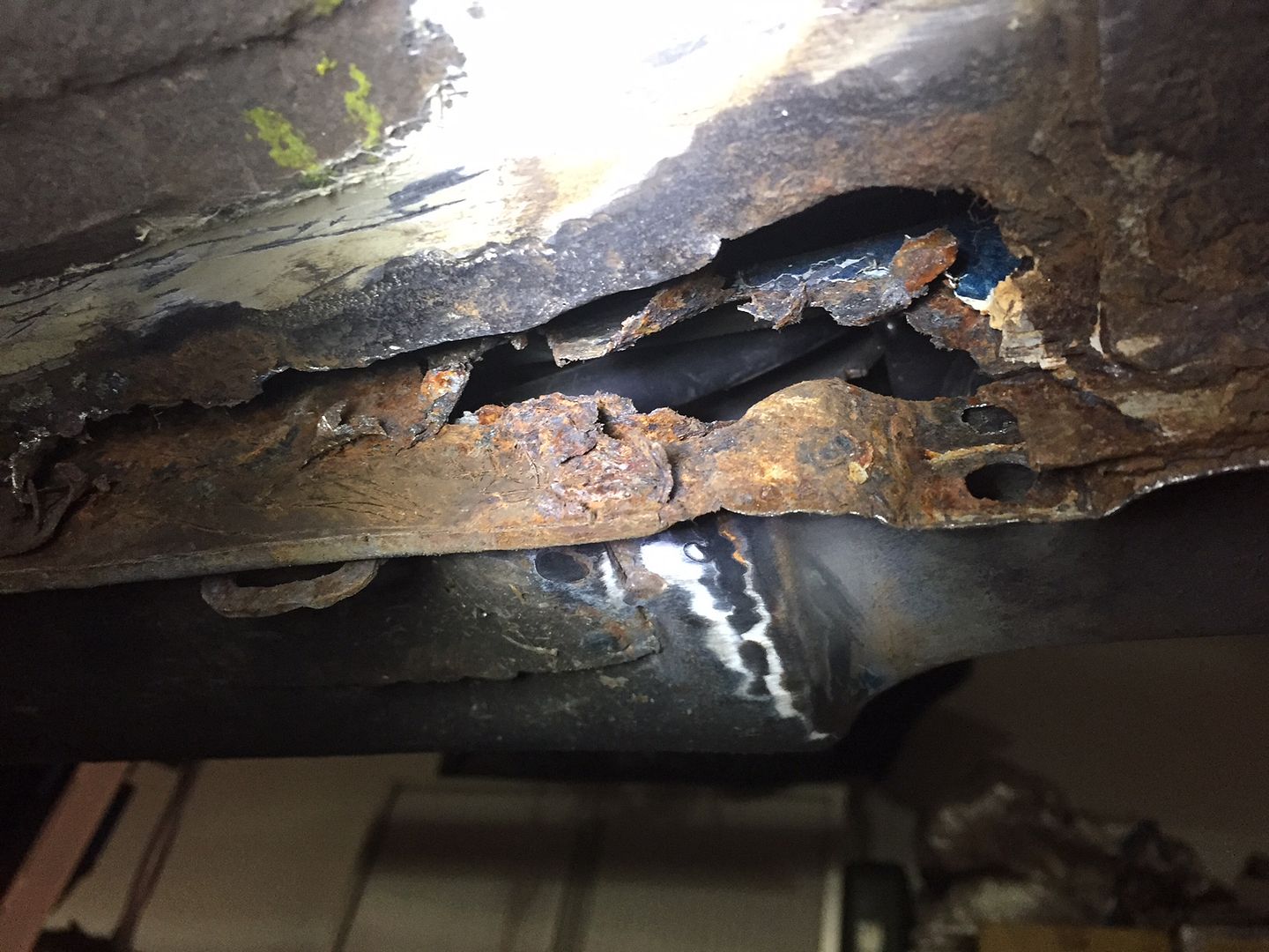

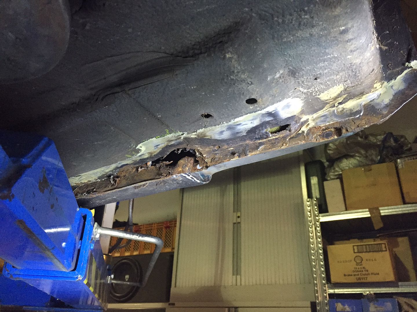

Well i was having fun with my door blinds project, but its kind of been put hold as an MOT fail has ment some more serious work.

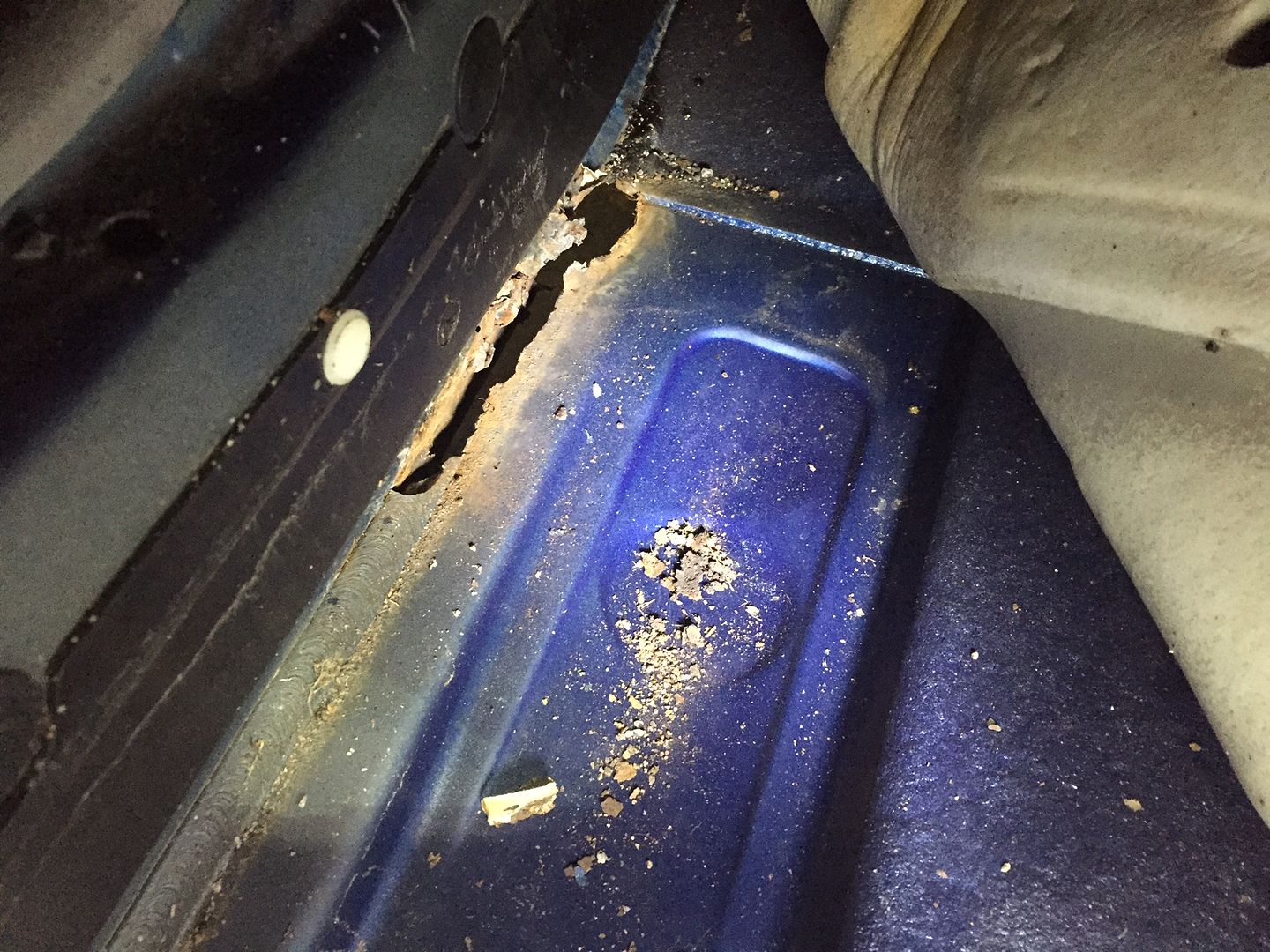

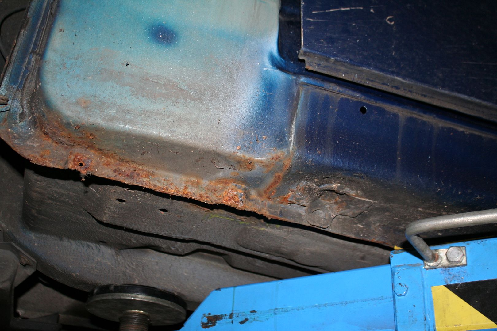

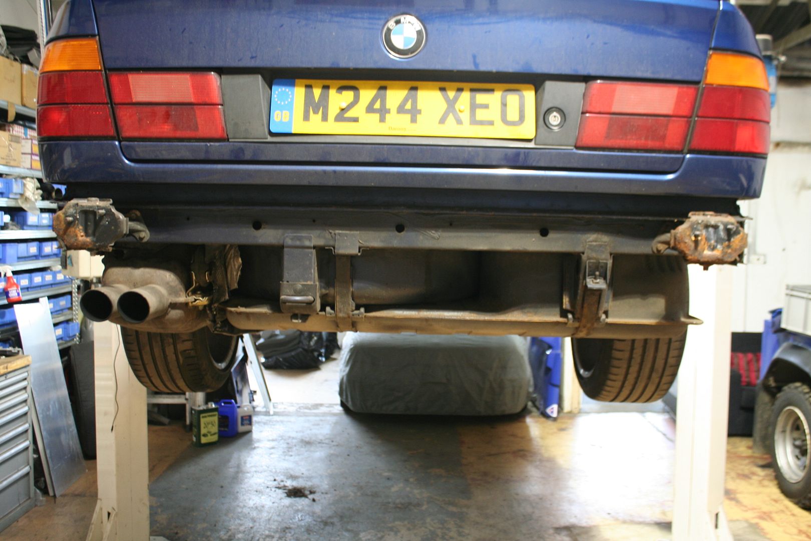

We've ended up here a no doubt familiar place for my e34's :?

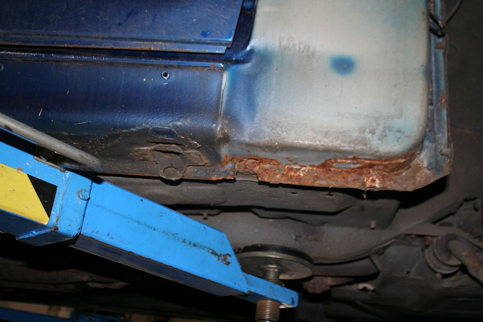

So failed on nearside floorpan
advised on
offside floor pan sill area

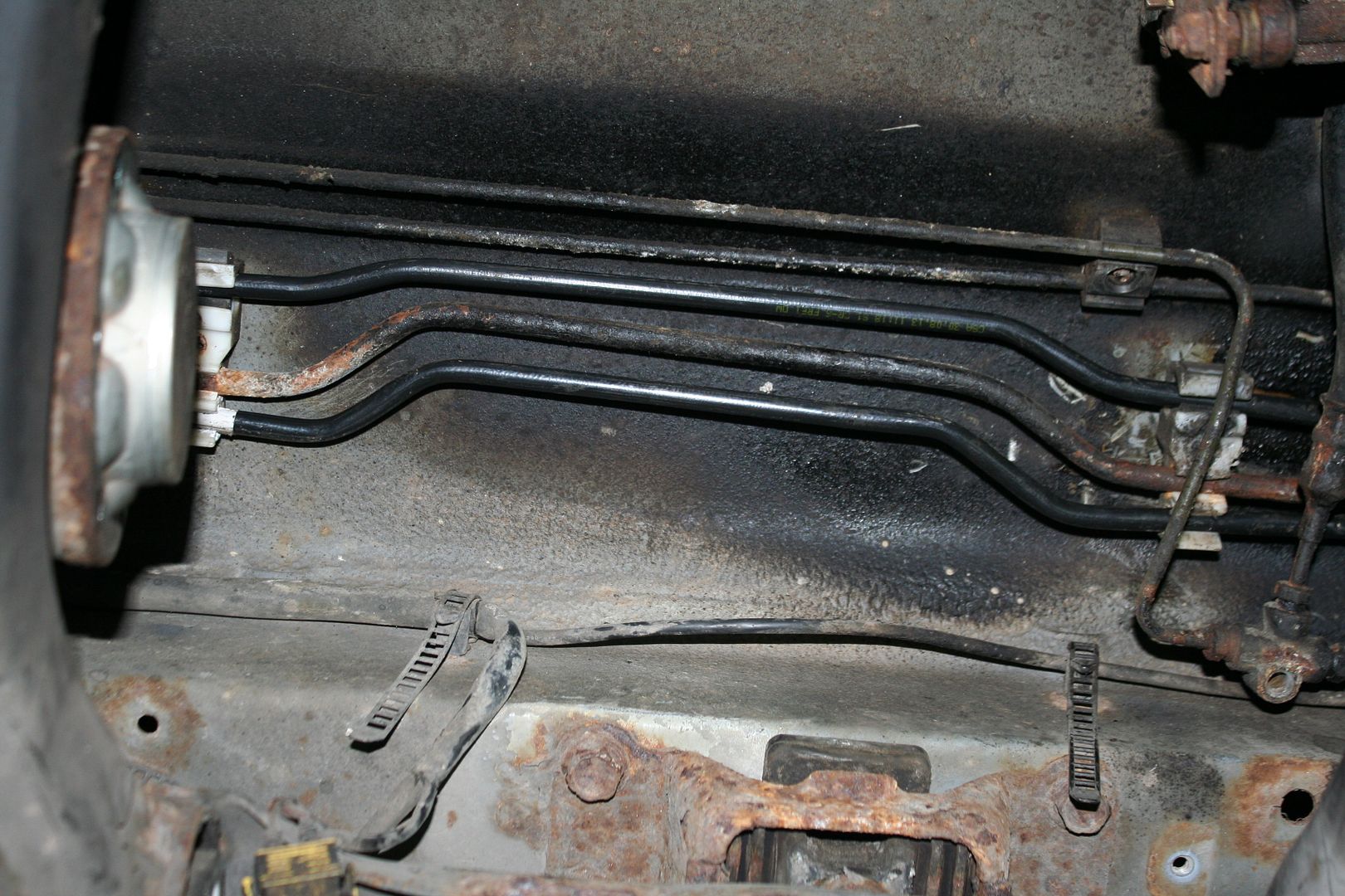

rusty fuel lines
windscreen chips
1 brake pipe slightly corroded.

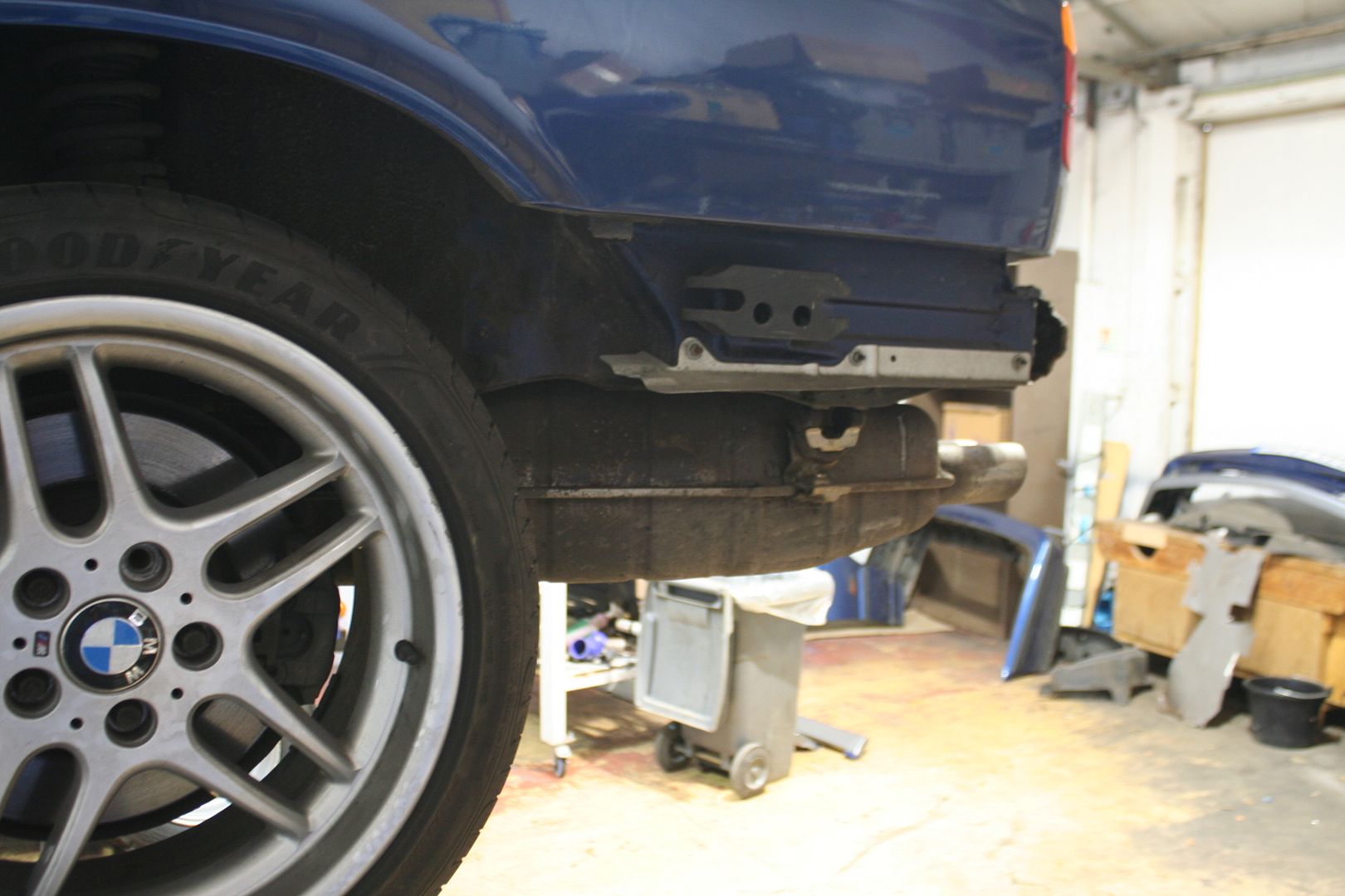

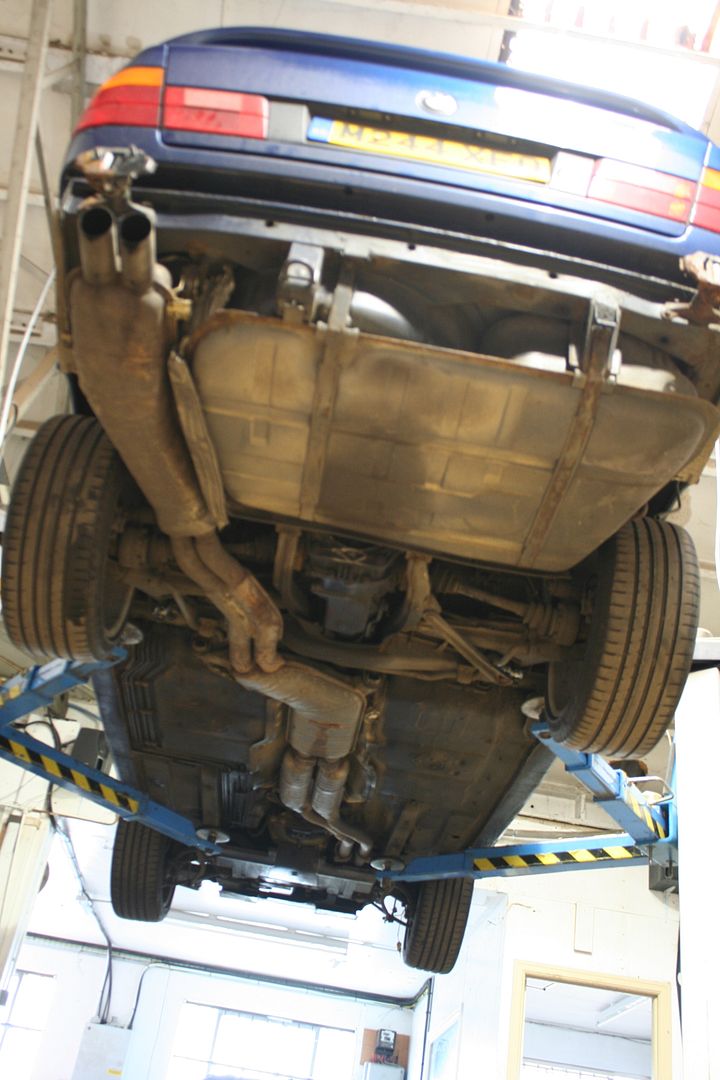

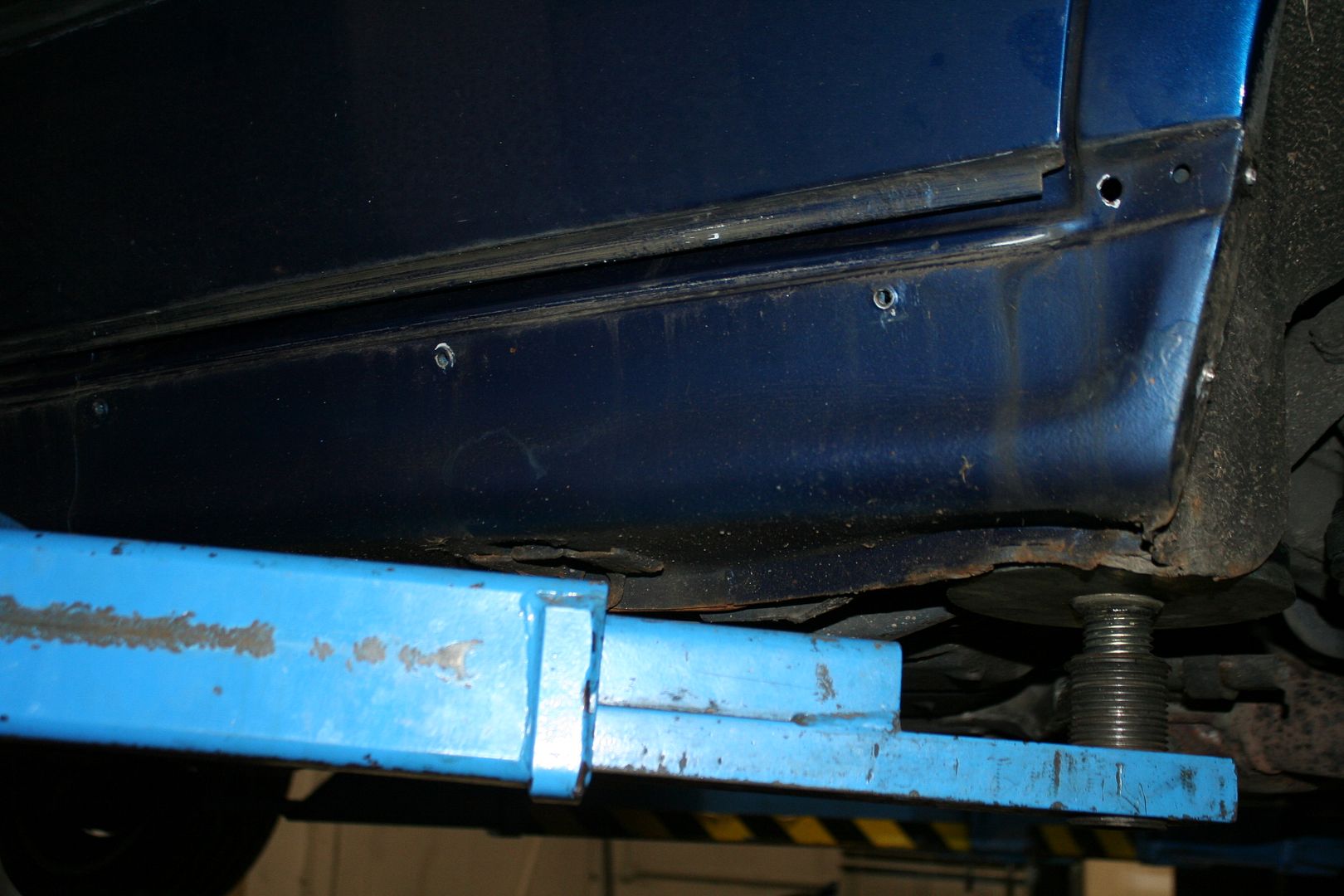

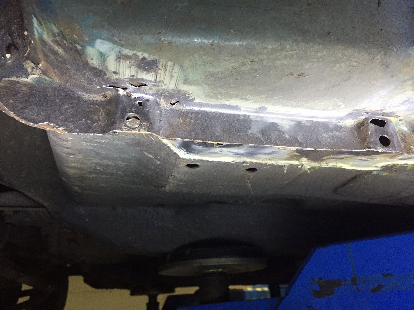

So off with the sill coveres, now this was welded up in these areas 1-2 years ago
So nothing too tragic from the outside as you might expect. Its had a genuine replacement wing in the past too i've discovered so its solid, the original is the usual crusty at the bottom.
Being a northern car originally its looking pretty good i'd say overall underneath. As always the jobs spread and she could do with some good old car maintenance

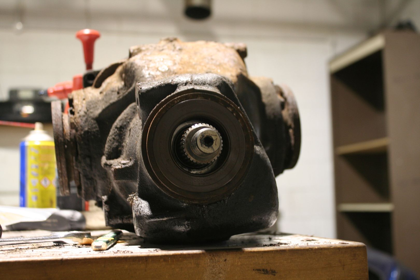

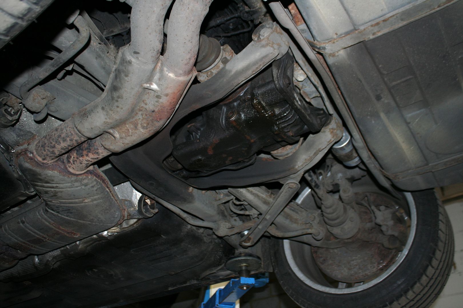

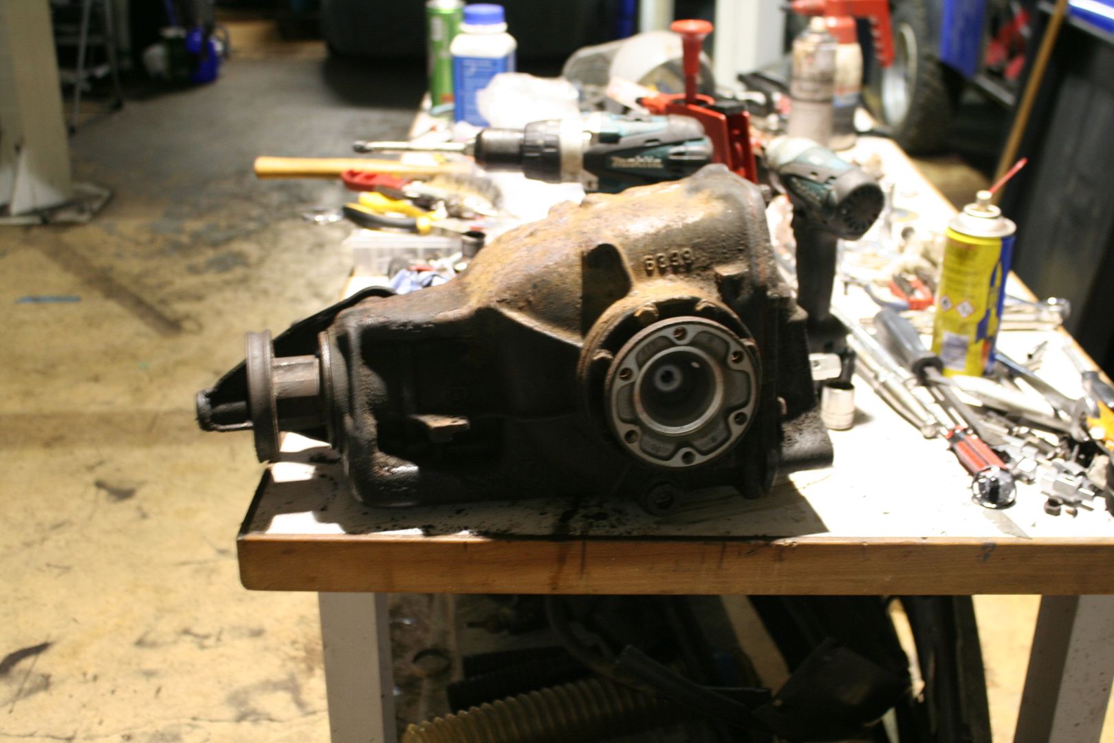

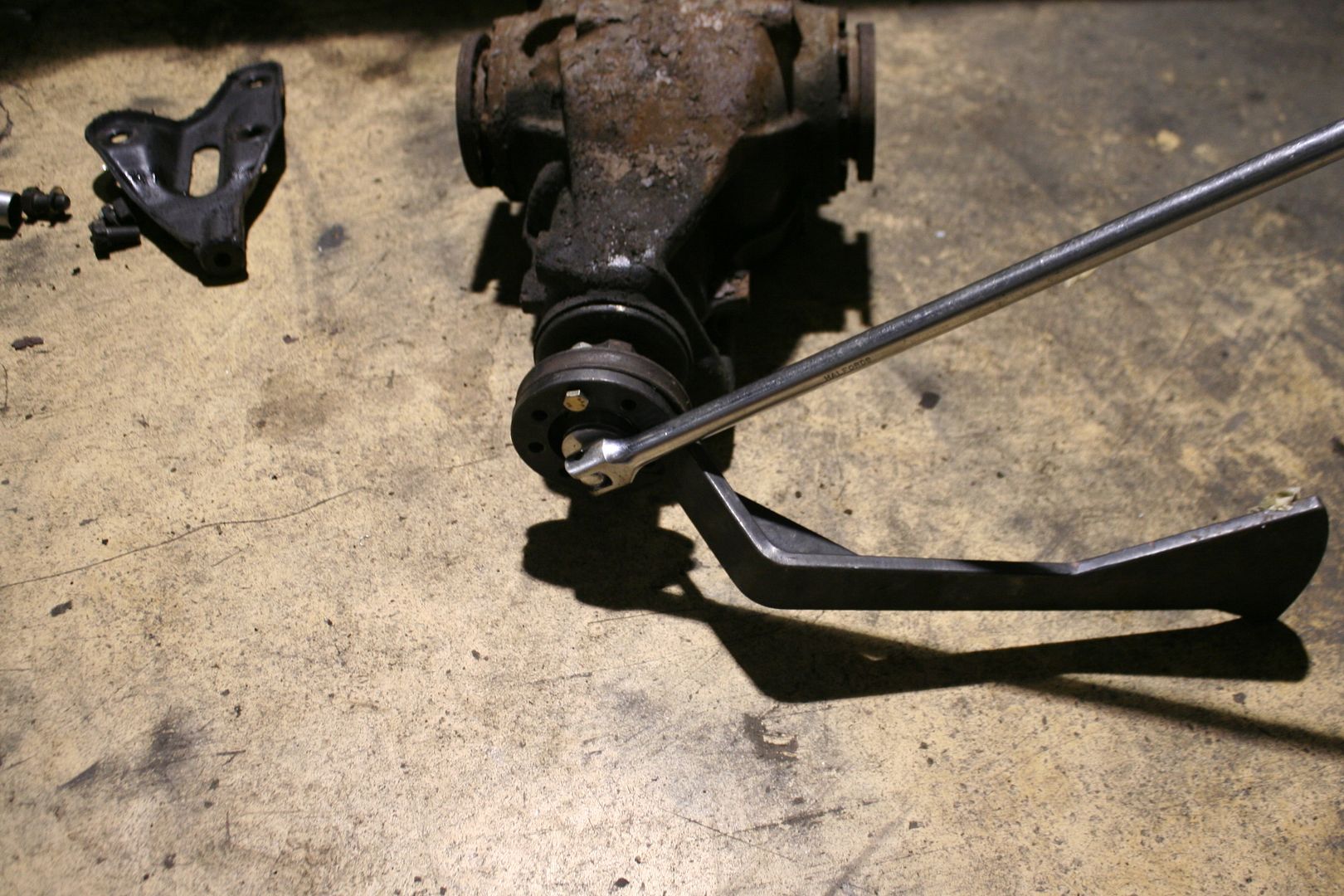

Diff has an oil leak on the backplate and the pinion oil seal also.

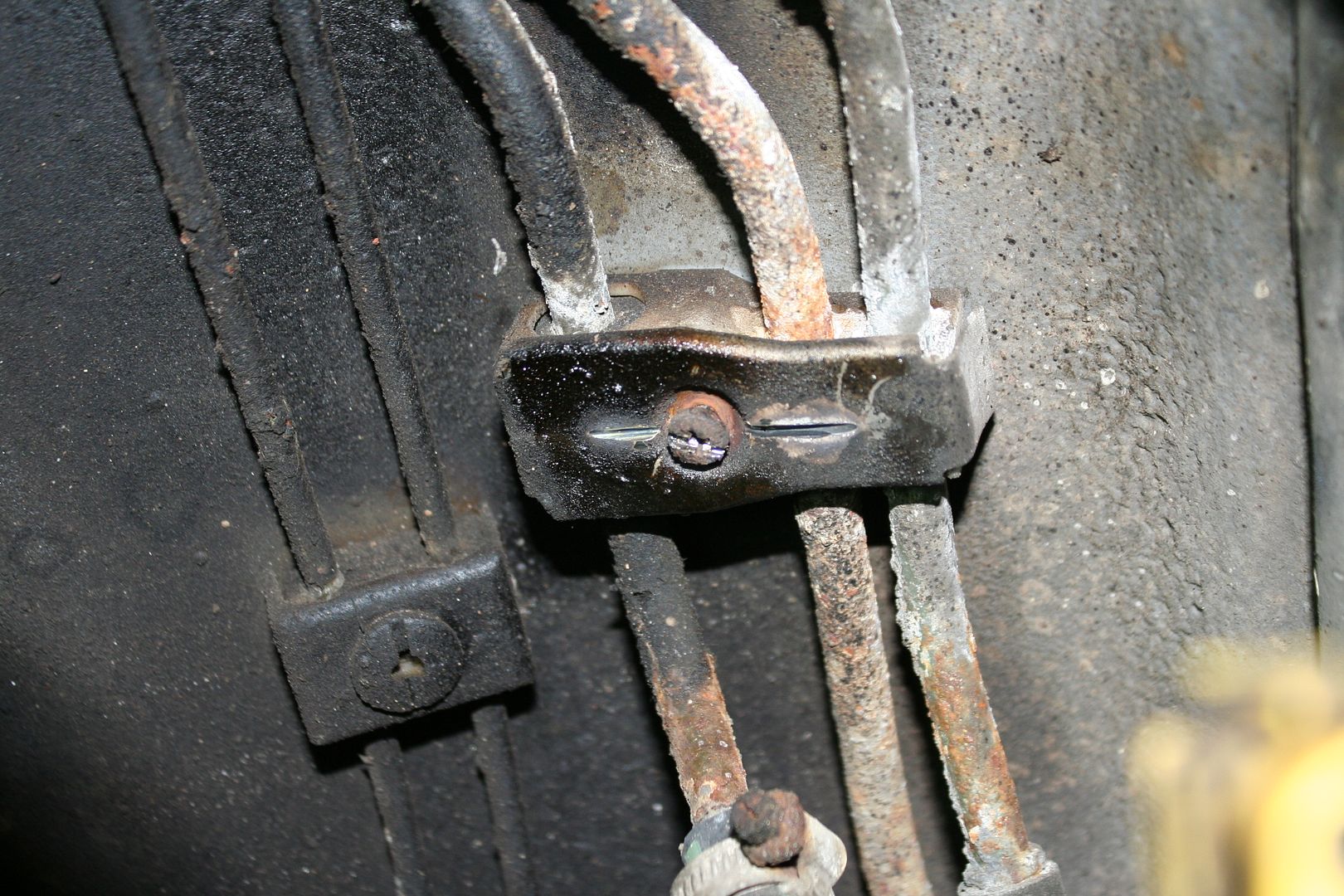

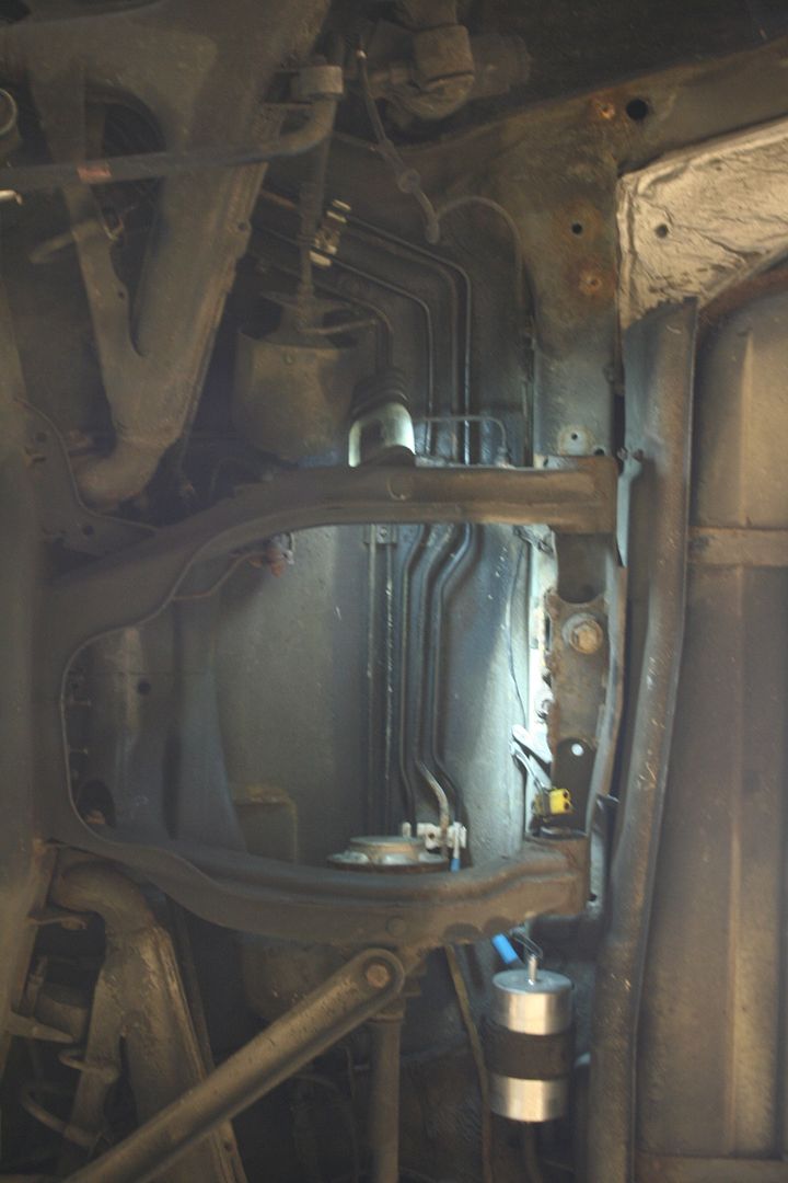

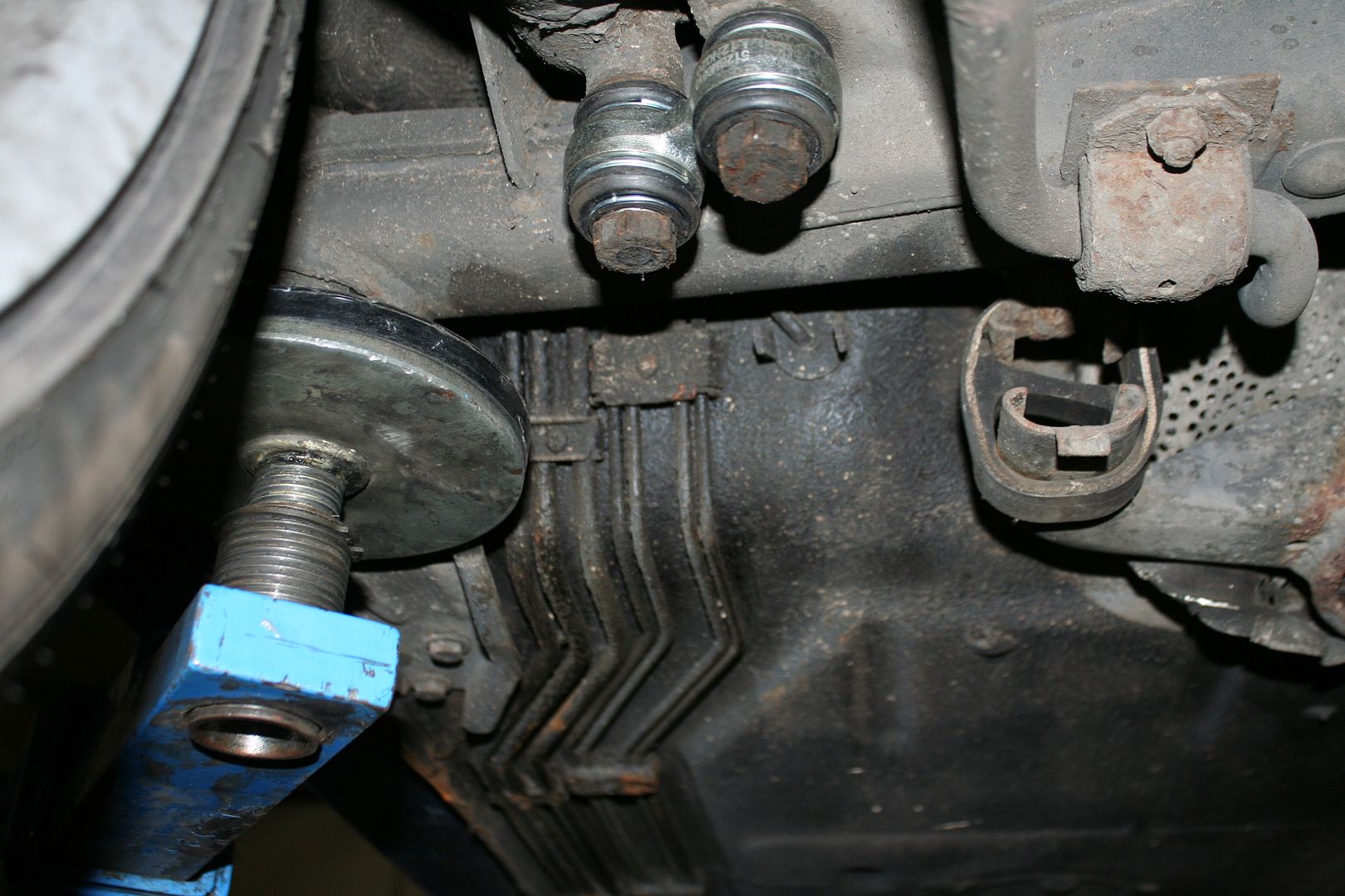

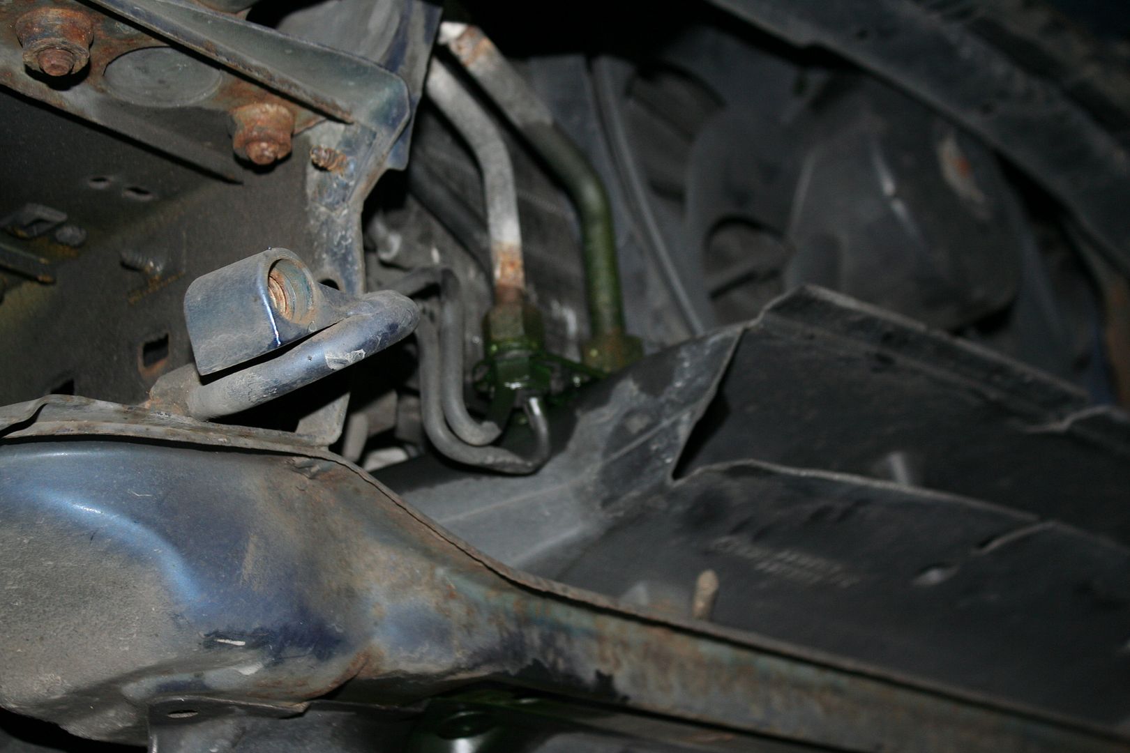

grisly fuels lines i decided to replace, which in short has been a mission as i've literally had to grind a slot into every screw head as they were rusted in to get them moving. Which has meant diff removal (coming out anyway) and the drive shaft one side, dropping the beam down also to get the new lines in.
Grim, system still has life in it but this is the worst area
Ah a leak on the A/C but some seals should cure this along with a new charge point valve. See if it all holds then!
Some new pitman arms as they looked to be sad originals. I'll do the subframe bushes too later as they're a bit soft, and an odd pair also.

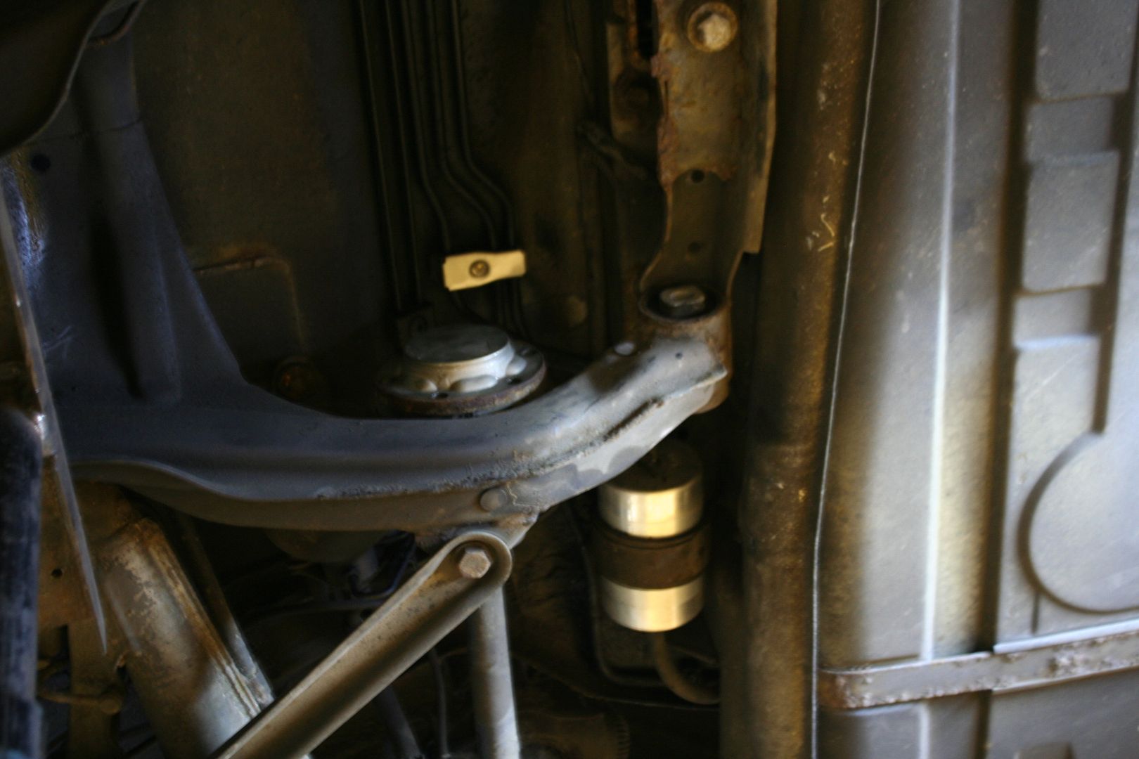

Getting the new lines in for the pipes and new clips £120! The breather pipe isn't too bad so i've left it
these clips are a silly £5 each and i needed all 3. New fuel filter while we are here. Seems easy but its been a ballache as per usual

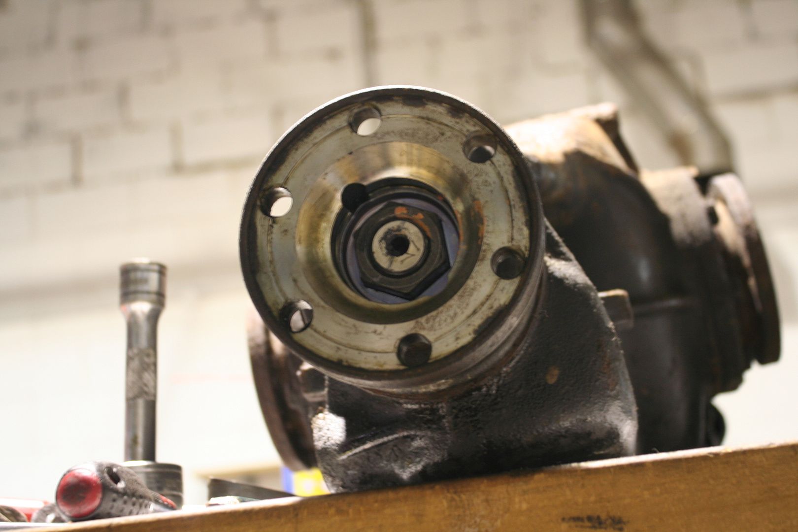

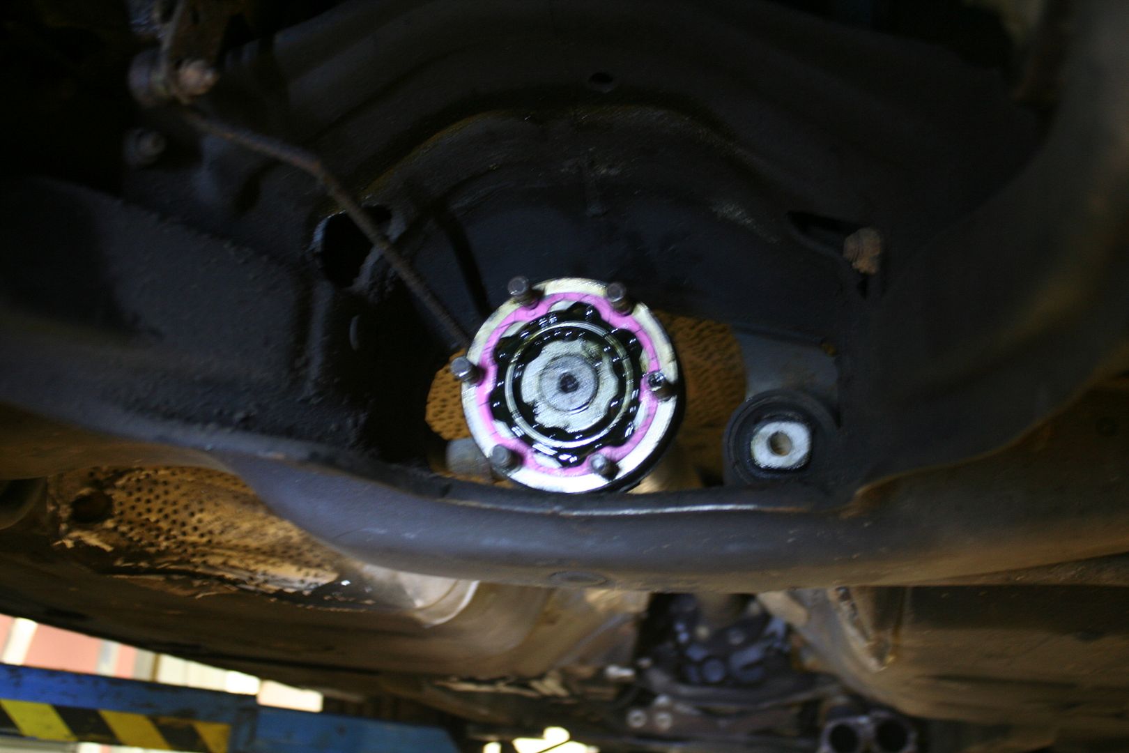

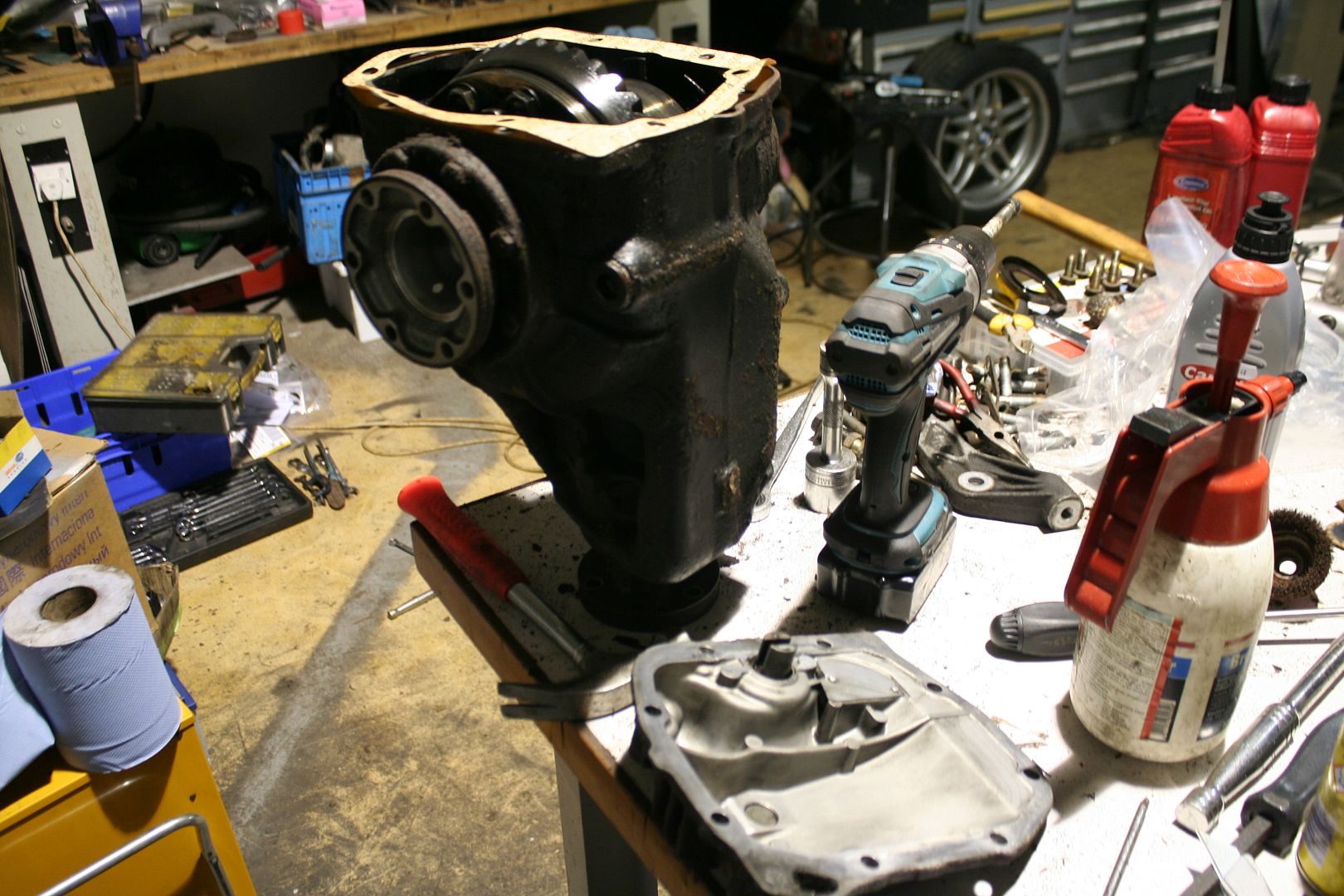

Onto these rather heavy diffs, this is my method of undoing the bolt
new seal in
Nut on and re tightened
New gasket, and i've changed the oil while i'm here
The beast ready to re install. Its in not sure how i did it on my own but it was tiring!
New gasket here to keep the grease in. Cleaned most of the old stuff out and added some new in

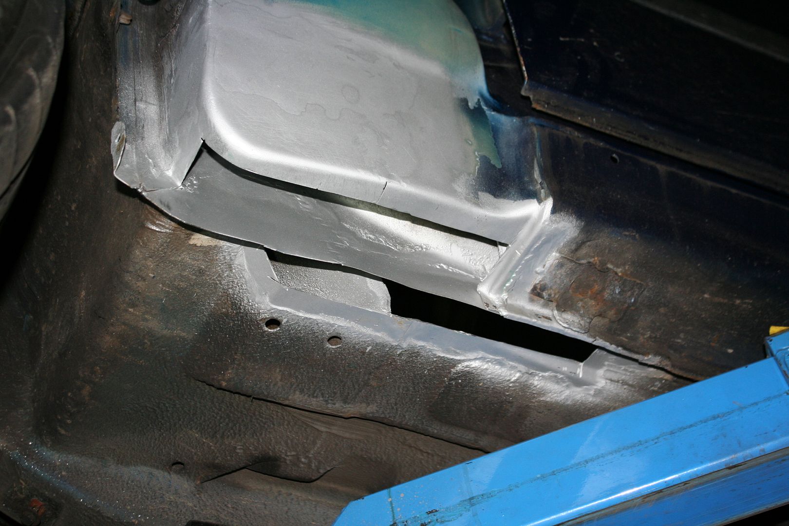

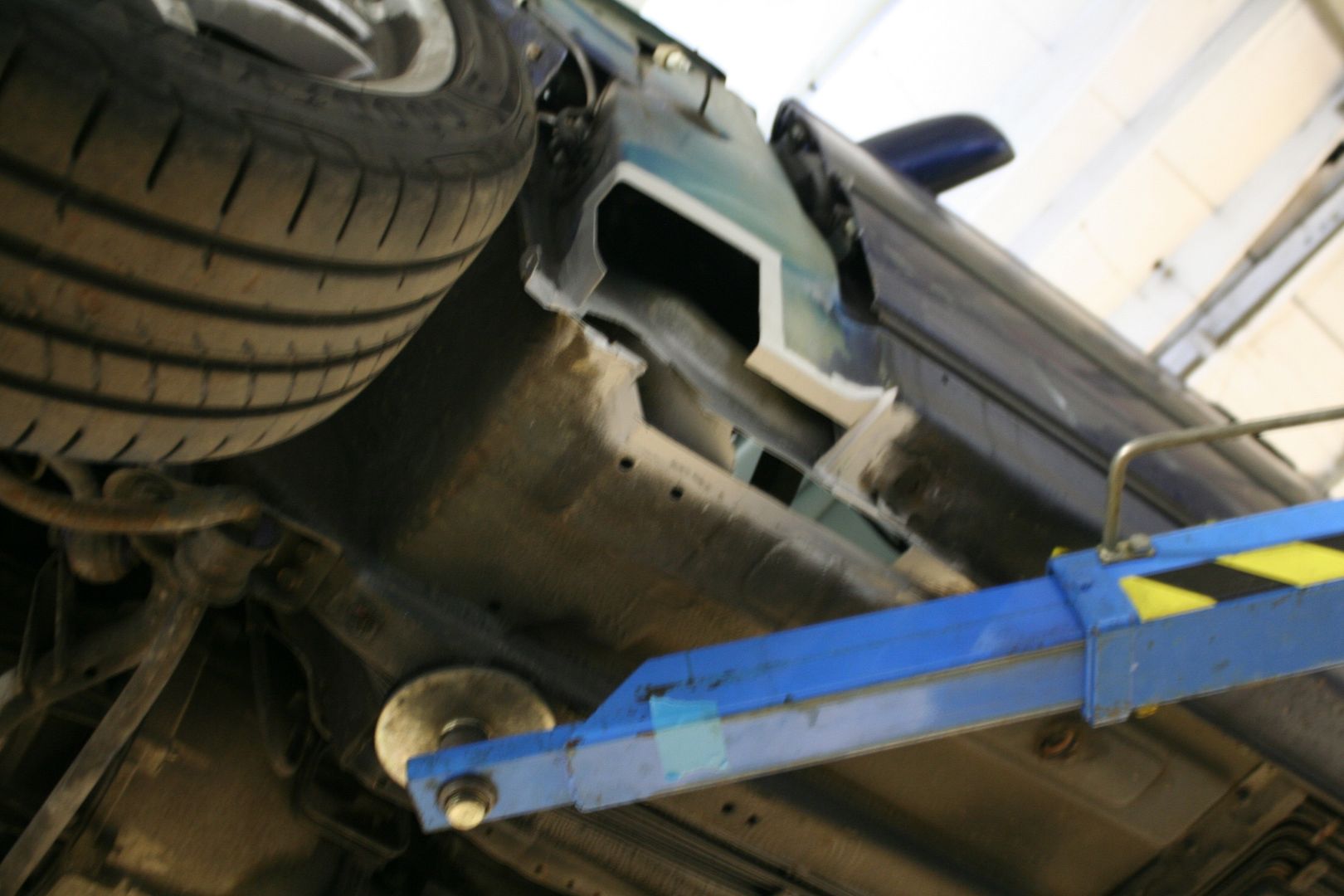

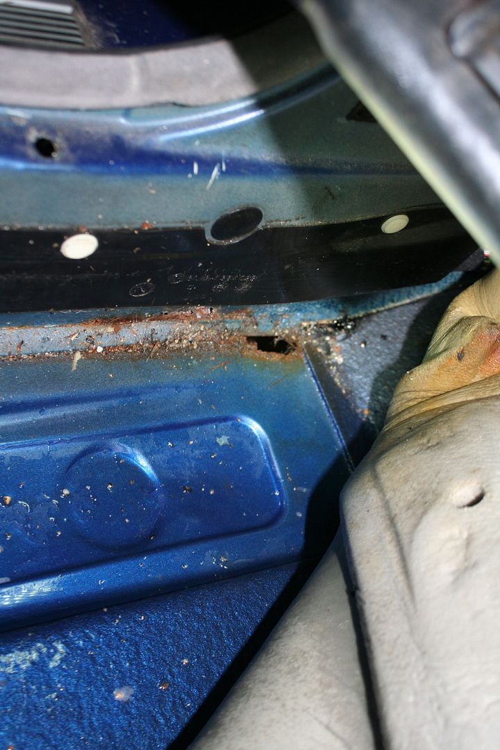

Onto the welding which Henry is undertaking! Very nice chap
Quick clean up, this is the side i poked a hole in............i wonder it will grow in size?!
Sure has!!
Quite a bit cut out and the thing is the previous bodyshop would of known this was here as they're talents extended to welding metal to rust which is quite a feat as those who can weld will know.
This is the repair so far and as far as we are with it at the moment.
Very much working progress still
