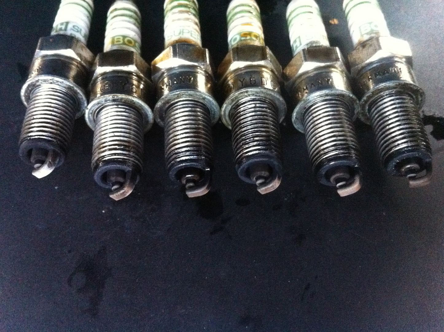

So she ran well for 3 days and today back to before! rough/lumpy idle. Bogging down when pulling away. And running poorly almost like its missing, i can hear little pops from the exhaust when i lift off the accelerator when coasting in gear. It even did a loud pop when i revved it up in neutral when sat at traffic lights! I can feel it missing under light load. The engine note has changed it clearly sounds different and the performance is flat or the low end torque has gone from before. I've not taken it up 3,000 RPM thought even when warm
All i can think off at the moment now i know my sensors are ok, is MAF, O2 sensor or Camshaft sensor? - It looks like one is fitted to these? I know a crank sensor could give these kind of faults on generally on BMWs when they fail the car just wont start rather than failing gradually. Its clearly a sensor electronic fault i think.
Time to get my plugs out see if a clue can be had here

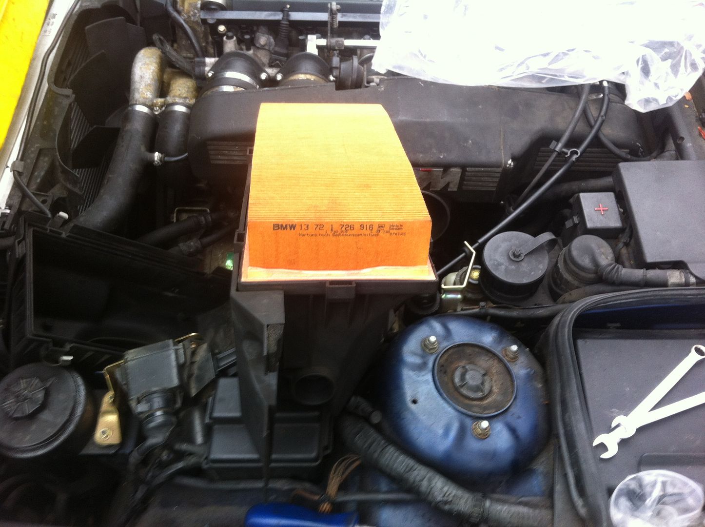

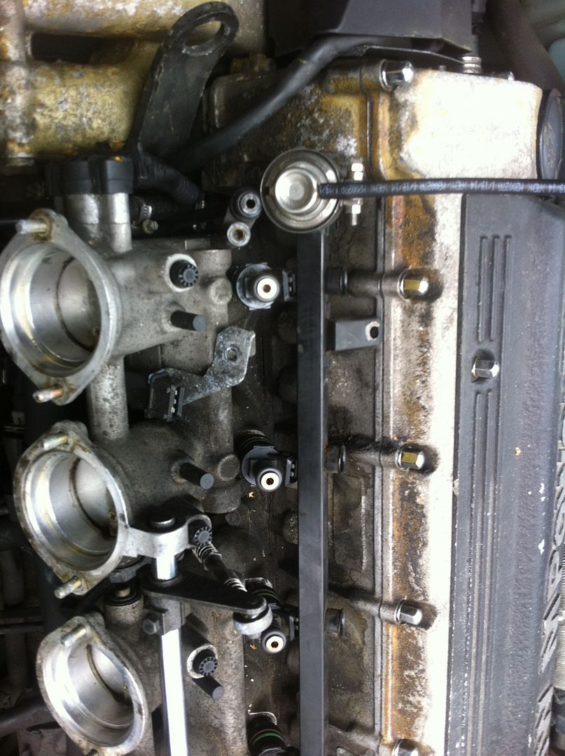

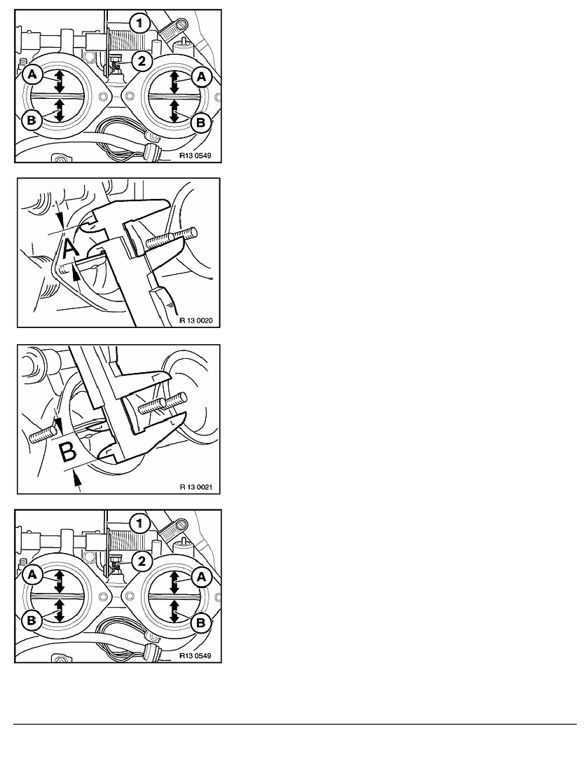

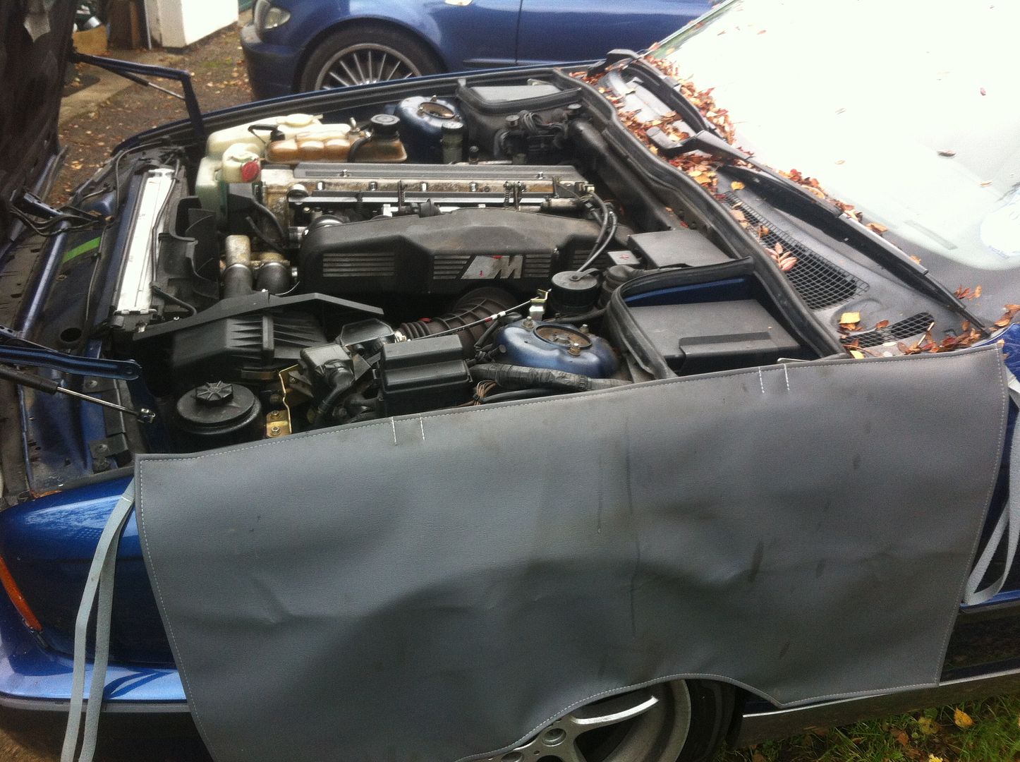

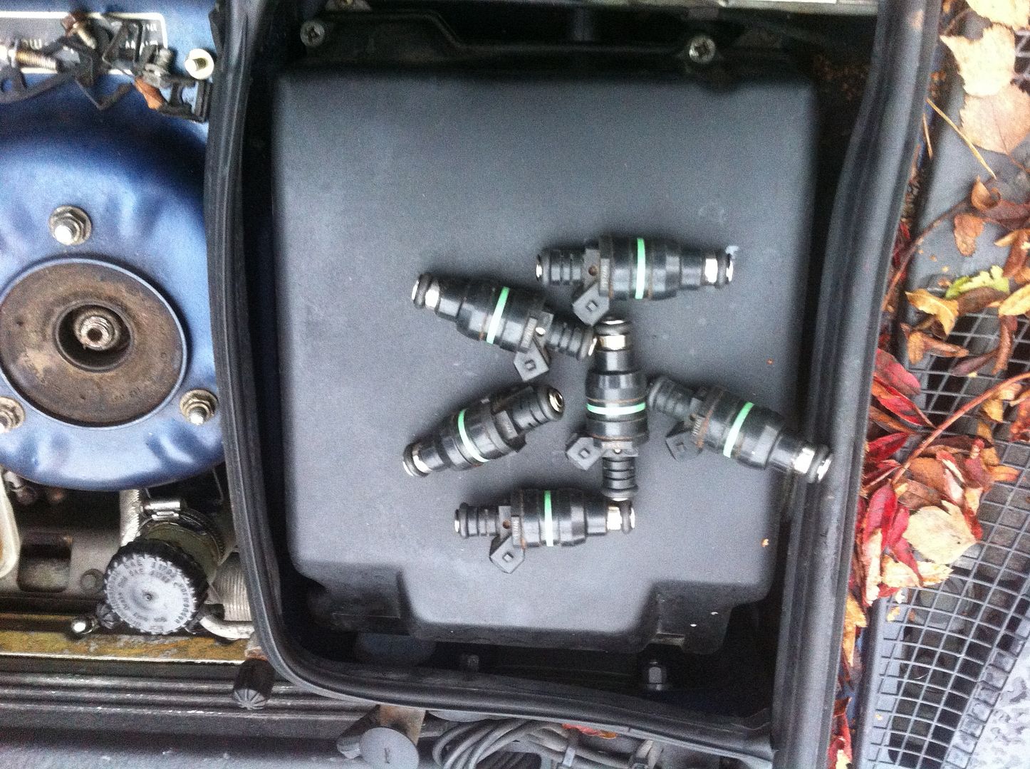

So i've not driven the M5 the past 2 weeks as its been in bits and waiting for parts etc One of things i wanted to check that can cause rough running is where the TB's where all still in sync.

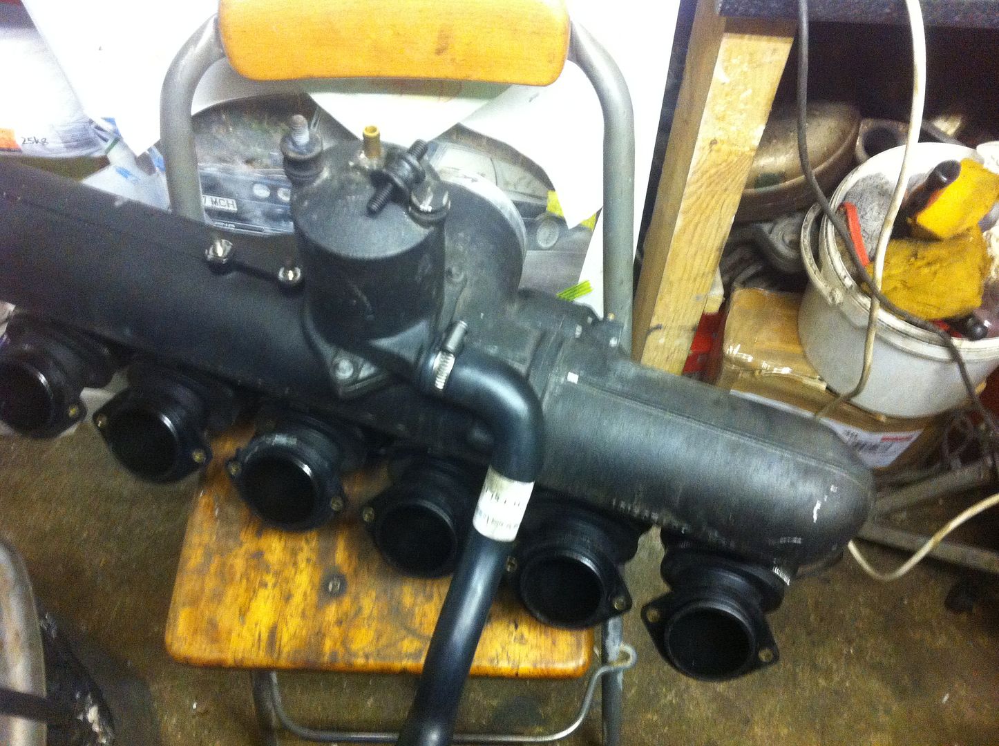

Getting the Inlet off is pretty easy once you've worked it out! I used an online BMW manual for this and after measuring all the TB's like this

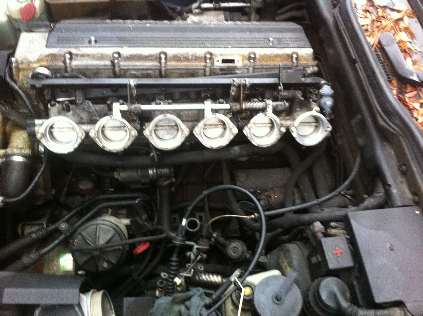

so on every TB you measure distance A and B for each cylinder, then you add them all up and divide by 6 to get your mean.
BMW state 23.75mm for A and i had 23.72mm
B is 24.75mm and i had 24.73mm so i left them alone.
I did adjust slightly the throttle linkage rods and cleaned them up
Whilst it was in bits it was a good time to get the injectors cleaned, the flow rate was still nearly spot on but the spray patterns were average so they're all good now.
Also as it wasn't alot of money a new FPR and hose as that was grim. I've got a fuel filter to go on also

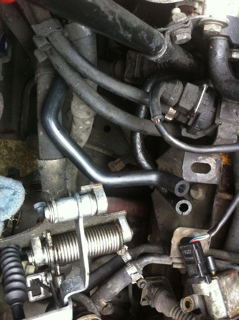

Whilst the inlet was off was a good time to replace any nasty/split grim hoses like this one for the oil catch tank to dipstick tube
Plus this one from the rocker to inlet breather. Someone has replaced the small vacum hoses already so a minor result. The little shock was also bust at the base of the inlet. Grinding a slot into it sorted that out
Old air filter was well dirty
I want a new M sticker for the inlet but i bulked at the £29 price!
And back together, i've done it a bit arse about tit but my reasoning is this i know the TB's sync haven't been set with the vacume guage but i've not really changed anything here. So next is to check the valve clearances and then i'll set the TB's with the guage. And i've hopefully attended to any air leaks.
Is the running fault still there? yes, btu really its time to read the fault codes live data now. I've done all i can without the computer

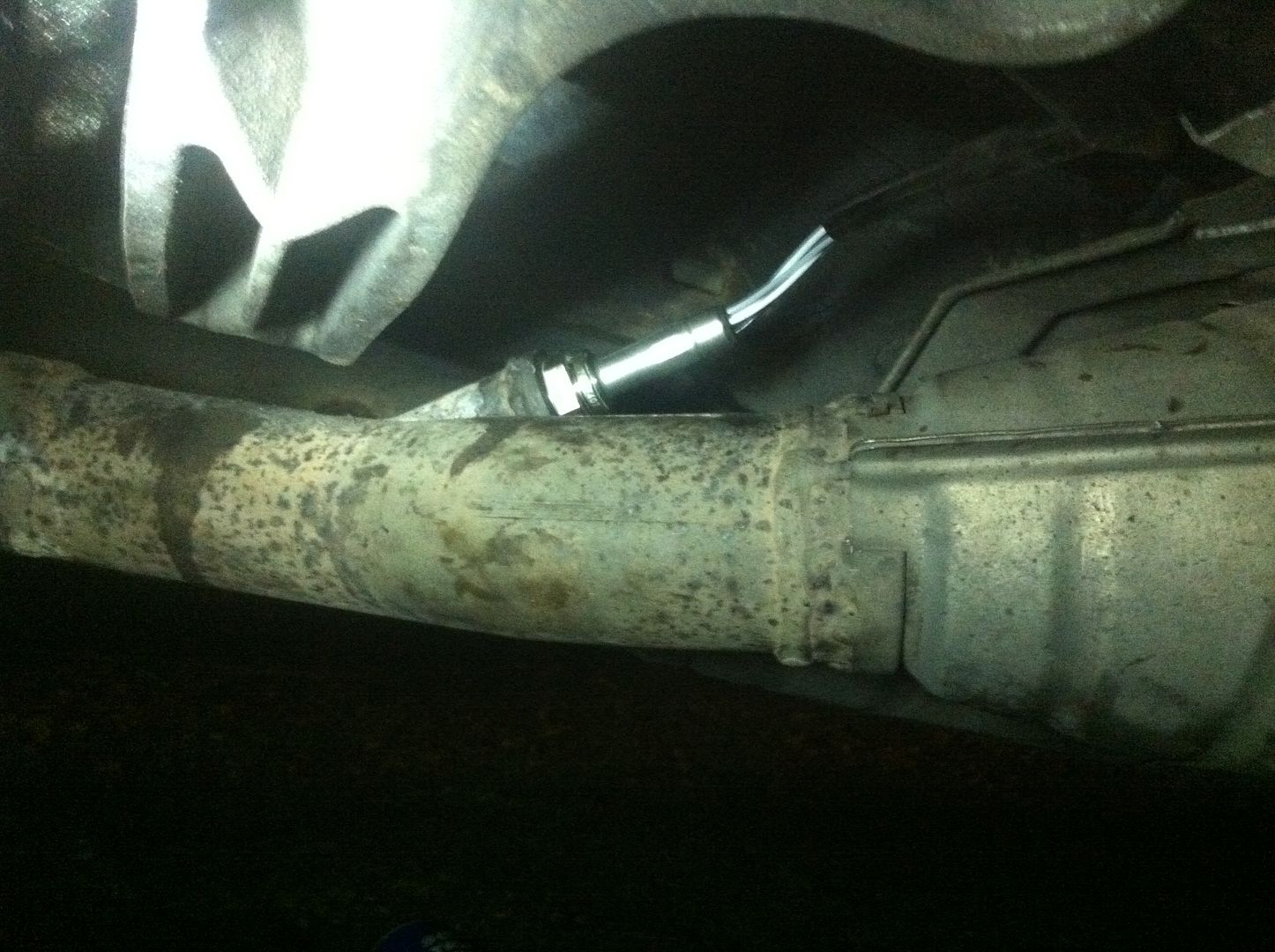

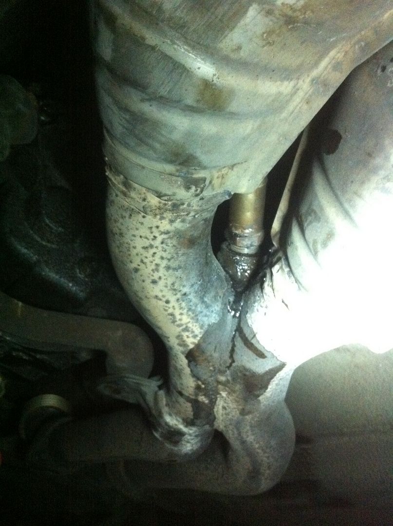

Powelly came with the diagnostics this week and plugged her in to reveal a fault code of the O2 sensor variety! Great that causes a running fault like i've got
So yesterday came and i replaced the O2 sensor. Its quite a tricky sensor to change when you only have a long 22mm spanner! A half moon shaped one would do the job nicely
What a cheeky location! I changed the one on my e34 bi turbo in 15 mins start finish on the drive! Not this one
I had to drop the gearbox cross member to get enough space, but anyhow its on and fitted.
Any good? Yes and no, it runs much better but the idle is still rough, the idle speed is still eratic in terms of RPM so varys from 600rpm to 750 say. but does not hunt. It does however drive much better but theres still a hesistation when pulling away and can be jerky on and off the throttle.

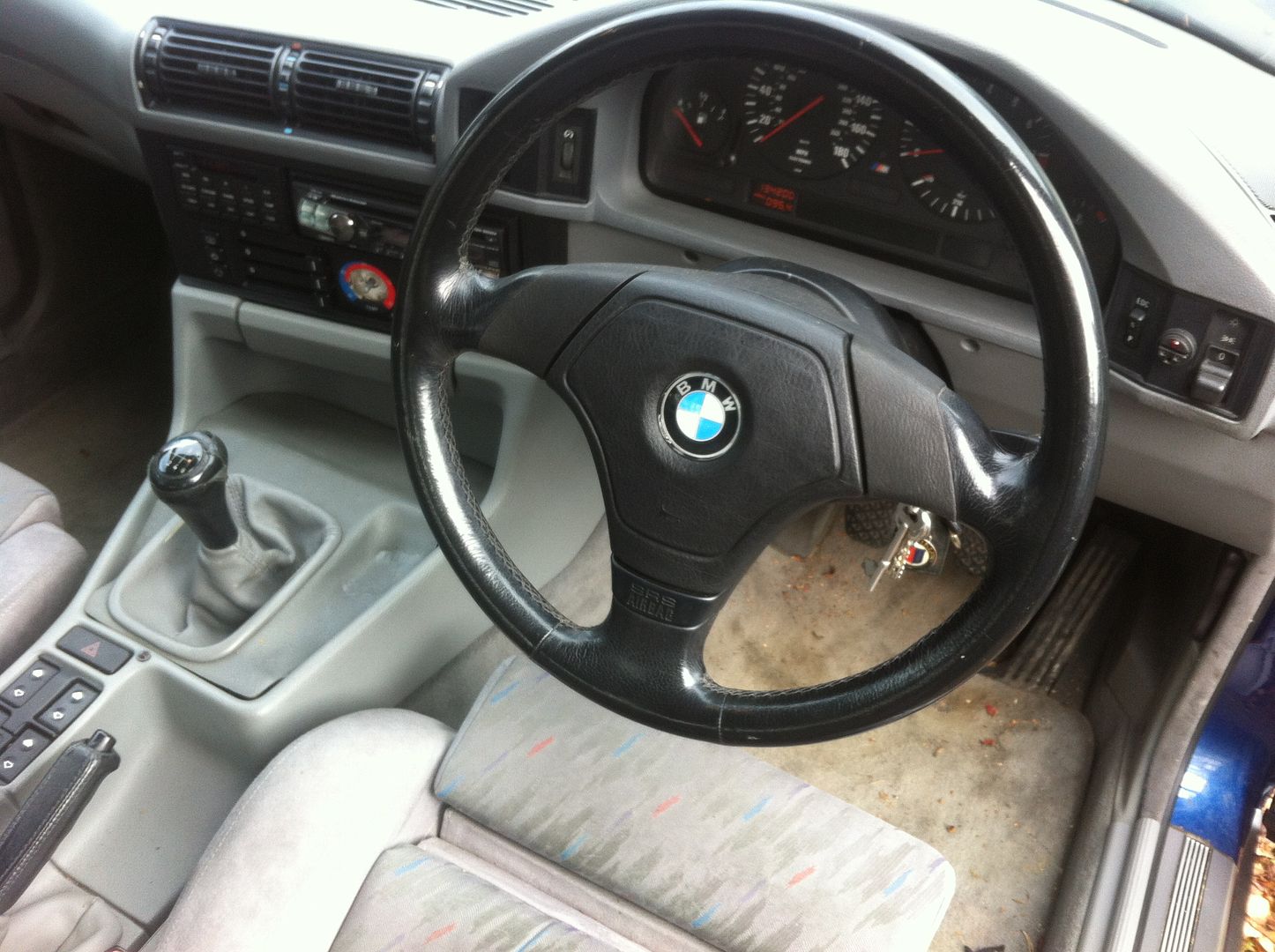

I've binned this crap off also as the gearnob was doing me head in horrid thing
Also while we are on interiors. On the cards extended champers? Or a nice black leather trim? They both go but champers is more special i think

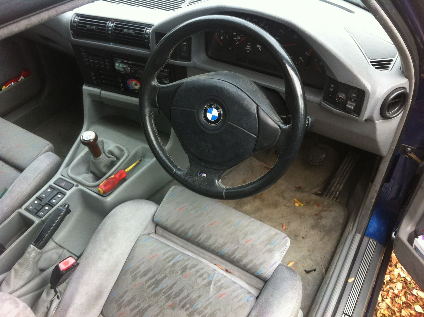

Si was the steering a direct fit?
jimbom30cab
- Tech 1 freak
- Posts: 7631
- Location: in the garage
Great update there Si, a good read
- Posts: 22697
twas a straight fit from an e36, they only bolt on the late e34's

That E36 wheel looks rank in there, sorry. The old type E36 M Tech 2 wheel fits. Abit ofd wiring for the horn and the airbag light whipped out.......
