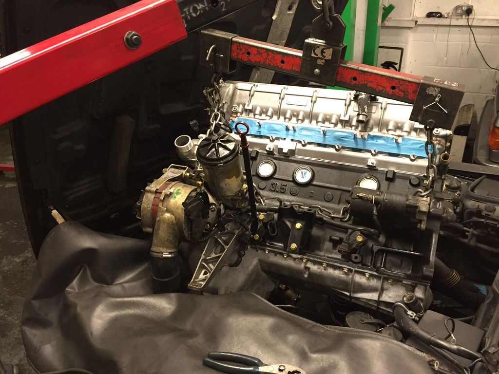

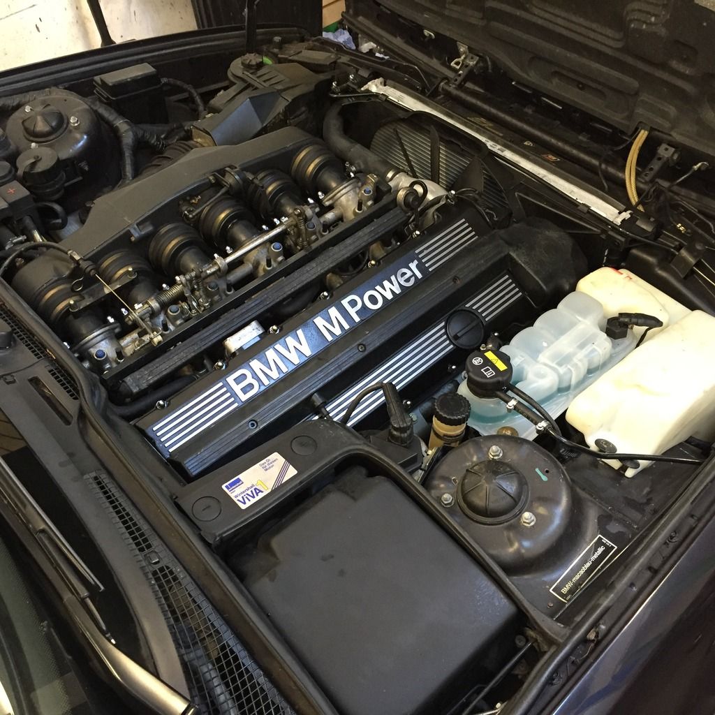

So two E30 M3's, life and other peoples cars have got in the way of doing stuff to this so time for a bit of a bumper update to round up to where we are at with it.....
Following on from the last update in may,

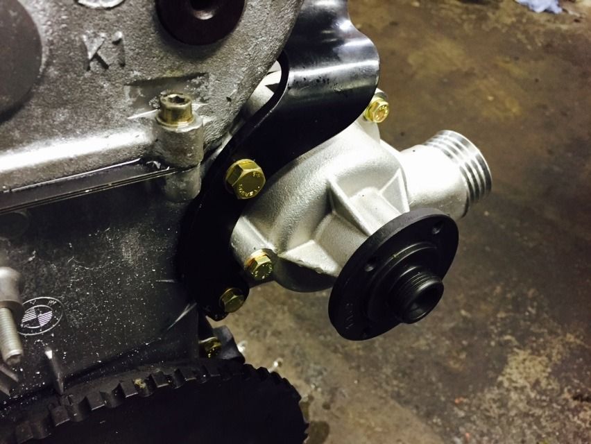

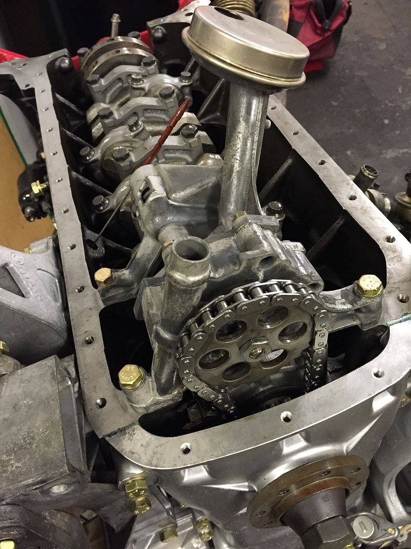

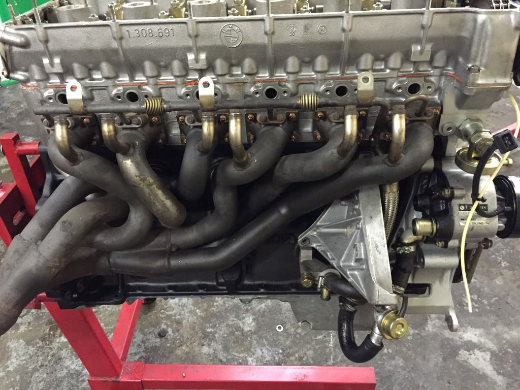

Water pump and oil pump on.

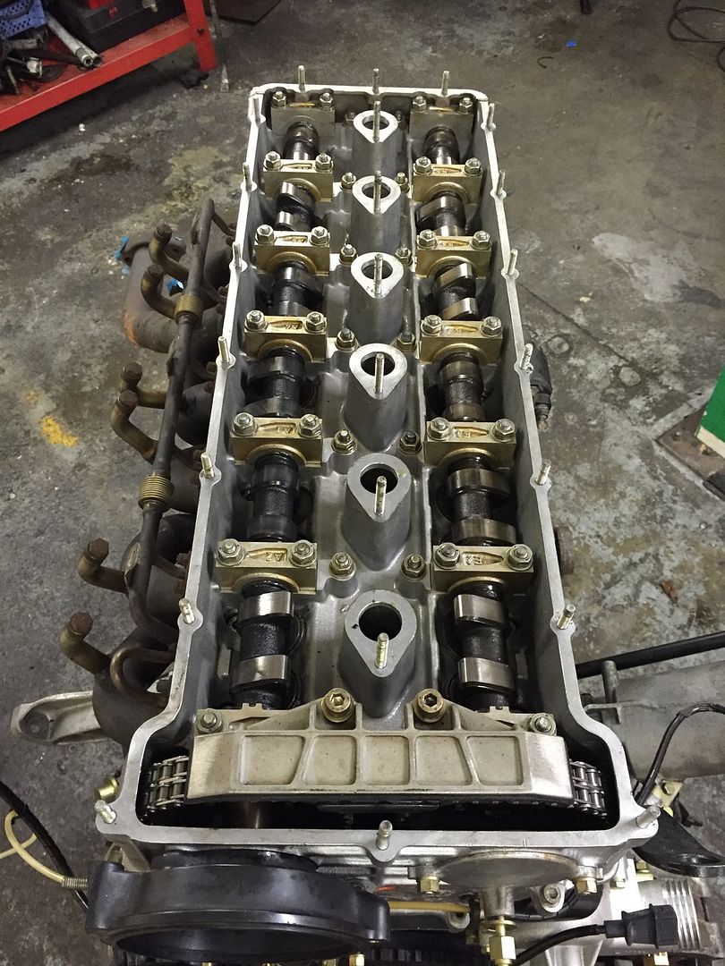

Cams in and valve clearances set.
Exhaust manifold, mount arms and air pump on.

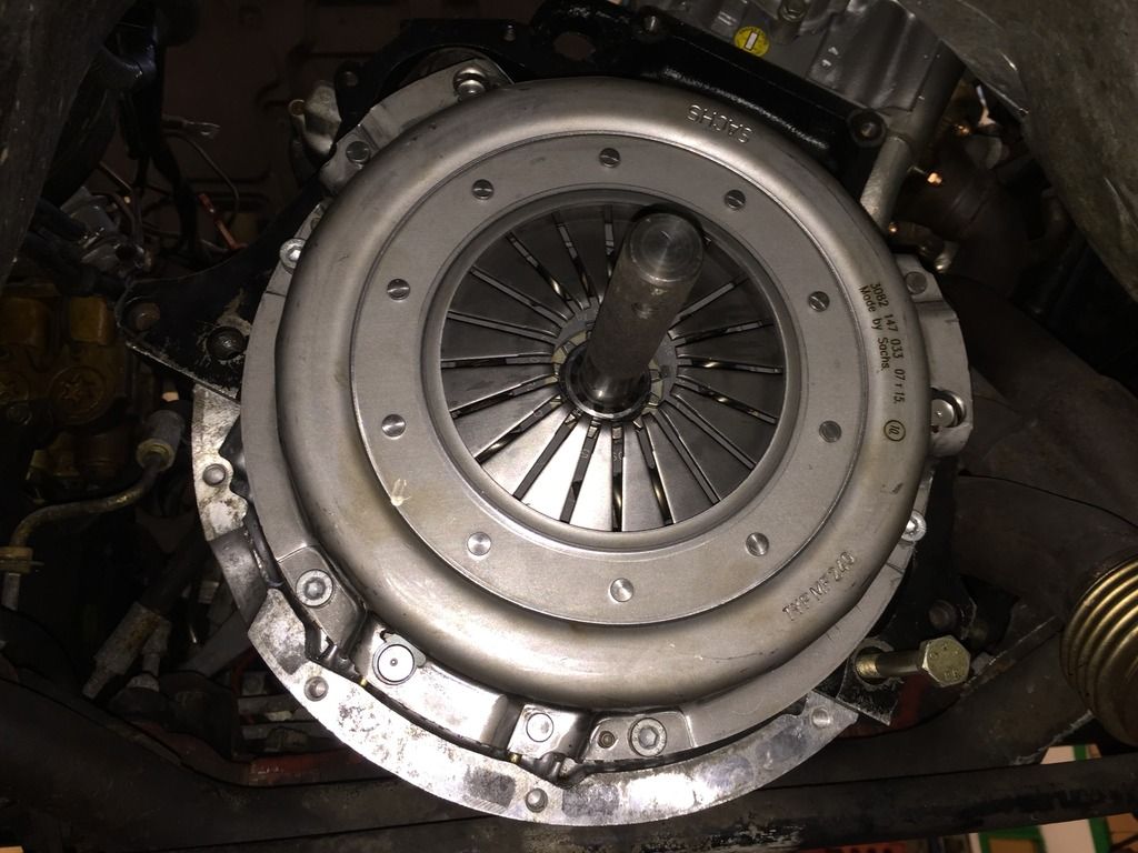

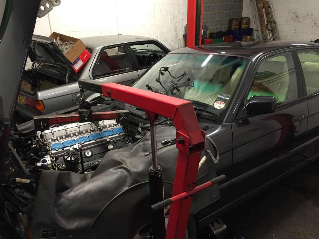

Fast forward to new years eve and I'm installing the mill on my own before heading out to a poker night.

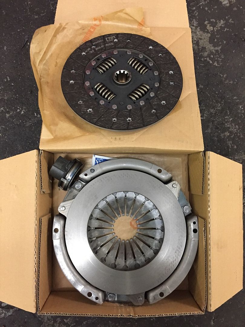

New Sachs clutch kit bolted on.

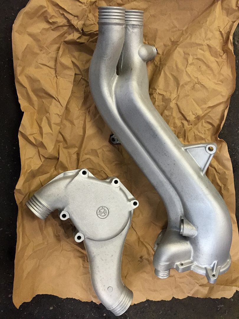

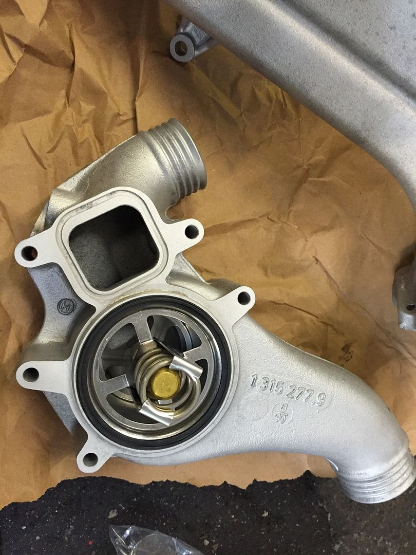

Freshly vapour blasted thermostat housing and coolant housing fitted with new thermostat.

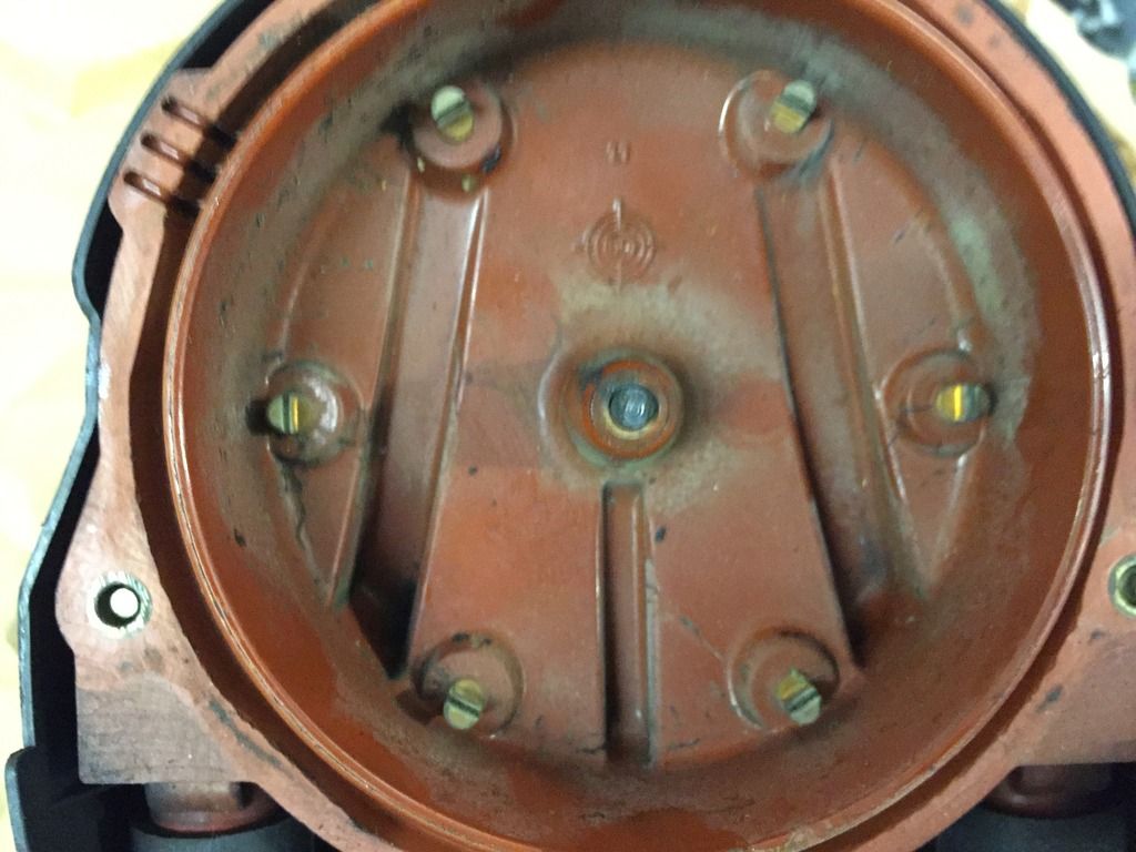

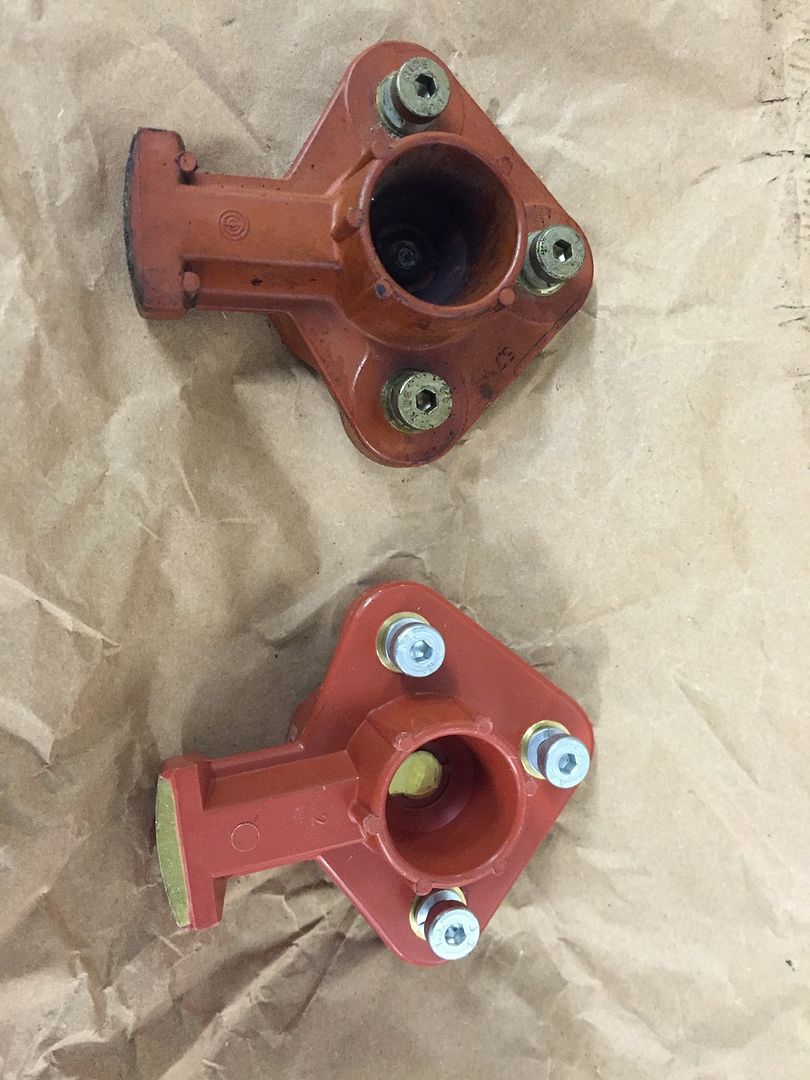

Orignal 1990 cap and arm replaced with new.

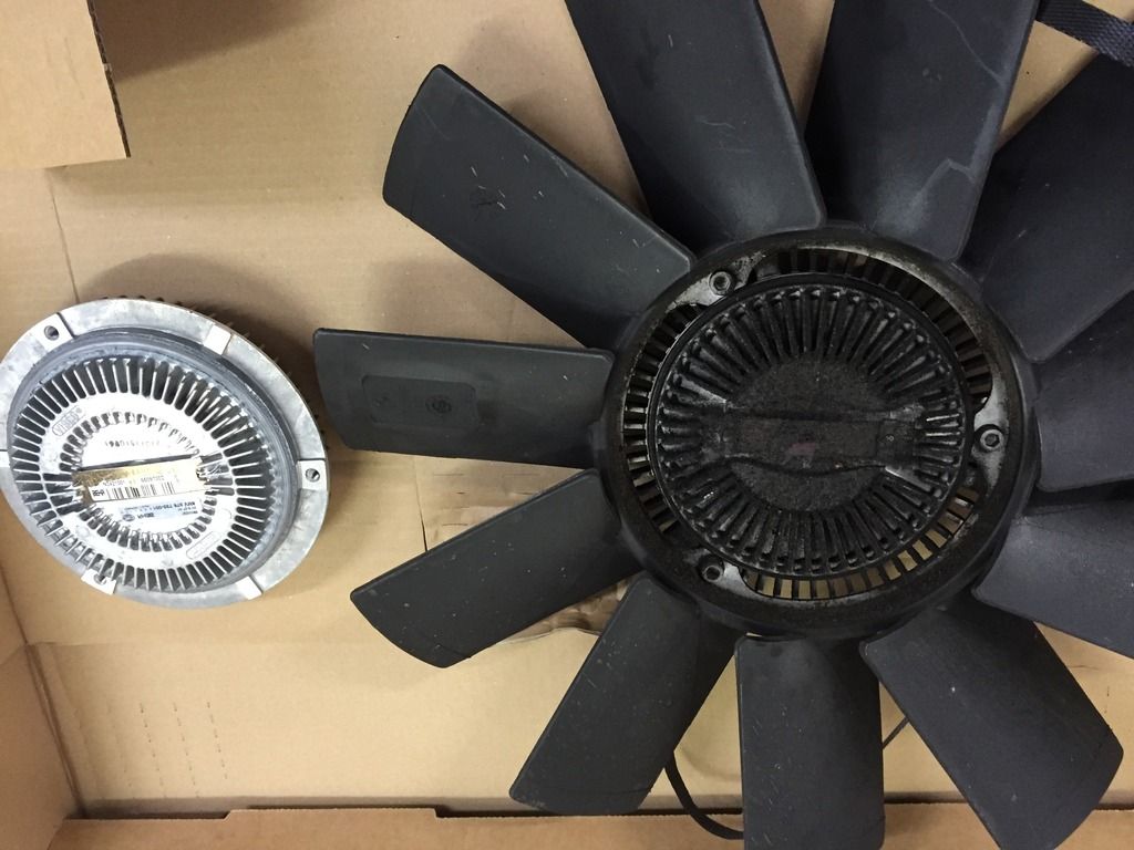

New Behr viscous coupling to replace the original 1990 one.

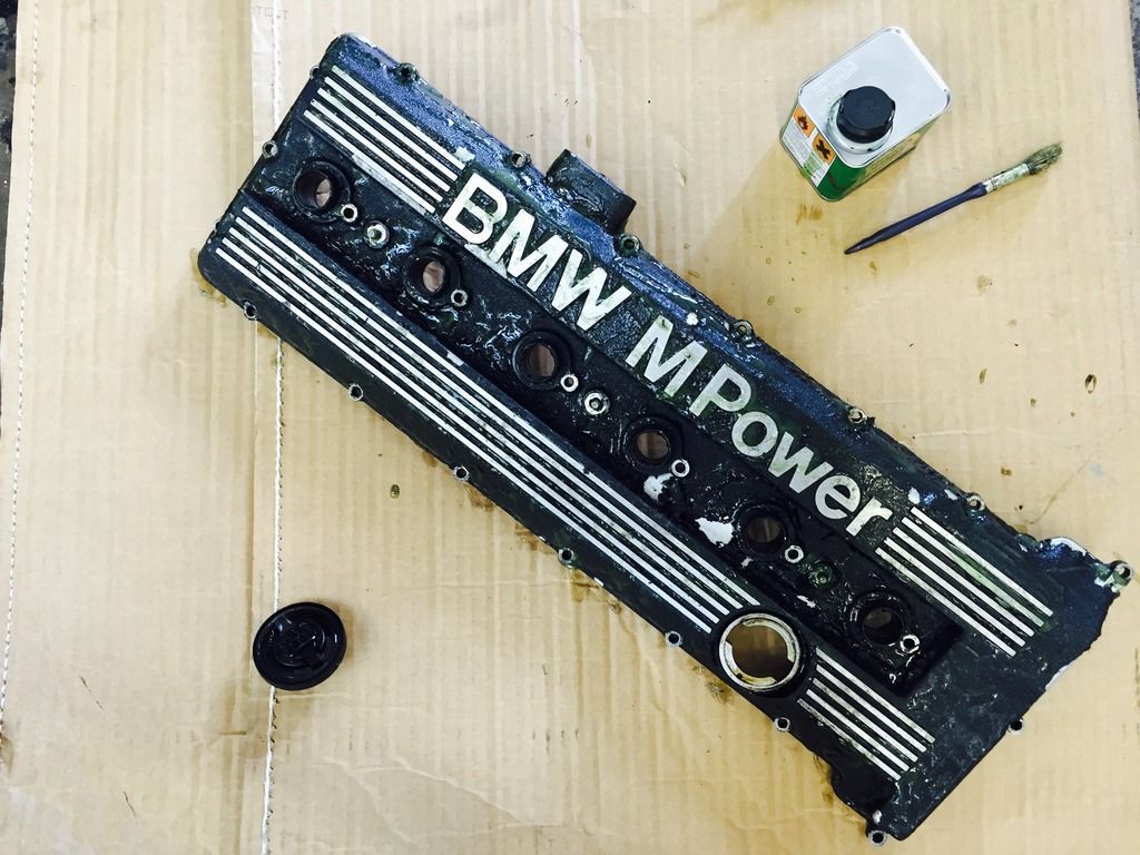

Cam cover stripped with nitromors then repainted.

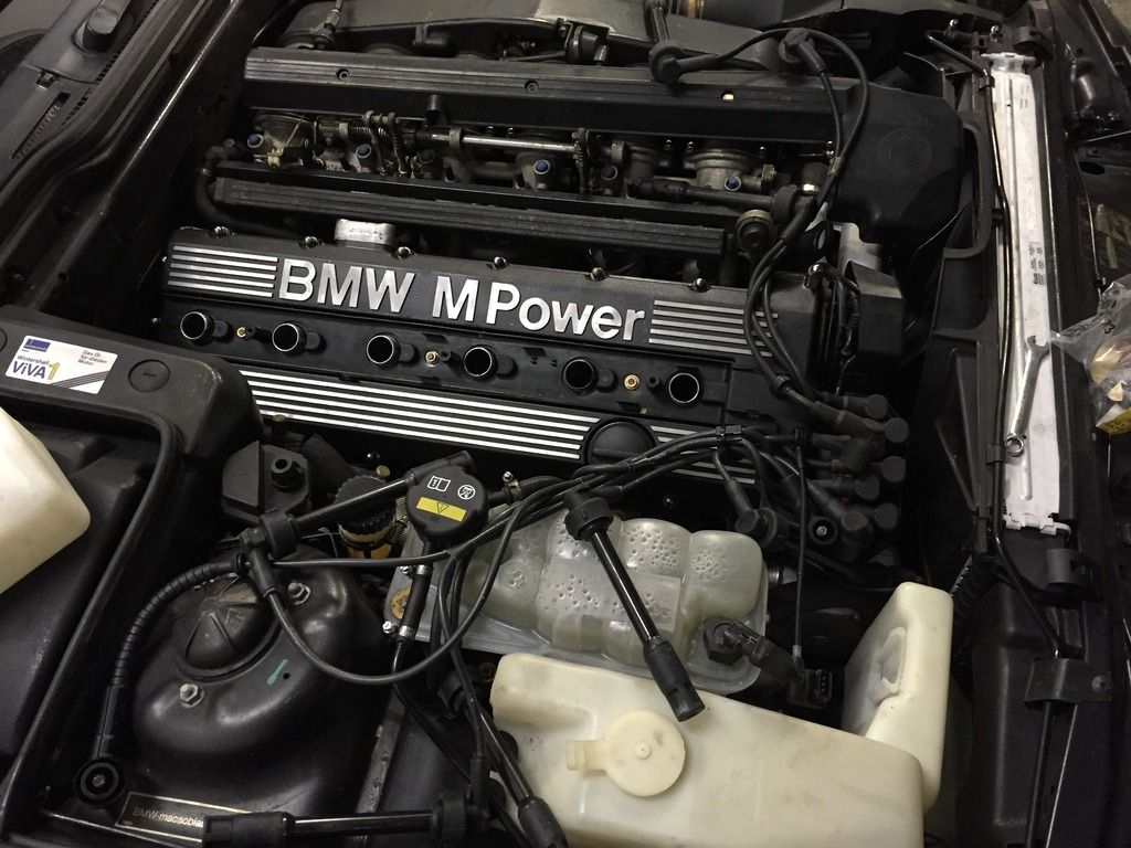

Fast forward and the engine bay is complete!
To round up, the following work and/or replacement parts has been done/fitted.
Replacement head repaired, skimmed, guides replaced, cleaned.
All valves measured, cleaned and lapped in
Block decked, honed, cleaned, painted and new core plugs
Pistons and rods cleaned and measured, new rings fitted
Crank cleaned, measured and journals polished.
New bearing main and rod bearings
New rod bolts and mains bolts
New timing and oil pump chains
New guide rails
Oil pump measured and cleaned
New VAC MLS head gasket
Assembled with all new seals and gaskets
New water pump
New thermostat
New viscous coupling
New radiator
New expansion tank and cap
New coolant hoses (all of them!)
New clutch kit
New drive belts
All original nuts bolts and brackets passivate plated in original finish
All vacuum pipes replaced with new
Oil cooler and pipes flushed and cleaned
Castrol TWS 10w60 oil
BMW coolant
Clutch bled with fresh dot 4 fluid.
Just after returning from bedding in the new piston rings which was also the first time driving the car since i bought it 18 months ago!
Next up MOT, putting some miles on it and a light cosmetic restoration.

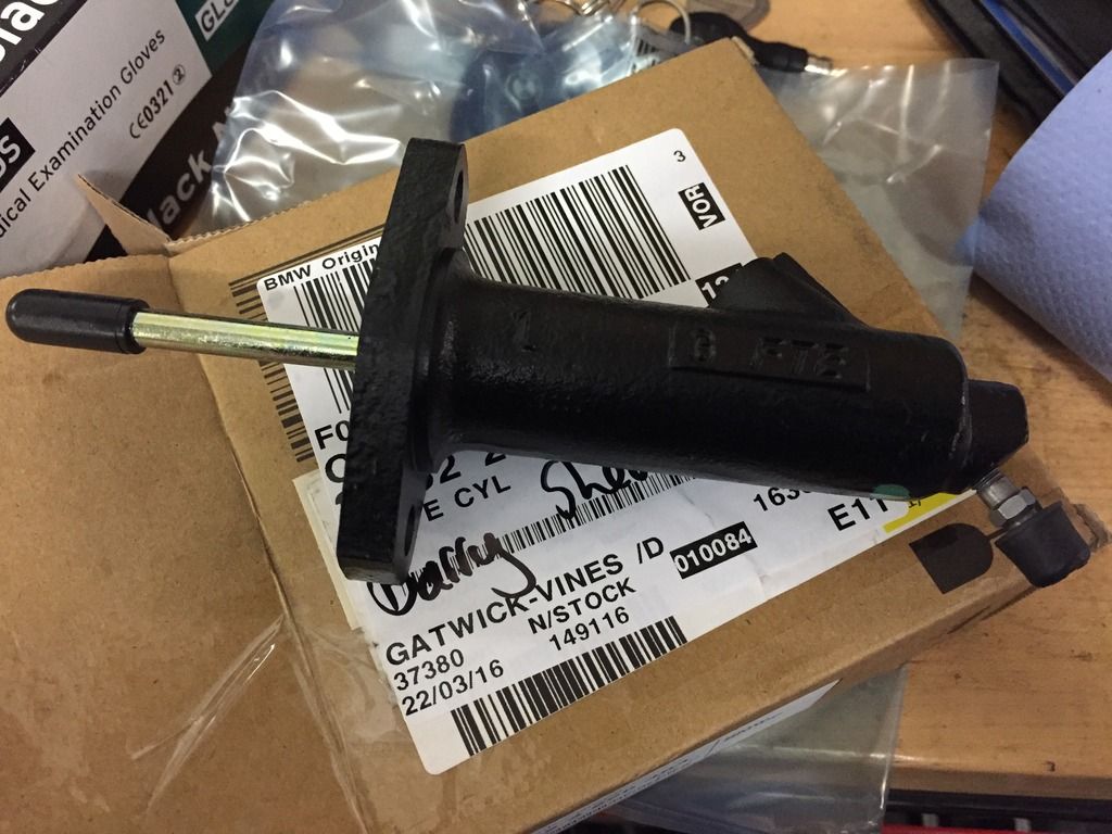

So not long after the MOT a taxing of the M5 the clutch pedal started creeping to the floor one night so i limped it home and after checking with ECP it turned out that the slave cylinder is unique to the 3.6 M5 and now BMW only. I promptly ordered the last one left in the UK and normal service was resumed the following day.

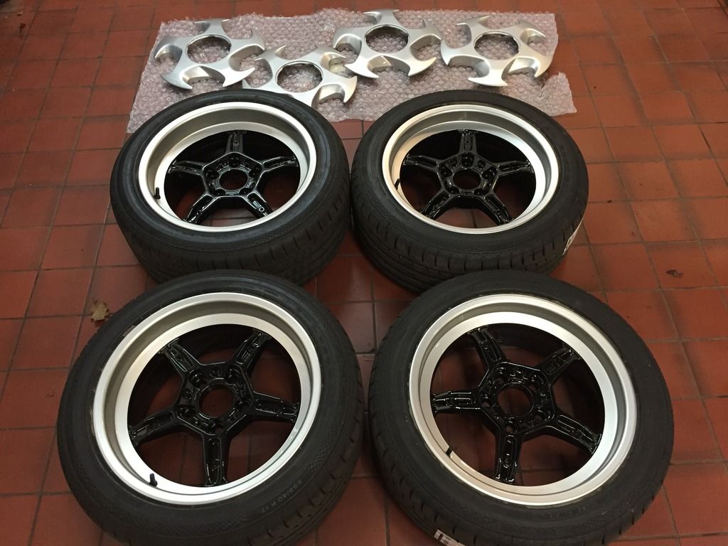

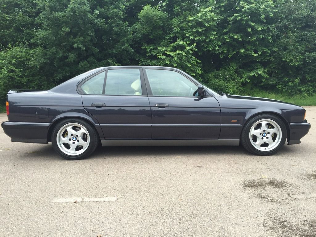

Whilst the engine was still being run in i had a lead on a buyer for the car and as an impending wedding requiring some of my toys to be sold, this was followed up and a price agreed after viewing. The new owner decided to go with the throwing star covers so the wheels were sent off to lepsons for a refurb then shod in a new set of Continental Sport contact 3's in the correct sizes.

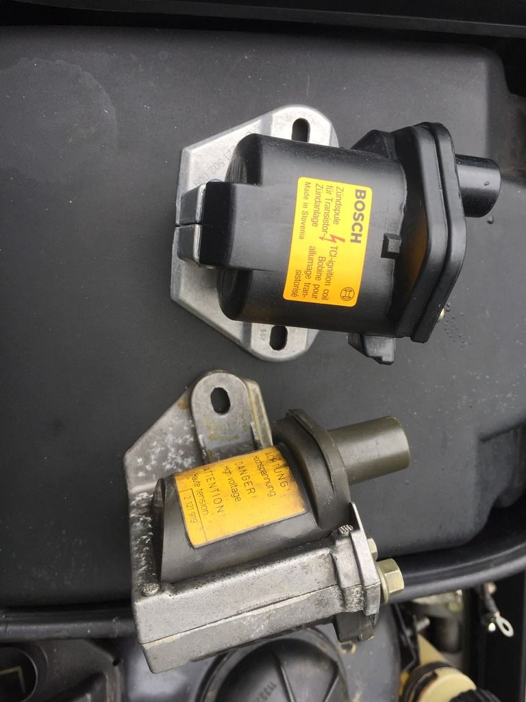

Now i had to make a repair to the plug leads coil wire as the end broke so i thought that perhaps as they were the 26 years old and had already had one repair that they may be causing the misfire at WOT so as with many parts on this car its BMW only for a complete set of leads to the tune of £350+ vat!
Unfortunately the leads did not cure the misfire. A few things were checked and tried such as a spare coil, fuel pressure, TPS adjustment and function at the DME, crank sensor resistance and air gap, a donor DME, AFM and fuel pressure regulator were also tried but wit no joy!
Te injectors were sent away to be tested and refurbished and once they were returned and refitted it was still the same!
Started to get worried and under a bit of pressure as i had taken a deposit on the car i trawled the web and found a thread on the M5 board with someone having the same fault as mine with the EXACT same symptoms and it turned out to be a coil.
After reading that i went straight out to the garage and robbed the coil from my E30 325i and result, misfire gone! The coil i initially tried but have also been knackered so once again, called the dealer and the BMW only part was in stock and again last one in the UK so another £80 and we were good to go!

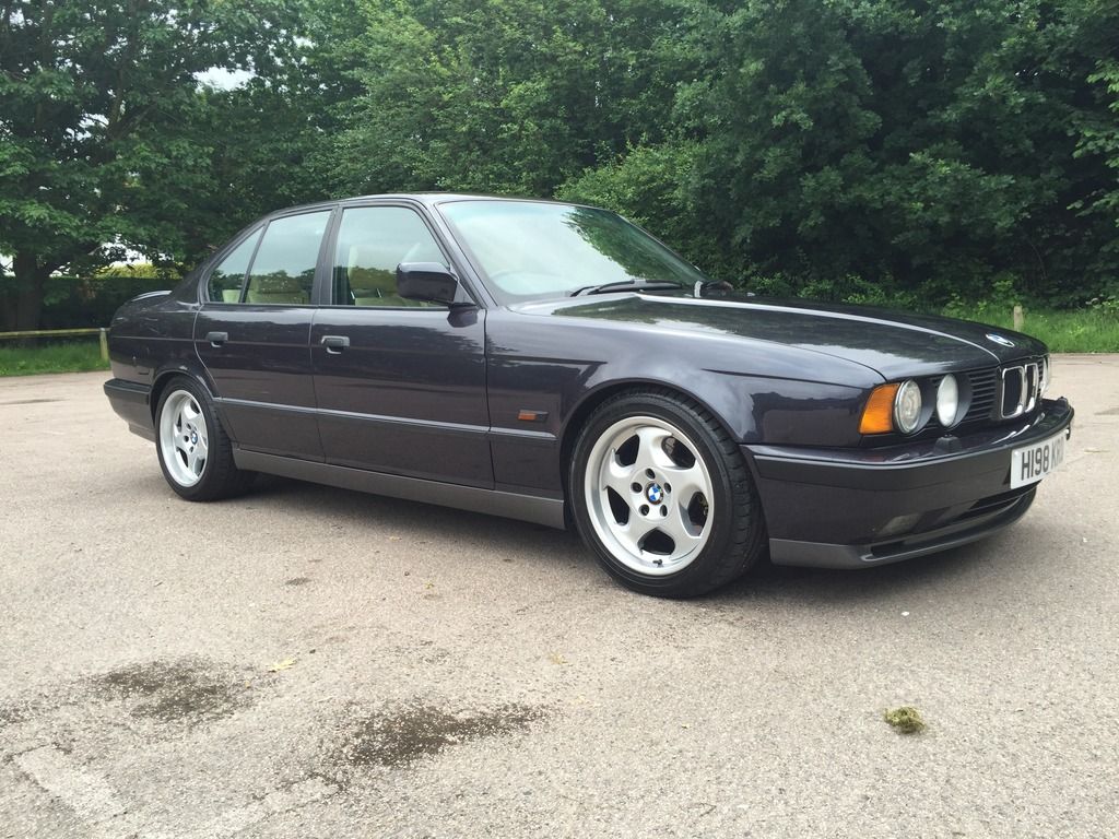

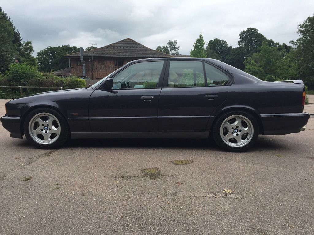

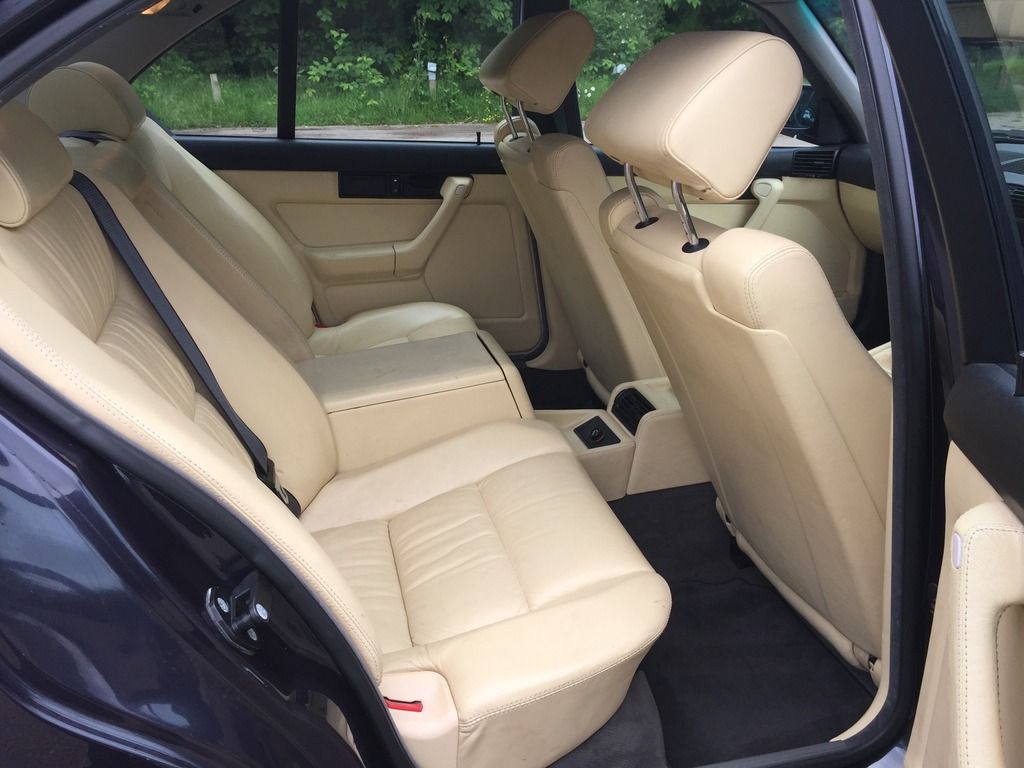

After a total of about 900 miles another oil and filter change was done again with Castrol 10w60 and just before the car was collected today i took a few snaps to remember it by.
Bit gutted to see it go as it is such a tight and up together car and have enjoyed the short space of time ive had with it.
