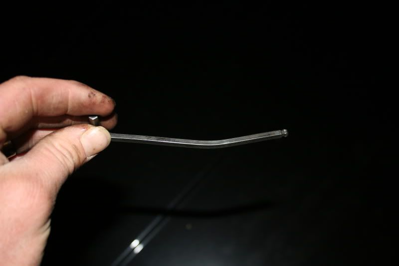

yesterdays bodgery
Crank nose bolt tight? then you need a 5mm long allen key as the crank locking pin! Was strong enough to hold it just with me hanging off a large breaker bar! Bit risky but it worked. I did think if it snaps then its gearbox off to rectify a silly mistake/gamble!!

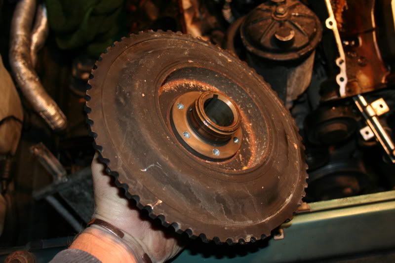

pulley came off as one? i could swear they should break down a bit? Some minor violence needed? i don't need to split it but it had me stumped a bit

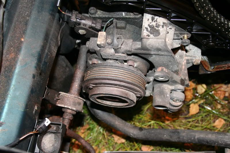

Well i'm please to say that the compressor isn't seized so maybe a new condensor, dryer and gas and the A/C will go again! So it would be rude not to try to sort it!

That crank bolt has been out before, they are supposed to be torqued up to 400NM odd, a 5mm allen key shouldnt even get a look in!

i don't reckon its been off myself i had a loooooong bar and me hainging off it! i thought the allen key would break first

Im surprised, ive had 8mm bolts poked through the hole and they have bent like buggery, alpina fitters must be lightweights

It could of been off, but why i don't know. I've only done the nose bolt up on my E30 to 290Nm (my wrench won't go higher!) and its been fine now and not come loose in 25,000 miles with track work thrown in.
Not to say this is ok but i don't think getting it back to 400 odd spot on is going to kill it!

I wouldnt even attempt it!

As long as the Aux fan is free, then I reckon that AC will be sorted with the parts you listed.

The pulley does come apart - you're supposed to remove the six 13mm bolts and take the pulley/damper off. BMW have a special tool that bolts to the pulley hub and rests against the chassis leg whilst you swing on it. You can make one from an old PAS pulley and a bit of 3 inch wide square section tubing welded on. I use Wurth green threadlock and do the bolt up FT. If you want to know what tight is, try an M30 crank nut - fcuk me they're tight. The last one I did would not budge, even with 3/4 drive stuff and a 5 foot long pole. In fear of breaking something, I covered everything up and ground the top off the nut, splitting it with a cold chisel.

3/4 drive is the only way to move FT bolts
One of the mechs at my local dealer told me about an E36 they had bouncing around the workshop with 5 blokes hanging off it

We have a 3/4" torque wrench for doing crank pulley hub nuts. M47/M57 diesel crank pulleys are dual mass and are common for falling apart.

The A/C fan isn't seized either!

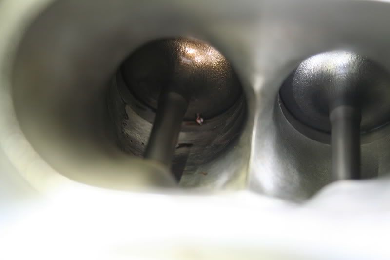

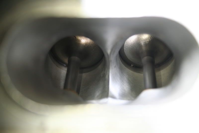

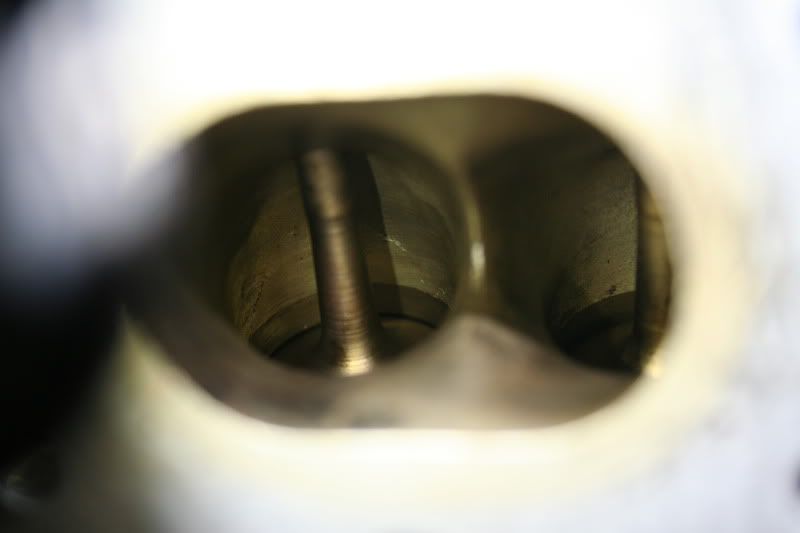

Well i've found the cracks and repairs...............
Repair on inlet 4
one of the untouched inlets for comparison
repair also on the exhaust side again No.4 i couldnt get a pic of the other normal exhaust ports as they're dirty.
This looks to be a very tricky place to repair a head and be successful? Not for the faint hearted tig welder!
Repair on inlet 4

They have gone to town with the dremmel on those ports by the look of it, between the valve seat and plug hole is the favourite place for these to crack anyway.

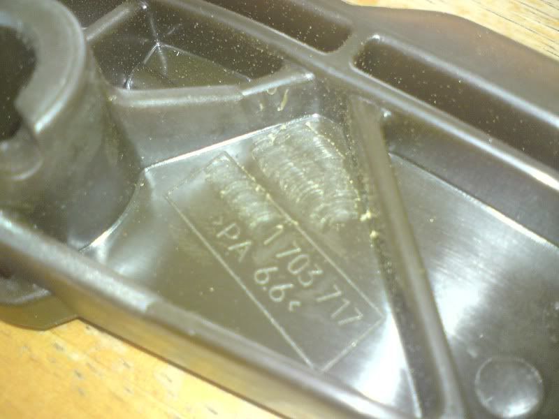

Buy the genuine BMW tensioner rail. The Febi ones - believe it or not - aren't that great. The M30 one I had needed a bit of work with a file to get it to fit. You can get a Jwis chain from ECP or GSF - might even come in a Febi box.
- Posts: 28649
- Location: Staffs
Ever used a plastic M52 febi rail Andy? Ive used 3 or 4 and they have the BMW roundel ground off -
Same part innit
Same part innit
