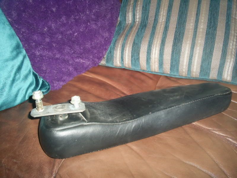

Retrofit of the armrests is going to require bravery Barry,
Had a look when i swapped over the passenger seats, the back pannel requires some sliceing up,
You want me to take some pictures of the components for referance once you have a set to fit?
Its make me think twice about fitting the armrests onto the sports leather*! 8O
*(Which is very nice btw ta!)

Here you go Barry,
I'll take some pictures of the required molestation later in the week, if you remove the back panal on your seats you will see the appropriate holes already placed in the frame, as i say the seatbacks will require modifying skillz...

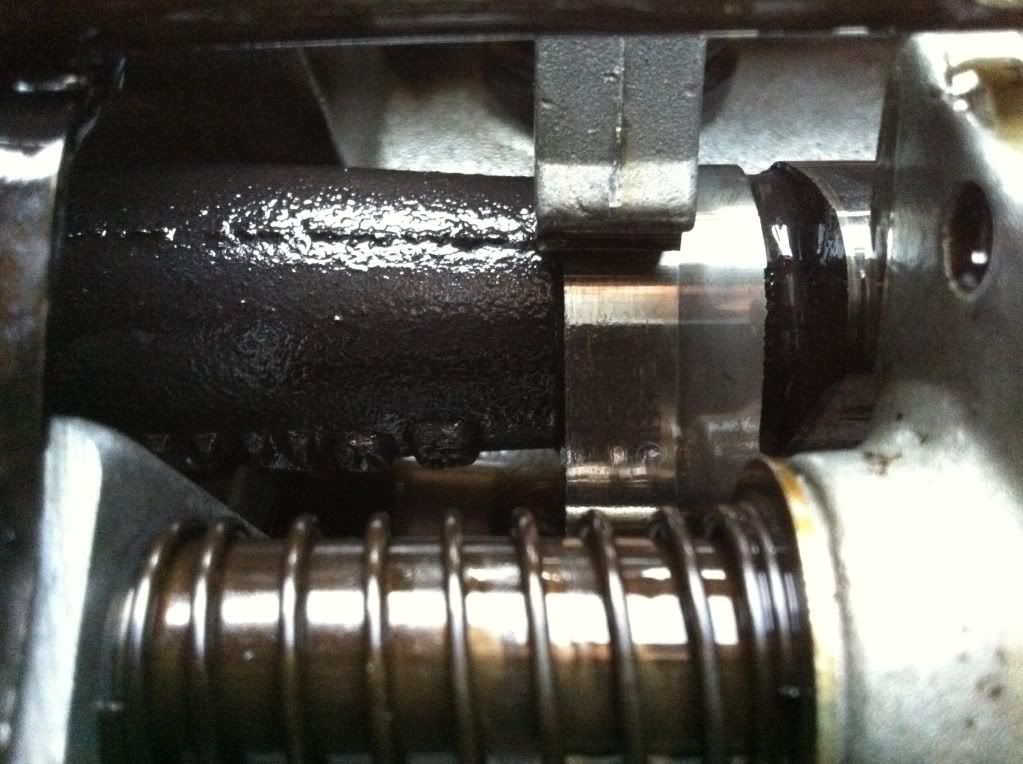

Basically, as mentioned earlier in this thread i had found evidence that the head had been off as it was very clean in there and had a schrick 284/280 cam and some new rockers.
What was a problem is it seemed to be quite noisey from the top end but in one particular area, toward the rear of the head.

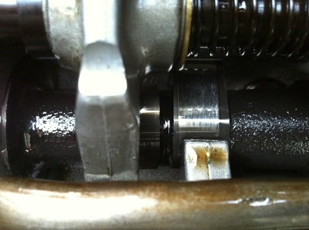

Upon further investigation i found that the rear three inlet rockers were not seated correctly on the the cam lobes which also meant that the eccentric adjuster was not in full contact with the top of the valve, almost hitting the retainer!
After close inspection of all the valve gear it was apparent that all of the springs, washers and rockers were correctly fitted to the rocker shafts so this was not the problem. As the problem was isolated to the rear three inlet rockers which are located by the rocker shaft it meant that the rear inlet shaft was incorrectly seated in the head thus pulling the three rockers back off the cam.
In the pic above you can see the bottom rocker is in the middle of the cam lobe but the top rocker is hanging off!
So to rectify this means the head has to come off to reposition the rocker shaft as it slides out the back of the head.
Disaster i hear you say?! Well yes and no. Yes its a pain but it will give me the chance to go through the previous work properly and replace/sort anything that i dont like!

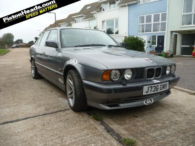

This little gem turned up on piston heads for not a lot of money and it had two ingredients that are missing from the B10, an LSD and a manual box!
After a road test and conformation that the slipper was still fitted, some haggling ensued and i was on my way back home with the poor turd. It had some interesting features fitted which have a comedy value but are also a bit on the naughty side!
I wont say exactly what those switches do but there is light and sound involved! winkeye :twisted:

bss325i wrote:Image
What Barry's failed to show here is the epic rear exhaust bodge including 2 x cherry bombs with 2 spark plugs welded and wired up into them 8O
