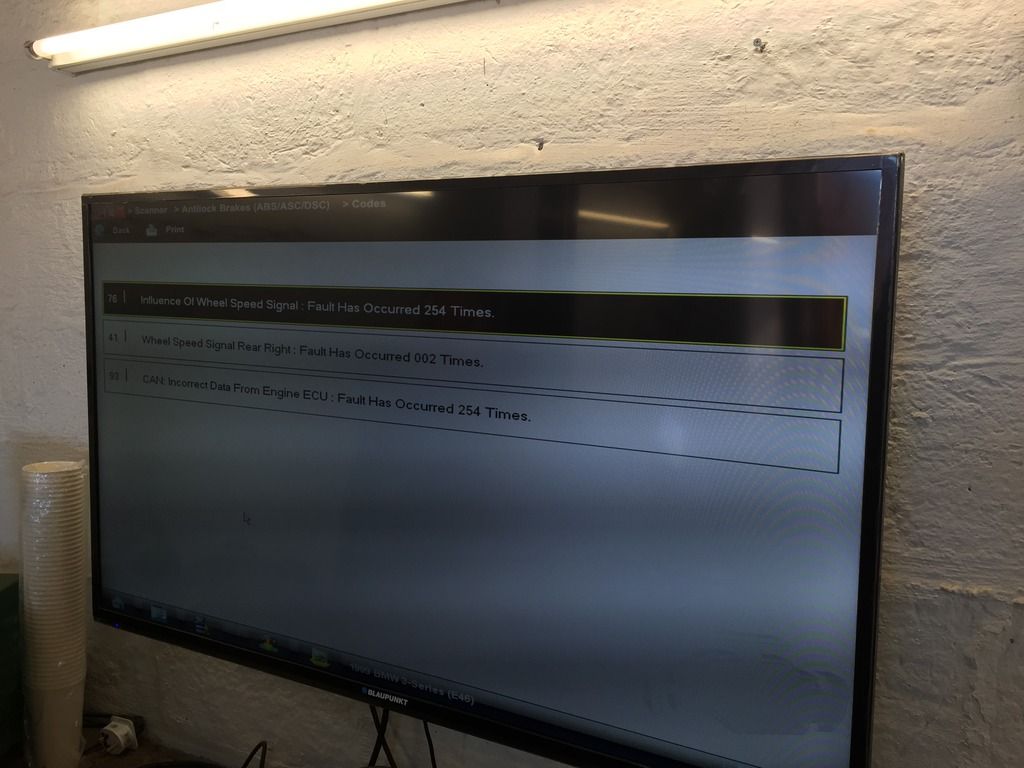

I have recently acquired a 318i and tend to get fault lights on, which ussually go out after a few miles. That's if they decide to go on at all. The three that come on are the ABS, DSC and the brake linings. Now I know the brake linings are due and that one stays on regardless, but any particular reason for the others being on to begin with, then going out after a mile or so?
Would a fault code reader show what caused the light to go on after its gone out?

Willinz and P_Viddy are right, rusty pick up wheels or magnetic swarf stuck to the bearing seal pick up if it has that type are a common cause of intermittent faults with ABS lights coming on, usually once you are up to 30mph+.
The CAN fault is a communication fault between the DME and ABS, check the power supplies and earth's to both control units and the BUS lines between them.

You check bus lines with an Oscilloscope to see if a message is being sent, you can check them with a volt meter and ohm meter but that can involve a lot more work disconnecting all the control units on the circuit.
Velleman do a pocket scope for about £120 worth every penny if you do a lot of electrical diagnosis
Have you checked the sensor wheels to see if they are rusty yet or damaged?

Now have you had a look at those sensor wheels yet to see if they are rusty or damaged, that is the first step and a piece of piss to do
