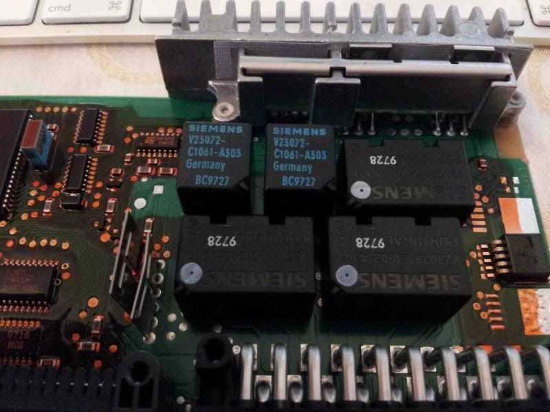

Wed May 07, 2014 7:46 pm
Makes sense that its a relay problem, this is exactly the same as whats on my car - http://www.ebay.co.uk/itm/121171332709? ... 1423.l2649
But it does say its from a saloon which could be a problem? Or its wrongly identified..

5 relays in this, one has fell to bits as I can hear something rattling about in it
Wed May 07, 2014 8:13 pm
Actually its only 3 relays, the two with the blue text only have two pins on the underside of the board

Have a look on RS for the relays. Would be pretty simple to repair of the relays are at fault.
Brianmoooore
Posts: 49358
Wed May 07, 2014 9:30 pm
The V23072-C1061-A303 is RS Components 718-1692 @£4.81 each.
They don't stock the V23078-C1002-A303, but this is a twin 12V 20A change over relay, configured with the NO contacts connected together to pin 8 and the NC contacts together and to pin 5. This means that with power connected to 5 and 8, and a motor connected to the relay common contacts (6 and 7), the motor will run in one direction if one relay coil is energised, and in the other if the other coil is powered.
Obviously won't fit on the circuit board, but two external relays could be bodged with flying leads.

I found these Dan?
http://www.ebay.co.uk/itm/Tyco-V23078-C ... 3f25e0a8b6
Also maybe just use the relays from the good GM?

Plan is to take a relay from another module to repair mine, ive dropped it off to my mate who repairs this stuff for a living 8)
