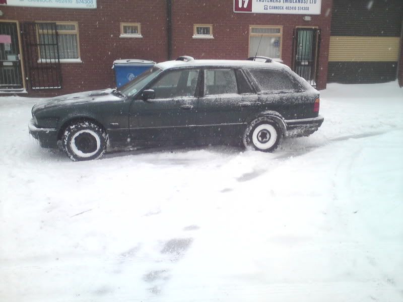

I used 195/65/15 winters on steels, but only when snow/ice was on the ground, when its dry they are not the best to drive on due to the smaller footprint and extra flex, ok for going slow/sensible but you cant put your foot down
Dont get me wrong though, they are fantastic to drive through snow, nothing stopped me at all

being thinner they'll be better in the snow, but fractionally less sidewall. tbh, i'd run the thinner ones, especially with such a saving!
I've got a pair of 215 45 for the e36 when the recommended size is 225 45, but only plan on using them when snow is imminent. used every day, i think they'd be dead before the end of winter as they feel very soft.
