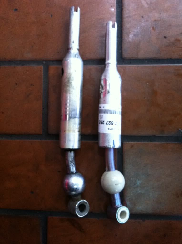

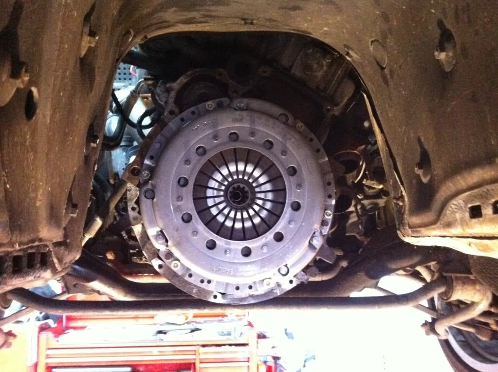

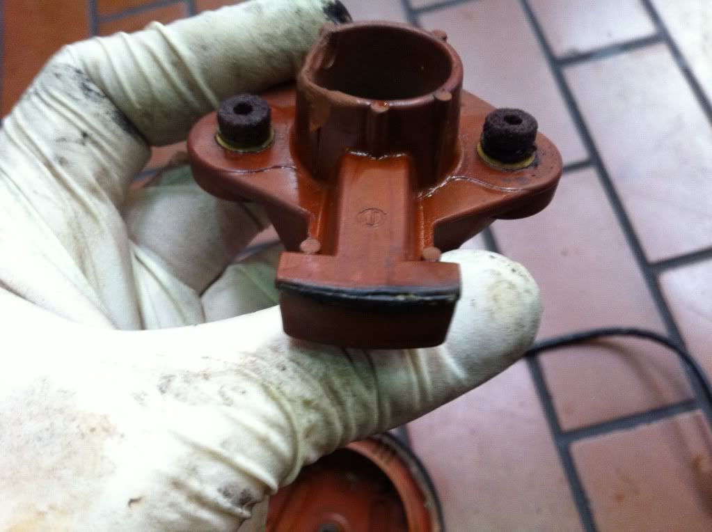

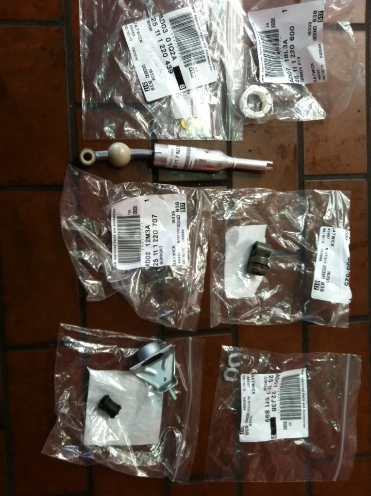

New genuine BMW clutch along with new bolts, spigot bearing and rear main seal.
All the parts to rebuild the gear linkage and i thought i'd give a Z3 1.9 stick a try.

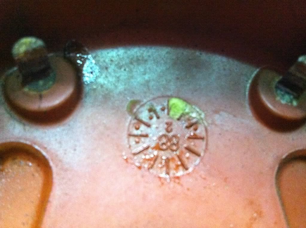

Original cap and rotor still fitted from 1988! Pretty f*cked but it still ran ok! Both were replaced with new Bosch items.

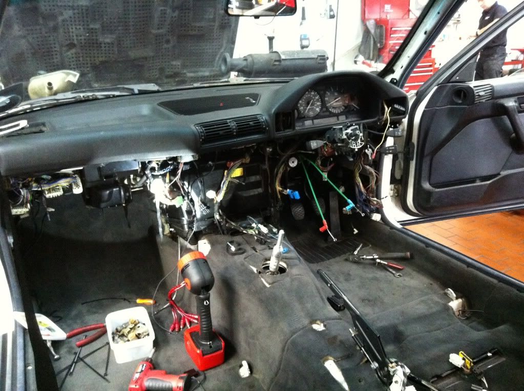

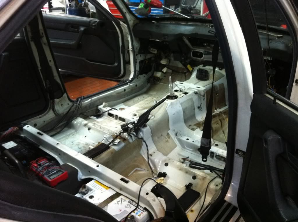

Complete interior striped to reveal no rot anywhere luckily!
Dash top and carpet in mid way through the interior fit up

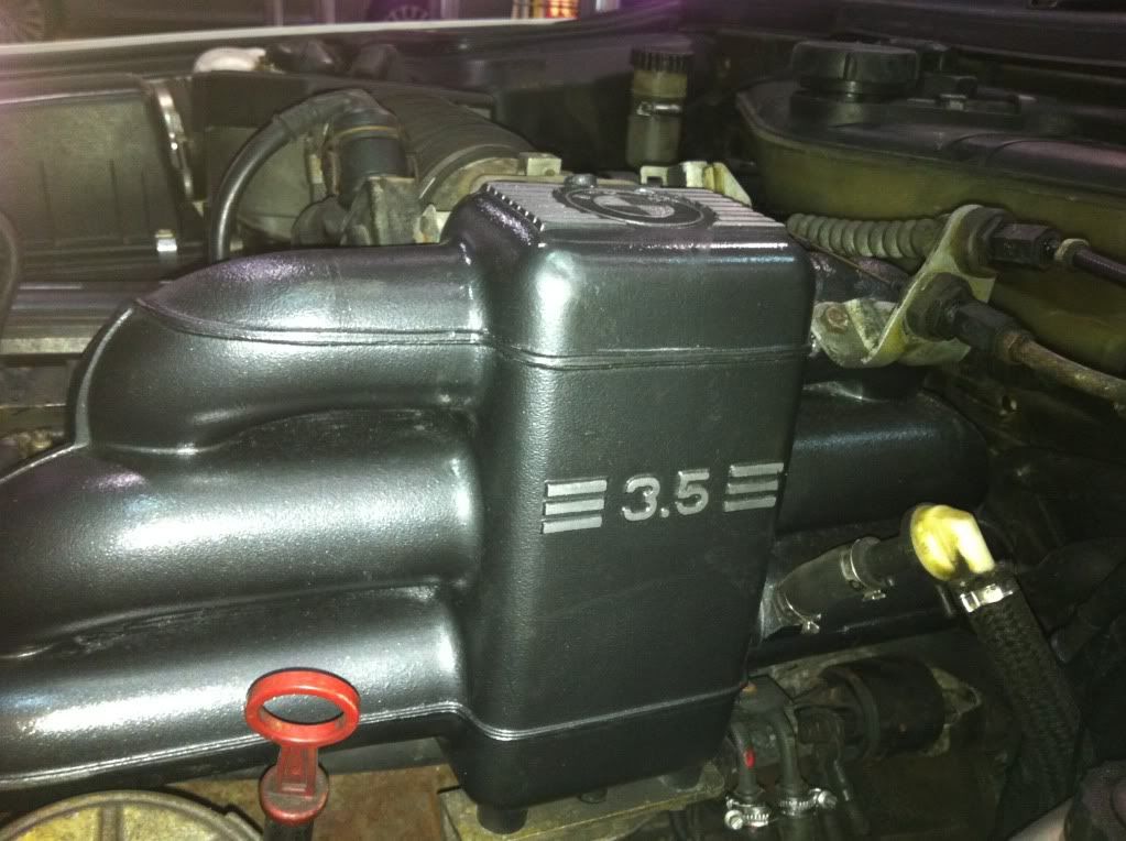

A few more pics for you picture hounds! :)

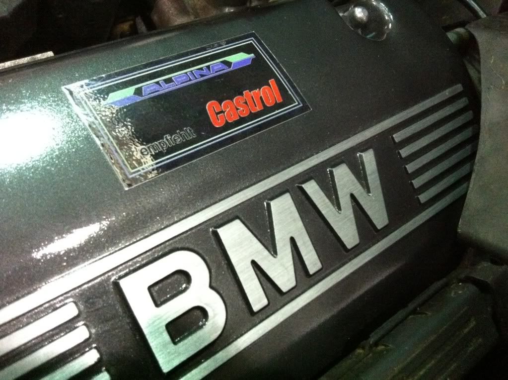

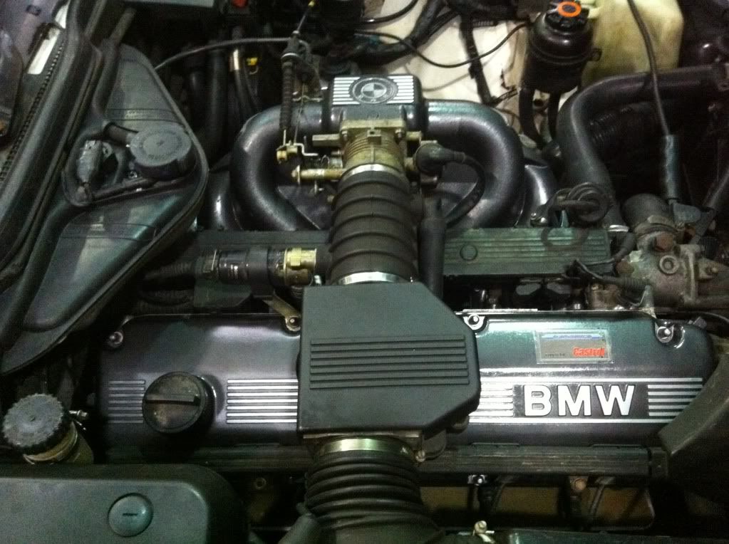

The rocker cover and inlet Trev did for me in the correct colour for Alpina M20/M30 engines along with an exact replica of the Castrol/Alpina Label courtesy of Pukar.

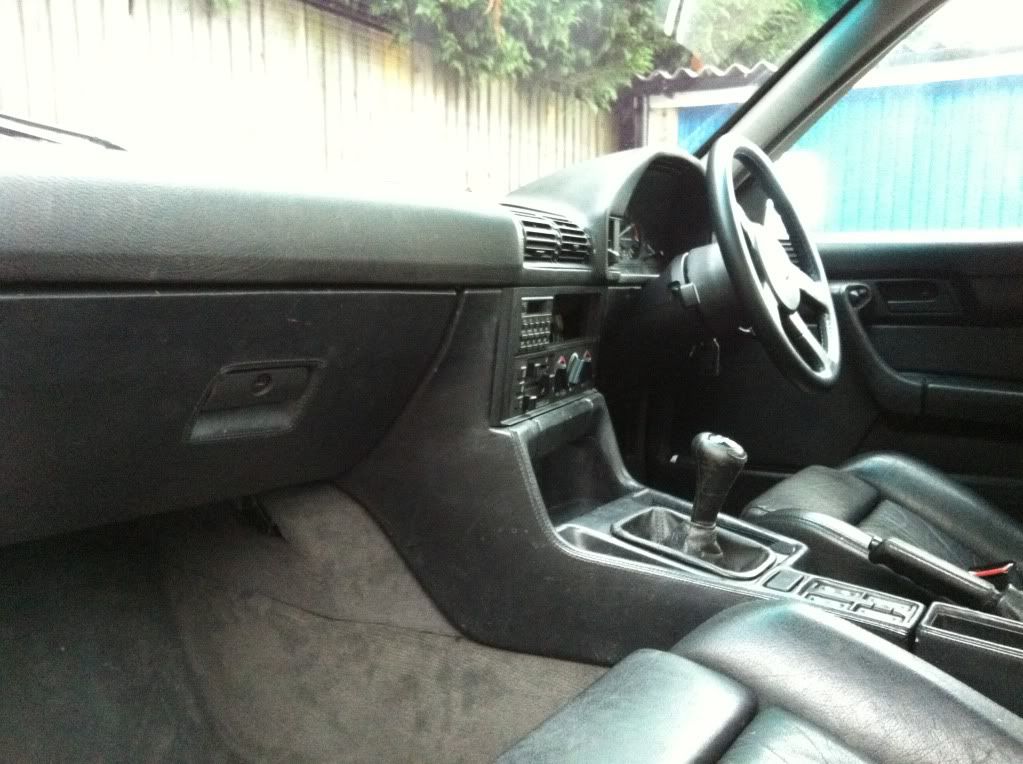

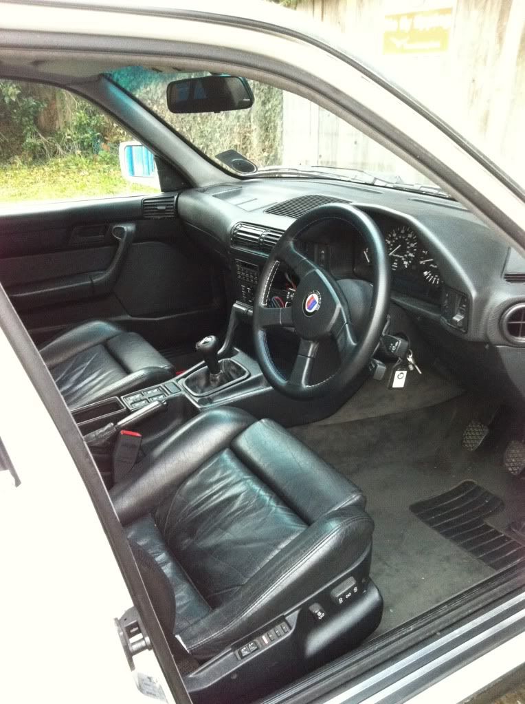

And a couple of the interior now its gone from nasty indigo blue cloth to Black extended buffalo sport seat. The interior is in dire need of a clean and detail as is the rest of the car to be frank.
Can you spot the missing item?
