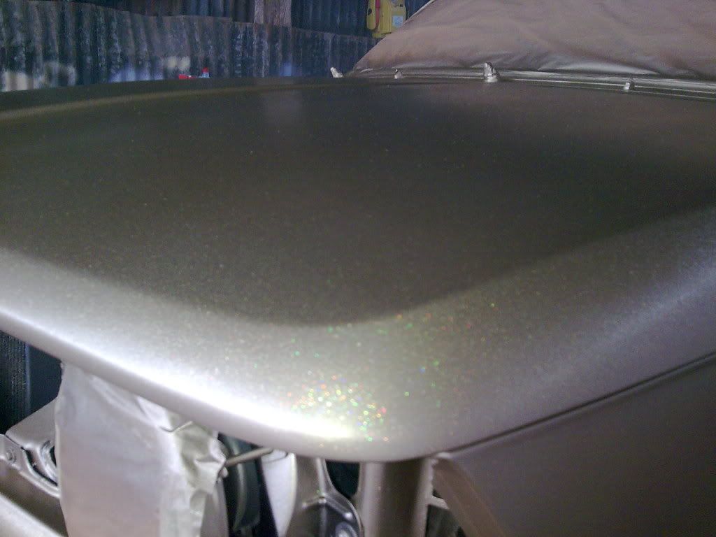

Rubbed down,anti-stonechip spray followed by 2 coats of smoothrite gold.
Same treatment for the rear arches

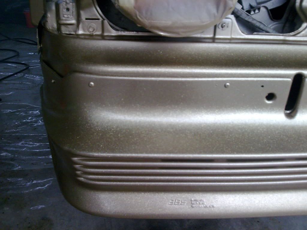

New front wings were sourced
along with a BBS front spoiler

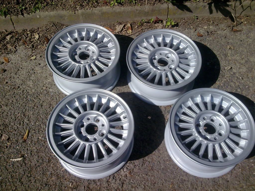

It came with really scabby alloys
Well after hours of work with wet & dry,Simoniz wheel spray and galons of laquer (not to mention several elastoplast) they look like this :-
Somewhat manky

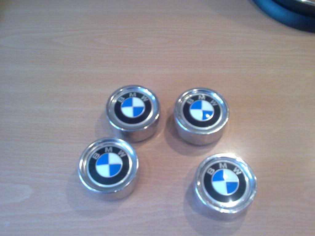

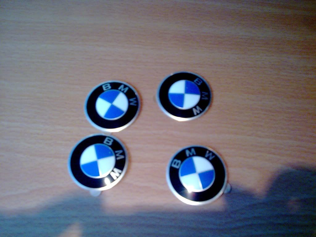

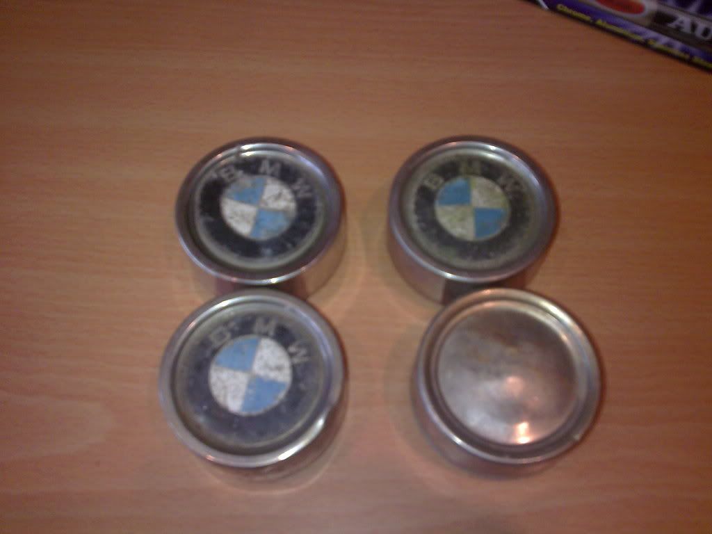

Bought some new centre cap badges from the BMW dealer,£13 for 4 which was nice
And after a bit of work with autosol,they came up like so :-

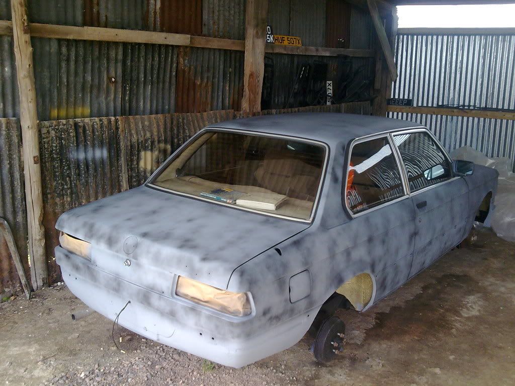

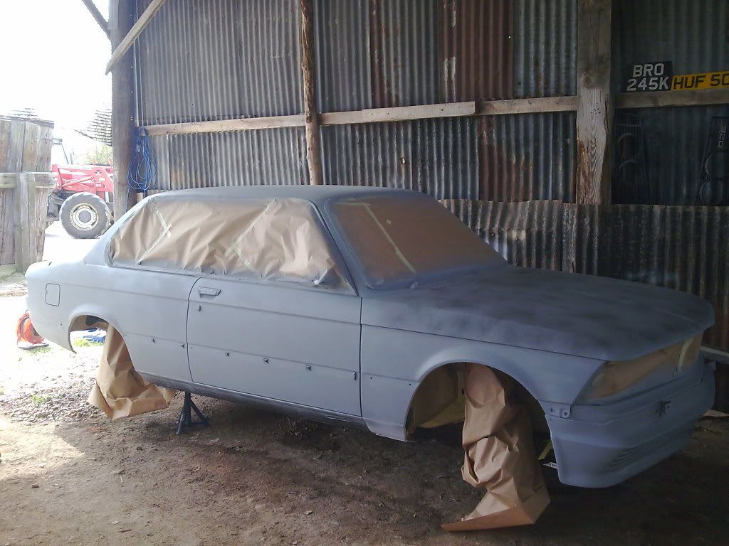

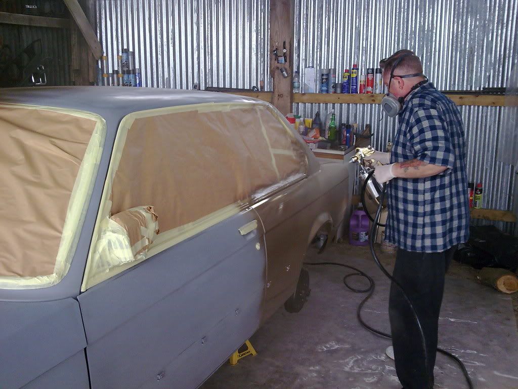

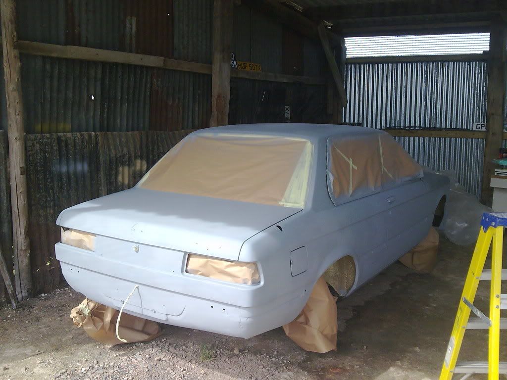

In high-build primer,note the ladder..being a short-arse I needed it for the roof

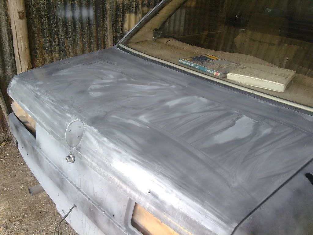

Then sprayed a light black guide coat all over it.

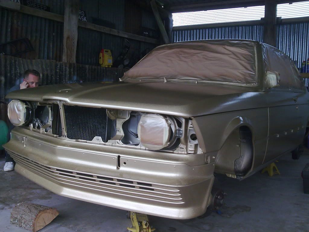

Then removed masking paper and was glad that I took my time masking up,no overspray!

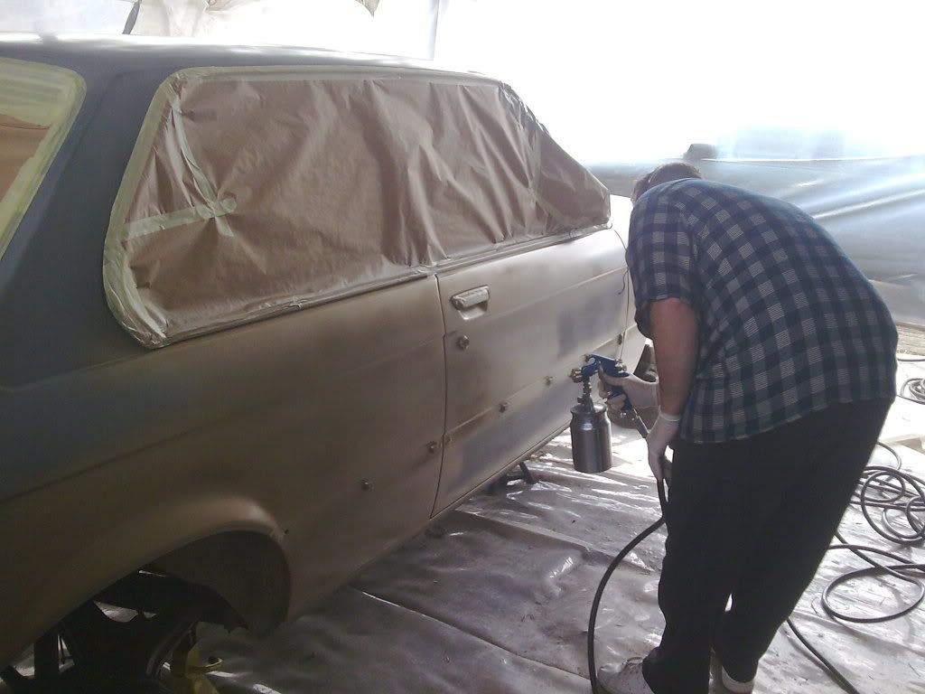

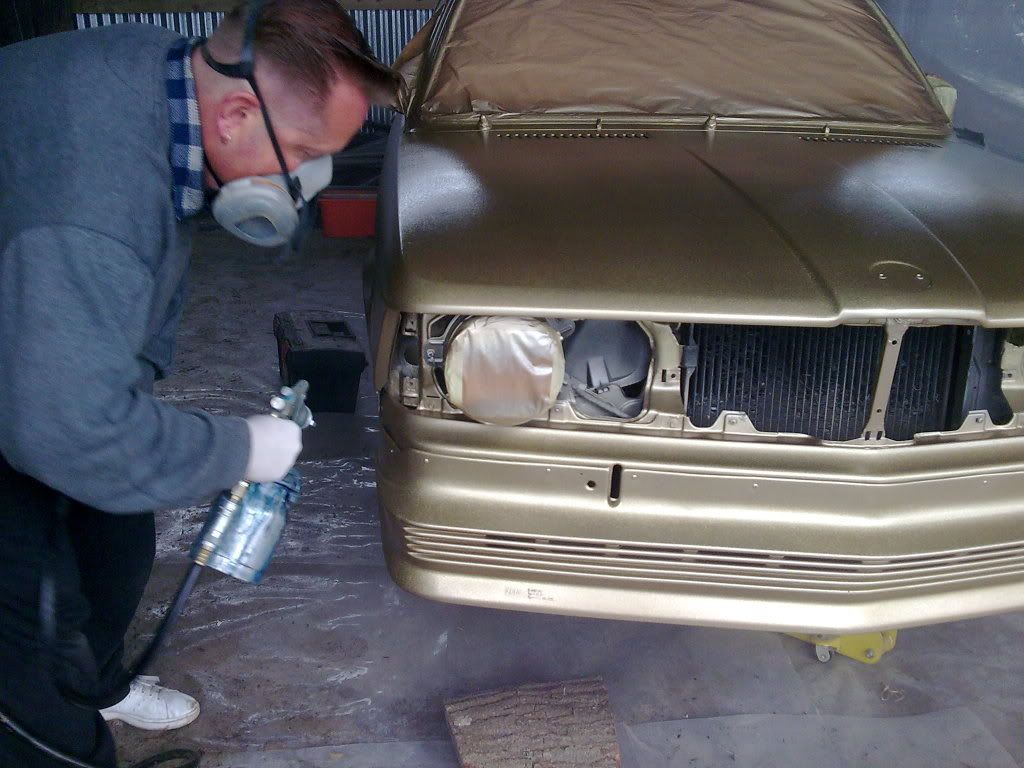

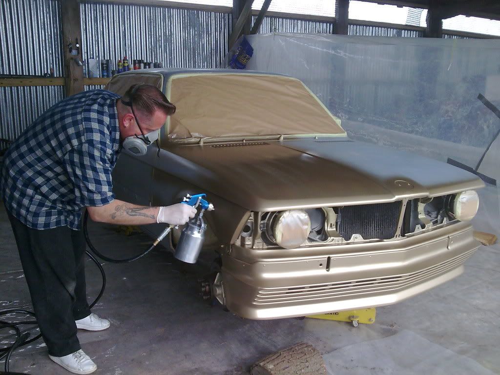

Then came the fun part,paint!

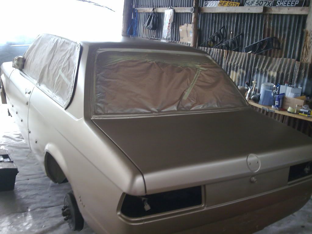

Me & my mate Paul painted it in the original basecoat colour,but added metalflake in the laquer for extra bling!

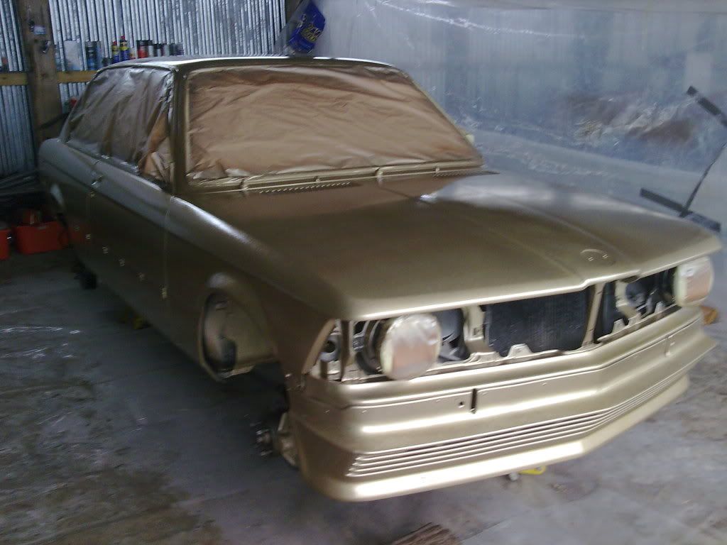

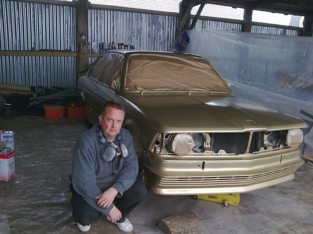

On goes the gold basecoat
Basecoat done.

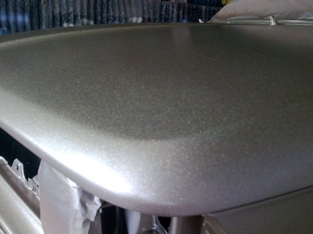

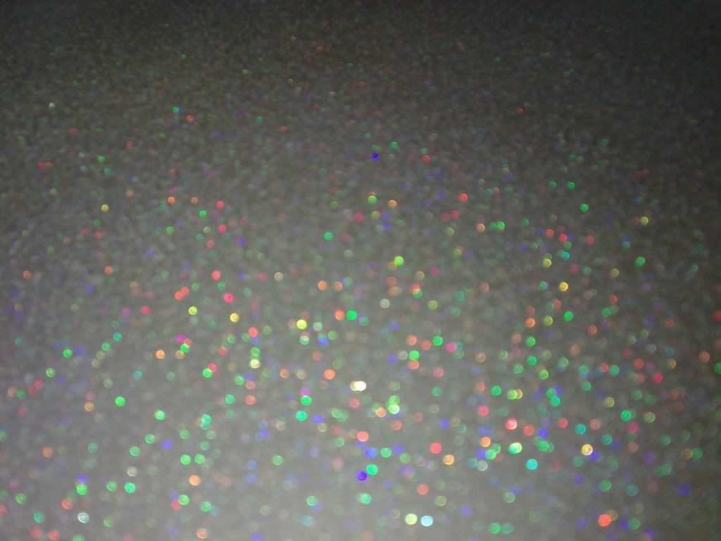

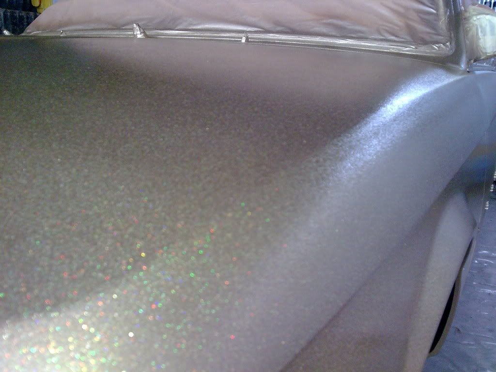

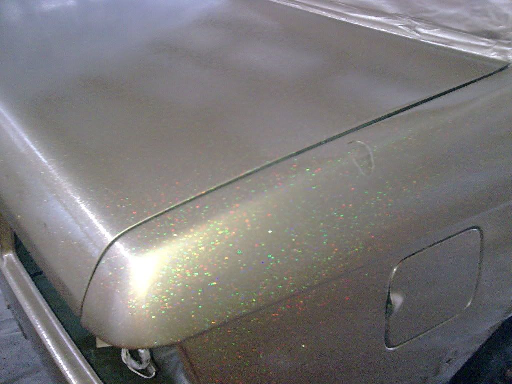

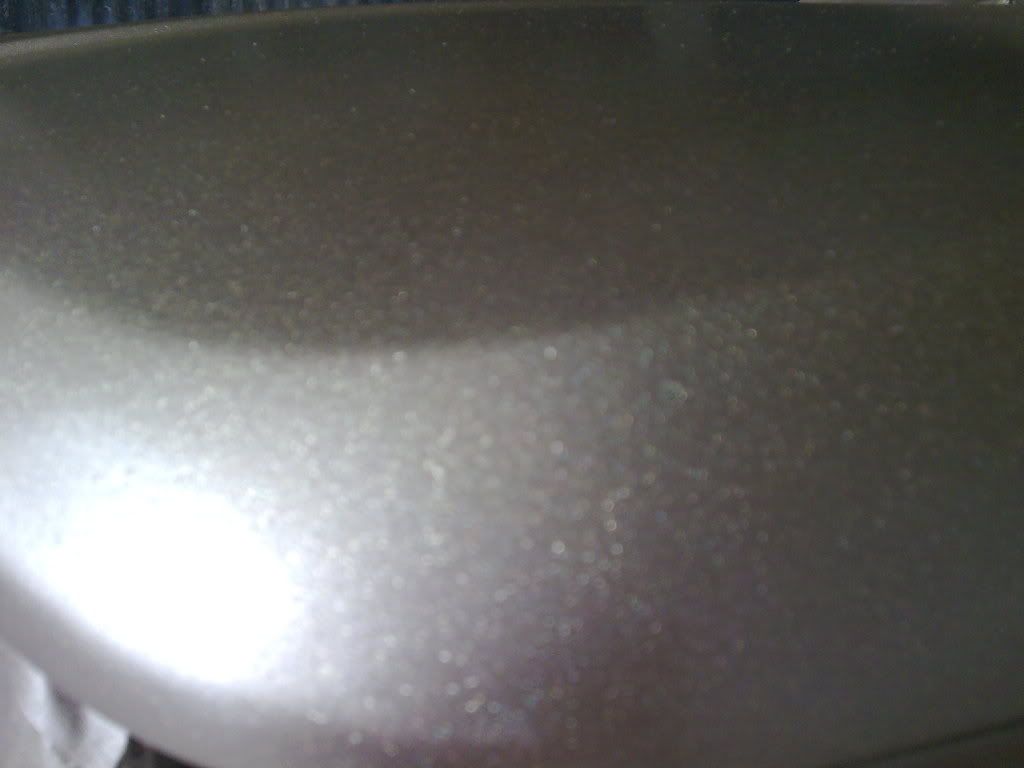

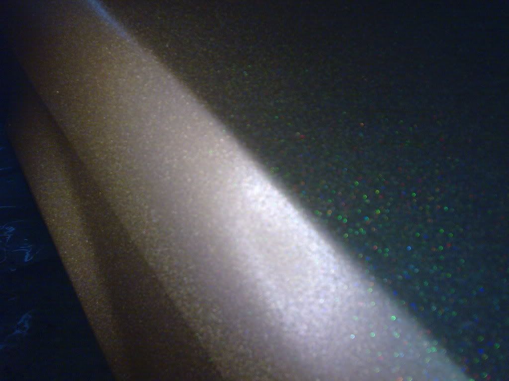

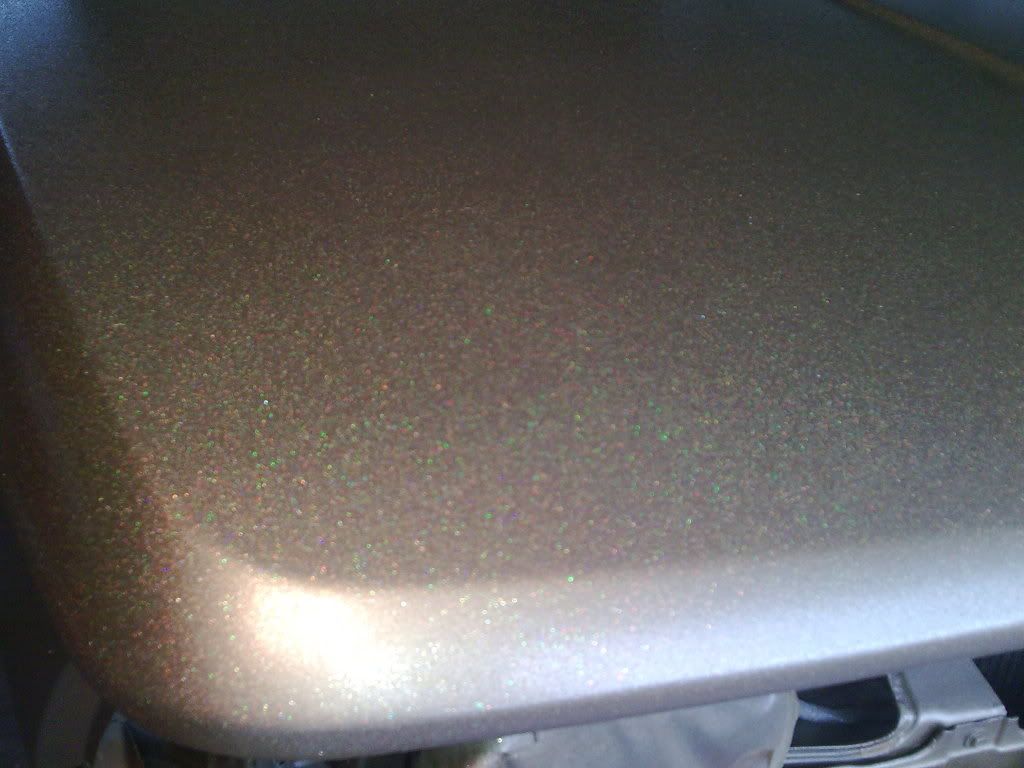

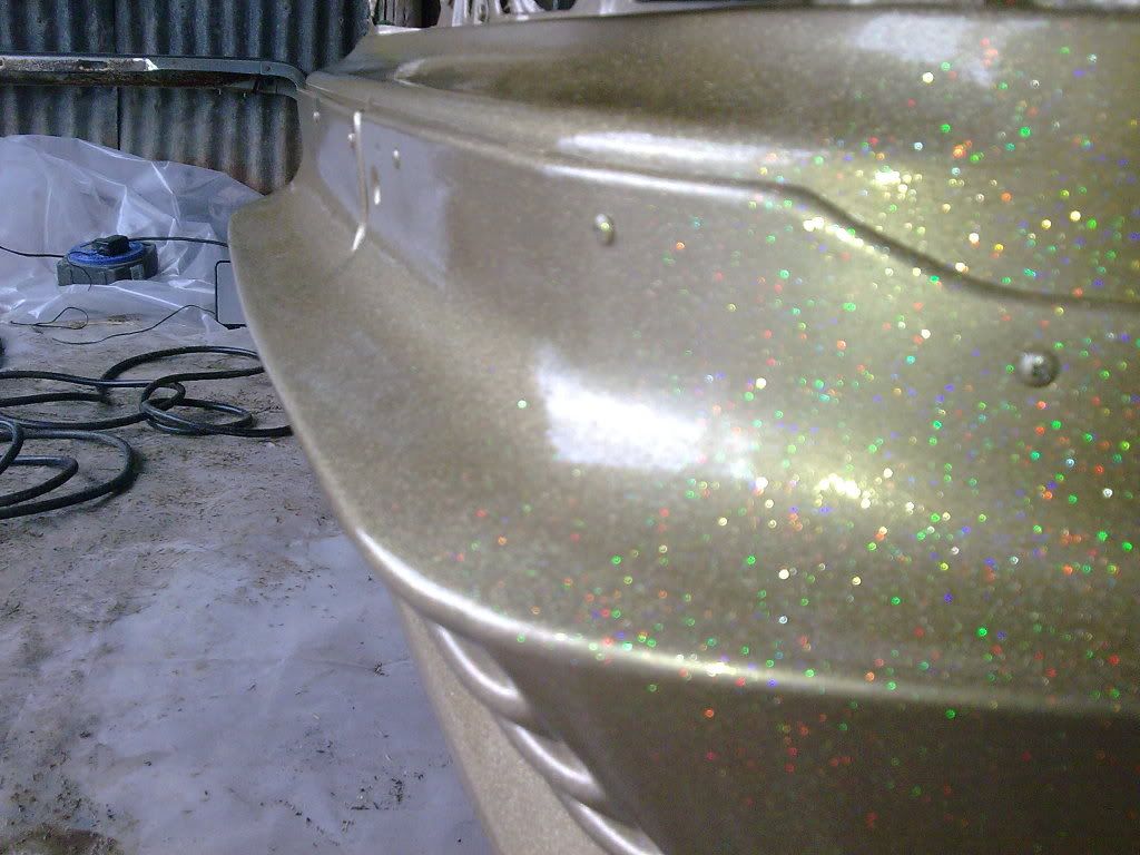

Mixing the flake ,we used 10 tablespoons per litre of lacquer! Word

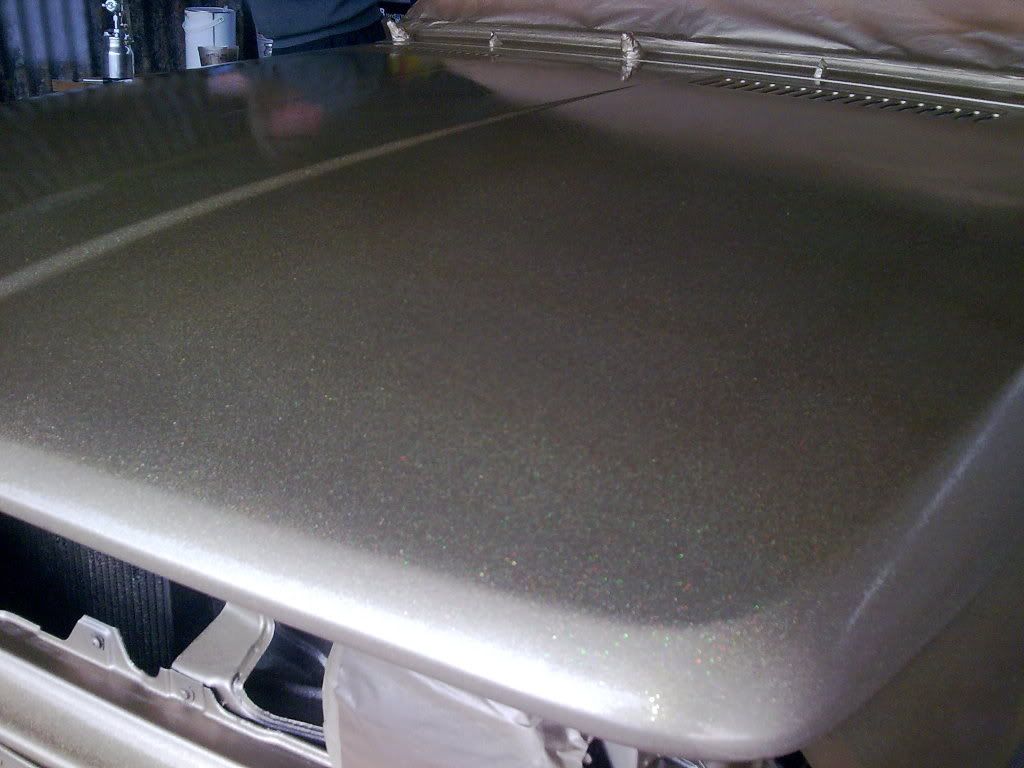

Sparkly shit.

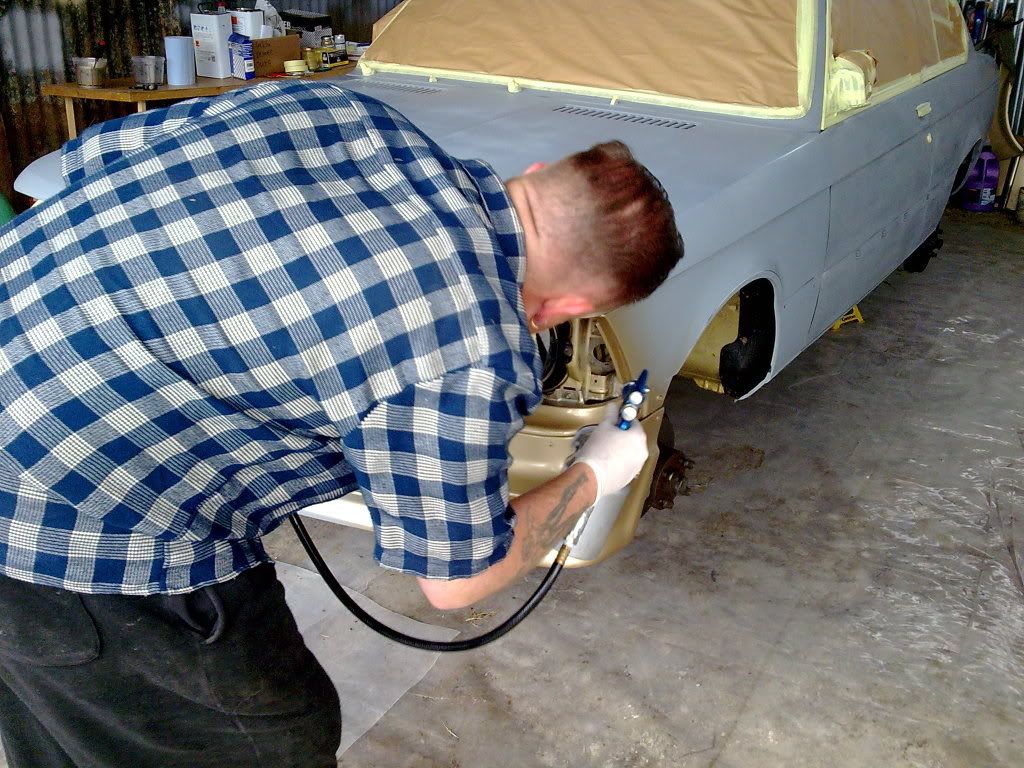

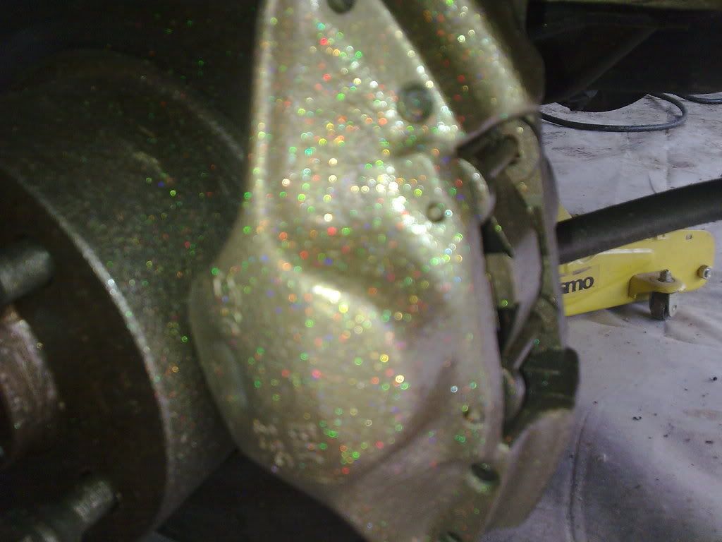

Flaked calipers

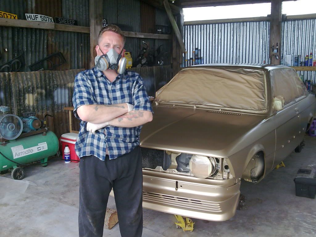

The big dog with his handywork.

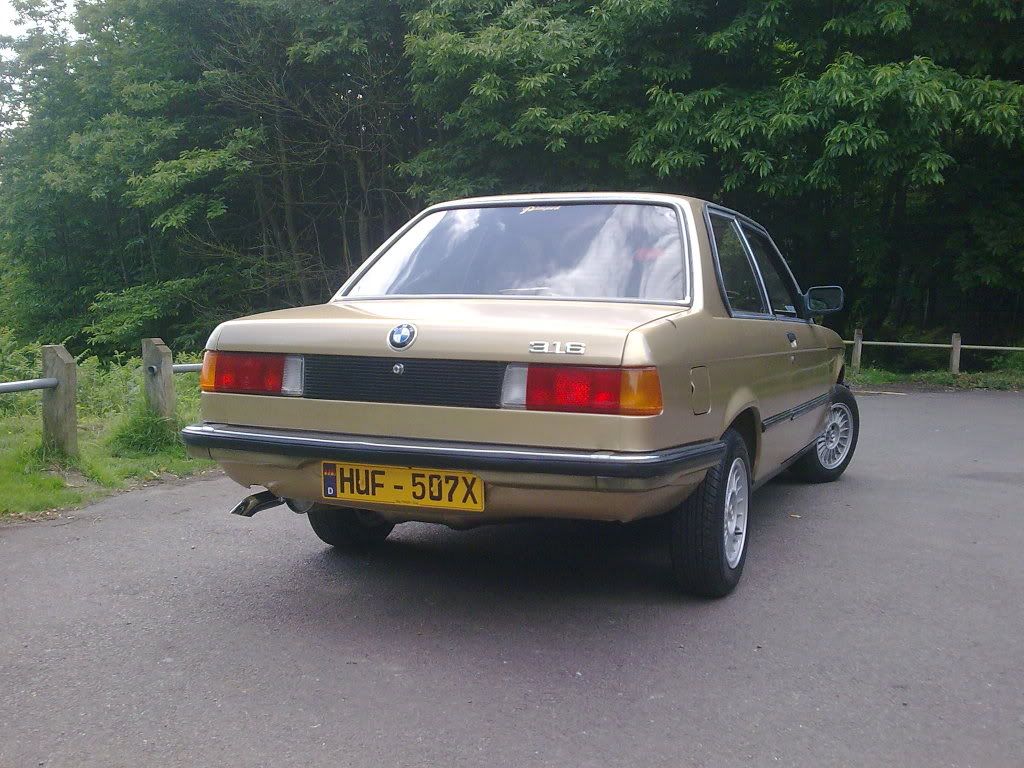

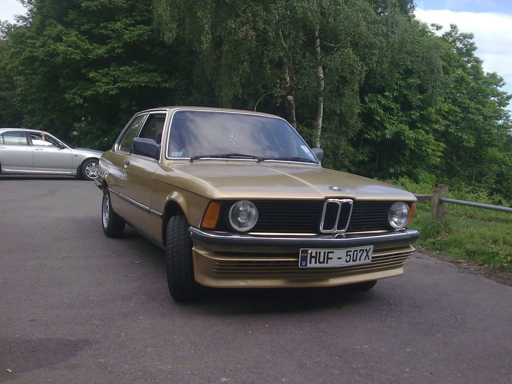

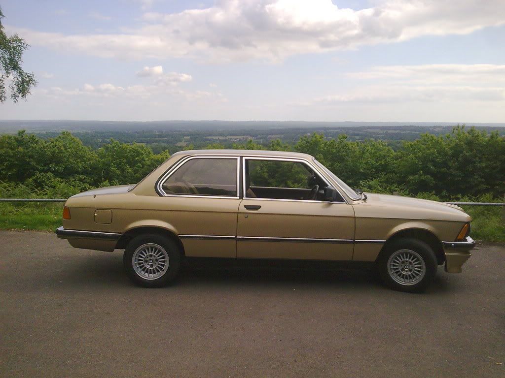

And here she is,the flake really comes out when the sun is shining (not often enough!)
