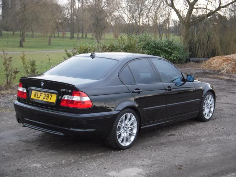

I've got a E46 320d Sport -
I bought it new back in Sept 2004, in that time all I've had gone wrong is a broken spring - cheap and easy fix.
It's got 35k on the clock, I change the oil every 12mths regardless of mileage and what the service indicator indicates. I'm fully aware of the swirl flap saga but never thought of having it rectified :?
I can highly praise them and I'm very reluctant to chop it in against a E60 535d, hence the new purchase of an M3 instead of a hefty depreciation on the 535.
