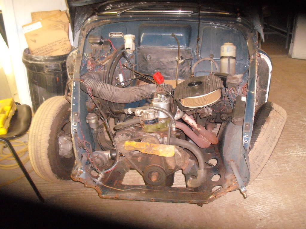

I recently managed to bend a torsion bar on the Marina's predecessor, the Morris Minor, following a skid on wet leaves and a knock up against a kerb that stoved in the (rusty) chassis leg. Quite a feat, considering that they had survived 39 years prior to the incident:Andyboy wrote:Dunno Peter, but the front rates for a '74 1.8TC Jubilee* (four door) are 345 lb/ft/in. That compares well with the bar rates on a lowly 1.3 Deluxe.
*Known in Sweden as the Maurice Mariana Torsionlanda.
Fear not though, Zoners, for the trusty Mog is currently being fitted up with a new chassis leg, engine bay panels, passenger side floorpan and new torsion bar
