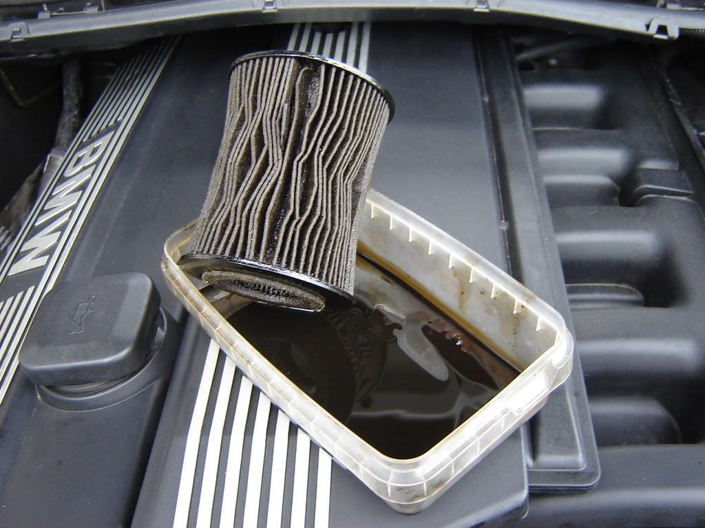

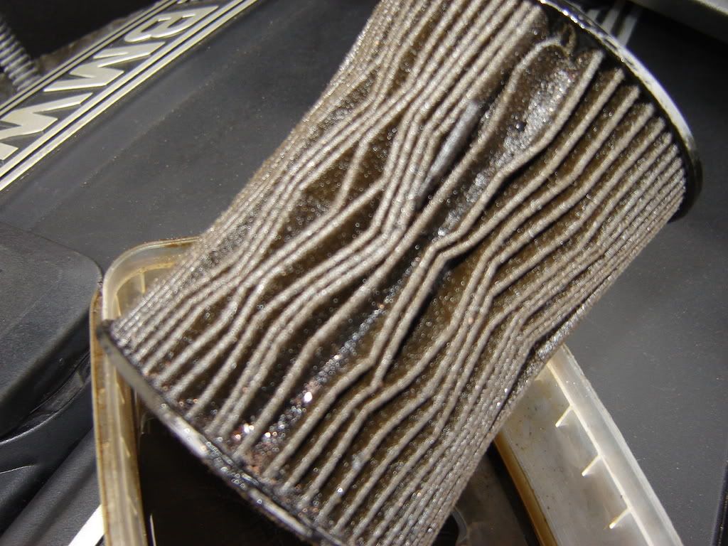

Last Saturday morning (19th July) my wife was driving to work and had only travelled a few miles from home when she heard a knocking noise from the engine. She immediately pulled over and shut the engine off. She phoned me and I drove my works van over to where she had stopped. I started the engine and as soon as I heard the noise I shut it off immediately. I knew that there was internal engine damage straight away. I then drove the wife to work in my van and returned to where the car was parked and got a mate to tow the car to my mechanic.

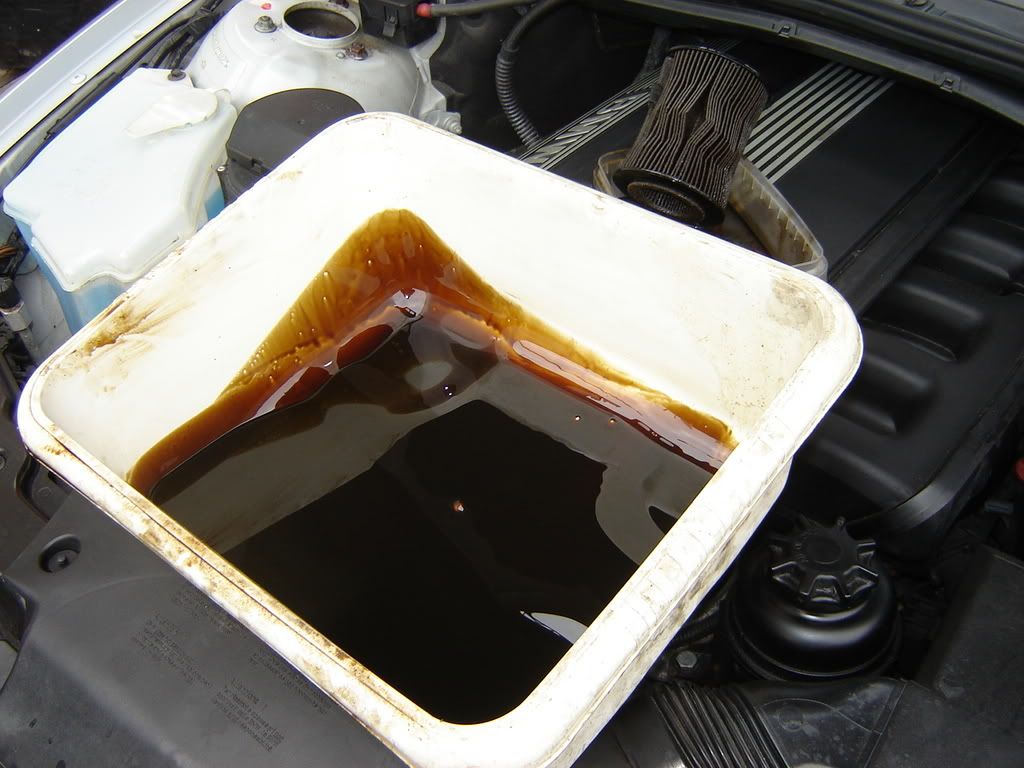

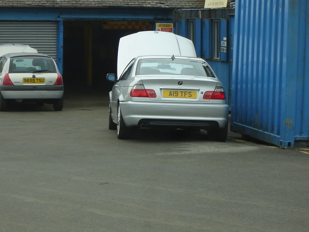

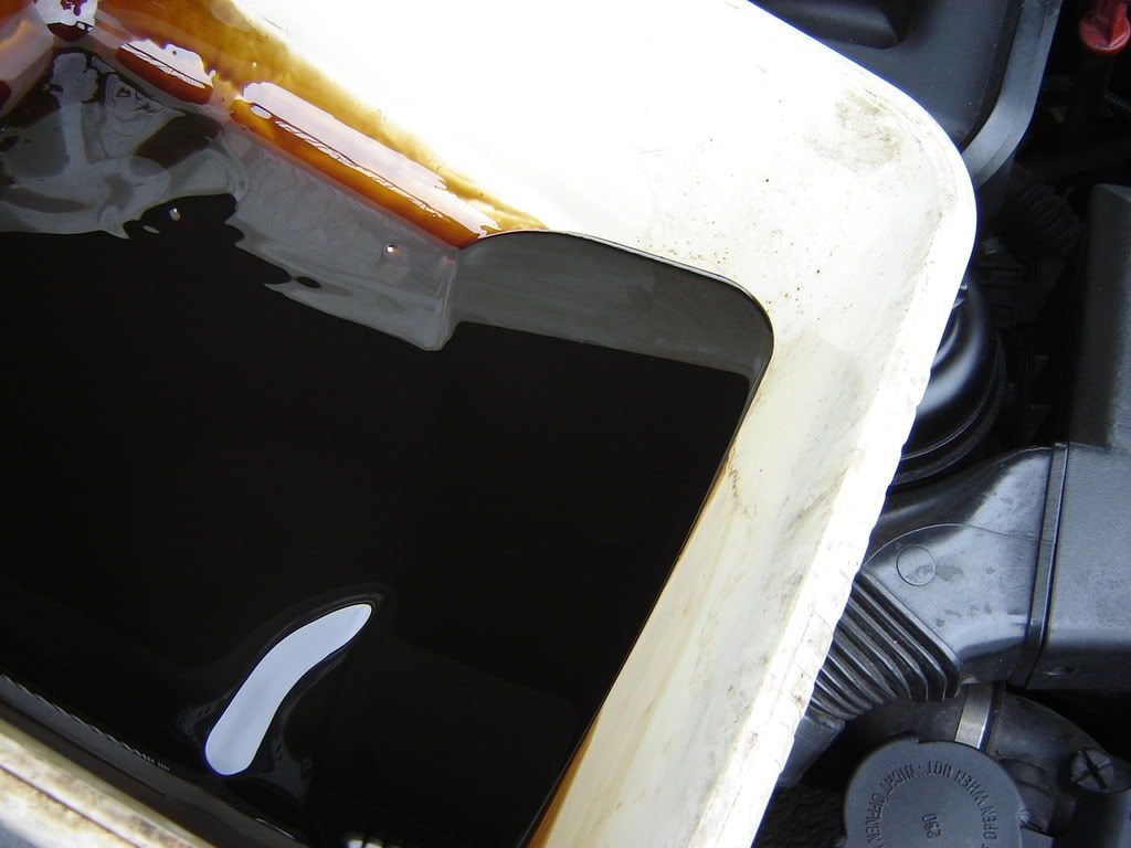

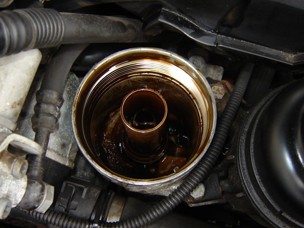

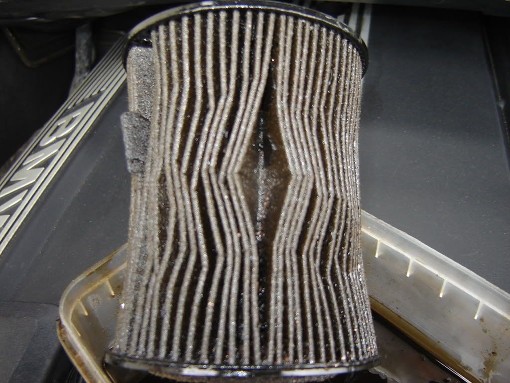

On Monday after work I went to the garage where the car had been towed to. The oil filter had been removed and the oil was drained from the sump. This is what the findings were -
Now obviously the oil & filter change had not been carried out as promised by the seller. The filter is so badly clogged that it has caused oil starvation to the engine. The oil is like treacle & the filter has started to disintegrate and there are metal filings in the oil & filter. At the very least the engine is going to need new bearing shells and obviously worst case is a new engine. The extent of damage won't be known untill it is investigated further.

Firstly - that engine is scrap. Forget about putting a set of shells in, it's finished. The crank will be buggered, the oilways full of swarf and crap.
Assuming you repair it yourself, a good used engine is the only way to go - it's a double Vanos M52TU so you could even drop a 2.8 in there. You may want to get the car fixed and then sue the tw*t. The car is no use to anyone sat there for three months whilst the courts chase him.

Doesnt look like that car has had fresh oil for a few years

Right Guys, got an update today from my mechanic. No. 6 bearing shells are fubar and there is slight scoring on the crank which is enough to justify a re-grind. So crank would need to come out which means timing chain off which means cylinder head off. Labour costs alone mean that most economical option is a replacement engine.
They are going to supply me with estimates for both options (cost to repair existing engine and cost to fit a replacement engine). So I should have the estimates tomorrow and then I can go back in to trading standards to get the ball rolling on a claim.
