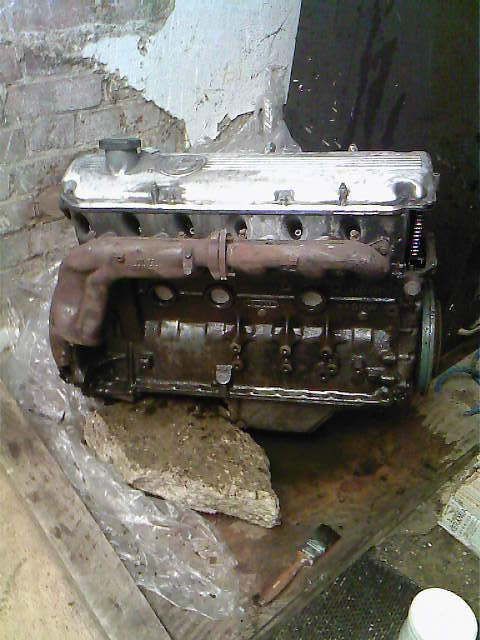

whats the easiest way of removing rust from a block?
whipsey
Posts: 3731
Location: kettering
Post Wed Jul 11, 2007 10:37 pm
i've been trying to get the engine block back to bare metal so that i can give it a coat of paint but im having trouble finding something to remove it i;ve brought some hammerite rust removing gel but it isn't really making much differnce whats the best thing to use i was going to get a portable sand blaster cause this won't fit into my cabinet any ideas?

dissassemble the engine and acid dip?
maybe a little too much..strong degreaser (maybe not even environmentally friendly, gasp!) and hard work, sandpaper, scrubbing brush etc. cant make it too mint when its still a complete engine, i would worry too much. just make it so you can handle it without getting too grubby

Drill with wire brush attachment?

i wanna remove the manifold and get rid of all the rust on the block i've got some high temperature laquer that i wann :D a use on it

maxfield wrote:Drill with wire brush attachment?
i've tried that already max can't get into it enough unless you know anywhere i can get a longer one mines disc shaped

Can't you get flexible attachments for drills? Jenolite rust remover (acid based) is quite good.

Nitromores, let it sink in then go at it with a wire brush and some serious elbow grease, then wash it down.
Dry it off with a blow torch then de-gease it with carb cleaner or de-greaser (whichever's cheaper) then let it dry or use the blow torch again but watch out for the fire ball :twisted:
Then its all ready for a lick of paint.

i used angle grinder with the extremley stiff circular wire brush on the end....its seriously viscious and cruised through the rust. then for the little bits in gaps i couldnt get to i used a very stiff wire brush in a drill. i removed it all in an hour or two. dont expect to get all the old paint off because some bits are on so solid they wont move, so paint over them as if you cant get them off with wire brushes they wont move when painted over.

the blocks not been painted yet its all rust

needle scailer, if you can get hold of 1, then wire brush in a grinder, just keep a good grip on the grinder :wink:

why not take it and have it sand blasted?

DaveD wrote:why not take it and have it sand blasted?
you try lifting it mate it's not light lol i may aswell buy a portable one for bigger items my other one is a bench top one and won't fit it :mad:
