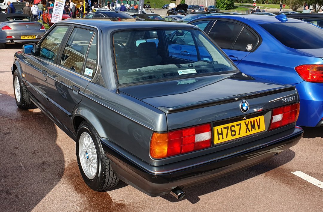

Detailed the car a few weeks ago and thought I'd post the results of Menzerna 400 as it was my first time using it. Having used Meguiars 105 previously, the dusting from it was infuriating even though it was excellent at cutting paint.
I tried a few passes of the Menzerna after claying and it had very little effect. Decided to wet sand with P2000 to clear the oxidisation and this is where the Menzerna comfortably dealt with the sanding marks and left very little smaller scratches. Another pass of Meguiars Speed Glaze finished of the panels very well and then IPA prior to the pin stripes.
Very low dusting from M400 and a good working time even when it was partially sunny and reasonably warm outside.
Imagemen400 - 4 by MujONE, on Flickr
Imagepin6 by MujONE, on Flickr
Imagepin9 by MujONE, on Flickr
Imagepin8 by MujONE, on Flickr
Imagepin1 by MujONE, on Flickr
Imagepin2 by MujONE, on Flickr
Imagepin5 by MujONE, on Flickr
Imagepin4 by MujONE, on Flickr
Imagepin3 by MujONE, on Flickr

Well done for having the balls to use stripes................I love them :cool: :cool: :cool: :clap: :clap: :clap: :clap:

Nice work :thumb:

I've always been a fan on the stripes, look naked without them in my opinion. I wanted grey/silver but they are NLA. I put silver/silver on my diamond black 325i but thought they'd stand out to much on dolphin grey so opted for black/silver. A subtle nod to the 80s.

Nice! Do you have any photos of the car side on? I’ve got a dolphin grey and always wanted to do the pin stripes as they looked great on my red 316. But I’ve not been sure of which combo to go for with the Dolphin grey

Not right from the side, still a bit of an angle on the photos. Many stripe combinations are NLA, I put silver-silver on my last 325i but went with silver-grey for this one. It's very subtle, the grey can only be seen in certain lights and at certain angles.
My first choile was light grey-black but not available anymore 😓 my old dolphin grey had black-black and it was even more subtle than this one!

Did they really look this good back in the day ????
That stands up so well today.

Good job on the paint correction - looks great..

Great looking car and good job with the stripes. Stripes suit the car and capture the period perfectly.
The detailing on this car looks brilliant ( a fellow OCD detailer ? ) - nice to see that the engine bay looks stock without the need for a repainted rocker cover etc.
The vid is also good - a much better "sales" vid than the so called "professional" ones that are on dealer websites. I notice original mats in good condition. The missing heel pad on my mat is the only thing letting my interior down.

It was prepped and detailed as I had a good idea it would come up well as the car had been garaged all its life. A lot of hours went into it, engine bay was the weakest part, which I will detail this year but I won't be painting the rocker cover as I also prefer the original look.
My heel pad is starting to lift, I kept them from my 325i as I love originality wherever possible.

I think the black silver stripes look good. Are they available still? Is only place to get from dealer?

Hi! No worries at all. Black/silver are still available, I got them from Cotswolds here on the forum.

51141933378 is the part number and were a shade under £60 last year.
