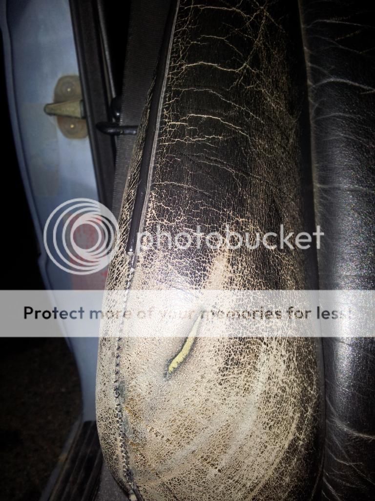

Hi my drivers seat is in a sorry state but the rest of interior is still fresh, is this repairable or for the bin? Image

Depends on your skills for the beading, but the split should be repairable using a kit supplied by the furniture clinic people. Approx £50?

As gert mentions the seat would need retrimming on that bolster to get the piping back, but recolouring and fixing the split isnt that hard, then use gliptone to keep them supple
