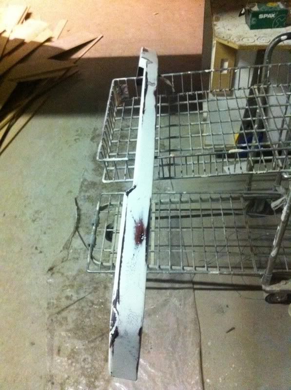

Lip spoiler

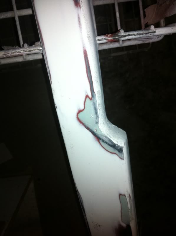

So far, I've filled, sanded and plastic primed it. Then I gave it a few coats of filler primer. I've just now sanded that back to get it level. I used wet & dry 'wet' going from 240, 600 and 800.
Now its level, parts of the plastic have come back through and some of it has the filler primer and plastic primer showing.
Obviously, since the plastic is showing, it'll need plastic priming again yes?
Once plastic primed, do I need to sand it again? if so will 800 be ok - again used wet?

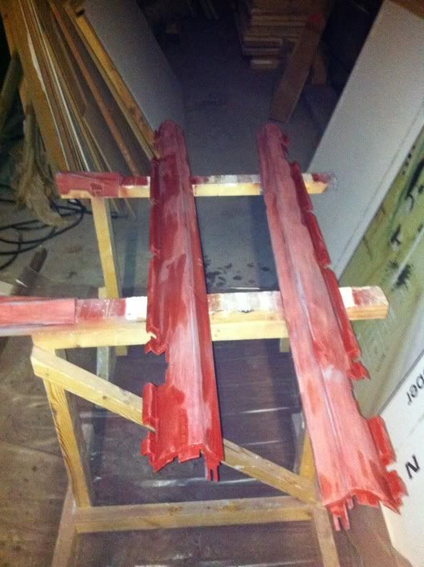

Skirts
Again, I used plastic primer (grey), then red primer to make it easier for the red paint. I've done this straight with 800grit wet and some of the black plastic is showing through.
Plastic primer again?
Will I have to sand the primer prior to paint and will 800grit be ok?

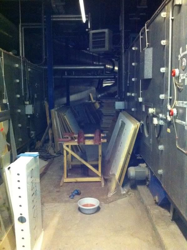

My bright and airy prep space :lol:
...no I wont be putting the actual paint on down there

You need to give it a bit of plastic primer then some high fill primer over that....
Block it down with 600 then 800 and dont go through the primer.... a tiny little bit is ok.
Now clean with wax and grease remover (prespsol)
And paint leaving around 5 minutes between coats no longer....
1st coat is a grab coat so its quite light... Helps prevent runs
2nd coat is a nice medium coat
3rd coat another nice medium coat...
And that is it... unless your going to clear...
Hope your not using cheap garbage paint. Do it right do it once.. :D

Make sure you use a block to sand and you must give the primed parts a guide coat, block it till there is no more guide coat and your done..
