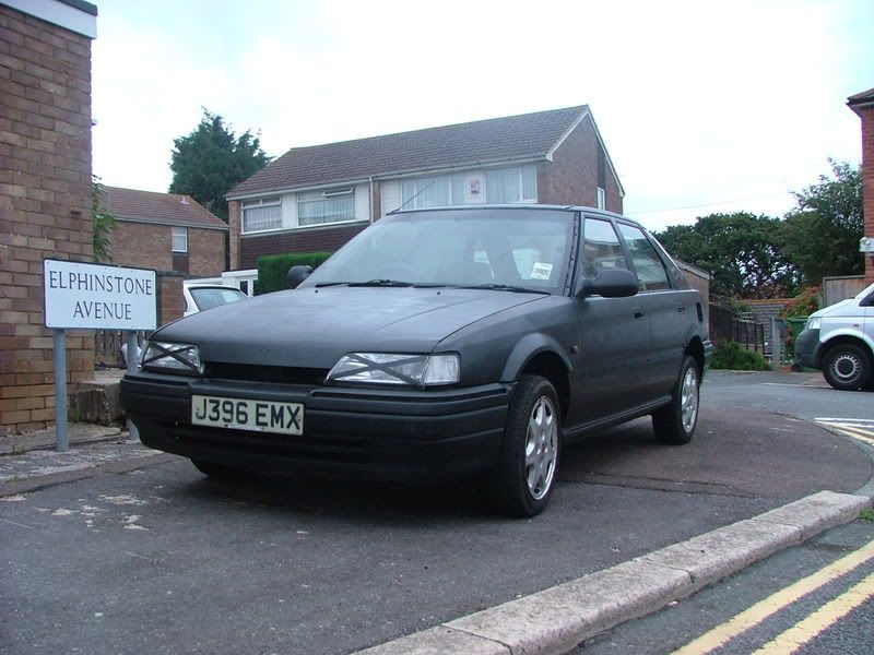

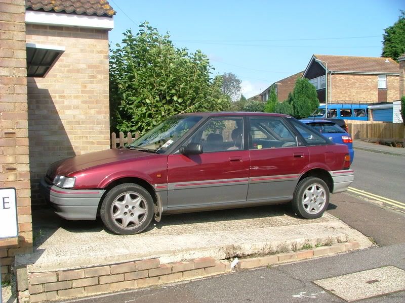

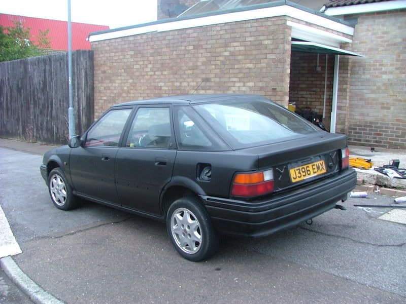

A while back me and my brother did this to a rover 214 before taking it to the nurburgring
take one nasty 2 tone rover 214:
'remove loose/flaking paint' it says on the tin...!
then rub back with scotch pads, mask up some bits (well, we didn't actually!) and throw 3 trade size cans of rattle can matt black over it outside on the drive
as mean as a rover 214 can ever be!
