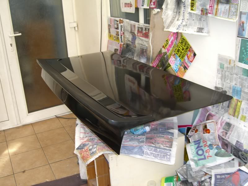

fair play that looks awesome.oakey wrote:What do recon? I think you can
dodgem, would you not need to put on a lacquer to match the rest of the car? people have told me that all metallic paint is lacquered.
i've repainted my bumper inserts with halfords bumper paint. had a massive scratch/dent on one side too, but i followed someone else's post about repairing them...worked out well. although my woman wasn't too happy coming home to find the living room turned into a paintshop.
also made a start on my engine bay rust, which ended up going through into my wheel arch, which has all now been fixed...looks a bit of a clip, but, the rusts gone and it's all good practice.
looks like a nice job on the boot oakey, there may be hope for my diy spraying after all...

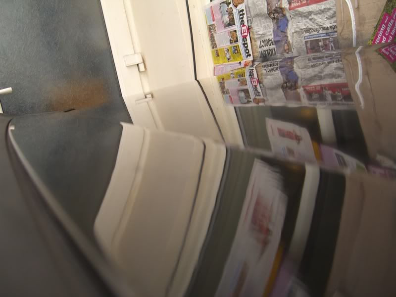

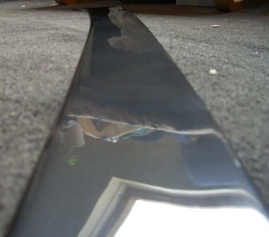

Well, in the end i looked at the finish of the colour coat when i got home and it didn't look too bad - the slightly rough bit was underneath (it's an iS lip spoiler i'm spraying - the bit under the front valance) so i jsut went ahead and applied the laquer. Got a bit worried when it seemed to be going cloudy on the thicker areas but it cleared as it dried
The finish is ok - shiny but a fuzzy reflection. I'm thinking that if i buff it and polish it after a few weeks then i'll get a nice gloss finish to it. Luckily it's about the nearest part to the ground on my car so not something that'll stand out...
I fitted it 45 minutes ago or so and tbh it looks better than most the rest of the car!! Especially my valance which looks shocking in comparison. I'm going to have to spray the valance soon and then take a porter cable to the whole car over a weekend i think - then we'll see how she looks
In answer to the title of the thread though, i'd say that with practice, a good finish is possible with spray cans. Practice, lots of patience, and lots of time - to polish it well after it's all properly dried.
