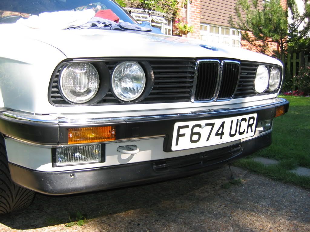

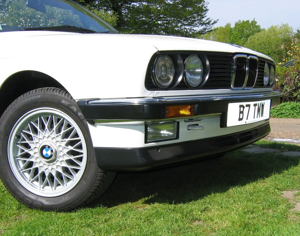

gaszman have you got any pics of the finished item??? Has anyone priced the front ones up lately from a dealer and how do u get thenm off. thanks chris.

I've refinished loads of them. The closest finish to original is Halfords Satin black. If the scores are too deep to flat right out, then a small smear of filler does the trick. No laquer on mine just the satin black.
If its a chrome bumper car than the rears are rubber and do not refinish well. new rubber is the only way at about the £45 for the complete part. Chrome front parts are ABS plastic the same as a plastic bumper car and are in 3 peices. Nuberplate mount comes off reletively easy but the 2 sides really need the bumper removing as the clips that secure them need to be compressed with pliers from behind to ease them through the slots.

thanks mate, think ill have a go at sanding them then re-painting them. I didnt realise that they were painted, i thought they were just black plastic., untill i looked properly last nite and some of the paints comming off further round. 8O Ill try painting them and if i mess it up ill buy some new ones.

ok just redone the front bumper inserts start by rubbing down with wet and dry untill you have a dull effect on the black insert then dry spray with satin black and ha presto will post pics tomorrow looks sweet
