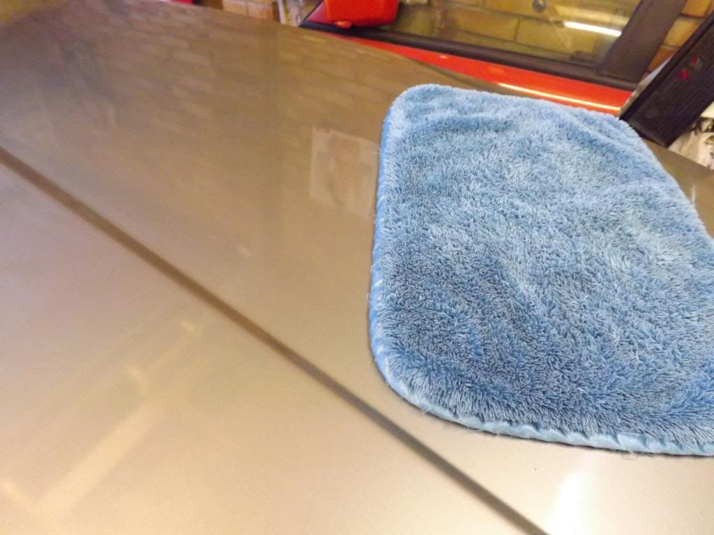

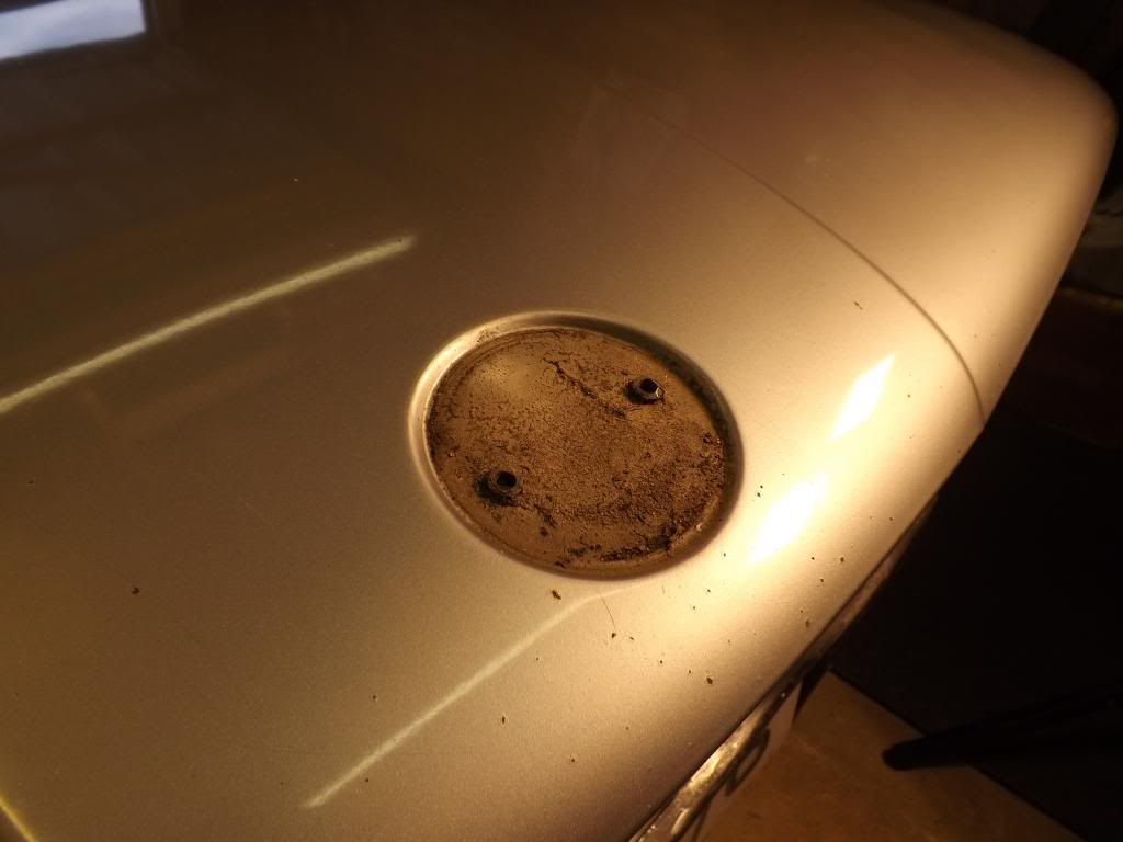

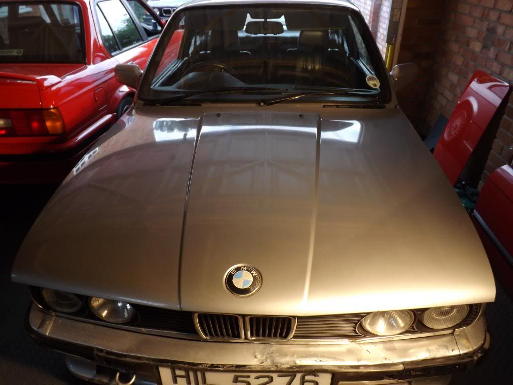

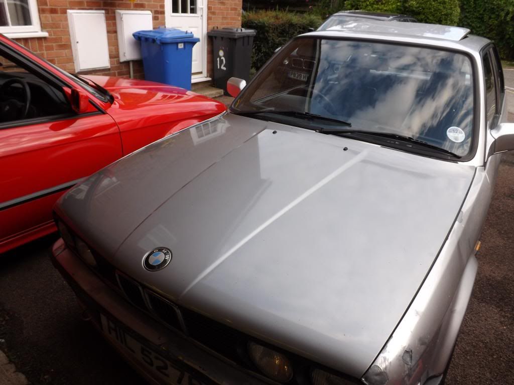

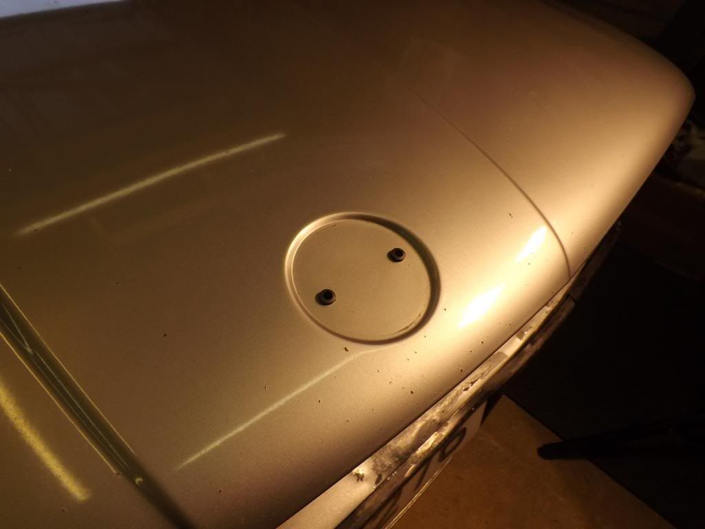

Having nothing better to do one evening i thought i'd see how well the Lachs bonnet on the Sport would come up:

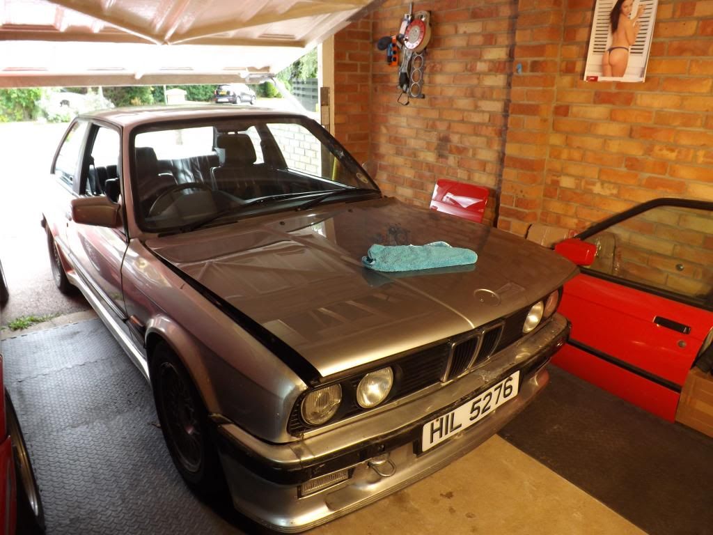

out came the claybar... claybar,claybar,claybar... :D

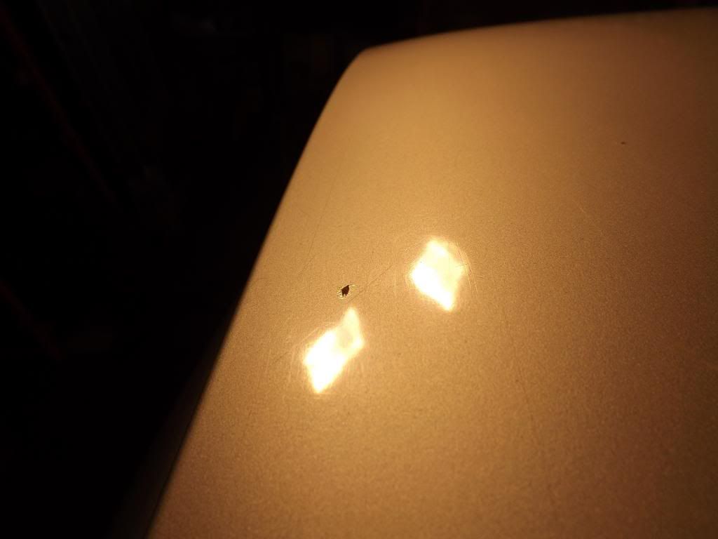

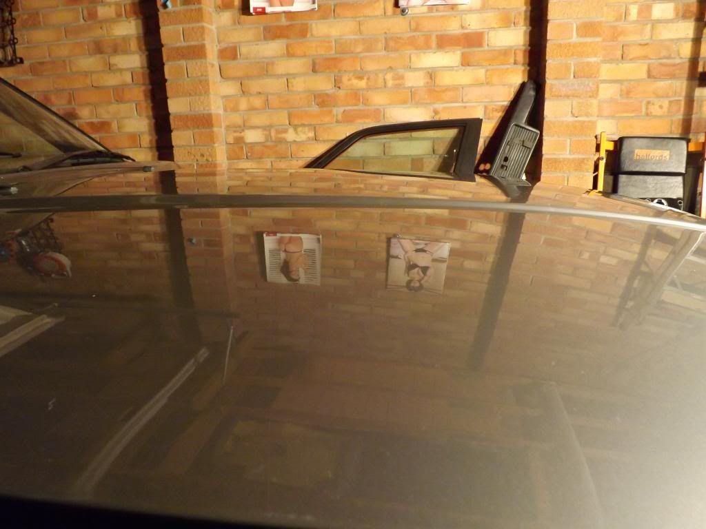

I can barely see that nice young lady's thong in the reflection, not good enough!

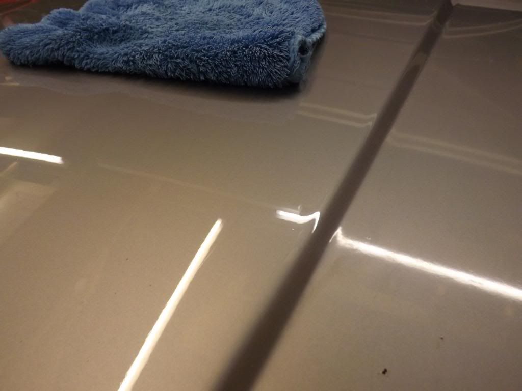

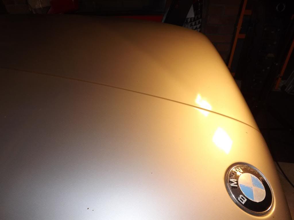

Left of picture compounded

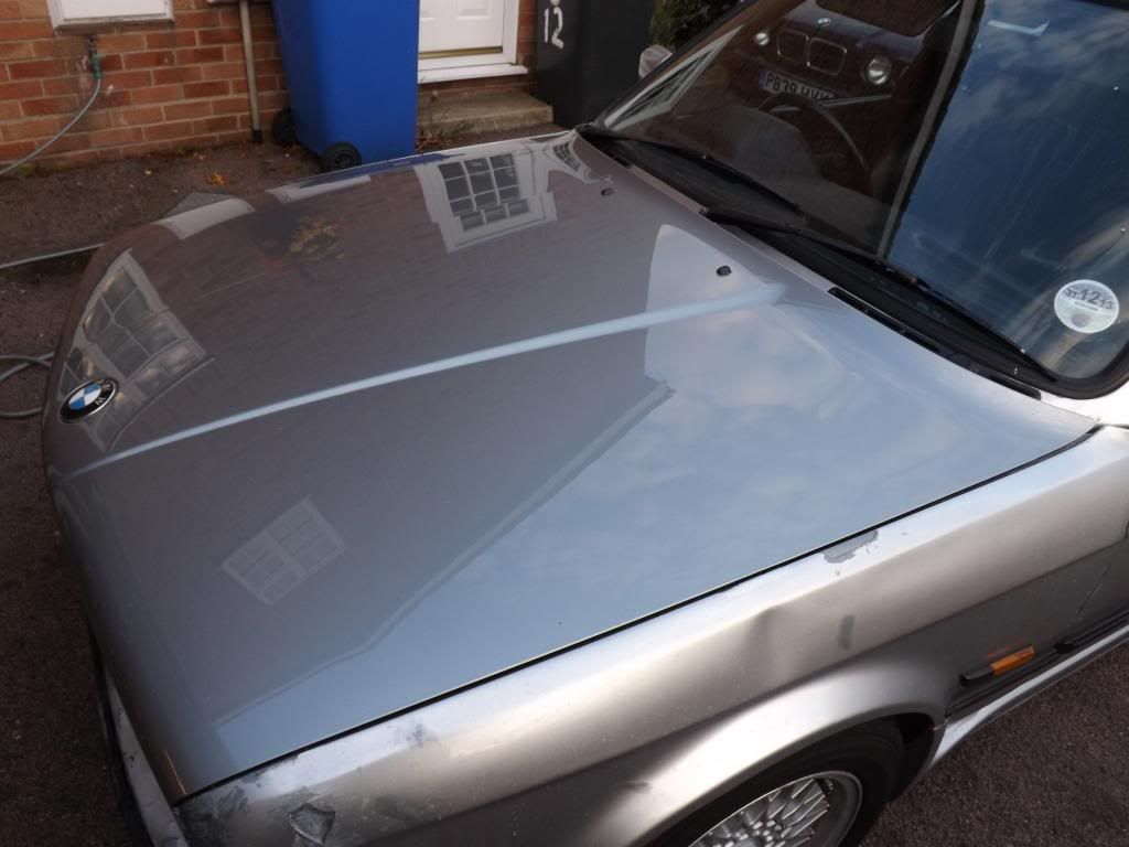

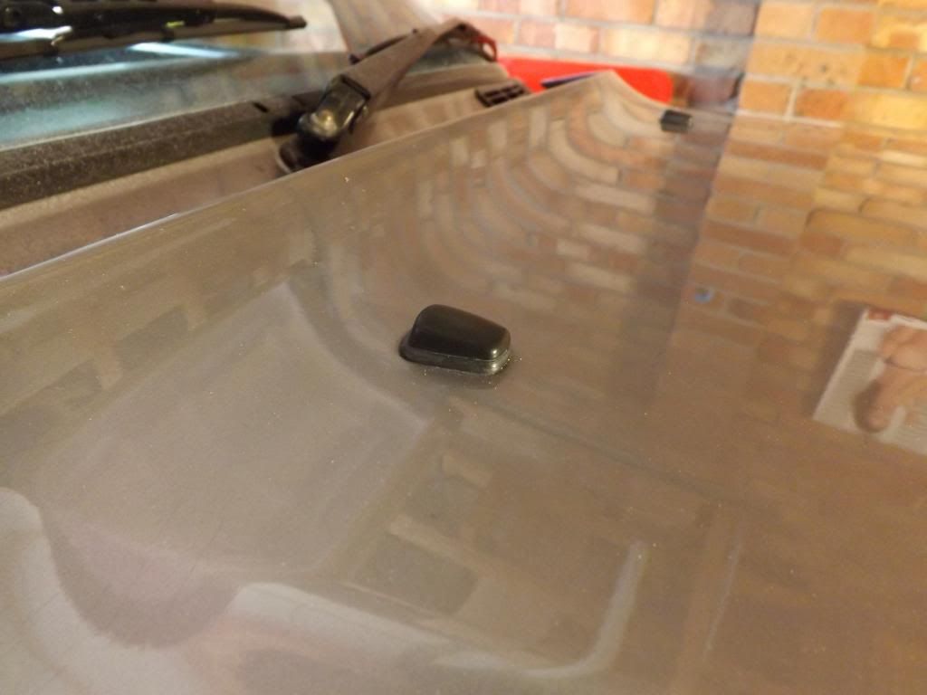

Getting better
Further pictures later today :D

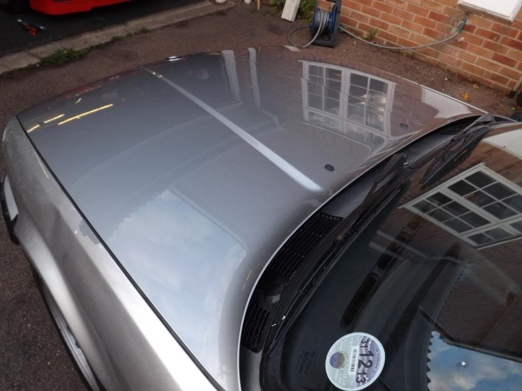

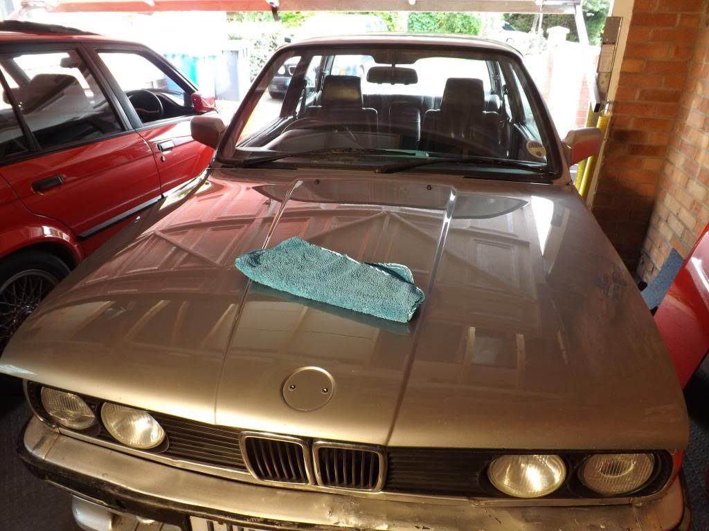

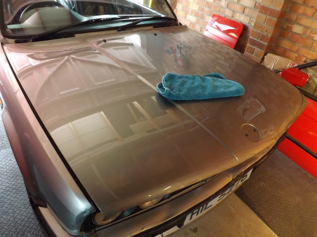

And polished up
LSP applied, nice result for the time spent:
