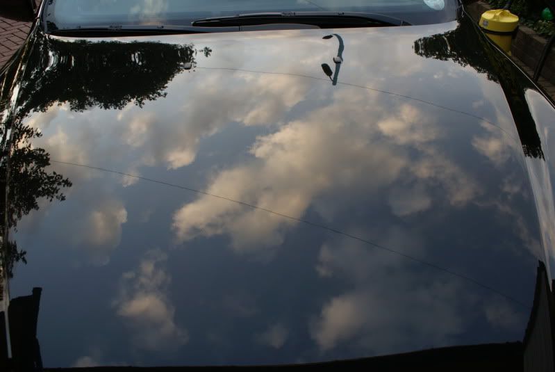

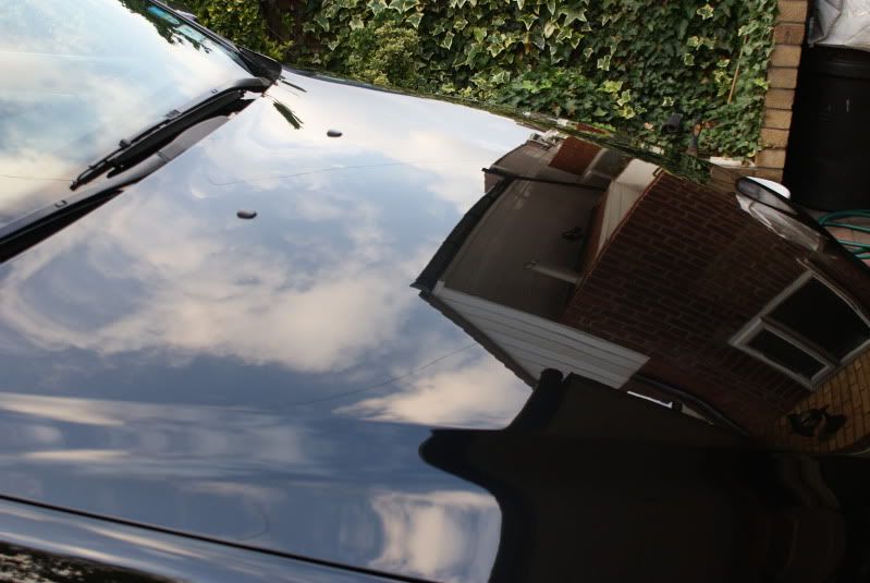

AMEN to that, when perfect black is stunning but a pain in the arse to maintain and correctMark-W wrote: Got your work cut out though, blacks a nightmare![]()
if good it can look like glass
