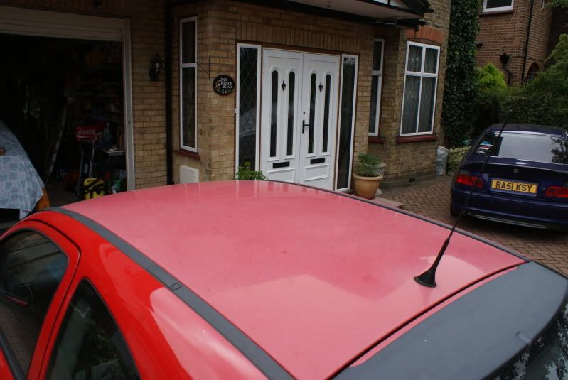

My roof & bonnet are riddled with fine scratches. Looks like someone has tried to polish the car at some point... with sand paper.
I gave the car a thorough wash and polish with Autoglym shampoo and wax but it only made them stand out more in the sun.
Any recomendations for a product to use? T-cut?

Machine polisher and the 3 stage merzerna paint restorer and polish will clear that up no problem. It's very dIfficult to remove scratches by hand.

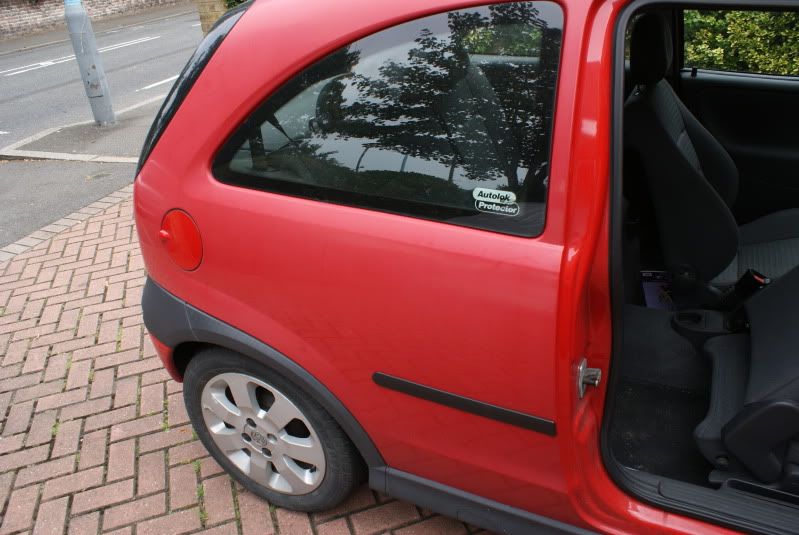

paint correction, 10 hours worth

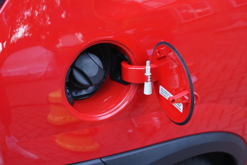

reds in general are a PITA. old 2 cellulose paint is notorious for it
if you look at the fuel cap, its still red unlike the rest of the 1/4 panel. its only happened on one side of the car and the roof.....

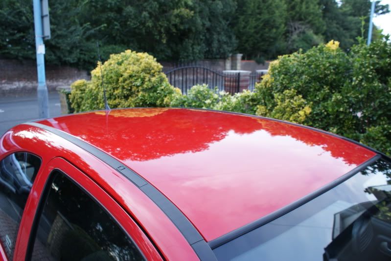

this is before i touched the roof. look at the passenger side , its still red
after

T cut , thats offensive lolmatt86 wrote:When you say paint correction, what products did you use t-cut, you've done a good job there mate.Kos wrote:paint correction, 10 hours worth
on her car i used 3M extra fine compound and a hit of autoglym super resin polish
ideally i'd have taken more time to refine it even more and get some more of the swirls out etc but she needed the car the following day

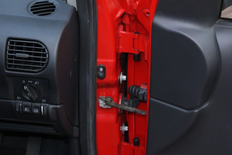

so she got it looking shinny and red again with all the detail work done like the following

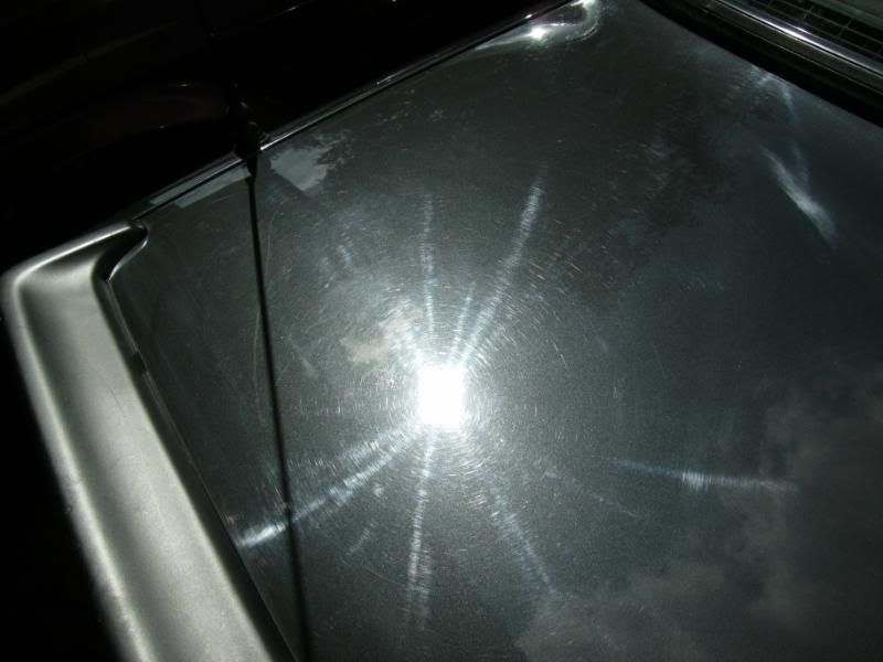

my old e30's boot lid before i touched it with anything
3 passes with Super resin polish and a layer of wax it came out like this
the wax seals in the fillers.
paint correction will actually polish out the scratches and its a permanent fix depending on how you wash your car to maintain the finish

go to halfords
buy -
auto glym clay bar kit
farclia g3 compount and waffle pad
farclia paint renovator
auto glym super resin polish
a tin of simoniz tin caranuba wax
auto glym vinyl and rubber care
some polishing cloth rags, and microfibre cloths
clean car like normal, rinse, to get a nice clean canvas
1 panel at a time...
clay bar, g3 any scratches,paint renovator, resin polish, wax
then move on to next panel, each panel will take a while to do, and whole car will take a couple of days , but in doing panel by panel it ensures its done, so should it rain etc it wont matter, go roof-bonnet-rear-sides
then look at it, if you really put the effort in it will look immense, dont worrry if youve never done it before, i wasnt an expert, and thats just my method
the paint comes out so so clear , il show you a pic....
