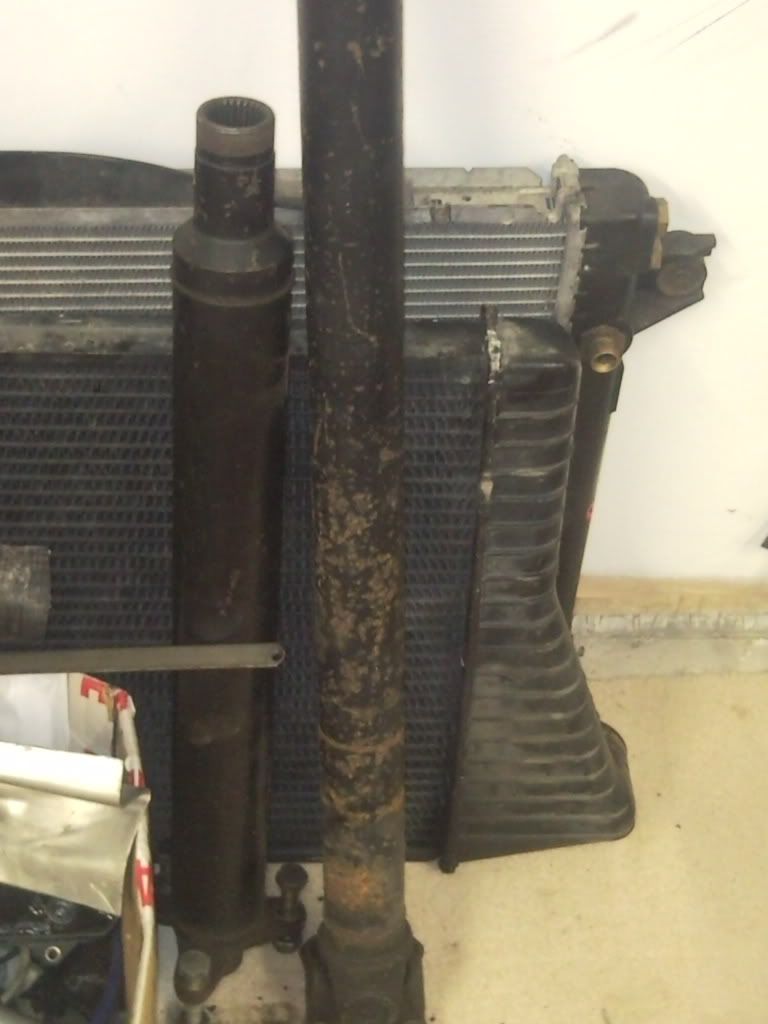

Best method to clean these parts.....
Posts: 22486
Location: Derby Massive!!
Sun Mar 27, 2011 11:13 pm
As above:
Was thinking of powdercoating the prop and diff red after cleaning?
TIA
m_jermyn
Posts: 4208
Sun Mar 27, 2011 11:18 pm
Mix kerosene and degreaser 50/50 and also mineral turpentine with a brush...

plug up any holes , tin of gunk thats its name , leave on for about 1/2 hour get into any awkward spots with a brush , jet it off , paint it what ever colour you fancy, but black /silver would be better.

i recently did a diff- autoglym engine cleaner, from halfords , is excellent stuff - also brilliant to do the enginbe bay with that, and a hose/watering can, all around the whole bay,work in with brush- rinse off - comes up brilliant and clean !
the diff- with powder coating it has to be baked in the big oven , so not sure its wise to put a diff in an oven !!! 8O , i painted mine black, with hammerite smooth black, tin paint, from halfords , 2 coats on there, looks good and came up new, that also is a "direct to metal/rust" paint, so no need to prep it
