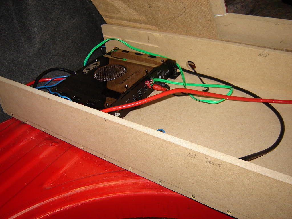

I used 12mm MDF for everything and all the joints were glued and screwed together.
Amp enclosure built

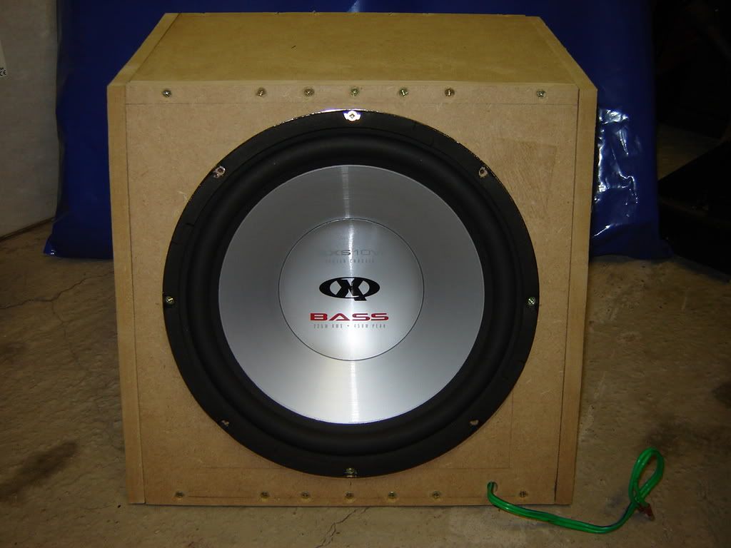

Sub box built plus a lid for the enclosure

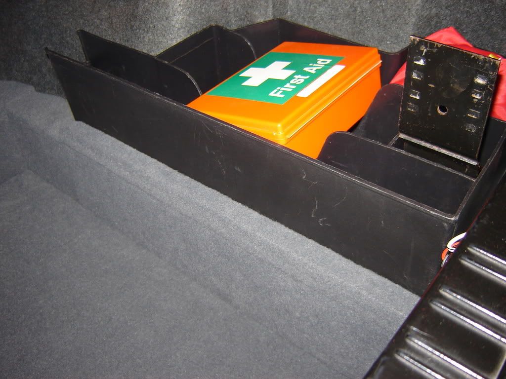

New battery box cover

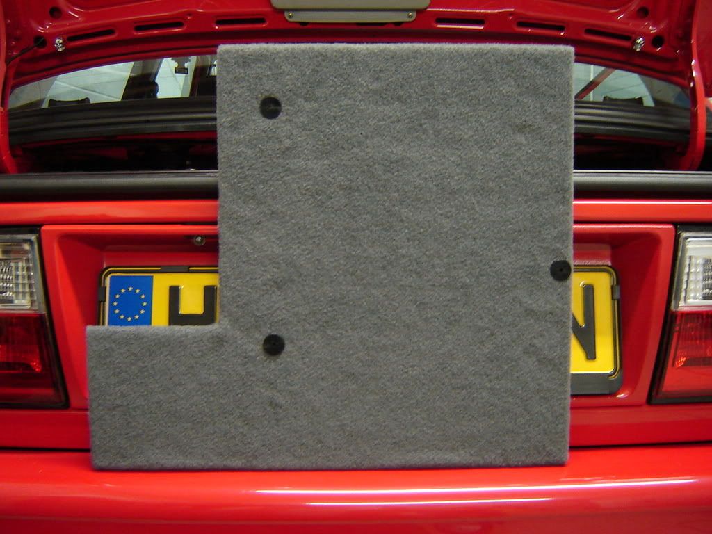

Everything all built up ready for some accoustic carpet

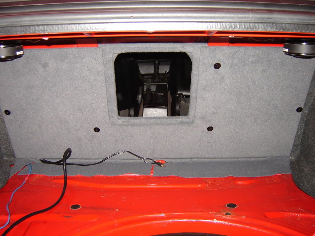

A wee tidy up around the ski hatch

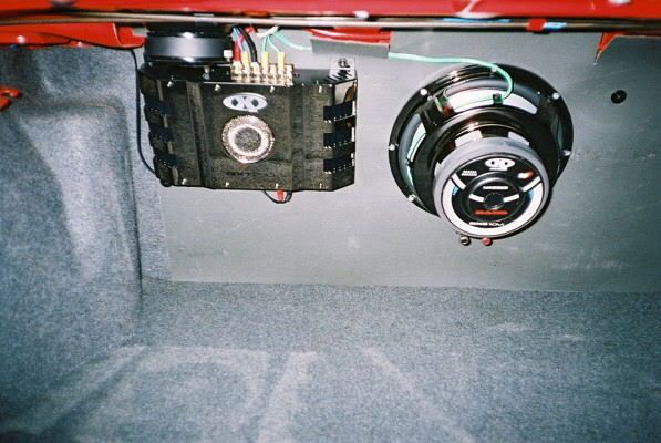

I made 2 new panels for the rear of the back seats to replace the panel that I butchered to fit my sub in it's original position
Amp in and all hooked up
All finished and a huge improvement

Did you just cover the ski hatch on the car side with cloth or did you make a wooden panel to fit? (pics 9 +10)

I made a small blanking plate from MDF to go at the bottom of the ski hatch (behind where the arm rest is) and then it was covered over with carpet.

That looks awesome mate, Ian's install made me redo mine as well, and i piched a few ideas, modified for my cab. Just a few qs though. Did you seal the hole in the sub bow for the wire to go through? Also when you put the sub in did you put any wadding in the box? I did this time and wow what a difference!!! How is your amp standing up as there doesnt seem to be much space above it for the air to move around, or mybe its just the angle. I know tthese have fans in as i have its bigger brother in mine. And finally, Ian have you any pics of your finished install? Ive been watchin the thread and re read it a few times, but would like to see it with sub/s fitted? :cool: oh and finally, how did you fix the sub box down?

Yes mate the hole for the cable was sealed from inside.
Amp has been fine so far with no overheating issues at all.
No wadding inside the box - what is it and what does it do?

the wadding i used in mine i got from a cheap fabric shop for doing cushions with i think. I know you can get it from ice shops. I believe it works by disturbing the sound waves in the box but i may be wrong. However what i do know is that it make a hell of a difference and is deffinately worth doing. I think i paid about 4quid for 3mtrs by 2, which did my twin 10"s and a friends 10" and left a little bit over. hth 8)

There was a panel spot welded into the ski hatch - I just drilled out the spot welds to remove it
