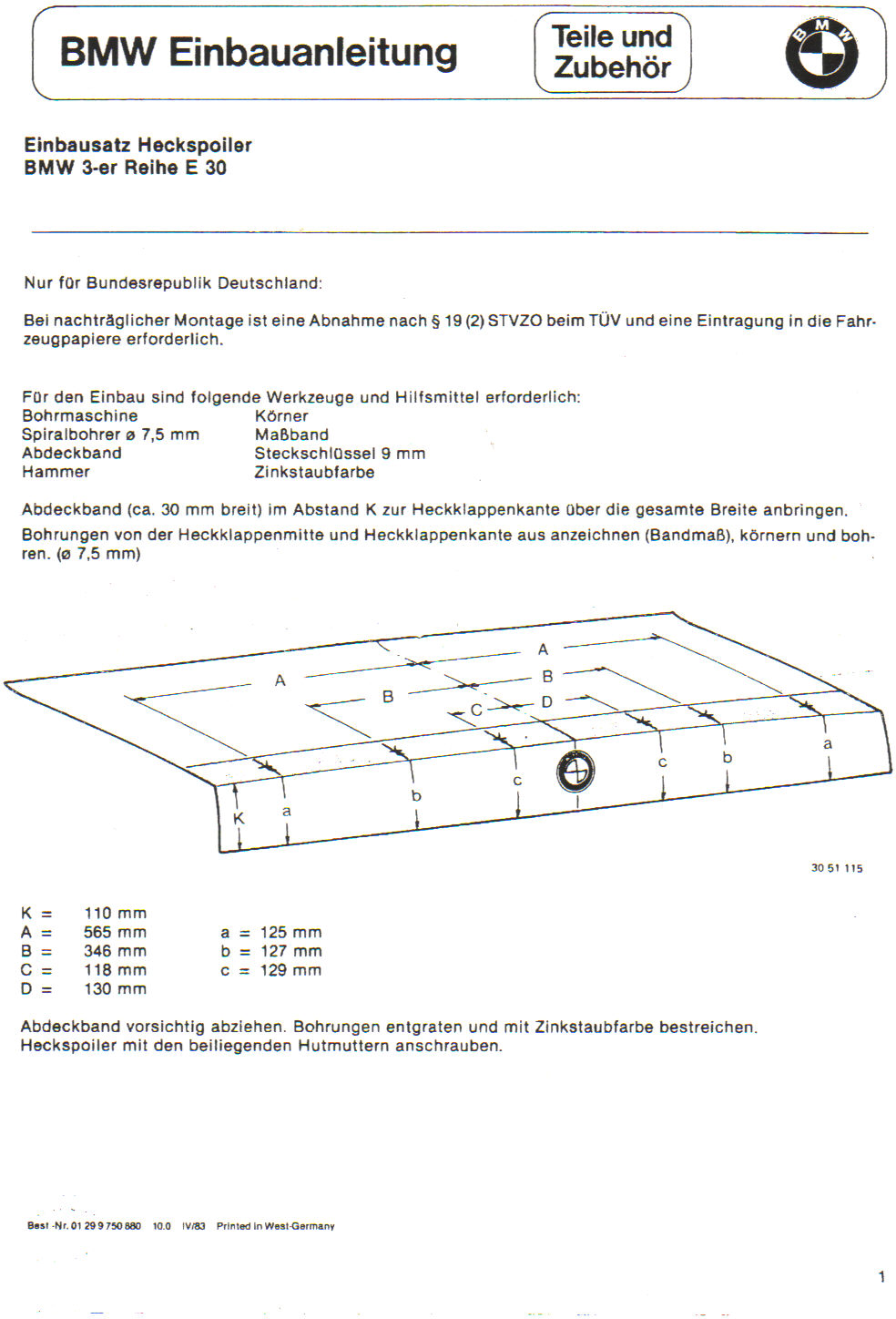

Does anyone know what the best way is to fit a heckspoiler (the standard bootlid lip).
I've had a look at where the holes should go horizontally across the boot lid but I'm unsure as to how far they should go back towards the opening of the boot.
I suppose some sort of PDF showing measurements is asking a bit too much?

This should be what you need:

Bloody Fantastic
Thanks very much!
