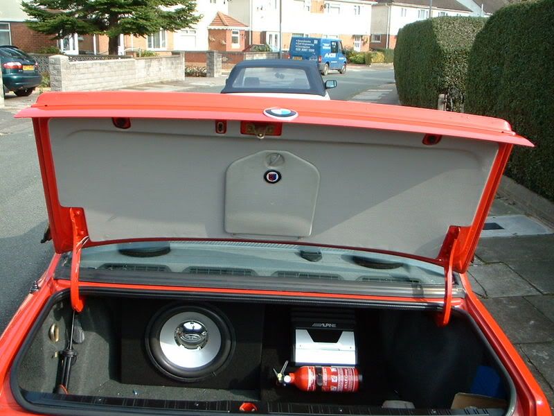

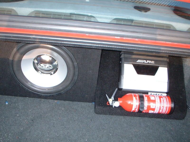

doesn't look like much but has 2 amps and a power cap hidden behind the panel.
made a wooden frame of my boot floor and then secured it to the floor, built the box as thin as i could and mounted the 2 amps on the back of it and the powercap on the side and then made the front panel (also the front of the box)

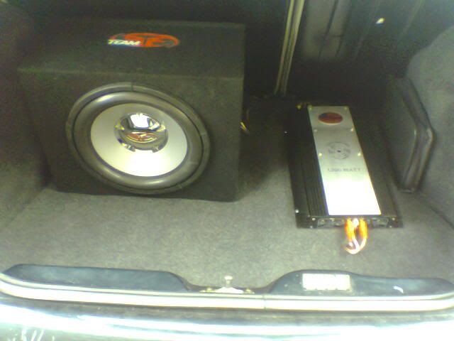

When I had a fiesta, I got a sheet of 18mm MDF. Cut it to the size of the box base and amp + a little bit extra, at each corner I had 4 squares of 18mm MDF measuring 2" then another bit of 18mm MDF underneath. So you've got 2 sheets of 18mm MDF 18mm apart yes?
I slid the MDf under the boot carpet and screwed the amp and sub to the base then passed the cables through the carpet inbetween the sheets of MDF and hidden under the carpet.
Looked tidy enough and kept it secured in one place. Oh and the MDF was siliconed to the boot floor so it wouldnt slide about.
You can see much in this pic, but you might get the idea...

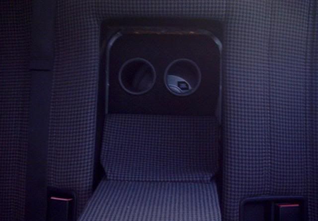

gasgas
- Posts: 93
- Joined: Sun Dec 17, 2006 11:00 pm
- Location: Oxfordshire
it didnt have a ski hatch but it does now!! chiselled the spot welds off! does the bass travel through the seat foam ok? as i havent got an arm rest! hope so!!

No worriesgasgas wrote: does the bass travel through the seat foam ok?
I had a 12" sub in my 2 door and the base was everywhere

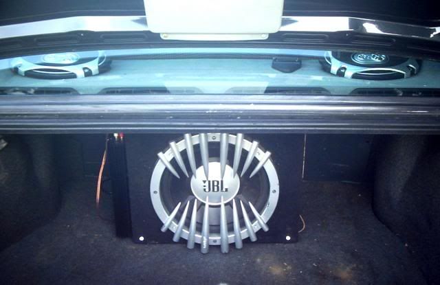

Standard box ported at the sides, i blocked the ports off and put the amp on a one side and made 2 ports on the back of the box so they face inwards... the sub cover chavey chavey chav chav lol was a fiver and protects me 1200 watt sub, so i'm happy
