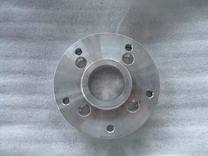

timmyboy wrote:yeah had a look there, as i have a caddy too, only prob i can see is that porsche rims have a 58 offsett so wil be 30mm closer the inner arch. is a spacer that size cool ????
Yes but the good thing about having that offset is that you can use a 30 mm adaptor with 4x100 pcd which bolts to your hub,then 5x130 pcd wheel ontop .Picture below :
Obviously cant do this with the bmw 5 stud as they are already the correct offset.
Ive been looking into doing this also as there are bbs wheels in porsche fitment.

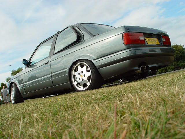

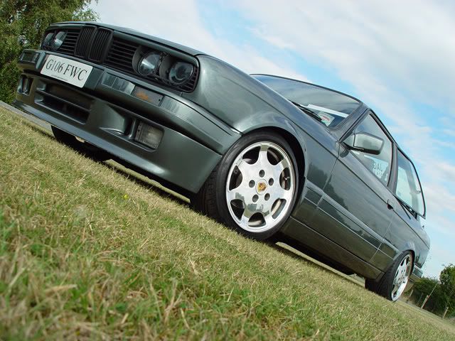

timmyboy
Posts: 129
Location: ipswich suffolk
Wed Dec 06, 2006 5:25 pm
personally i think they wil look pretty pucka( guess i wouldnt of brought them otherwise)
the wheels are flat and the e30 is pretty square boxy car think they wil work wel togrther,
ile post photos on sat and see what ya think. :D
