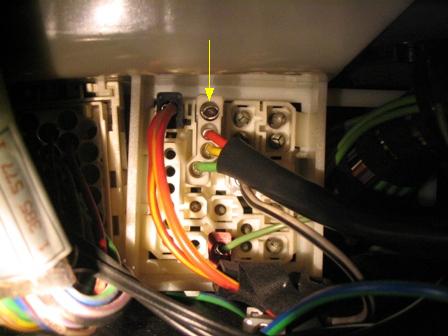

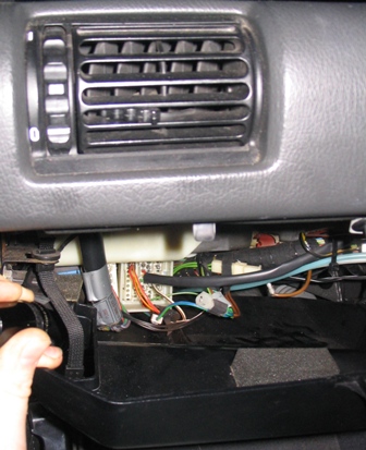

There's 3 wires to the back of my head unit : RED, GREEN, YELLOW (yup, no black). I'd thought yellow was earth as I'd only done a lamp test, and not checked with a multimeter.
This evening I traced the wires back and found this behind\above the glove box:
On the second pic (yellow arrow) you can see someone's snipped the black wire back to the connector! No wonder I was having "slight problems" (fuse 23 blowing, no stereo when headlights are on, stereo rebooting when vol turned up to 25% or more).
I guess yellow must just be nearer earth than green is, for the stereo to have worked at all. Maybe it's a feed for the lit bezel on some stereos, so light dims when the dash dimmer control is adjusted? I dunno, but whoever modded this wiring needs shooting. Am looking forward to sorting it tomorrow evening...
So it looks like the acid head at bmw assembled the electrics on more than one e30!
