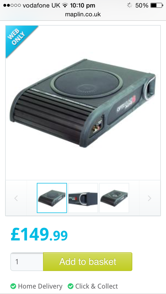

I was thinking of getting something like this.
cheers

Please don't buy that.

That was just an example picture. I've never heard one to say if they are good or bad.

They are all bad.
Buy some replacement doorcards, then make some doorbuilds.

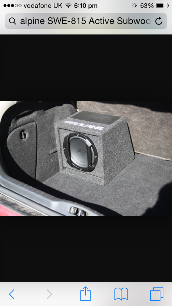

They are coaxles ithink. I just purchased a alpine SWE-815 Active Subwoofer With Wired Remote Control. Read some reviews and thought as I'm 6ft3 I can't risk any headroom

Whilst it isn't a bad sub for a hatchback, it might be a bit lost in the e30 boot.
Cut the ski hatch out, it will help get the bass through.

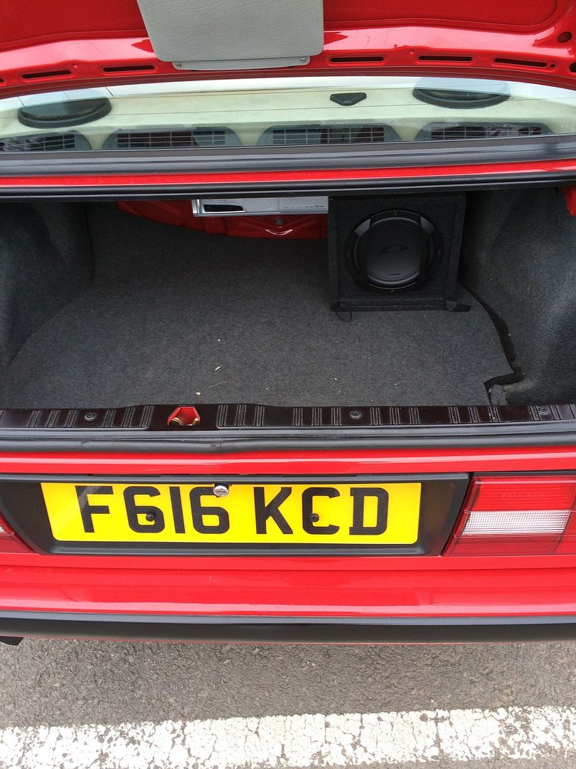

Post Fri Jun 19, 2015 10:06 pm
Just an update-Whilst sat in traffic today I had a little play with the fade on the stereo. I faded to the rear and then to one speaker only as I thought I heard a rattle. When I faded it I noticed a lot more bass, then I faded it to the centre and the bass disappeared. The person who fitted previous system had to polarity incorrect. When I got home I took the radio out and corrected the polarity. The sound was lots better with much more bass (6/6.5 inch mb quart rear)the number plate even rattled a bit haha. As I went in the the house I noticed my sub had arrived also. So I fitted that and tried it out. The car now has much more bass. The sub drops low when required and is quite punchy for dance music etc. The saloon boot does slightly mute the bass but I personally think it's very good and suited to the volume of my whole system. The sub takes up very little space in the boot and even the spare wheel is accessible without removing the sub.

Post Sat Jun 20, 2015 2:46 pm
Very small in e30 boot
