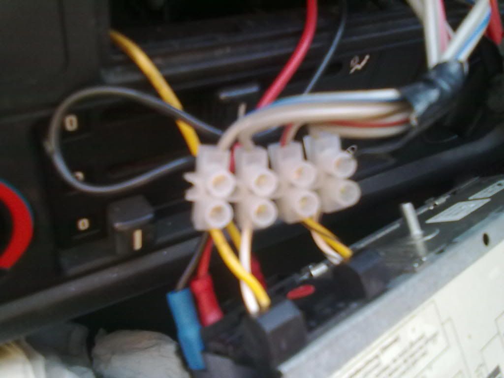

Hi my fellow zoners. I have an aftermarket stereo I would like to fit to my 1990 316i 5door e30. The problem I have had an aftermarket stereo fitted, so it still has the factory fitted "Blaupunkt windsor SQR 38" fitted. I have an iso connector for my aftermarket stereo, but I need to know which wire goes with what. Here are some links to the pics so you know what I'm dealing with. Any diagrams will be much appreciated. Thanks for reading. (sorry for mini essay and structure, was using my mobile!). Ryan aka Stokiedundee.

Chicken! From this photo, your existing wiring looks very straightforward:
Probably just an earth, a permanent +12V, an ignition-switched +12V and possibly one for the electric aerial trigger (if fitted).
It would take you all of 5 minutes with a multimeter or even a test lamp to establish which does what.
