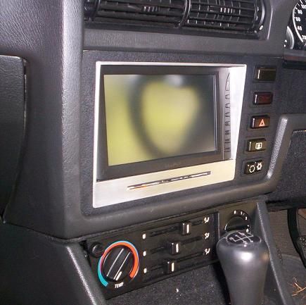

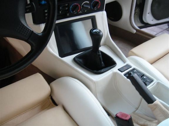

Here you go:-maynee007 wrote:thanks guys....i think aftermarket double din is the way forward, seen a sony one for about £600 includes satnav, has anyone got any pictures off double din conversions to dash???
This one has the centre dash heavily moded and all the stuff relocated below very easy, enough space and some trimming and fabrication is required.
This one has kept the existing centre dash standard and the double din has been placed in the pocket below again trimming and fabrication is needed. This looks like a better format and a more flush finish (from an e34)

In the pocket version (second picture) if you go for this method I would suggest you buy a centre console of eBay and do some trial fits before you go sawing into the original one you have at least that way you can fabricate a mock up, thin MDF would be the most likely material to be used like minimum 2-3mm in my opinion
