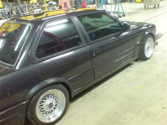

Looking to get a set of 8x16" wheels for the E30.
After doing a bit of research it seems a lot of people go for an offset of ET25 with these? Although I have seen ones with an offset of ET15. Would that be better?
With the offset of ET25 it seems people have to run a spacer, could I work round this and go for perfect offsets so I dont need spacers? Or should I just keep it simple and go for ET25 with spacers......

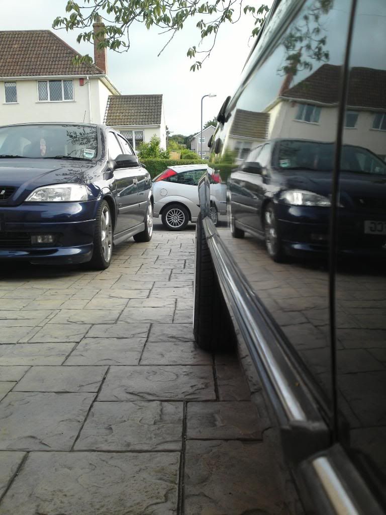

I have 16x9 with et 15, 205/40 tyres, 70/50 drop. The front arches are untouched but the rears needed rolling. I'm now running 215/40 on the rear and they needed even more tweeking to stop them rubbing.

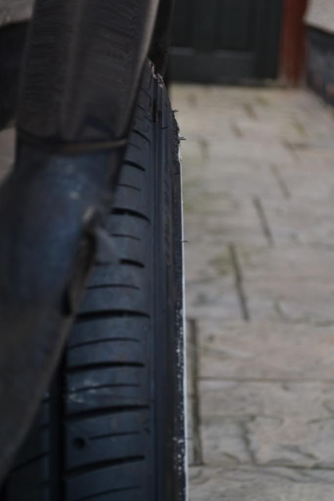

I run 16x8 et10 on the rear on 205 45 16's arches are untouched atm and no spacers:

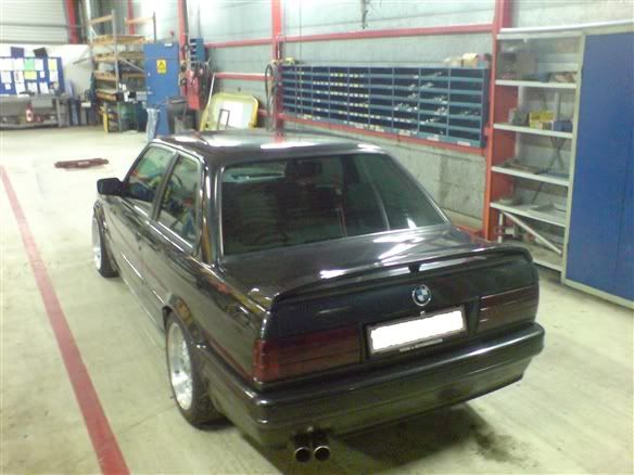

Hmmm, difficult to make a decision, ET18 would obviously be the safe bet then, no work and still sit quite wide, however i'm tempted in ET15 but then it needs arch work........
Need to be able to run decent size tyres too and not majorly stretched.

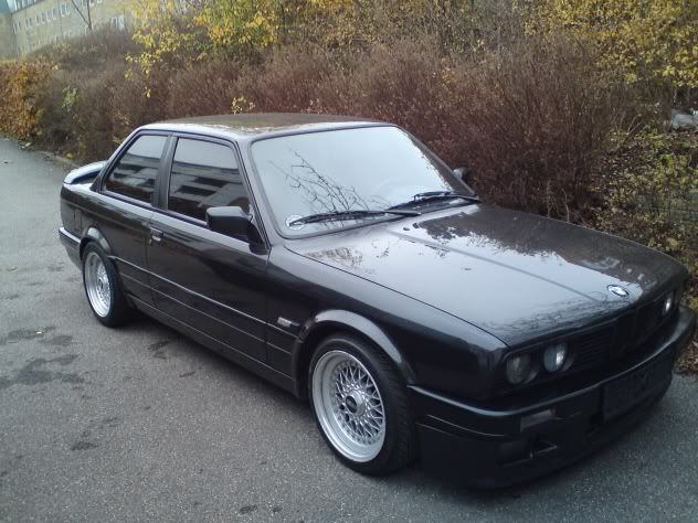

8x16" ET15 looks alright all round.
