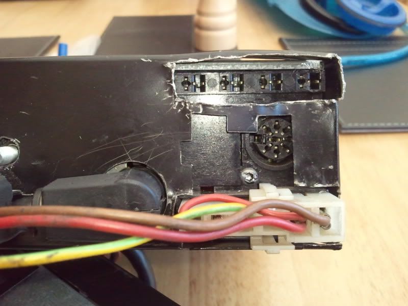

Just taken delivery of this;
Now any ideas where i source a plug for what i assume to be the speaker outputs?
Also how do a rig this up on a test bed as Barry has done to make sure all is working well?

is that the one from ebay kedge ? how much did you pay ? (looks super)
have no idea about the plug, but it might be just connectors to fit in there you need for the ends of the speaker wires ? halfords do a load, pop in there and ask and any local stereo shops woudl be a better bet independnt types and say you want this testing and fitting what do i need ? (even if you dont want them to fit it youl get the info on whats needed)

I was watching this on ebay. I would like the CD unit to match the SQR88 i already have but there is no where to mount on an E30.Kedge wrote:Just taken delivery of this;
To test, hook up the live and earth on the back of the unit to a 12v battery.
For power and speaker connections you want this,
http://cgi.ebay.co.uk/AUTOLEADS-16-PIN- ... 421wt_1199
