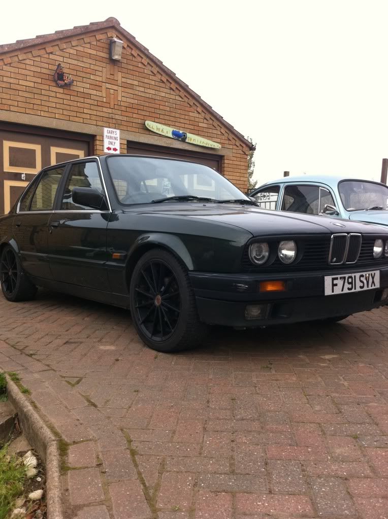

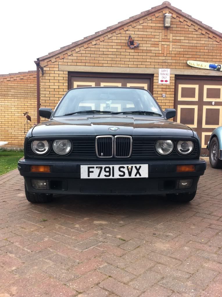

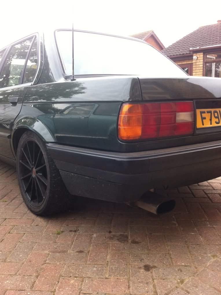

cheers guys, fingers crossed this works for the pics..

The eye brows make it look sad. :(
All it needs is a new front lip and some 15" bbs :cool:
Are you changing the wheels?

ive got a set of 15" vauxhaull alloys, the bbs replicas but im not sure whether to stick them on or not

Pretty much this. Love the colour. Those wheels are horrible.
A good clean is what this car needs.

Are they a straight fit on then? They'll look much better than the wheels currently on it. I know its the norm and it may look like most other E30's, but there is a reason they are on so many, they make them look spot on everytime...

Really nice car but the eyebrows and wheels have to go :) vauxhall wheels won't fit without a spacer (wrong offset) even though the stud pattern is right! You'll find they are an ET35 or 38 (stamped on the back) you want and ET20 or thereabouts.. They will go on but they'll sit right under the car and possibly catch on full lock!

cheers guys, ordered a volvo splitter to see how that looks first cause that might jsut make it look alright without a kit on :D
