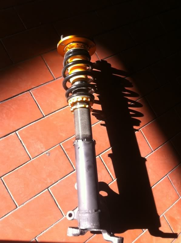

Most true coilovers require you to weld the E30 stub axle to the lower leg of the coilovers, these above were a threaded collar I welded to te stub axle - obviously you need to cut the old legs off.
Not much or difficult welding, you do need to get the dimensions right otherwise you may run out of adjustment.
Rears are rarely coilovers, so they re easy.
