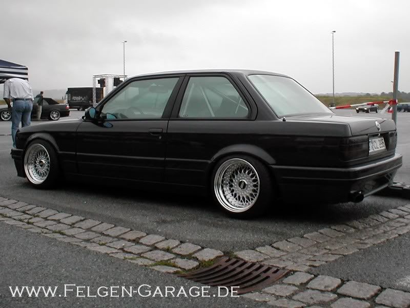

Another what wheels are these?
E30-830

I know there bbs but not sure what kind? Anyone have an idea on sizes and dimensions aswell? Thanks. :D

Actually just found d dimensions myself. There BBS RS1's
FT 9,5x16 ET 21 mit 215/40-16 Pirelli P7000
RR 11x16 ET 09 mit 245/35-16 Pirelli P7000
Would 11j Wheels fit the rear of an e30 with no problems?
Also would 9.5j wheels fit the front with no problems?
I'm running standard 318is suspension, not sure what size d struts are.
Thanks. :)
No, they're far too wide
Do you know what would have to be done to make them fit? From the picture it looks like he might have used spacers, but i could be wrong.

You'd need to make the wheel arches much wider

and the suspension much much stiffer

E30-830 wrote:
Spacers would make the stick out even further! Depending on offset you could get away with having your arches flared, but anything wider and they would have to be chopped up. As Mr Lee said you would also have to have stiffer suspension set up. Mine was like a bumper car, but i'v always been style over comfort :wink:

Arches would definitely have to be rolled. They look like 9 at the front and 9.5 at the back. I'd be very surprised if they were 11's. I don't think they'd fit without "tubbing" the rear end!

octanejunkie wrote:Arches would definitely have to be rolled. They look like 9 at the front and 9.5 at the back. I'd be very surprised if they were 11's. I don't think they'd fit without "tubbing" the rear end!
I had 10's on the front and 11's on the back of my Motorsport cab, but i had my arches choped and flared proper. I can't see any E30 moving with 11's even with flared and rolled arches.

That car deffinately has 11's on the rear. Seen it floating around quite a bit in the past. From what I have read a lot of work went into those arches.
With the RS' on top, certainly not a cheap mod!
