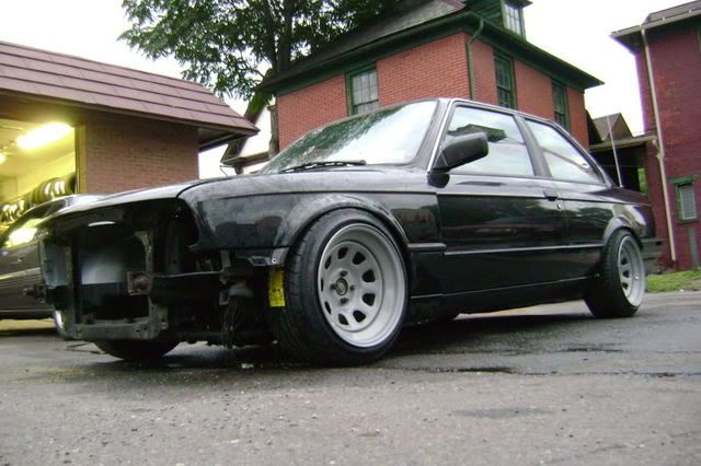

tyre tread should be fine to as i'll use a 205/50/15 and if the tread is covered on the 8jet-25 on the pic ^ up there then it should be covered on a 10j et00 too.

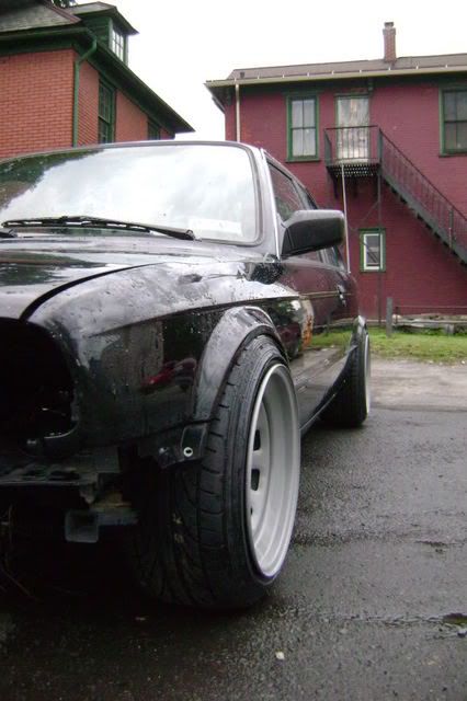

i think these are the exact spec i want to run
to me it looks like just a flare will do the job, maybe some inner arch bashing too i dunno, i'll do whatever's necessary.

Robbs wrote:i think these are the exact spec i want to run
Those steelies look the damage. :cool:
town325i
Posts: 7050
Thu May 13, 2010 9:57 pm
I would be more worried about that front tyre being the wrong way round and the fact the tyre is resting on the wing. To the op you going to be running coilovers?
