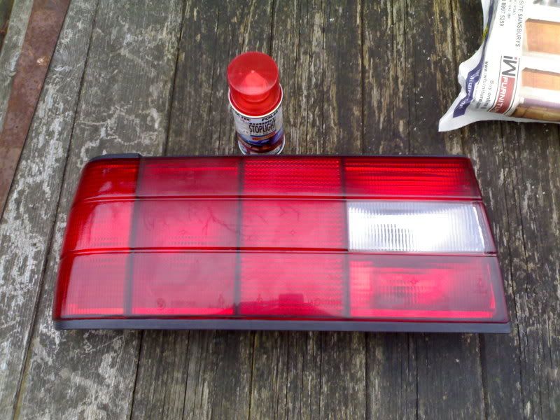

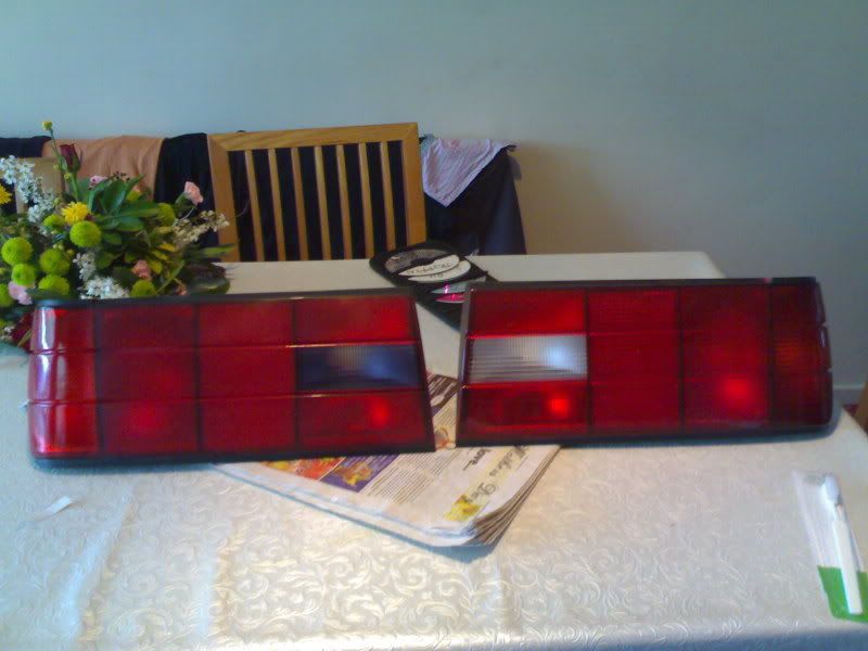

had a got at D'ingIM and im pretty impressed with myself!
their not fineshed yet, i was thinking about giving the whole lot a coat of smoked spray to bring back the shine but dull them out a bit because i think their a bit too bright for my car? its a lagoon green touring. . .
what do you guys think?

Looking good, how many coats of spray did you use?
I think I would be tempted to smoke the reverse light though.

HAHA! great minds! my, "not finished yet" statement was for that exact reason! i used about 4-5 coats. . . i just kept putting the bit i was spraying against the other light to see how similar they look
one finished, and one not. . . infact their both not finished because iv still got to laquer the whole lot. . .
now their finished lol, , , they both look the same, just cant be bothere to conect the camera up etc. . .
hop you like!

oh mate, its one of the eaies DIY mods iv done. . . just masked off the indicator and sprayed it with Folia tech Red tint from hal'frauds'. . . i kept matching them against the standar light to make sure i had the correct shade of red then just gave the indicator 2 coats of smoke spray. . . i laquered mine for 2reasons. . . i found rubbing the lights down gave the spray a much better surface to stick too also iv rubbed down all markings on the lights. . . so so 'E' markings or anything embosed, they are totally smooth 8)
i gave them 2coats of laquer, i was going to rub them and polish them out with tcut, but i like the sort of satin finish the laquer gave mine
