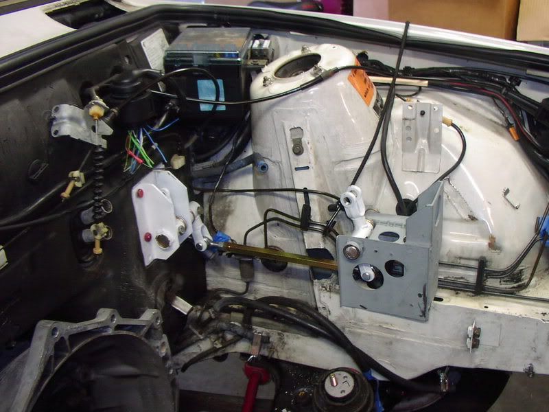

From your hoto Cosmin, I can't see if your servo is hitting your manifold. The resevoir certainly is and can be fixed easily with a remote reservoir kit. Also go for a Rabbit (american MK2 glf) GTi servo or get someone to send you a Clio one, provided the engine is on E36 alloy engine mount arms and 5 series rubber engine mounts as is commonly the case over here (are you in america?). [edit: just re-read and you're in Romania - you should be able to get a golf or Clio servo easily]

Sorry.. I must've typed MK2 golf by mistake. It's the golf GTi MK1 servo, or the MK2 1.3 servo that can be used. I beleive it's the first of the clio's with plastic wings that the servo can be used from. Not sure about on the iX though if the engine is in a different location.
Take a look at my Golf 1.3 servo with an Audi master cylinder. I have moved it over 53mm. Unfortunately you can't because of the LHD aspect of your conversion but it gives you an idea of size...
